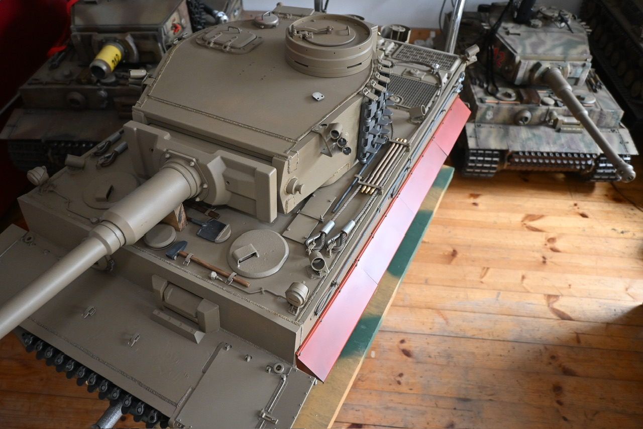

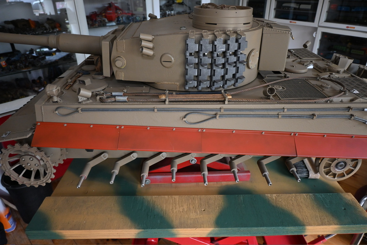

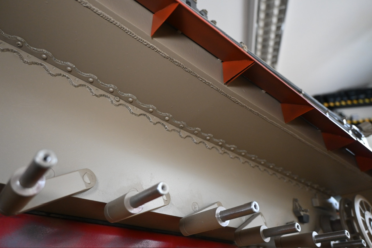

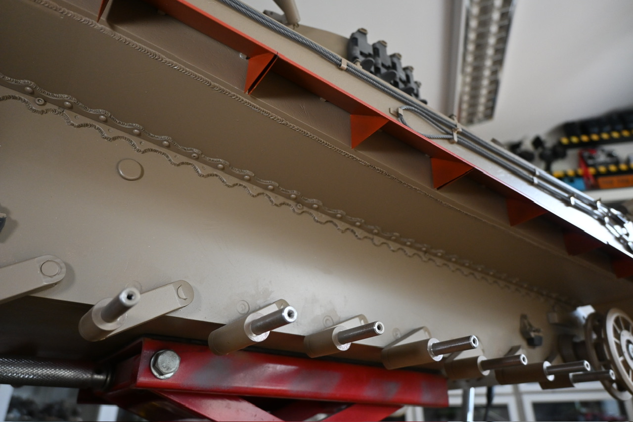

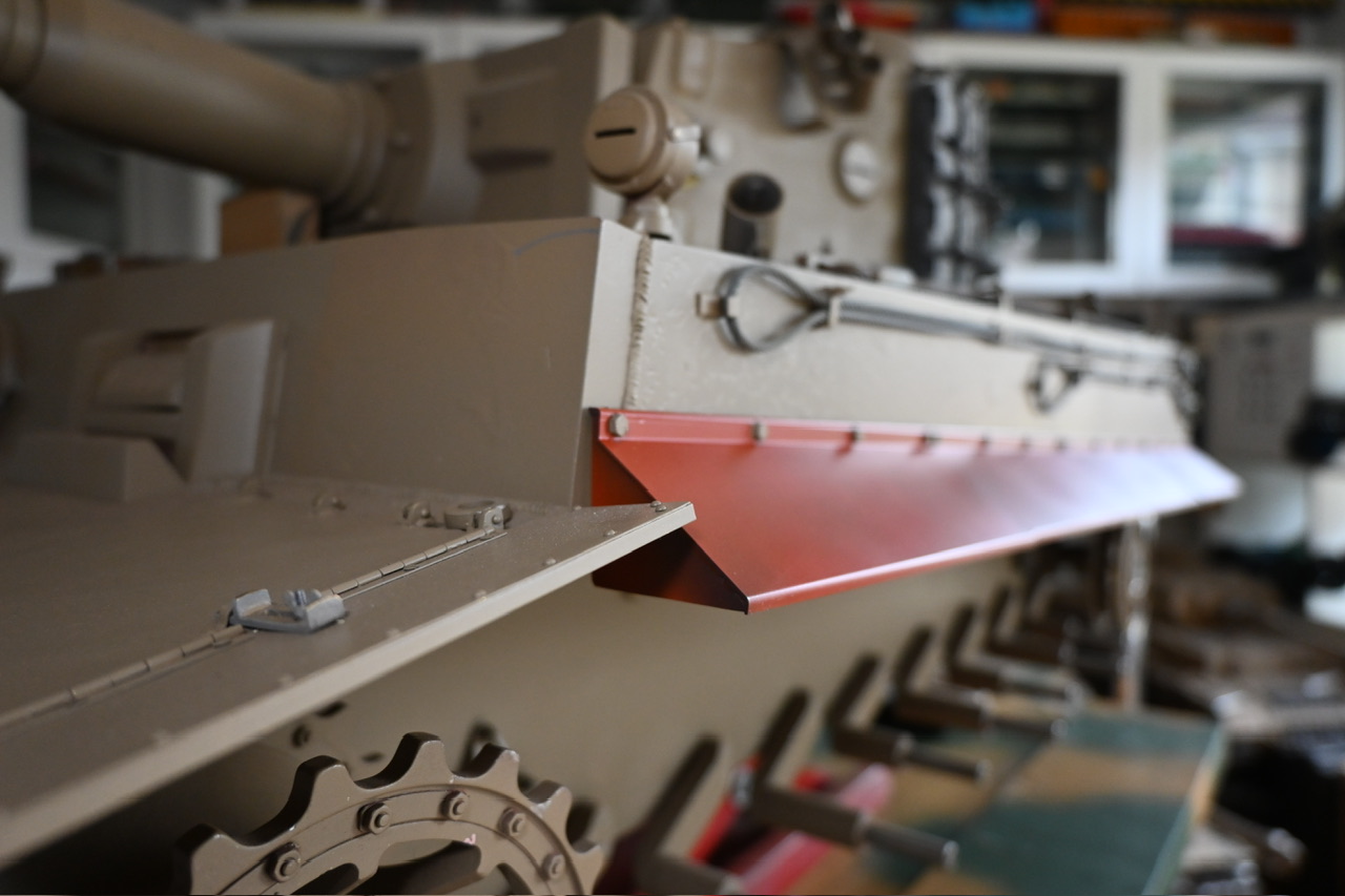

Latest progress. Added supports to underside of side skirts and fitted. This make them much more rigid and secure. Sorry I didn’t do this on my other tigers,

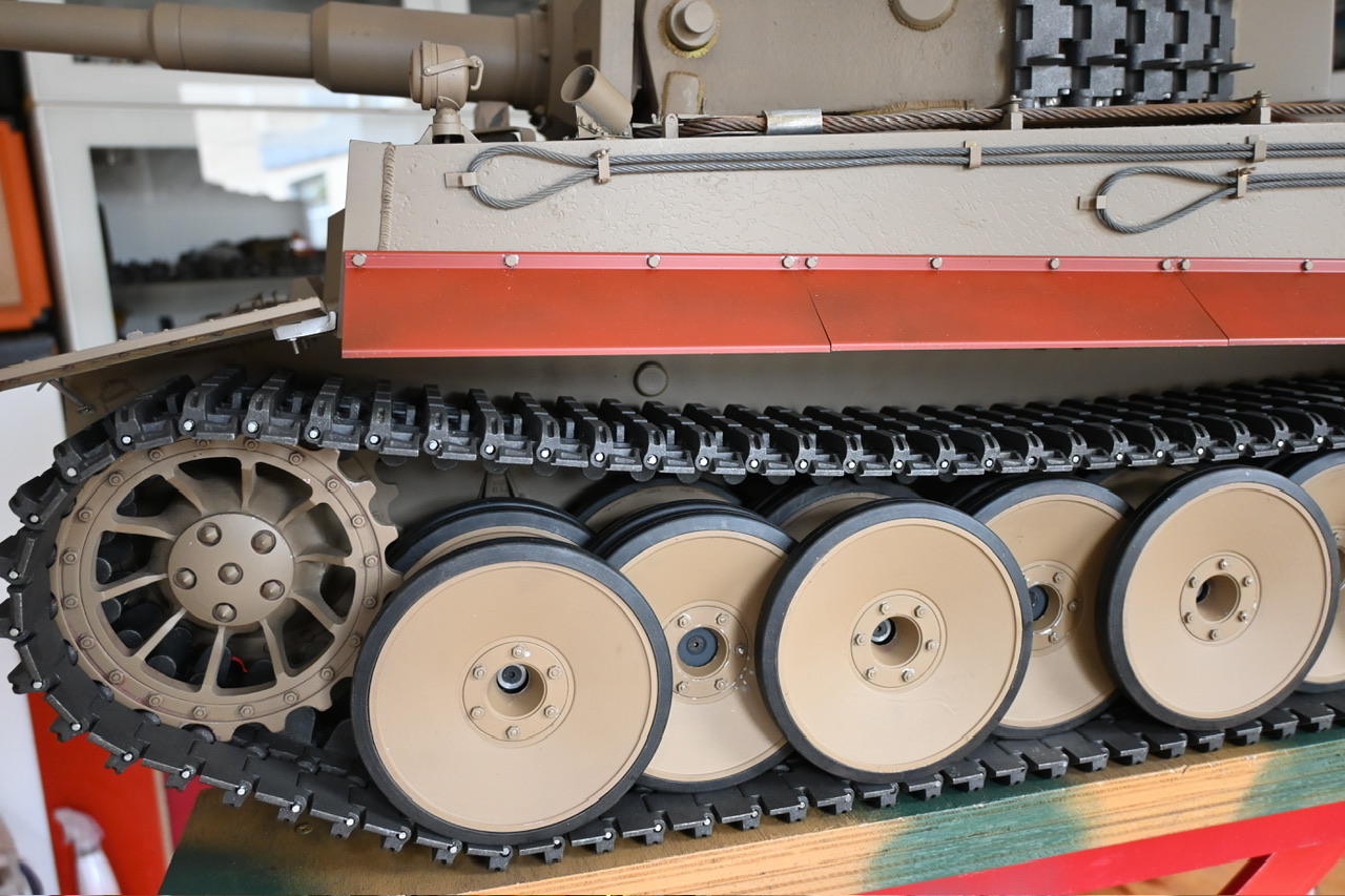

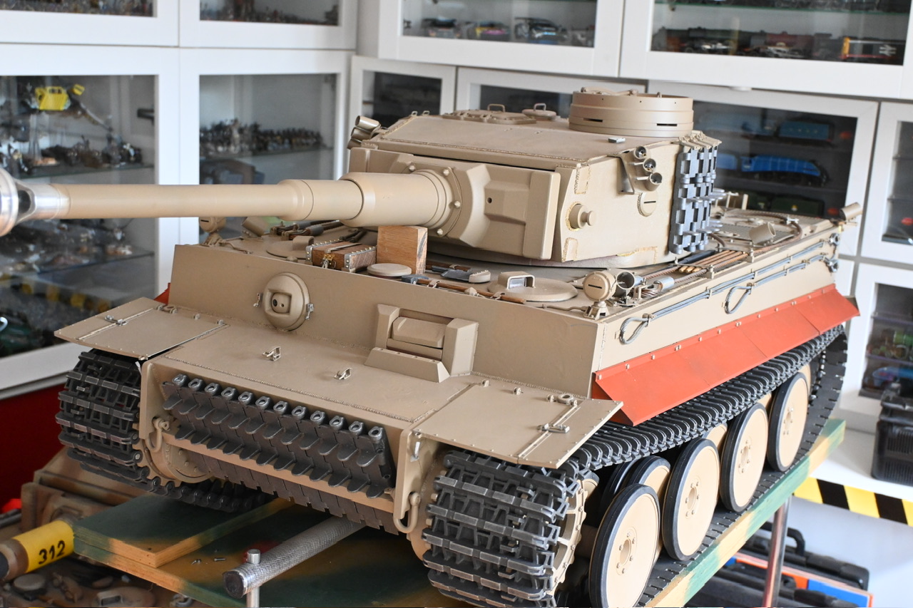

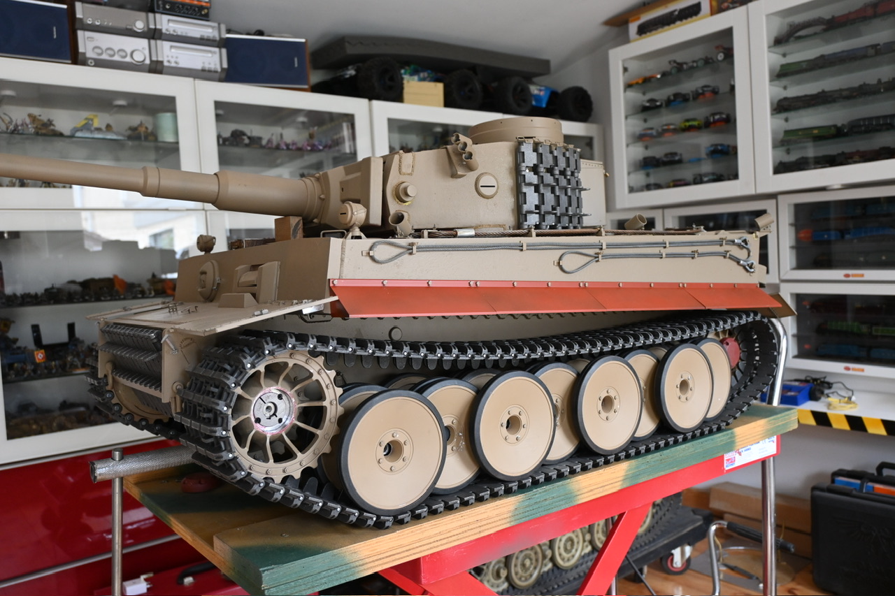

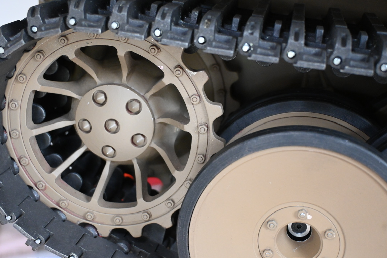

Trial fit of wheels and track. This was to make sure I have everything needed to fit wheels and track. I have wrong size grub screws for taper bores on sprockets so need these. Also m6 spring washers for road wheel spacers.
