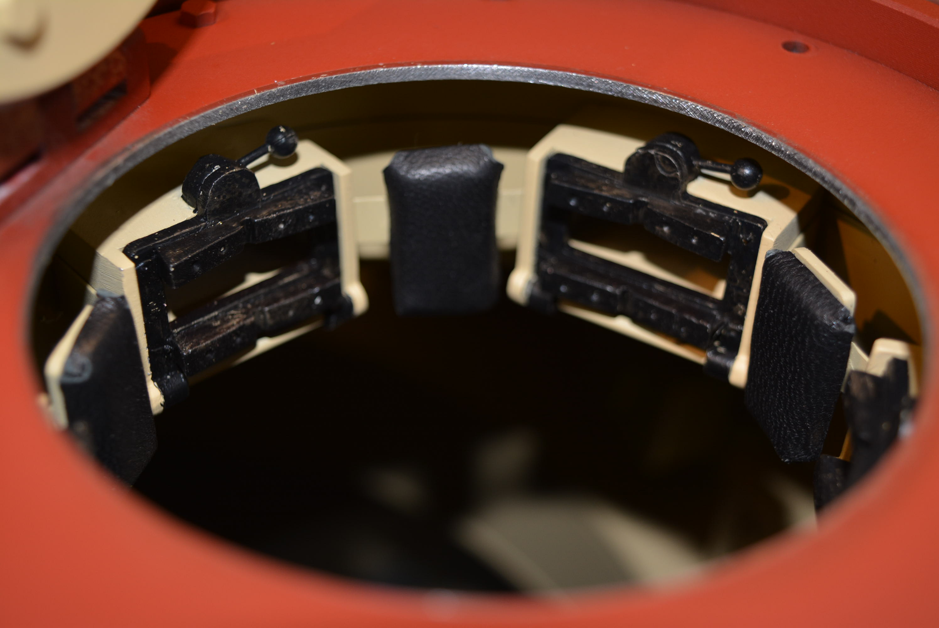

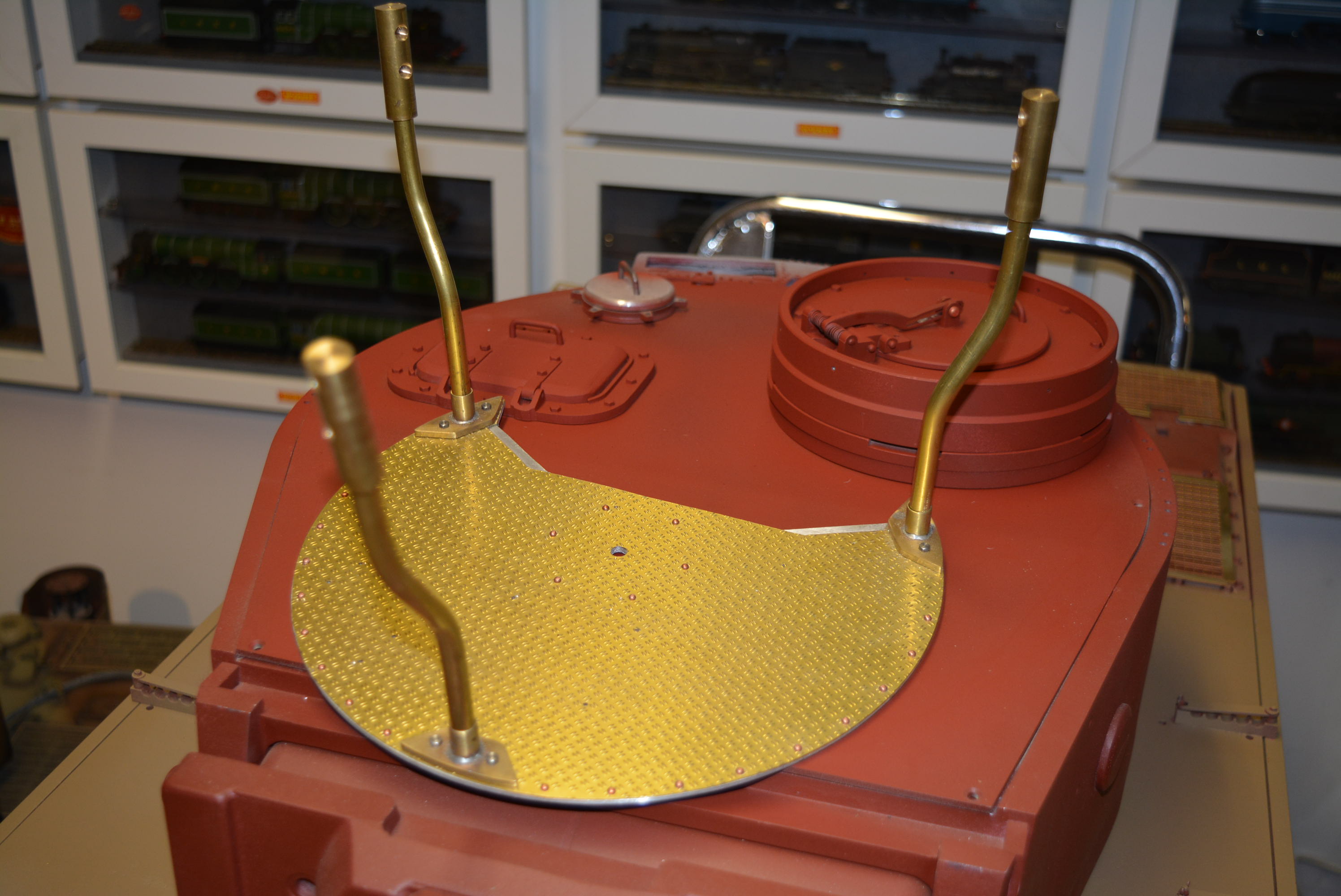

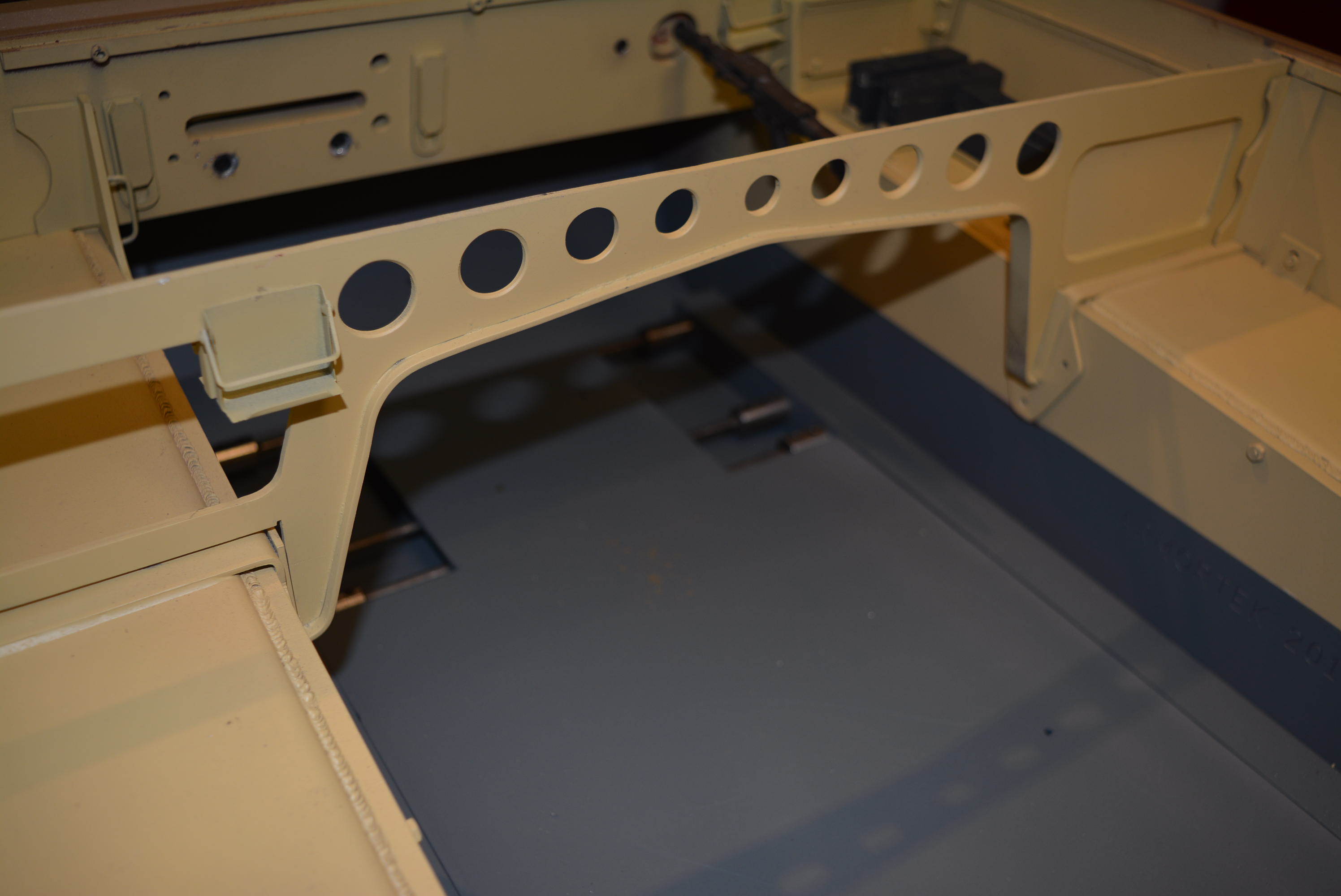

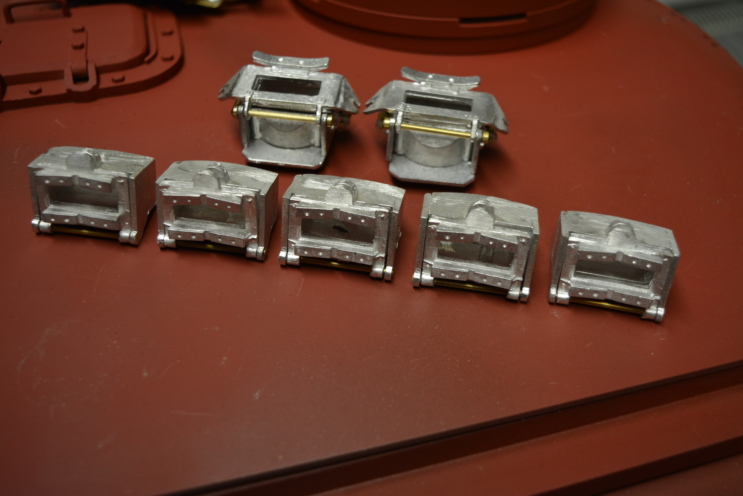

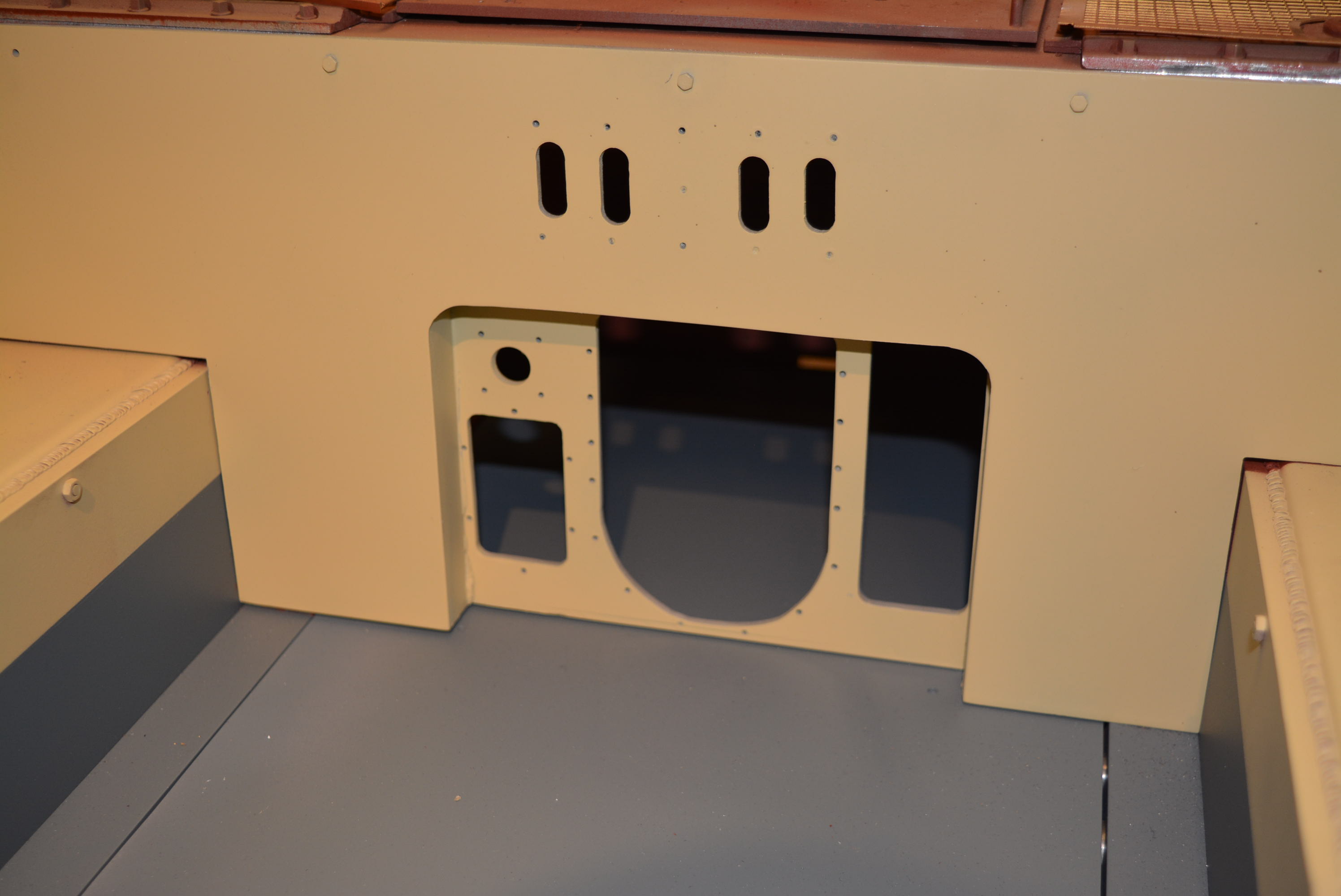

I have moved on a bit with the early Tiger. Still missing some parts but new lathe and milling machine will help sort that problem.
Started on a turret floor. Need to order more tread plate. Rear mudguards almost ready Cupola and turret view ports ready to fit. fitted. New aluminium firewall and front deck supports added. Full length floor added.

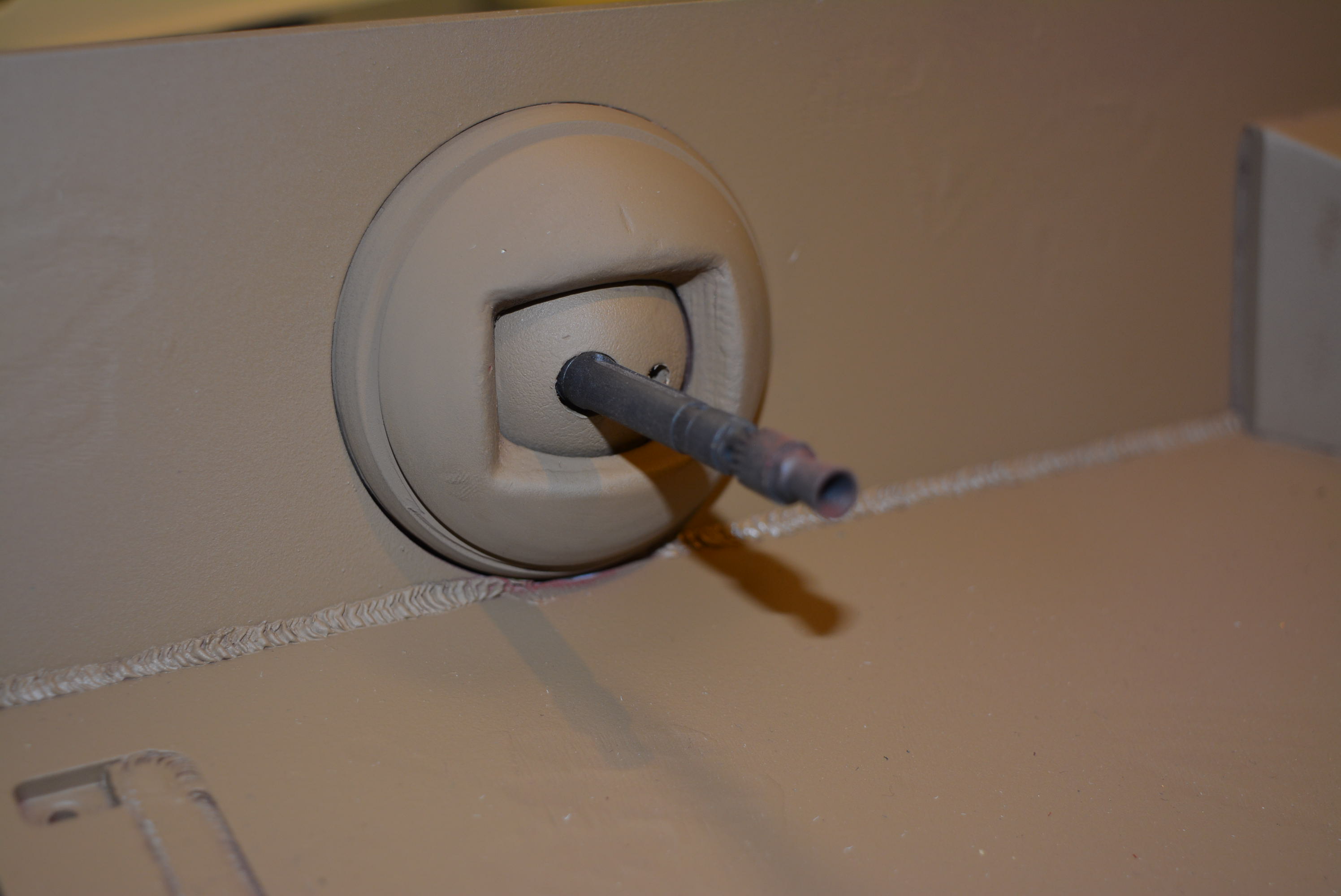

Mg mount is the old white metal version. It lacked the ring I believe holds the mg cover. I thought I would easily cut it on the lathe but when fitted in the chuck it was very irregular. Centred with 4 jaw chuck and got there in the end.

As you see in earlier photos of turret floor I used some brass tread plate which I found on a German shopping site. Unfortunately I forfot the name of the site. Anybody know name of Supplier for treadplate?

- Chang

Re: John's Early Tiger 1
Hi John,
Like your added full length floor. What is the dimension & thickness? Aluminium? Thanks in advance.
- Posts: 1798
- Has liked: 5 times
- Been liked: 565 times
Hi Chang. I don’t have access to get measurements at the moment as away from home for a few weeks. Thickness is 4mm. Just space left for motors and idlers.
