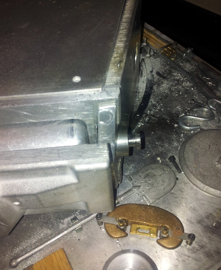

I had the turret complete, and like you had to do copious amount of filling.
But the gun didn’t elevate smoothly, it was grinding and was at a slight angle.
Others prolly wouldn’t notice but it annoyed me. So i stripped it down and noticed that one side had a slight twist in the wall at the front. The top lug that traps the gun elevation frame in place was not aligned to the bottom lug.
Now i have twisted it back with the tensioner the gun elevates perfectly. Just got to run a M4 bolt through to hold it in place.

Re: No 012 - Bedroom Build
Hi Bob
Is that the extra Pin in the front that you used to line things up,
in your second picture?

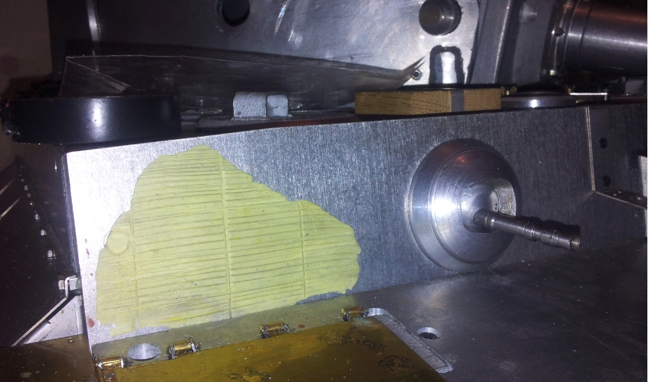

Could be an idea to scuff up the metal where you are doing your zimm just to give it something to hold onto.
Cheers Paul
Cheers Paul
Hi John why don't you let us al know how to scuffing the metal.
Thanks William
Thanks William
Hello William.
Its no great secret I have put it on the forum somewhere I always use an old modelling knife and simply cross hatch the suface to be zimmed or a coarse grade oxide paper will do the same job, just to give the milliput a key to get hold of.
Hope this helps mate if not just give mea shout always happy to help.
Cheers Paul.
Cheers Paul.
I imagine this would help with all zimmerit applications and not just milliput.
Phil. Yes that's one of the pin after filling with insta metal. I pinned 3 of the four lugs. The turret roof sits much neater now and the elevation is smooth. But more importantly the gun sits straight.

Paul, John. Many thanks for the help and advice for Zimmerite'ing. Have ordered miliput x 10 then im going for it.

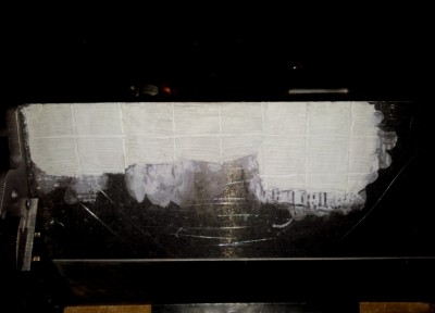

Applying Zimmerite (milliput) SUCKS!!
and there's so much of it to do!
