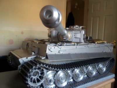

I know its not all that to the professional modellers out there but I’m not one of them. Hell you can see my washing in the background. This is my first tank model so i have tacked, glued and bolted stuff together just to see how it fits together before making it perminant. Tee jerry can holder is on a frame and will have a hinged bar at the front as i have seen on a historic picture.
When this is finished im going to strip it down and rebuild it in a workshop and paint it as i go.

How did you make that Jerry can rack mate?

Hi Mick
I used 2 lengths of 9.5mm aluminium angle cut to about 5mm shorter than can size. then 1 lenght slightly bigger than 3 can widths.
Then 2 lengths of 10mm flat aluminium to make the frame, one either side of the angle and bent another length of aluminium angle round as the surround.
I filed down the bolts on the reverse side to the same thickness as the flat aluminium (about 1.5mm) for a stand-off. I have just glued it together for size but will bolt it down once i have the shape right (as you can see the surround is a bit skew wiff). I will use a pin sticking out from the hull with split pin for the surround ends so it can be taken off
I had seen a similar system on some historic photos. The cans sit on the angle and are held by the surround strap. Simple but does the job

Those stains on the exhaust is my blood! Now thats hard core moddelling for ya DOH!

Hello Bob,
I have a question for you, is that a fuel pump on the back of your tiger?
best regards Yves

Hyves
No thats a breech from an unrelated model

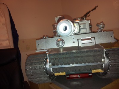

Progress but it now needs to be moved to garage

one of JF very fine mudguards on

Welldone Bob,
Your Tiger looks great.
Have you got to take it back to bits now or have you got a secret way down to
your garage :)
Phil

Thanks Phil
I'm moving to a house with a workshop in the next few weeks. So i will dismantle it totally, paint it, then rebuild. I just couldnt have an armortek kit sitting here in the flat here without building it, too impatient. :D
