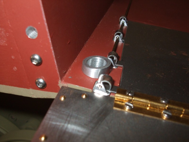

I am redoing the front mudguard slidebars but had to stop work on them as I need to receive some 2mm wingnuts I have on order before I can continue.

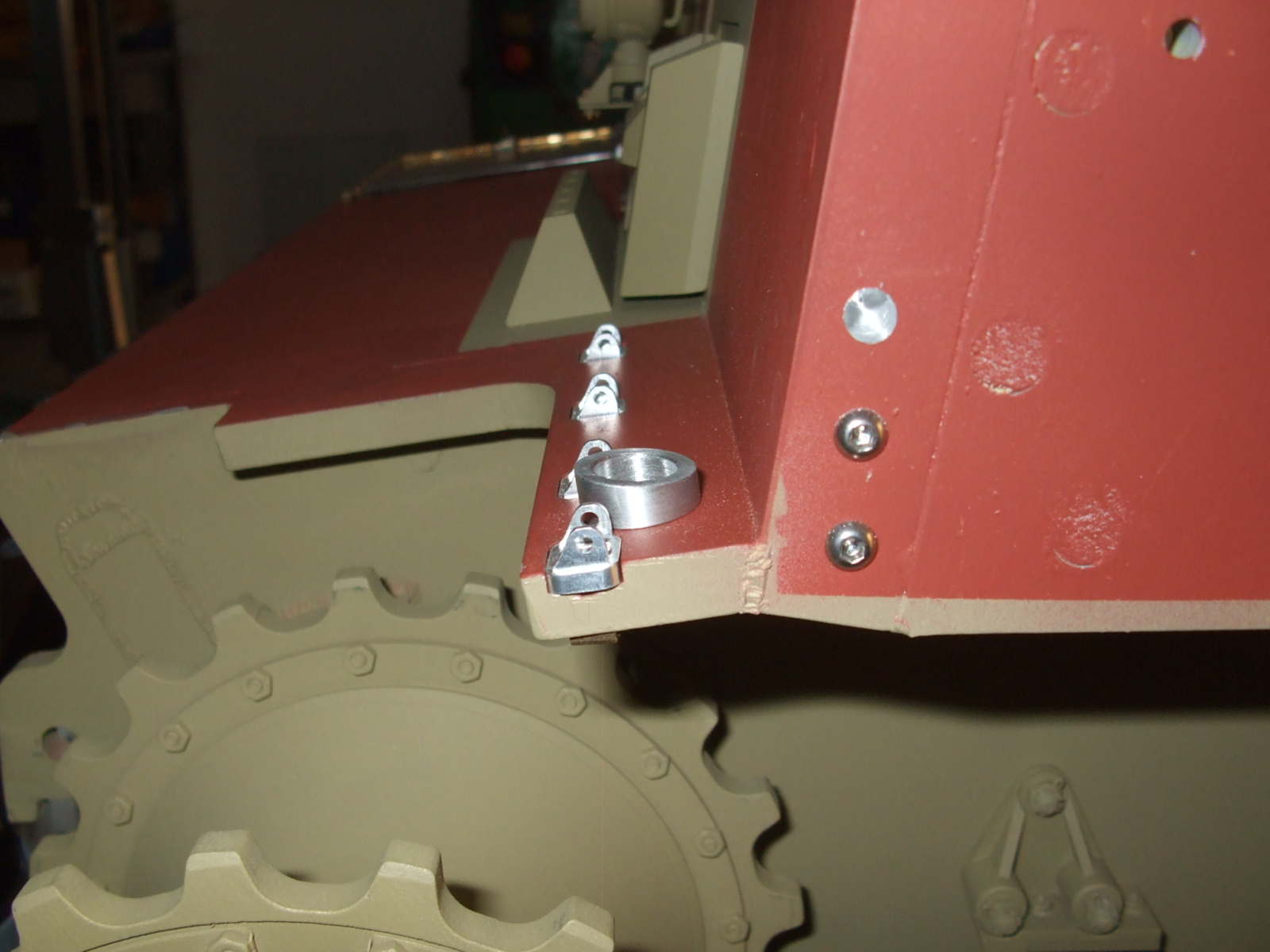

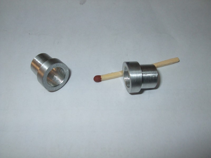

So, to pass the time, I worked on the front plate boss (CE0641). For various reasons I had already decided to remake them from scratch and give them the through hole and the correct angled top face.

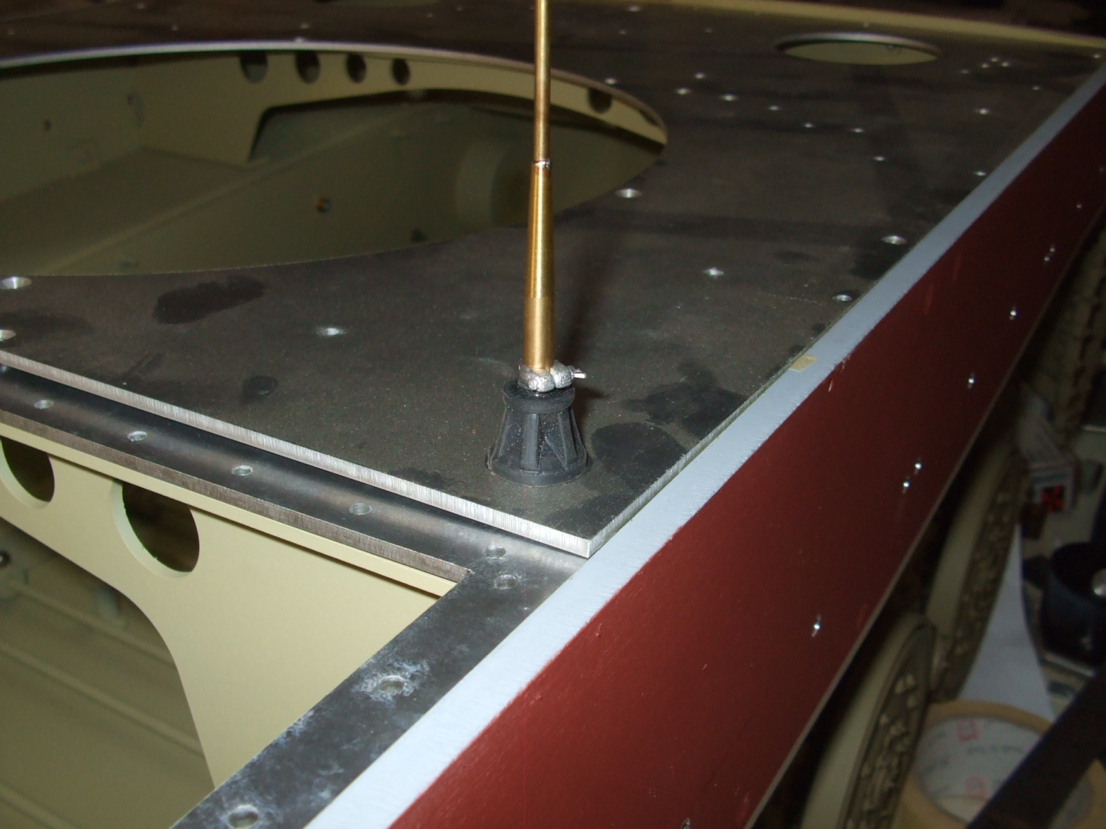

Also today I received Mark's tapered stab antenna. Very well made and excellent packing. Thanks Mark. Just for fun I did a trial fit of the antenna (and Armorpax clamp) to Liam's rubber base and bolted to the hull roof.

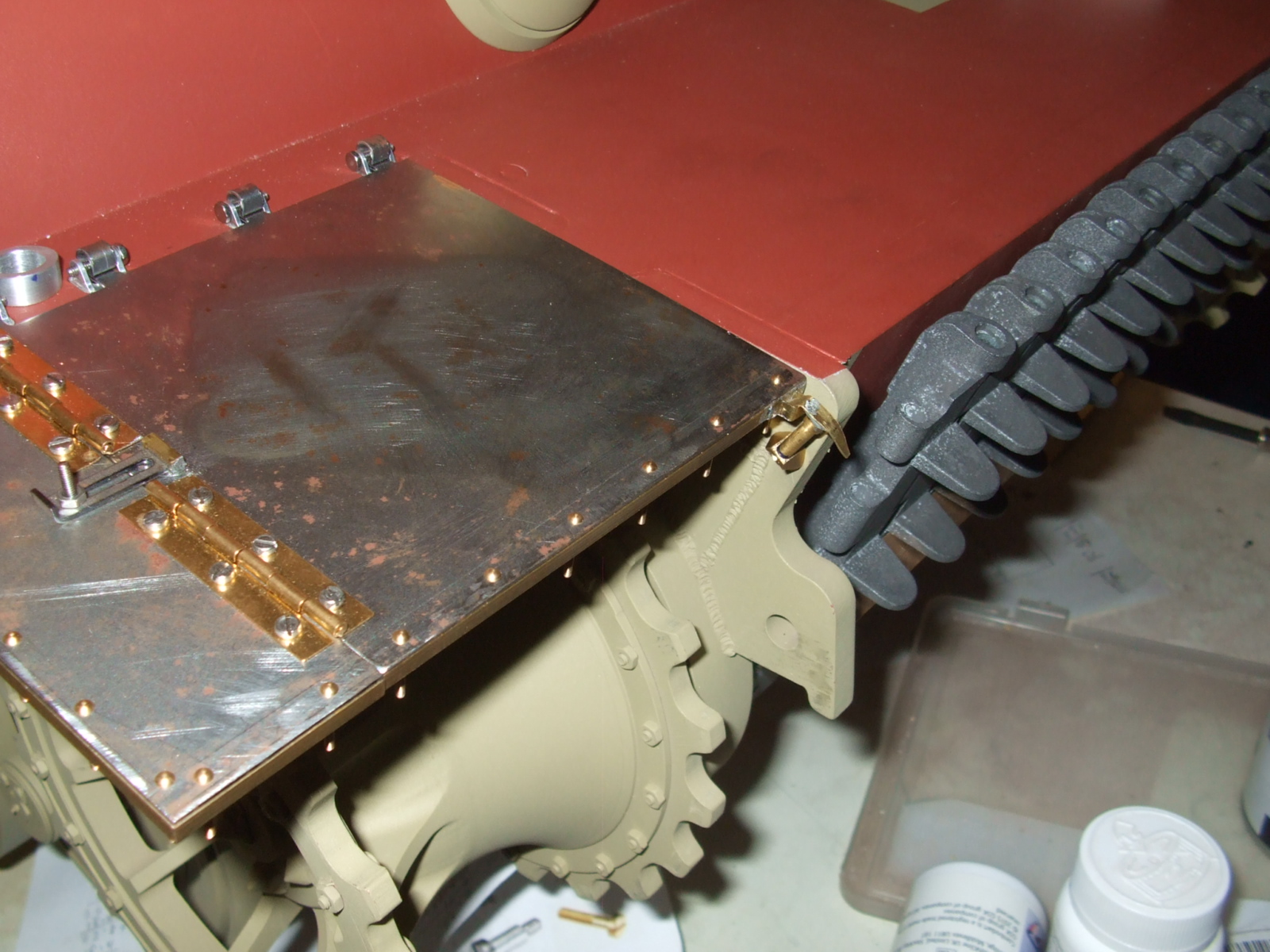

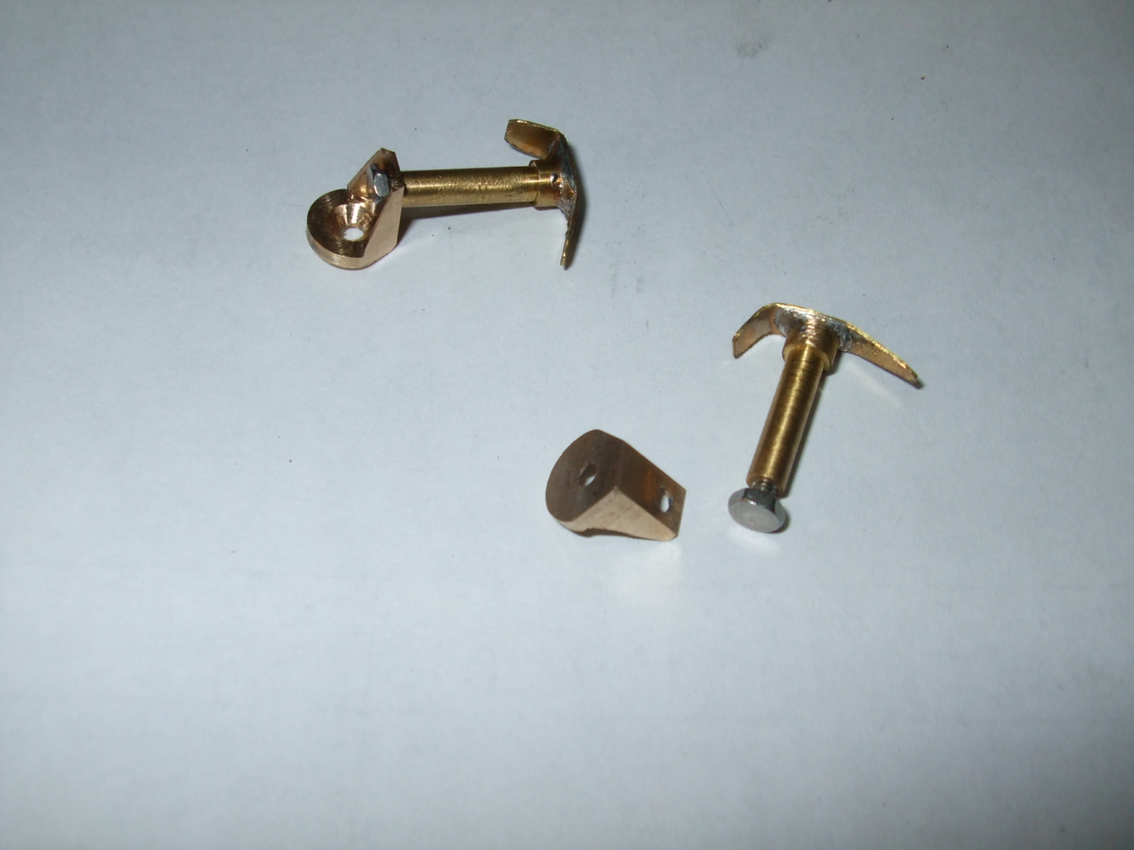

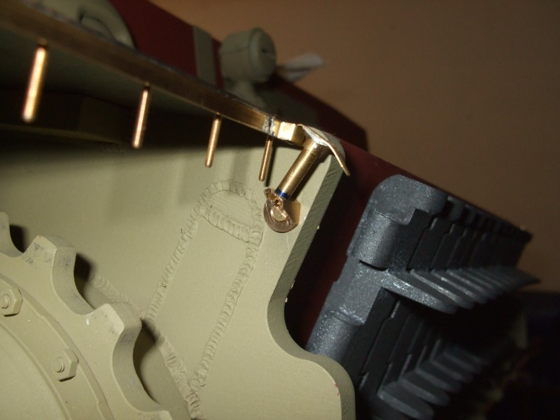

Still waiting for the wingnuts! So I can't finish off the front mudguards. So last weekend I thought I would attempt (emphasis on the attempt) making the hold down latches of the front mudguards from scratch. As a reference I am using the drawing on page 35 of the modeller's guide book. There are no dimensions on this drawing so it was all guesswork. Today I finished them.
And a temporary fit, holding the lower part with a tool to see how it looks.
The shaft has still to be shortened as I made it long on purpose. Now I need to decide if they are decent enough to add to the model.

the mudgaurd clamps look good vince, nice attempt, regards simon manning.

Thanks Simon. I suspect that the lower part of the catch (the part that is fixed to the side of the hull) is too big. What I might do is to actually attach them to the hull and see if my eyes get accustomed to them. I can always remove them and blank the 2mm tapped hole that it needs to be fixed to the hull.

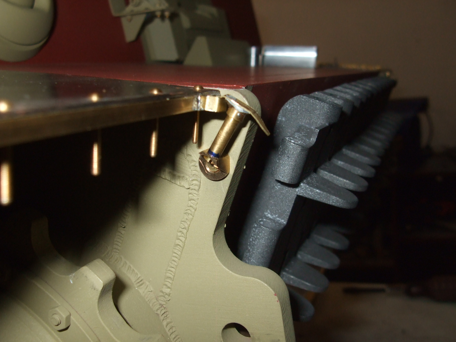

Finally plucked up the courage to drill and hand tap (in situ) a 2mm hole to attach the mudguard catch to the hull. I managed to do it with the aid of a machine tapping guide and the best part was that I did not need to remove the sprocket.
I will leave them fixed for now to see if they "look right". At the moment I have a feeling they look a bit "chunky".
