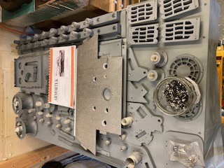

Brand new rear plate- many thanks Armortek
Rest of the hull now etch primed and zinc primed. I’m aiming to prime every part prior to assembly.
We shall see!!
We shall see!!

That's good news.Brand new rear plate- many thanks Armortek
Don't be surprised if some parts will not fit together after priming. Don't ask how I know. Been there and done that.I’m aiming to prime every part prior to assembly.
You might then need to selectively remove some of the primer.

Hi Michael . Nice to see you have the rear plate sorted . It's best to get the complete lower hull together , for the last time when you are happy with it ! You will never need to pull it apart again . Make sure all bolt holes are recess deep enough fill with car filler , what I did was use masking tape and tape a square around the hole close as possible this way when you spread the filler into the hole it will fill up to tape height this over fills the hole remove the tape early after applying the filler the idea of this is much less sanding and no need to go back and top up again . After this is done , do all the fake welds then from panniers down give another final prime coat then you have a finished hull ready to fit out just like the real tank in the factory ..
On page 5 and 6 of my King tiger blog shows what I mean . Also on page 15 you can see I didn't prime the upper hull until all hardware and small weld detail was complete Dale
