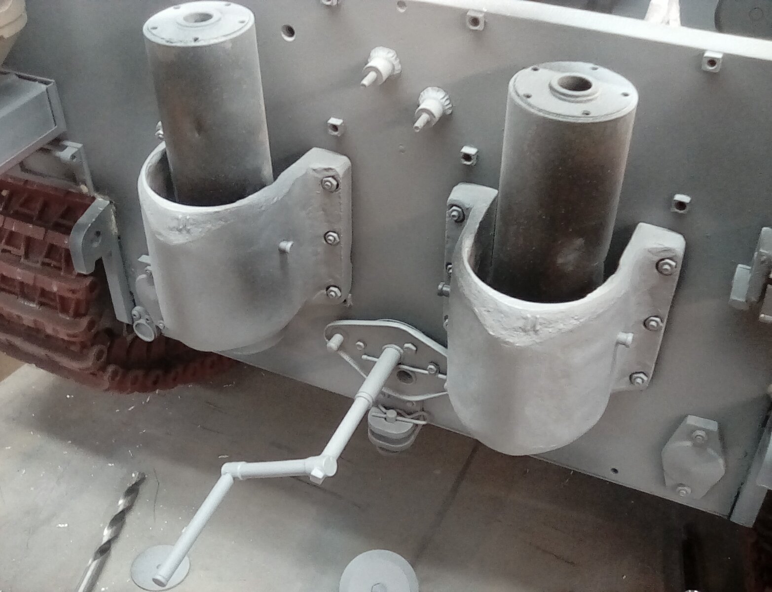

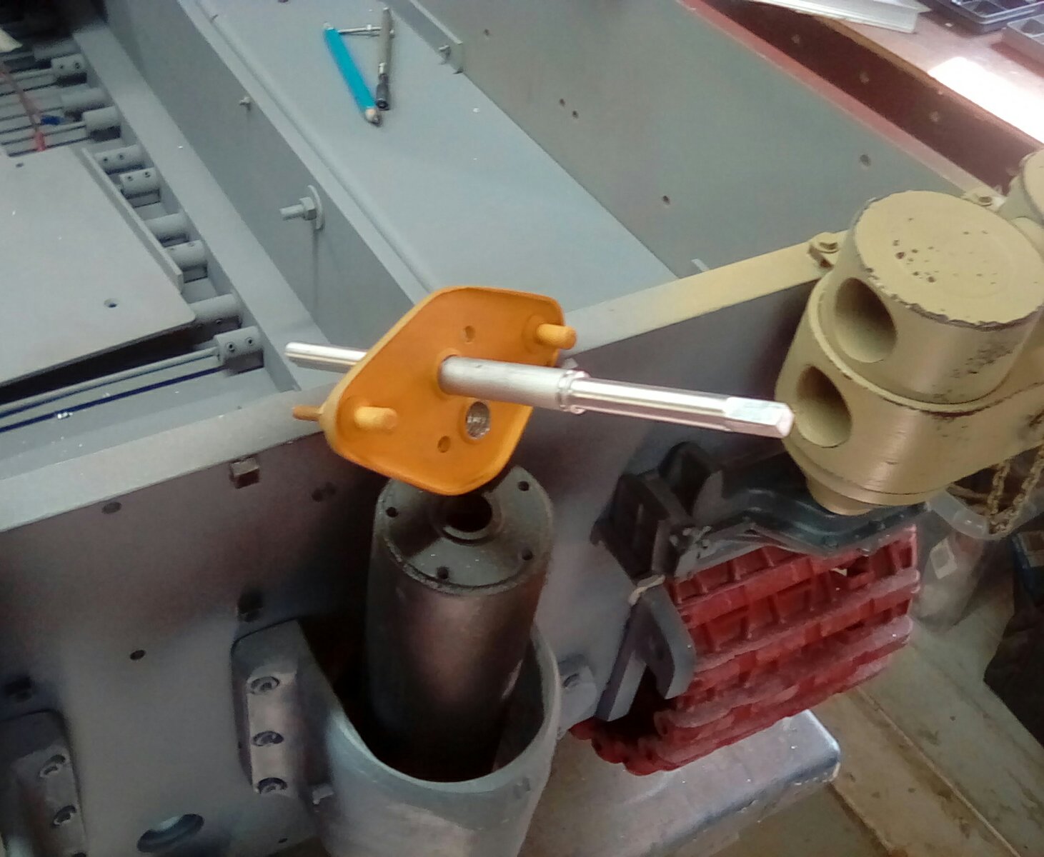

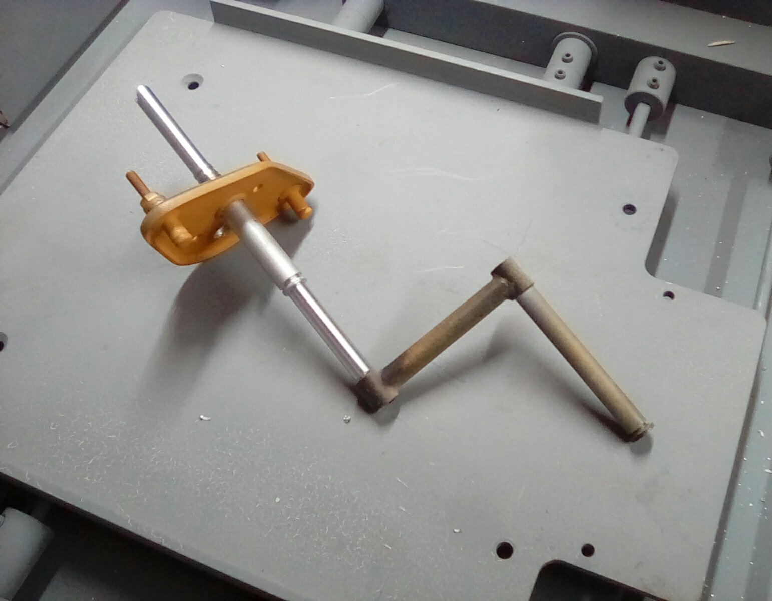

Still working on the rear plate details. 8)
I've turned an aluminum crank from stock bar.
I want this to be functional and part of a diorama.
I need to turn up the centre spigot that located the starter plate through the rear armour, now I'm going for the hl230 motor so which crank hole position do I use?

Re: Early or mid ? Tiger 1 build by Phil Woollard
Post by Christoffer Ahlfors »
The lower one, but if you want the crank to be left in, you will have to make the modification to the plate to make it horizontal, or you risk that every bypassing rivetcounter will embarrass you. :wink: :lol:
Page 40 of the Modeler's guide to the Tiger Tank gives a hint. For the HL230 (as I understand it), the hole closest to the edge of the starter plate is used for the starter shaft.
Thanks guys, reading up on the subject, when the hl230 was produced the manual crank starter engine dog coupler was slightly offset to the right compared to the hl210, hence the two threaded crank positions on the starter plate. The plate could then be used with whatever engine the Tiger had installed. I may need to enlarge the access hole in the rear plate.

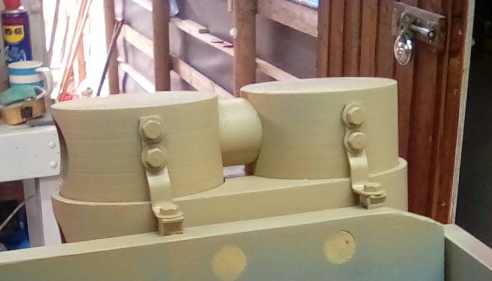

My plan when Hermes, the most useless carrier ever decide to deliver my parcel from Kees in NL is to fit the panther sounds card, my reason, I'm just not keen on the 131 recorded sound. I really don't think that the Tiger would have ever made that din, the aftermarket fan drive gearboxes certainly don't help. So I shall fit it record a video and we can all decide! 8) should be interesting.
Something else to consider to was the hull plate details as the early hull configuration was quite different once the newer hl230 p45 engine was fitted.
I think that's the starter plate and crank done 8)
I can't use the correct hole position just yet as hermes, the worst carrier ever, will not deliver my new large step drill.

Nice work. Now you just need to motorise it so Hans acts like the bloke on Camberwick Green :wink:

Not forgetting to nail his boots to the table first :lol:
Got to add, lovely engineering 8)
