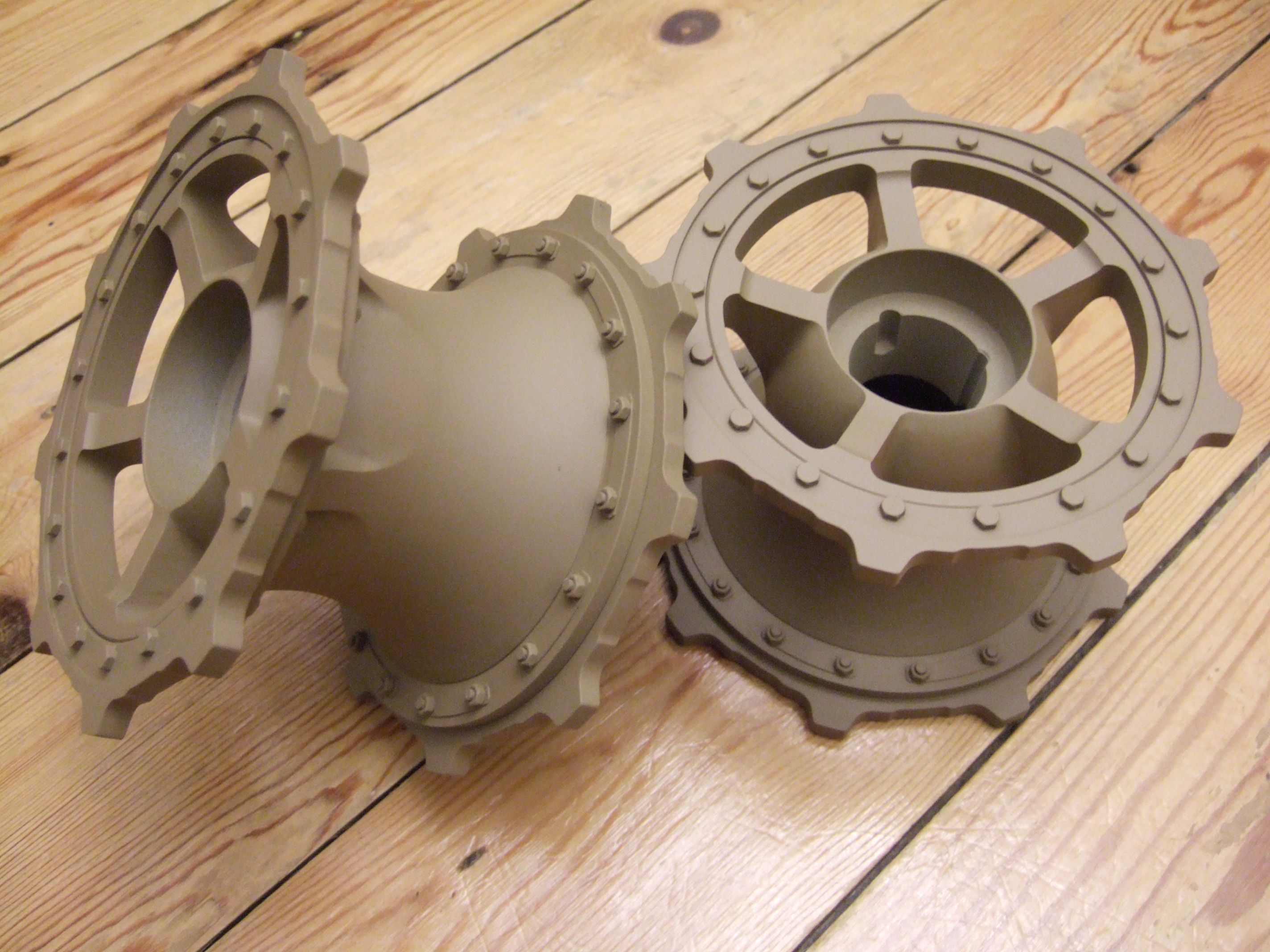

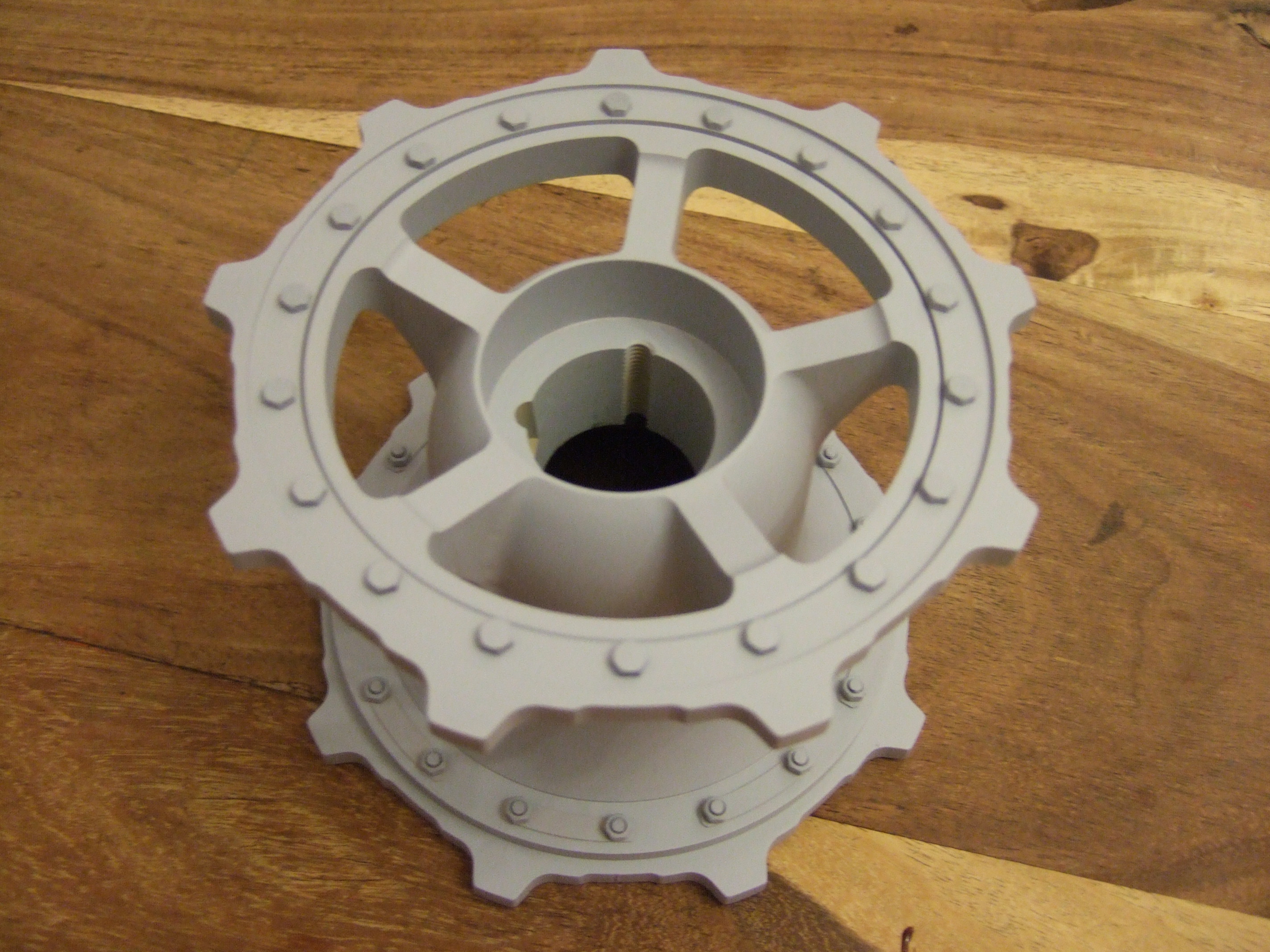

Re-think on sprockets:
Re-worked (was not happy with the way they where looking), the sprockets, had to strip them down and sand off the base coat and re-primed the hidden areas (Nut and bolt area).
Bought new 6BA Nuts and Bolts re-fitted sprocket rings so it replicates the real King Tiger.

Re: 2013 King Tiger
Hi Roger,
Hate to be picky but shouldn't the locking tabs be on the outside of the wheel rim.
Dennis.
Dennis.
- Posts: 1868
- Has liked: 6 times
- Been liked: 813 times
Re: 2013 King Tiger
Dennis is right. Also the nuts should face outwards rather than the boltheads.
Nuts and bolts wrong way round on the back also. There would have been locking tabs on the inner side also but kit only includes the set that could be seen. nuts face outwards both sides.
Excellent job removing those machining marks.

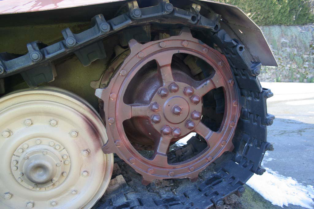

Re: 2013 King Tiger
Yep, the locking tabs go on the sprocket outside, as do the nuts. But Roger, you should probably get yourself a good photo of the wheels to follow along with. The bolts can run in opposite directions on those for the KT.,and you need to know which ones go which way. You can probably find some pictures right here on this site, in the KT thread.

In my eyes Roger has got it right.
The T2 sprocket had the sprocket ring bolts from the outside in with the lock bars at the inside.
The T1 sprocket had the sprocket ring bolts from the inside out with the lock bars at the outside.

Sprocket Detail
Many thank's for all your comment's here are some of the pic's below where i got my information.
Regards Roger
Regards Roger

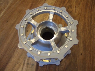

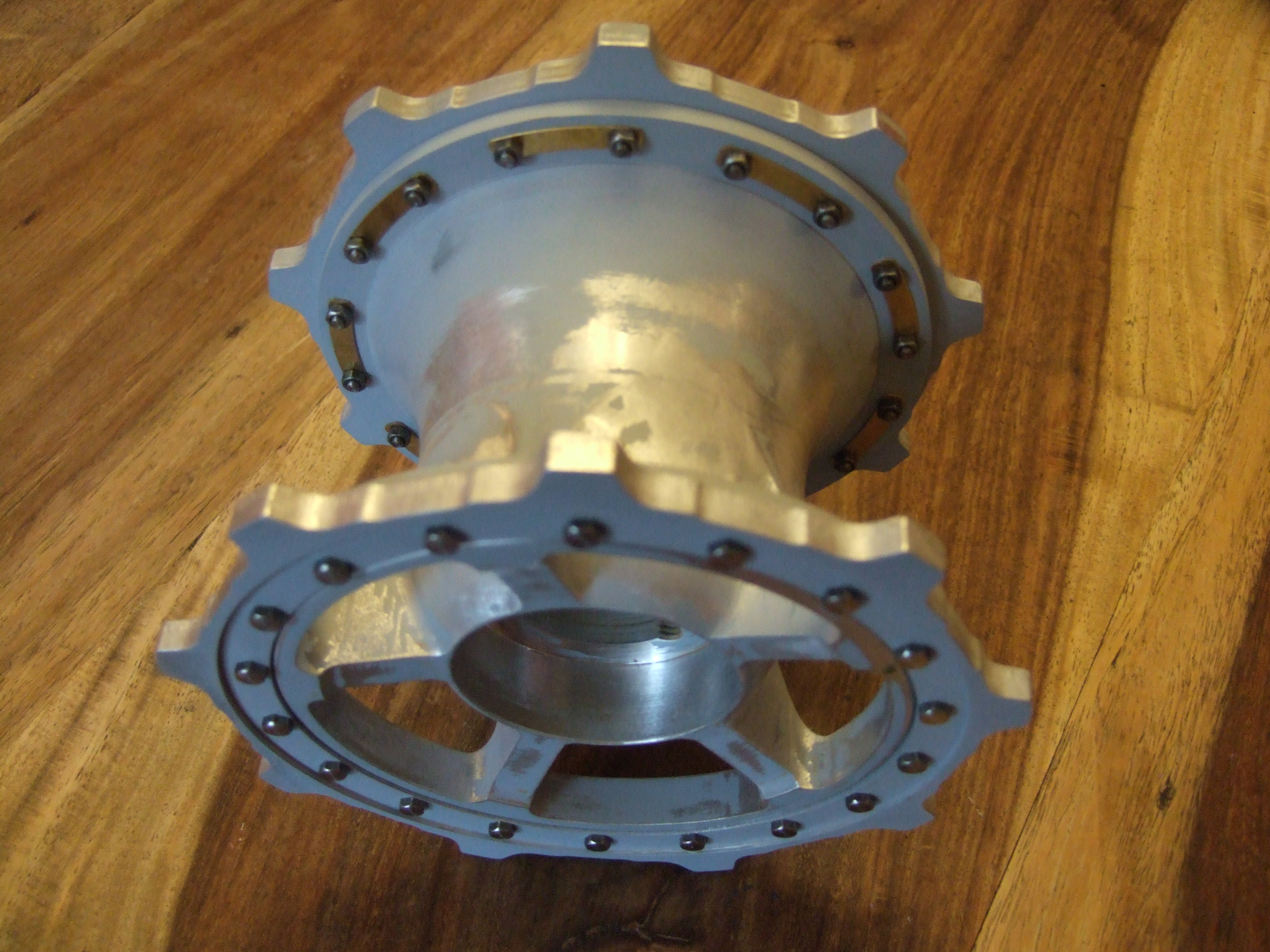

Re: 2013 King Tiger
Update on Drive Sprocket's
Nice to see these done again after my first attempt which was wrong.

Re: 2013 King Tiger
You're right. Looks like the tabs and nuts are the other way. But I know I've seen it done many times right here on this site that way. Good catch Roger. But you do have to be careful when looking at post-war vehicles. A lot of error creeps into them during all the years since. Parts being modified, replaced with make-shift components, some discarded all together; parts being re-installed the wrong way. You need look no further than the phoney paint-jobs many now have to know how much attention to detail was given them. It is tempting to want to use newer, color photos of them, especially given the poor quality and detail of war-time photos, but those really are "straight from the horses mouth" so to speak.
