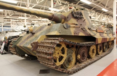

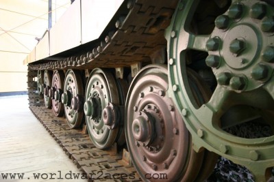

Sprocket Detail
Many thank's for all your comment's here are some of the pic's below where i got my information.
Regards Roger
Bovington King Tiger
Detail of sprocket's on the King Tiger La Gleize in Belgium
John Fitzsimons
Posts: 1872
Has liked: 6 times
Been liked: 832 times
Re: 2013 King Tiger
Post by John Fitzsimons »
I know you are working fast. Glad you did'nt change anything. A few other King Tigers might need to be changed though.
