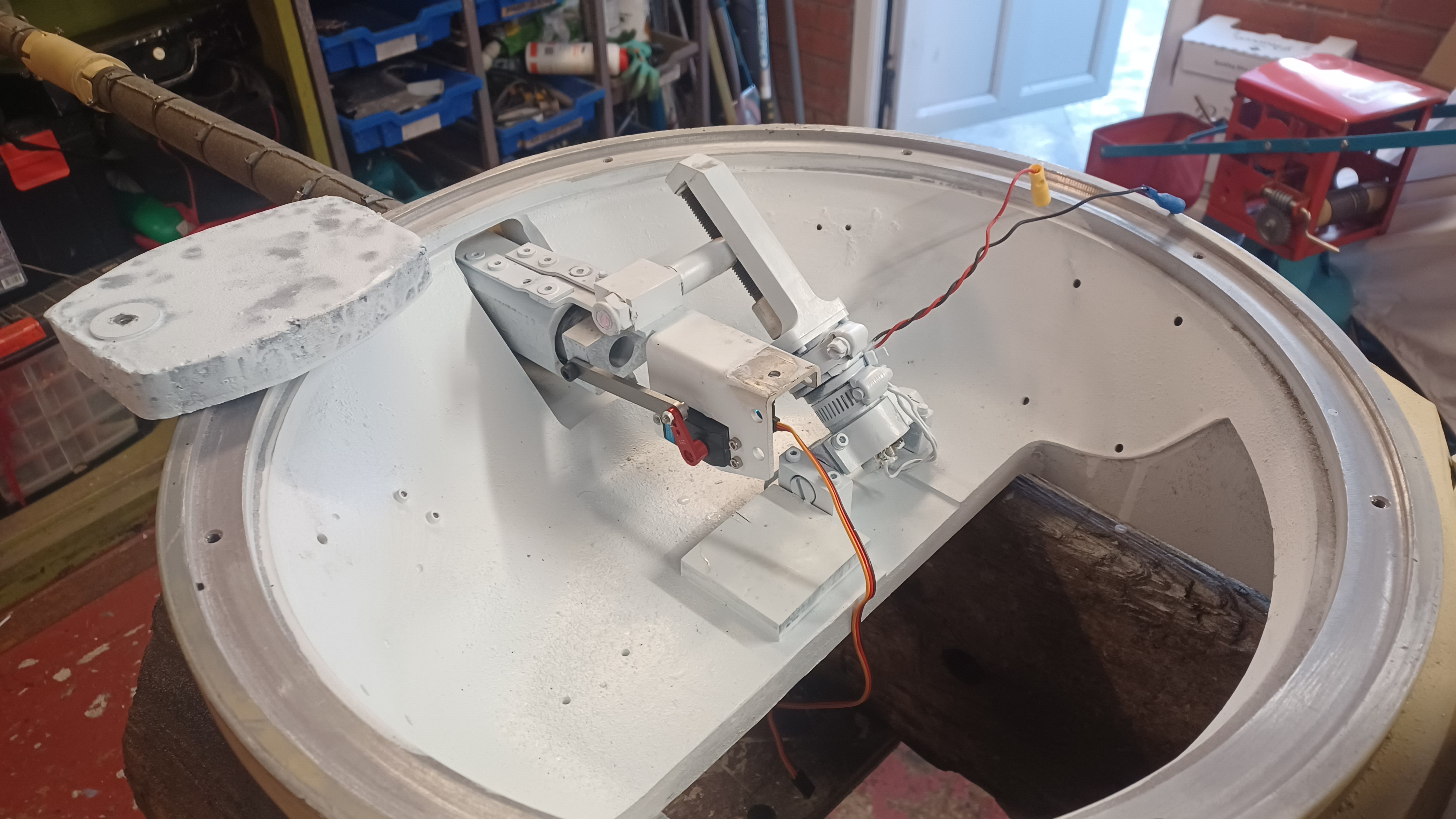

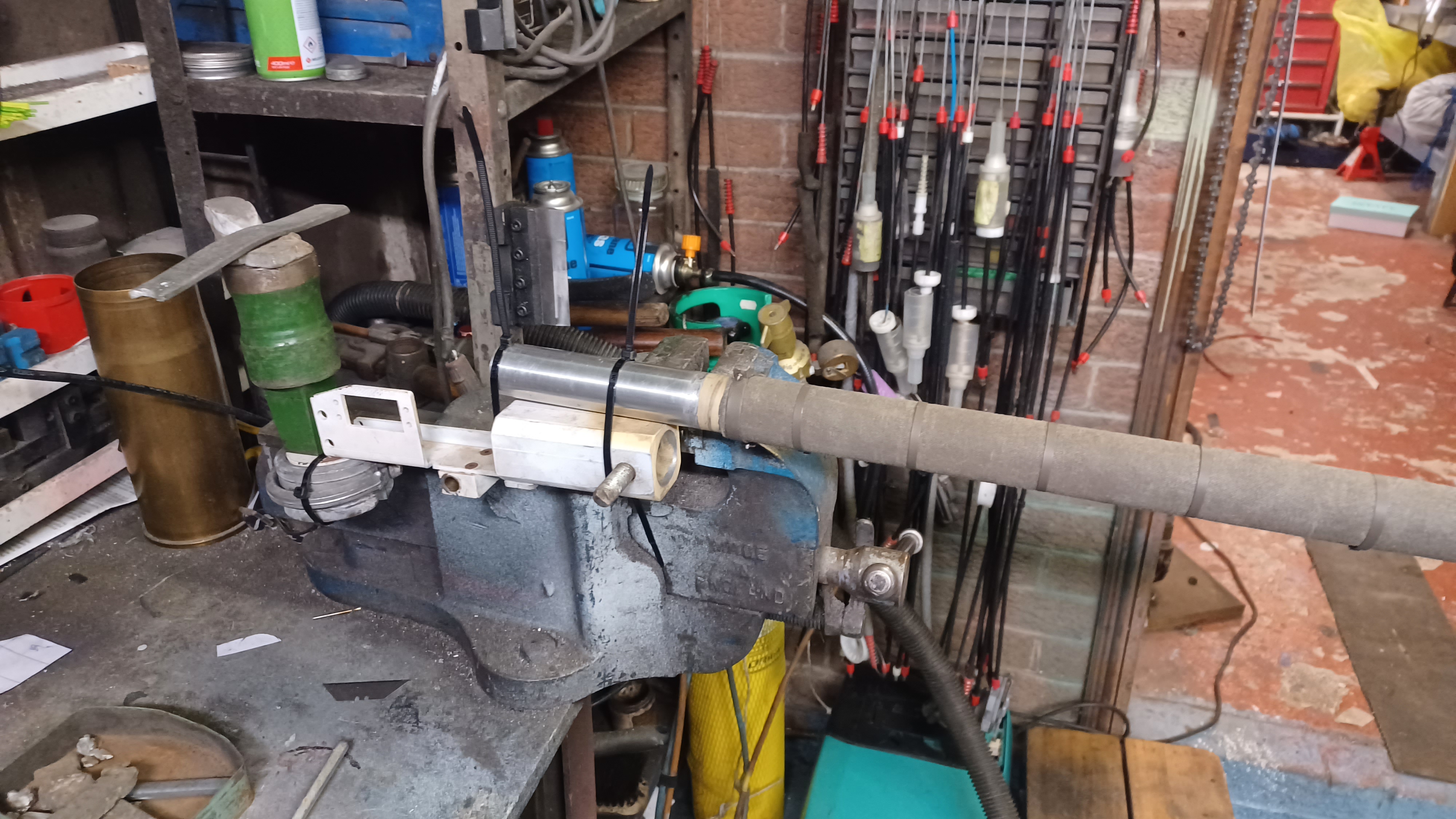

Clive, the linear bearing will probably damage the softer aluminum barrel, unless your going to rework the barrel.
You may find it works for a while, but the hardened ball bearings will cut groves into the barrel. If you were to machine the barrel and fit a steel sleeve you might find it lasts longer. Linear bearings are usually used on hardened shafts.
I've used sticky red grease which seems to serve the purpose, repositioning the servo improves the line of operation too, see my recent post.
Just a thought.

Thank you very much and very sound advice.I will see about getting the correct bush .
Every project seems to create another project. I will revisit your thread this evening.

Hi John I have now read your post and will be following some of your suggestions thank you , also going to experiment with some lead weights tomorrow and a couple of ideas around the screwdrive gun elevation system.

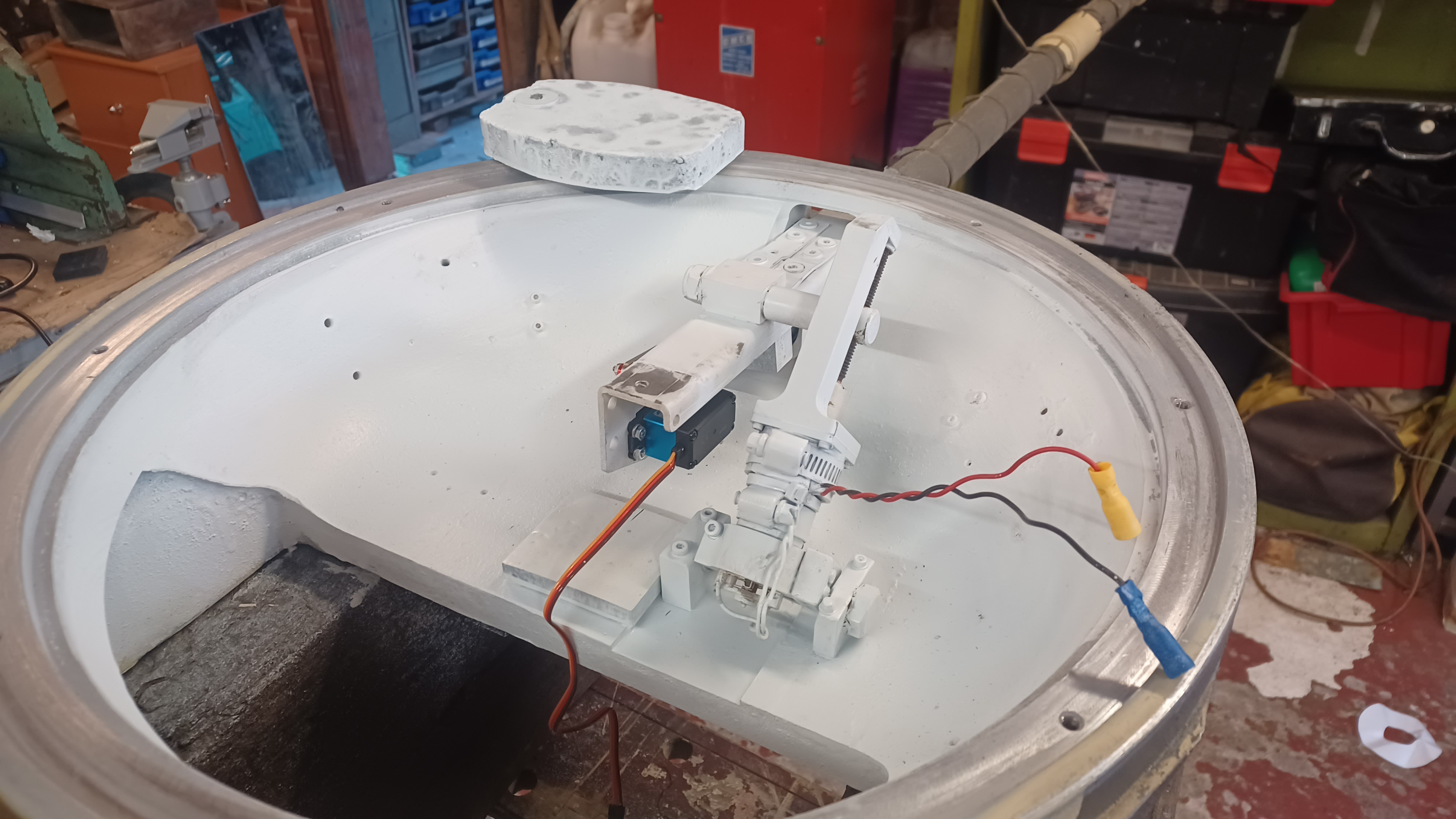

Following reading John's post about improving the barrel movement. I've carried out a non scientific experiment. To find the amount of weight for balance. I've never understood physics and maths very well but it worked.

- Posts: 1686
- Been liked: 1818 times
Re: Advice please 🙏
Don't forget wind resistance
And gold bars size wise are heavier than lead.

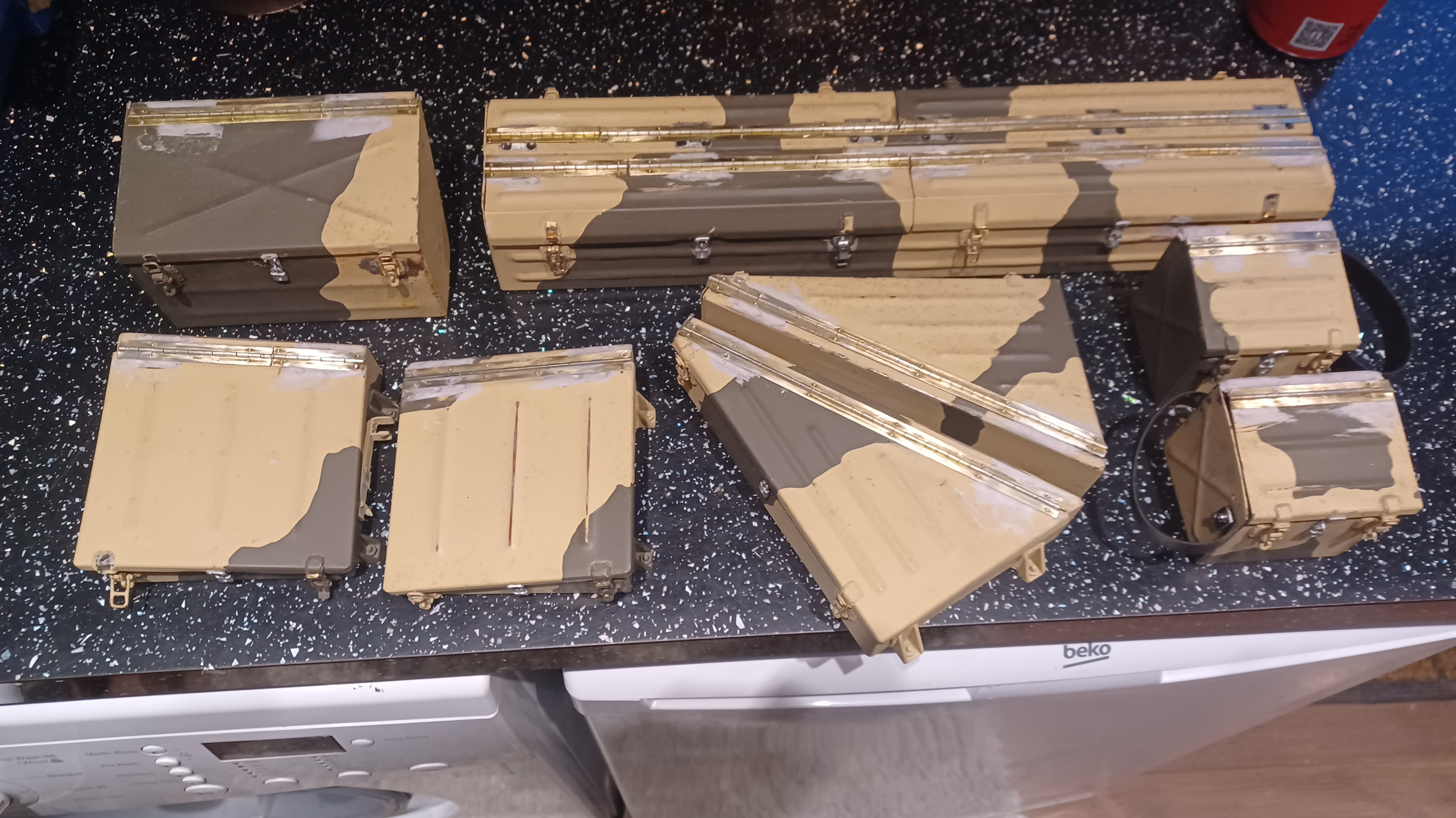

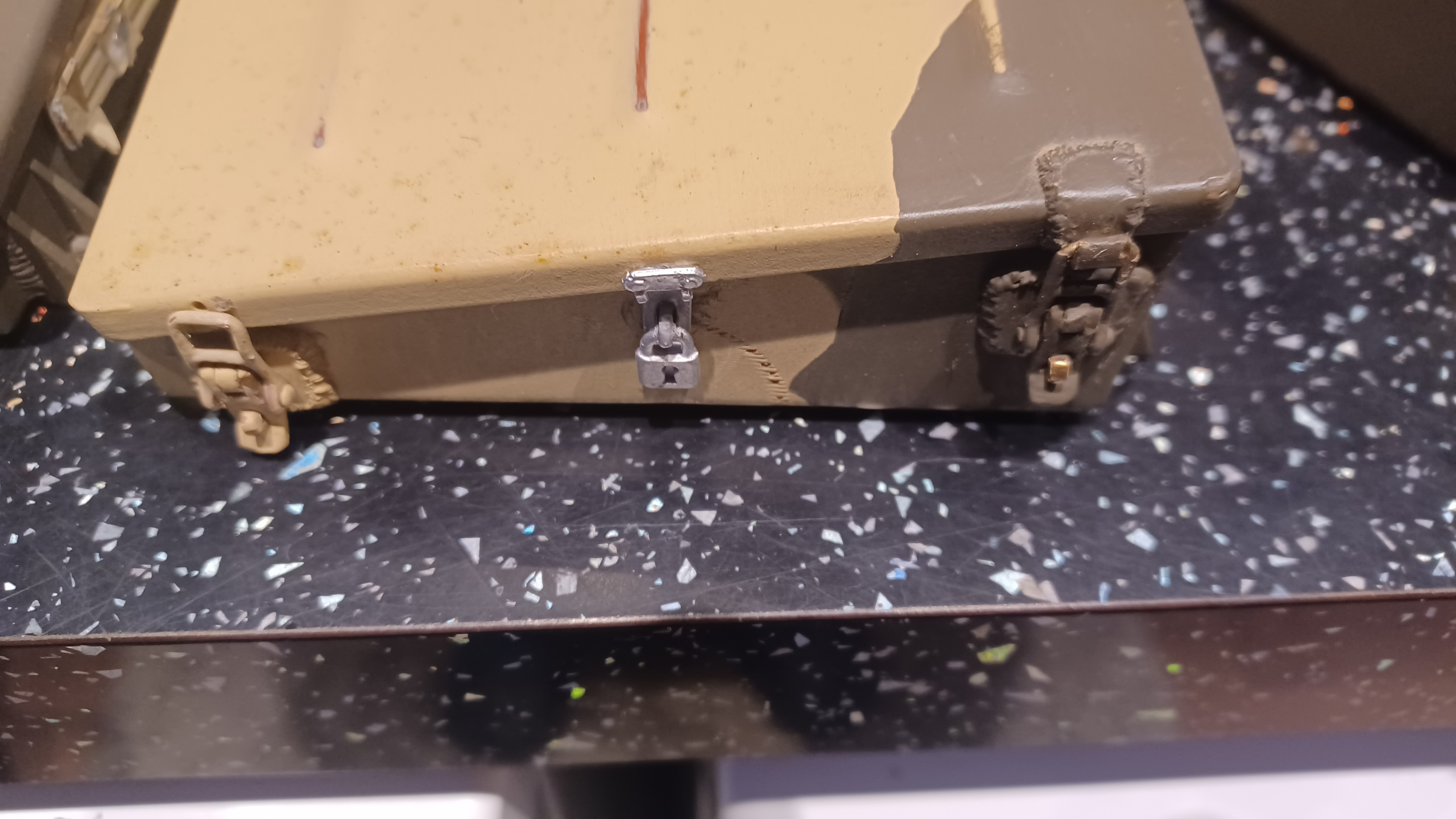

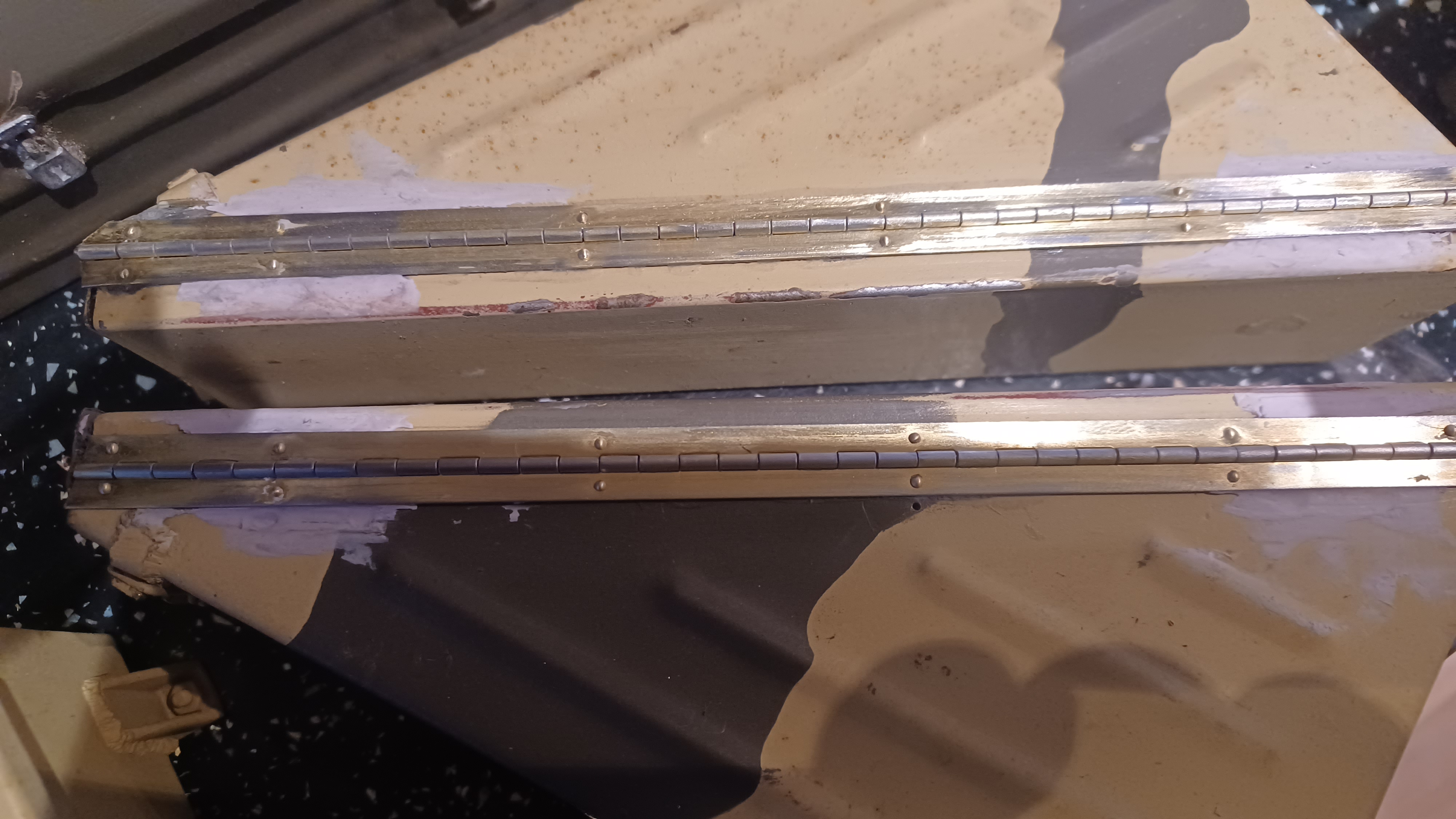

I have spent the week on and off removing the hinges from all the bins. Replacing with piano hinge.
Also fitted dummy hasp and staples with padlocks. Unfortunately I couldn't get the ones that you were lucky to get however please with the effect and there are going to be a lot of compromises on this build thanks for all the help so far .

I shouldn't worry too much about opening and closing the bins with piano hinges, Each time I open mine the paint chips on the hinge and I haven't been able stop it, so they'll rarely get opened from now on.
The piano hinge always looks good though.

I Am now happy with balancing the gun and removing any free play. I have shimmed the breach to take out the side to side movement it cannot be seen in the photographs sorry Added an additional support to the Electric elevation Motor I didn't like it being held on one side everything else has been adjusted. I'm considering moving the recoil to pull from the centre however it hasn't been tried yet so more on that later.
