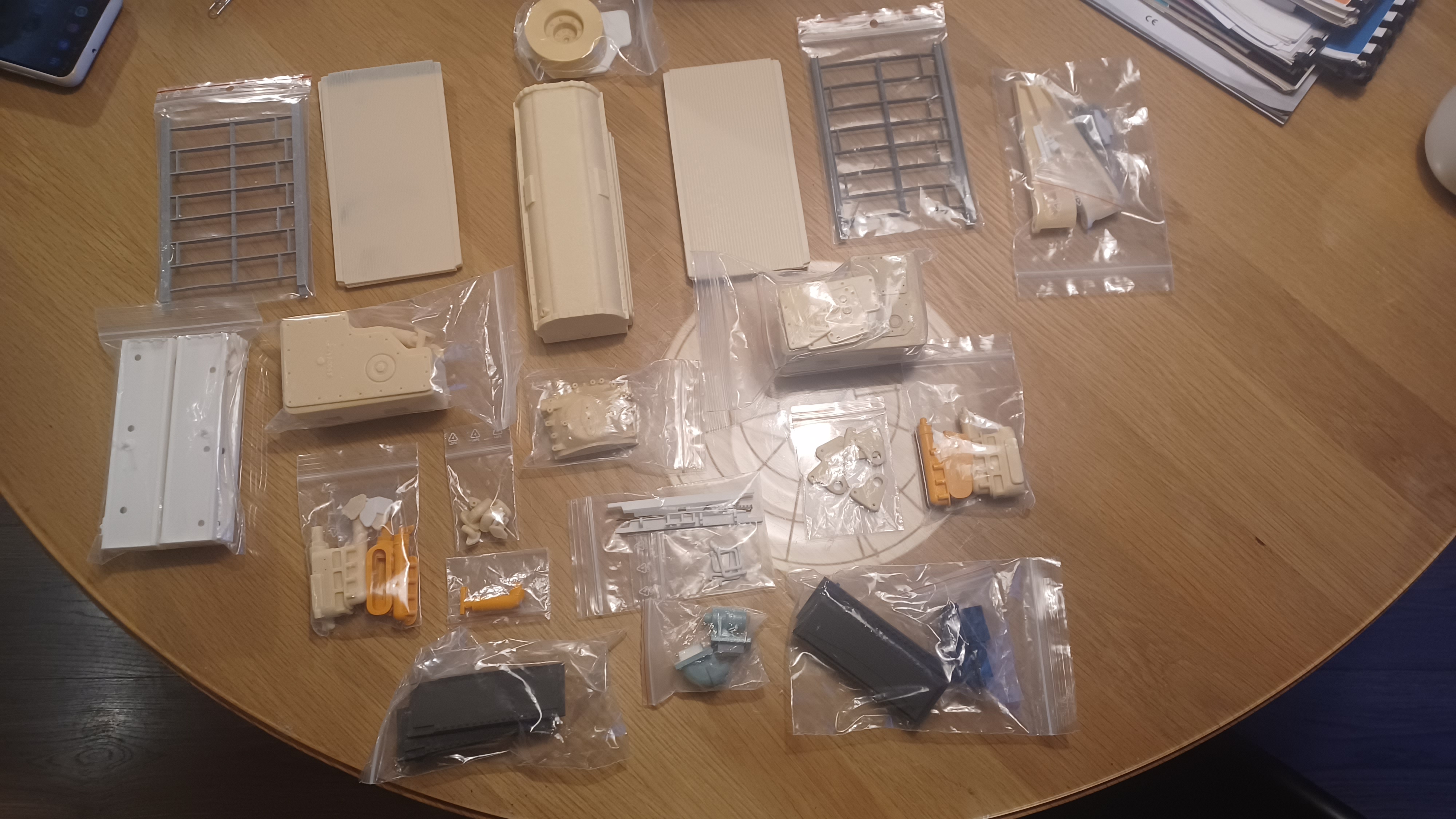

My Christmas present to myself has arrived I will be very grateful for some tips putting it together I really don't want to make any mistakes. Thanks in advance Clive

I haven't seen a basic build of the top end of the engine, but you won't go wrong looking at Phil Woodard's Chieftain build from around page 70. 8)
