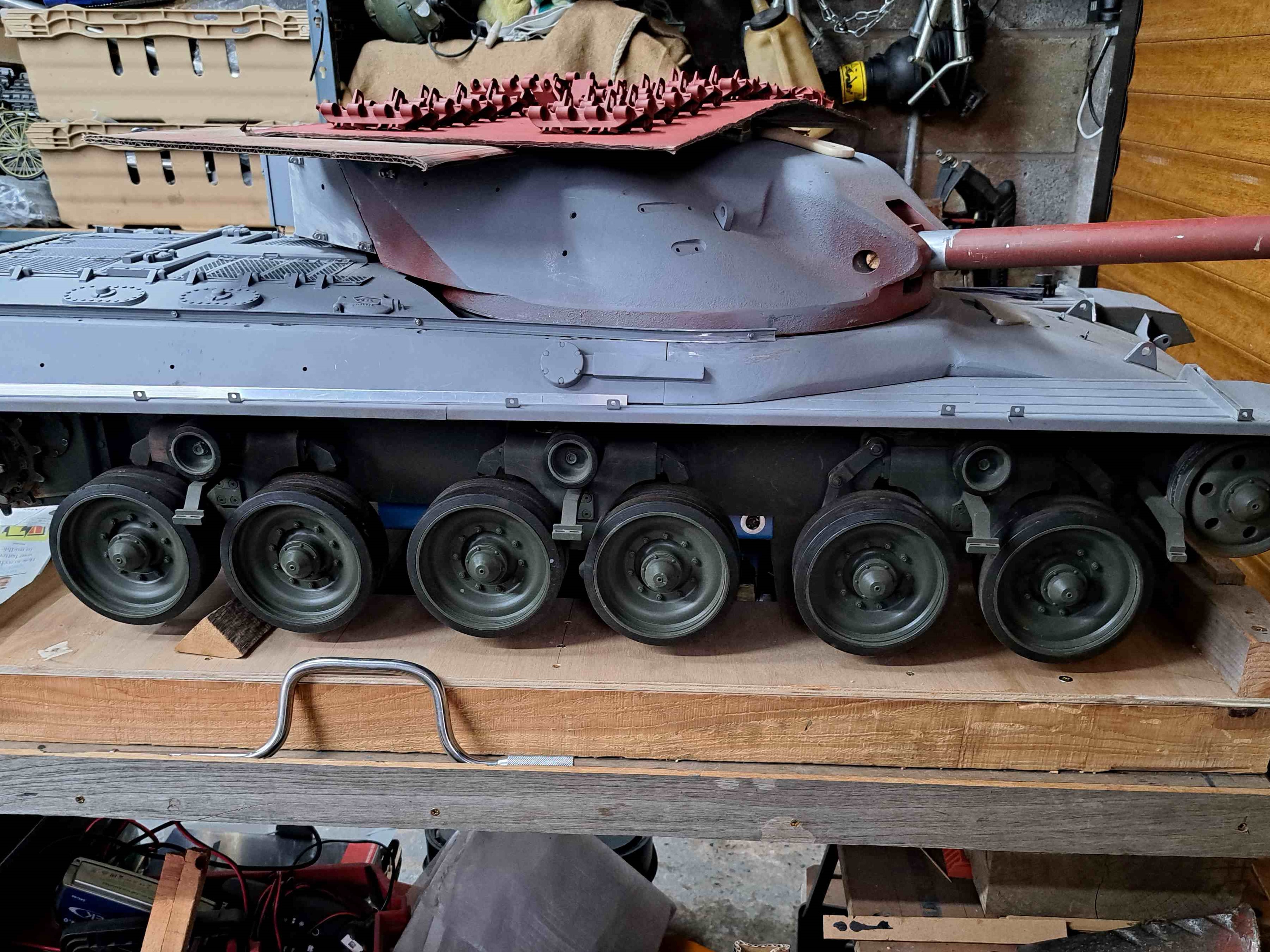

Evening all.
Hope this warm weather is incinerating/inspiring you folks as well as me. Worked from the garage this afternoon, ahh sanctuary(dosen't apply after November though).
Been away, very reassuring to note the RAF have left some aircraft in this country, counted five in one go :-? :shock:
I would like to think this almost pointless(but it is there) detail, once complete will inspire further scratch building around the panniers/bins.
Still rough, needs a tidy.

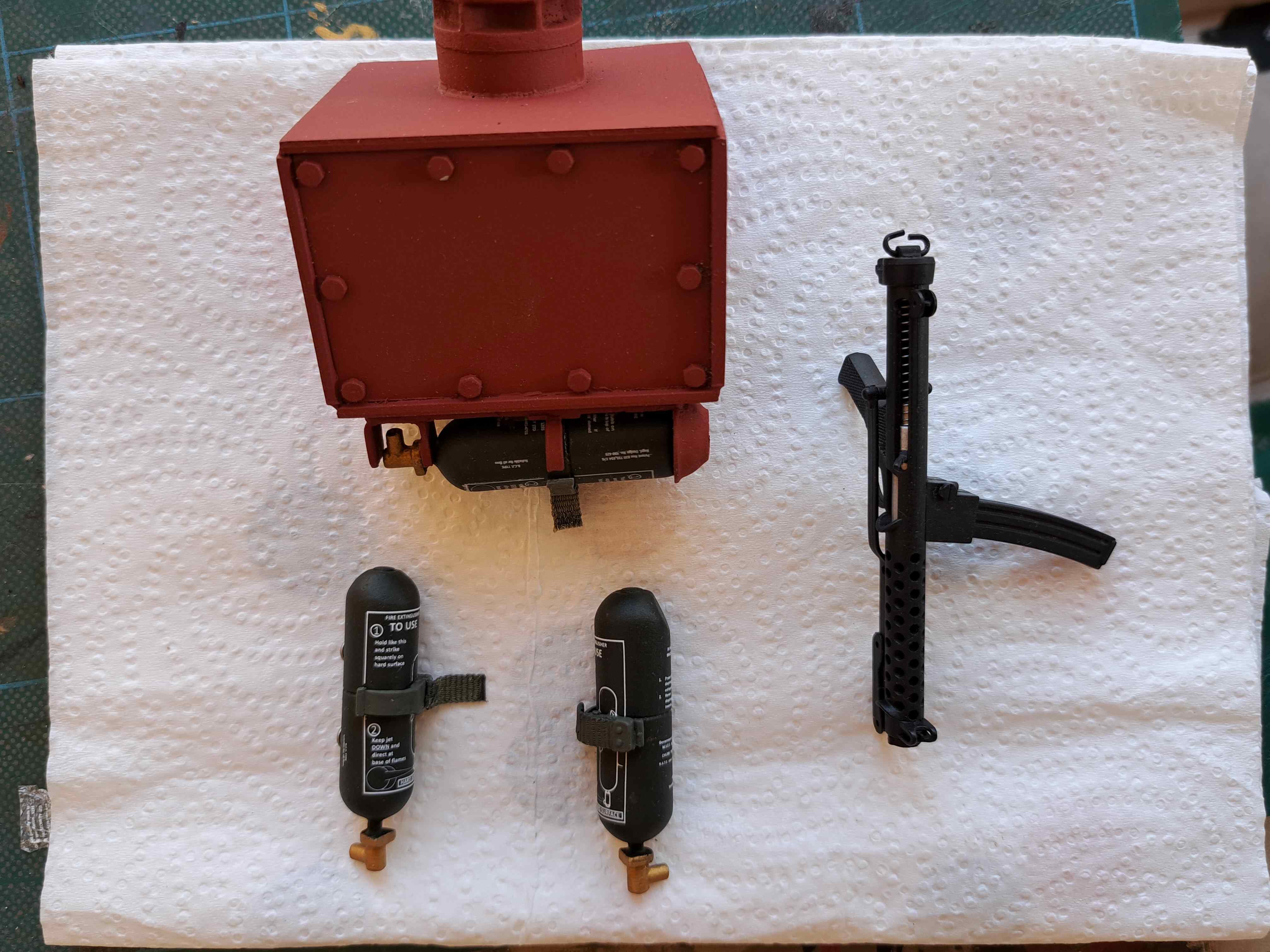

Also finally managed to wrestle the fire extinguisher transfers into place, whack some vanish on and hope not to visit this again, no disrespect intended. :D :wink:
SMG to help scale, I think.(the flat filed on RHS extinguisher is part of learning curve, not visible when fitted,     just to say.

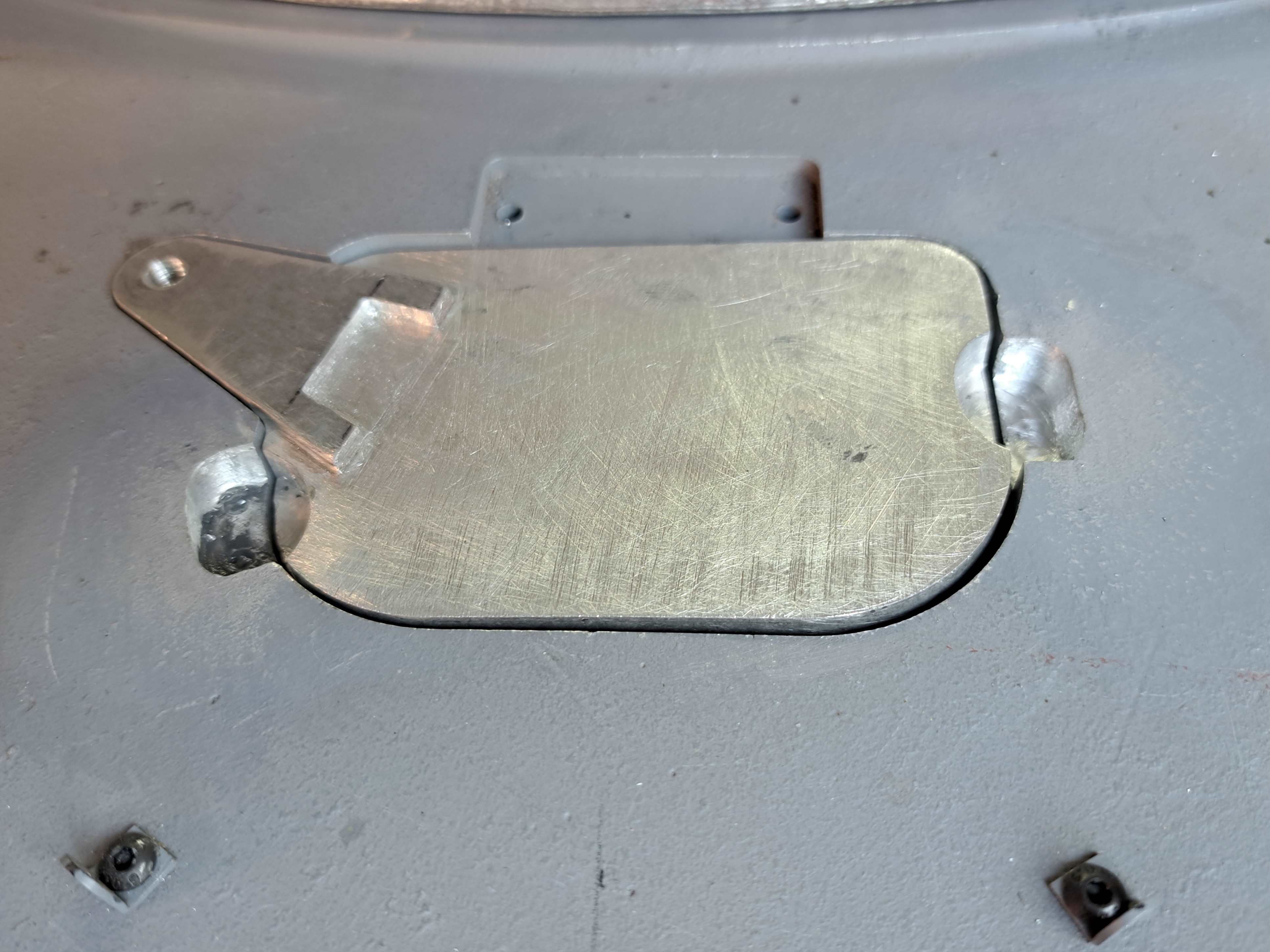

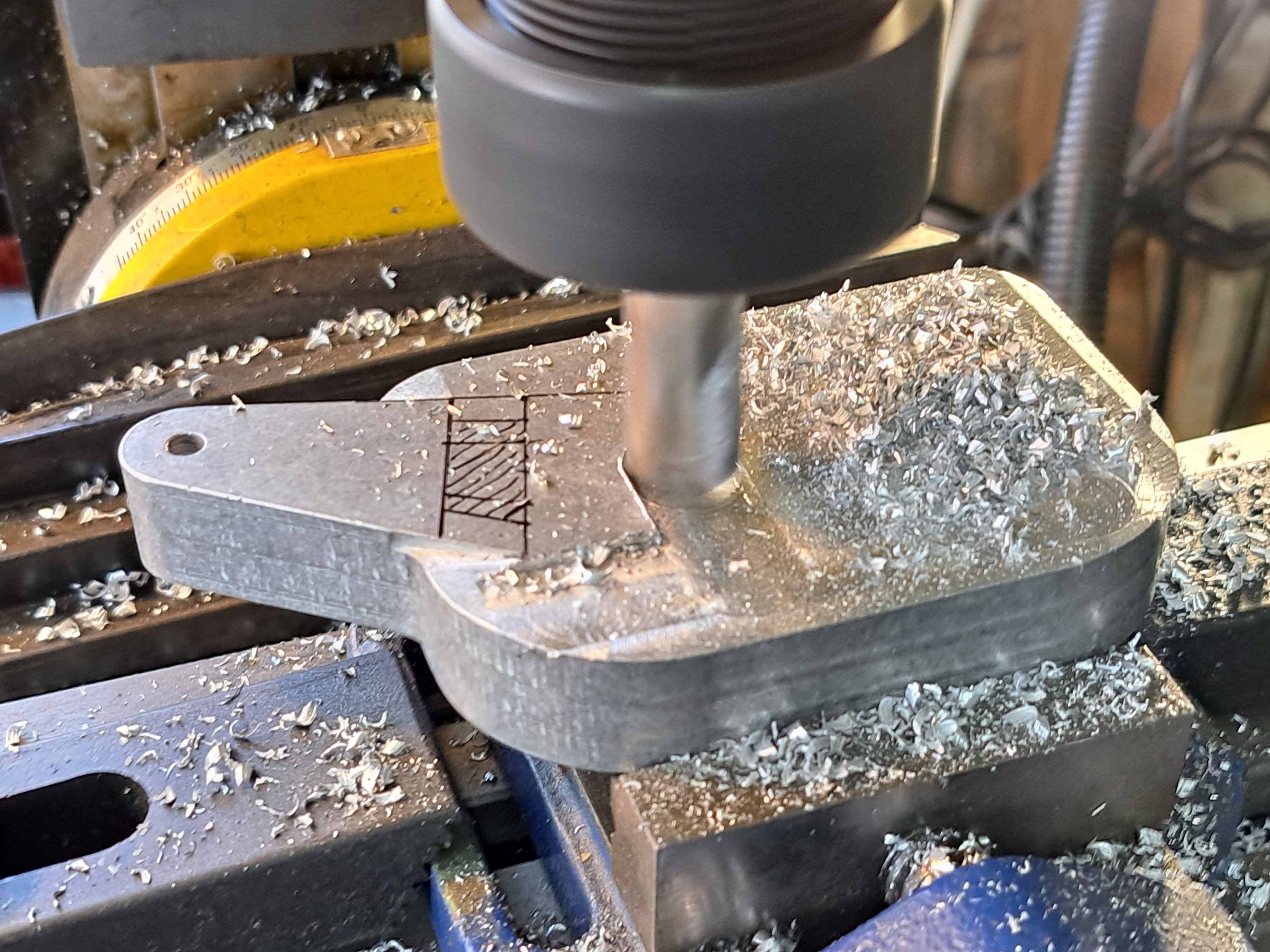

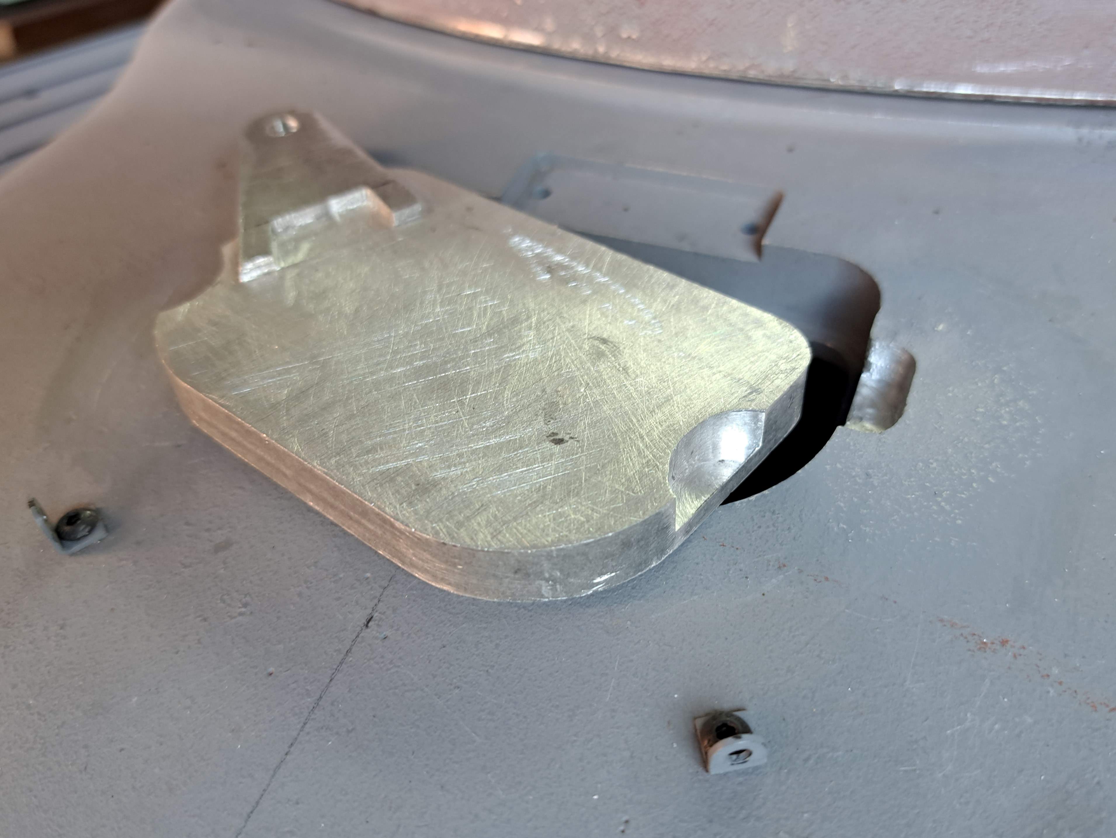

As has been mentioned on many an occasion, the Chieftain is a kit of many kits. Today I finally bit the bullet and attacked that huge lump of metal: The drivers hatch. Cue milling machine :D
Let's get started.
Let's get started.
Still fits, which is nice.
I was terrified at the prospect of attacking the hull.
The gray is Messr's J & B, I drilled a bit to far :roll:
Phew what a relief that's over.
Oh yes, it took an hour to hacksaw the excess metal from the hatch. Looks so much better, well in my eyes anyway. Just need to do a bit more filing, find the green house rubber(for it to sit on) I know its in the garage somewhere. Will also need to fettle a smooth lifting mechanism, lock etc. too
Have a good one.
Cheers Charles

Tis a lump and a half, and half you need to lump off to give that realistic look. So much better when sliced and diced, I made a little inner frame in the recess to sit hatch on.
Good Job, scratch that one off the list :D

You are right, that slimmed down hatch does look much better - well worth all the effort.
Keep up the good work

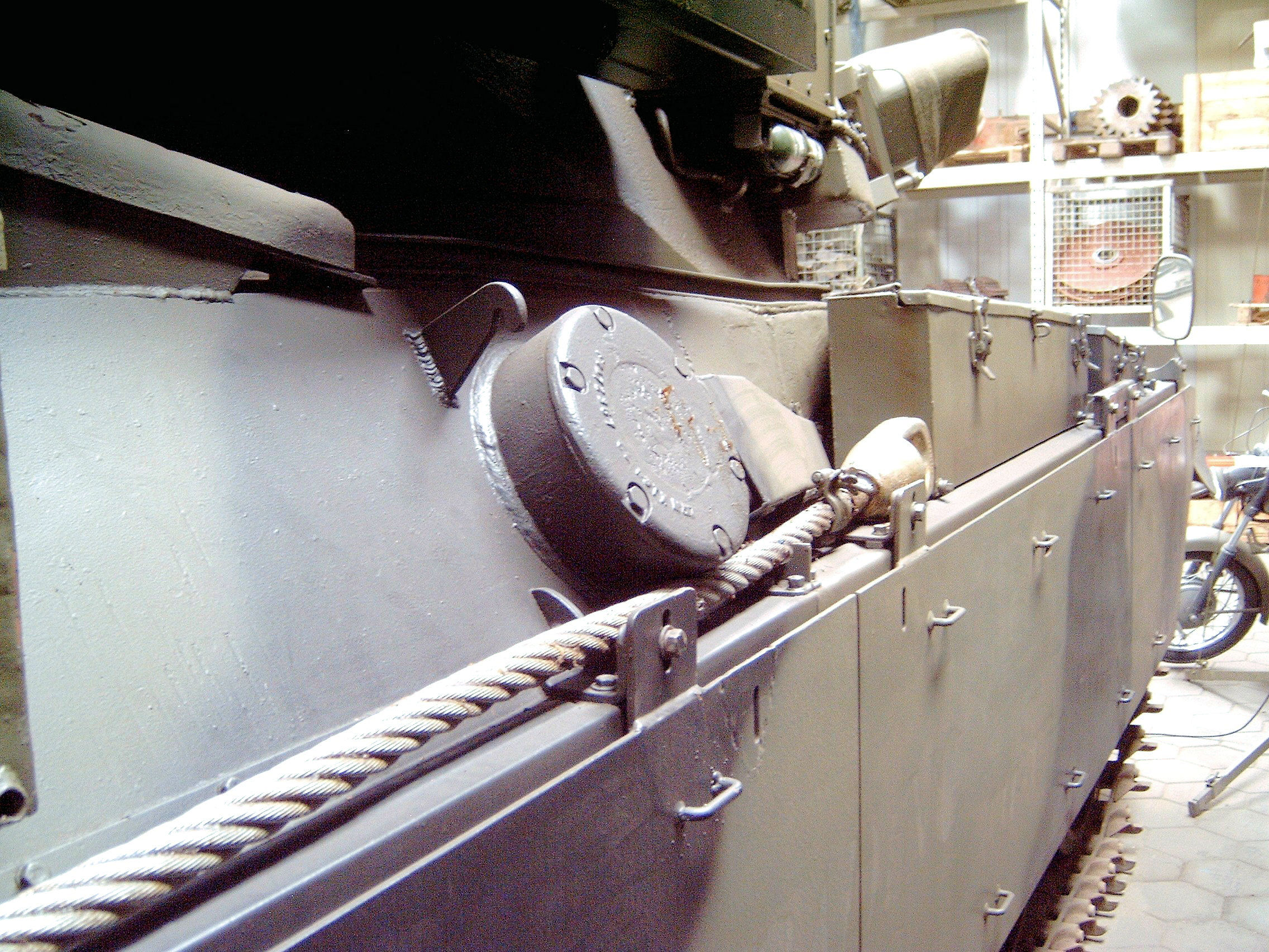

Good evening everybody.
Hope you are keep well and not too hot, bit of info really please:-

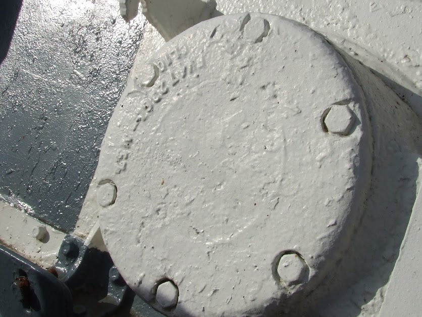

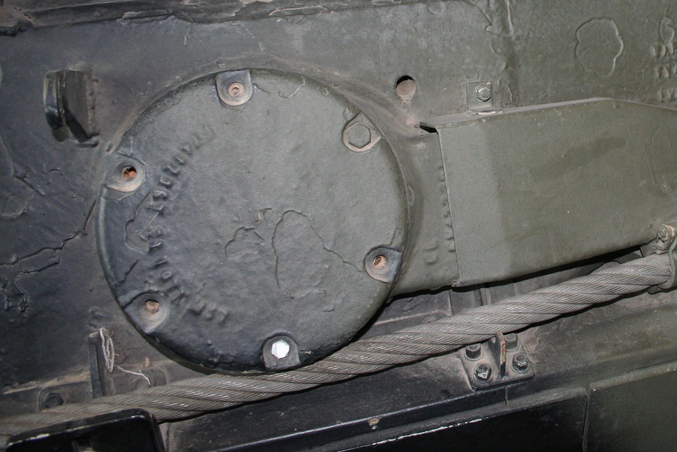

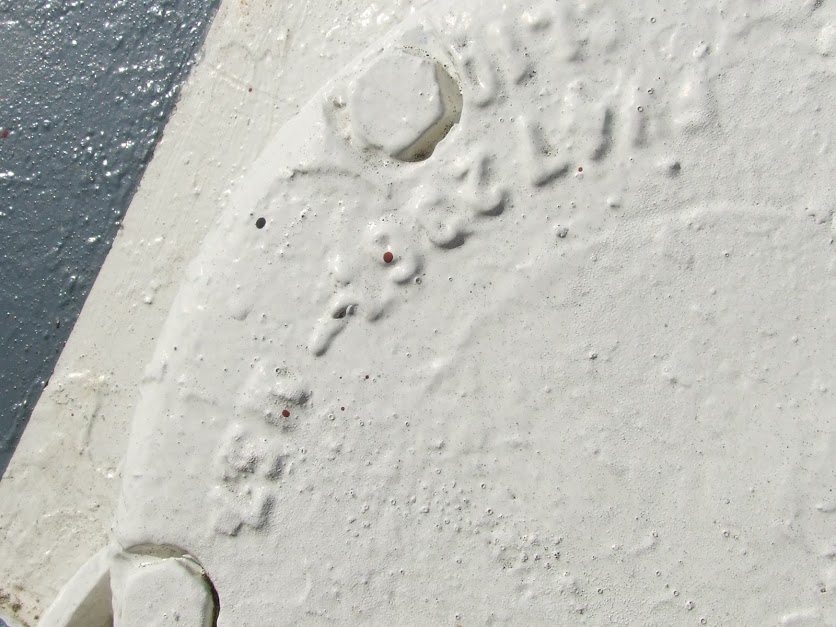

Anyone got a clear picture of these letters?
Charles
Posts: 1686
Been liked: 1818 times
Re: Chieftain No. 34
As with all things Chieftain things are not quite that simple. I've seen three different number sets on this cover plate and plenty of caked on paint covering the letters.
You'll struggle anyway with 2mm lettering on this smaller than normal piece in the kit, so I opted to remake it a bit larger and even then 2mm lettering is just ok. So I kept it to the minimum letters on my cover plate.
(Not with the kit, If you make the tin cover plate, the 2mm letters on the outlet under the tin cover can stay under the tin cover, you'd never fit them in) :|
There is four extra letters offset CL10 and FV472367-MS7, well, that's what I see.
Good luck in the house of the flying letters :D

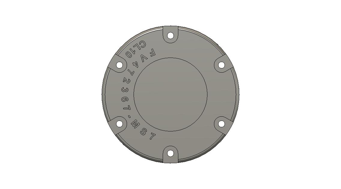

Hi Charles
Just to add to what John said.

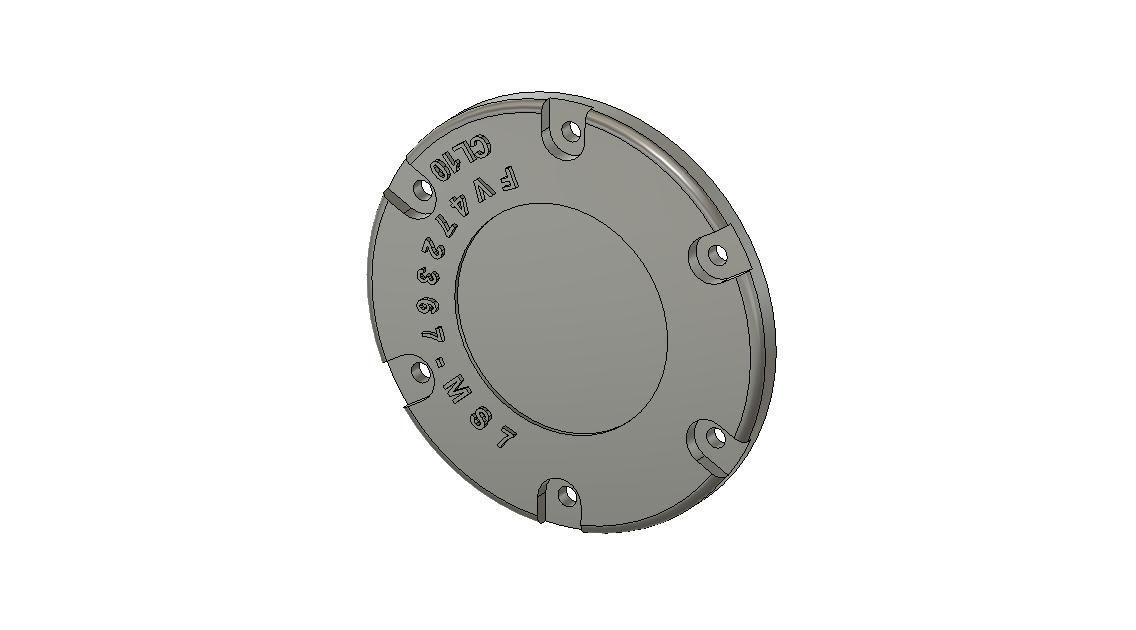

Many moons ago I had drawn up that cover but was never certain of it's correct dimensions. The OD of the cover you are going to see below is 42mm and the letters and numbers are 2mm high. I added the lettering that John suggested. Just for you to see how it would look. The font is Arial and bold.

Looks good as always Vince 8) , but this model has a lot of kickers, at 42mm, the OD of the cover plate would be a bit on big size. Maybe not scale wise but aspect wise.
I think Greg and I made up new parts to 36-37mm OD. It now looks realistic at that size against the side plating. One of the reasons why I'm taking so long building the model is that I keep having to stand back and look :shock: Actually looking at the MS7 could it be M57 (bug..r)

No problem John. Just trying to help Charles visualise the 2mm lettering. Hopefully one can find stick on lettering smaller than 2mm.
p.s. You are right. That does look like M57.

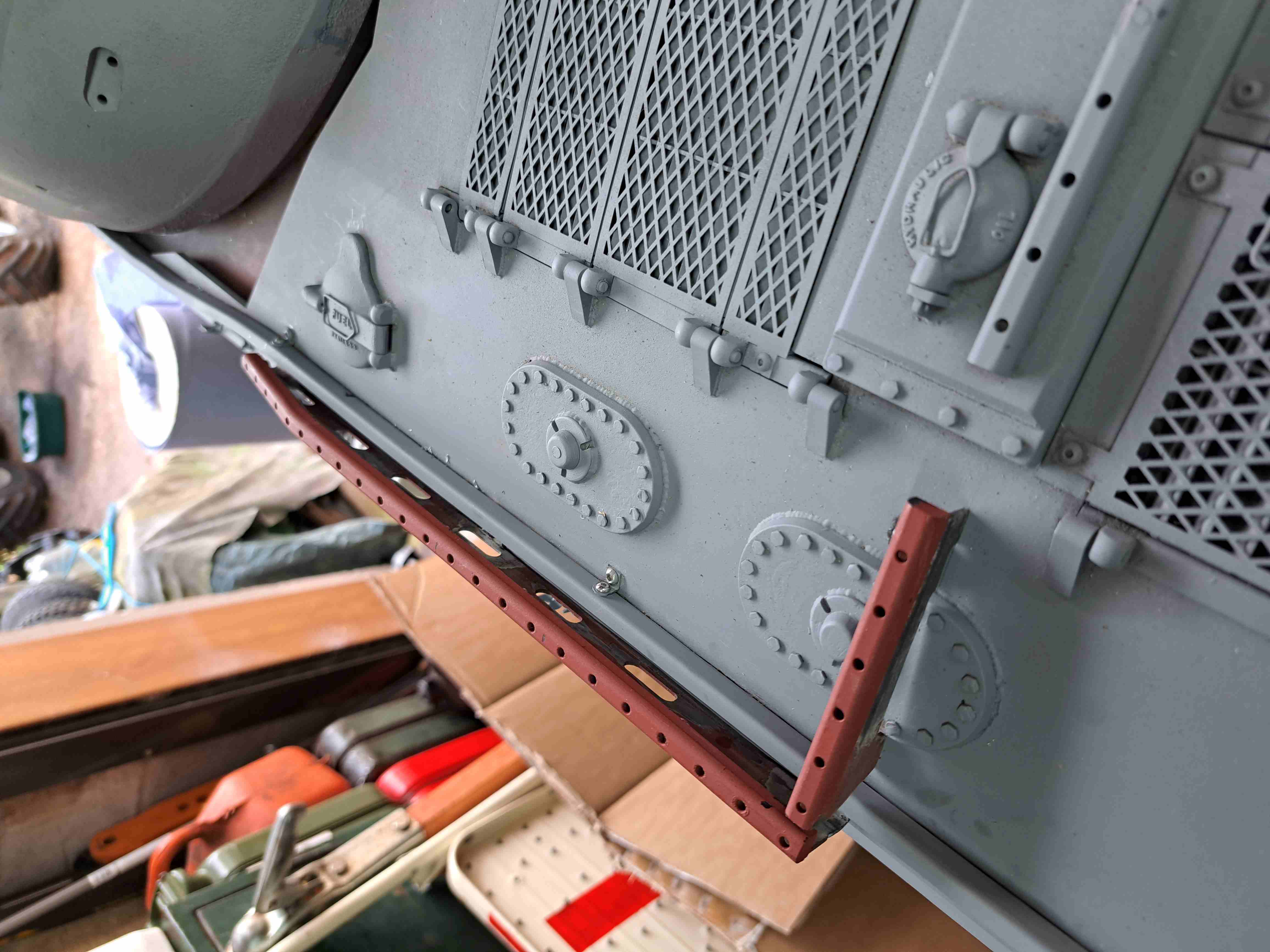

Good evening.

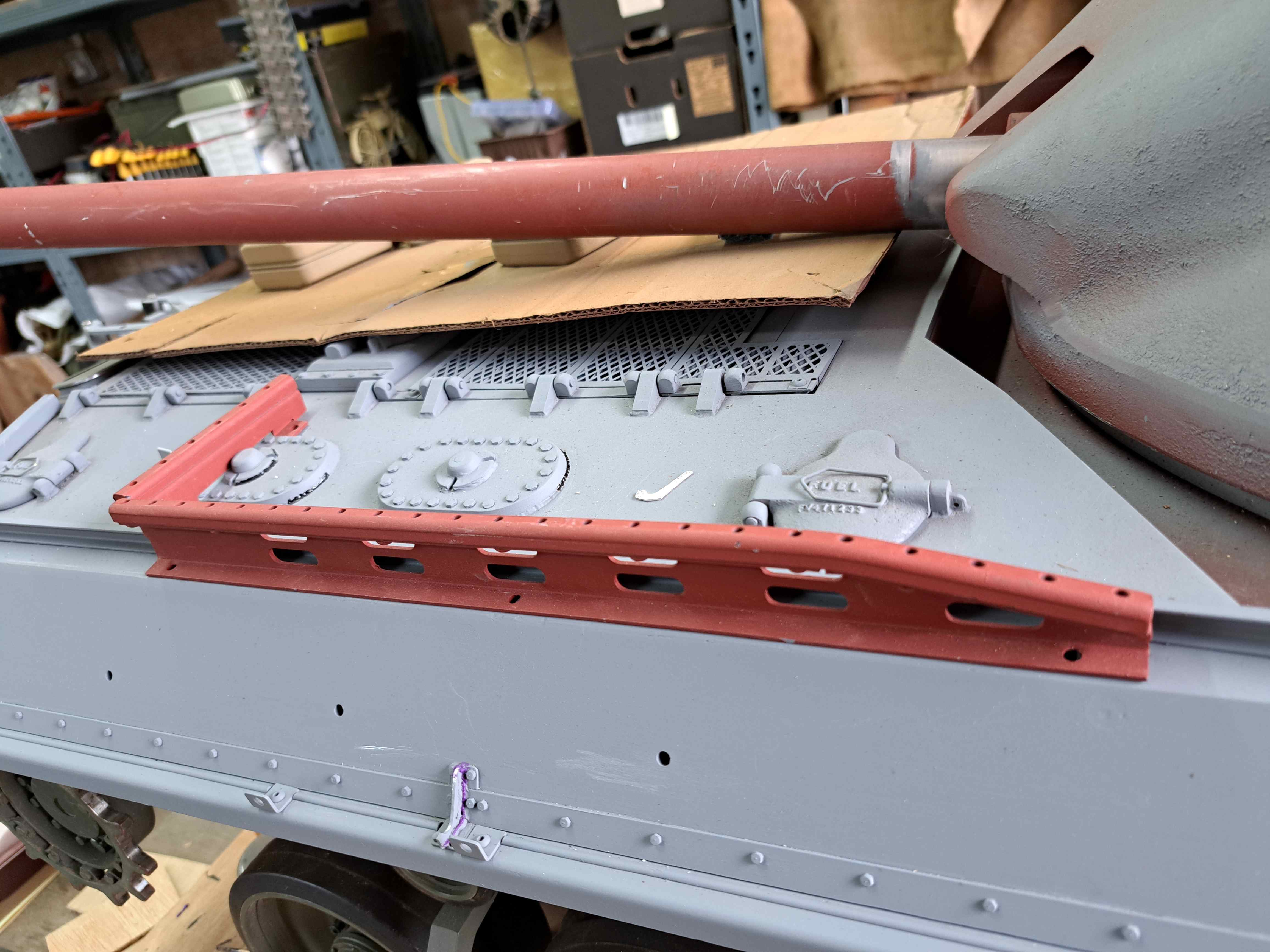

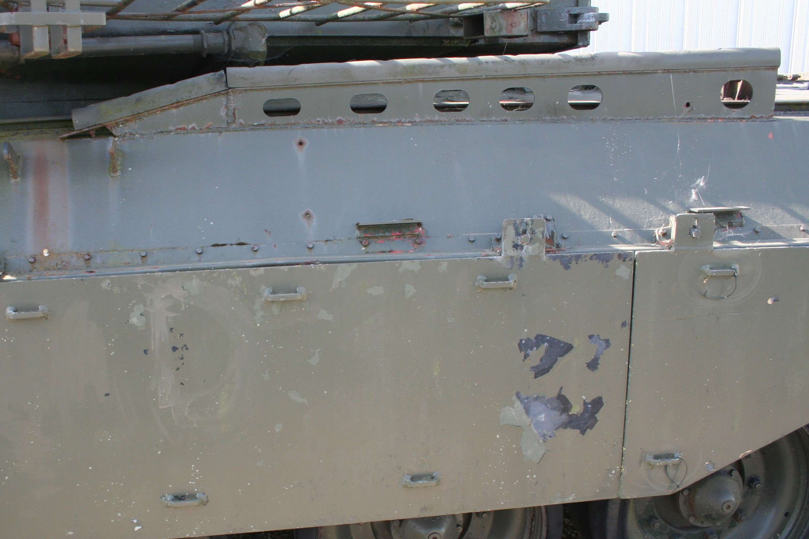

Small update. I wasn't planning this but when we visited the Tank Museum recently, counting nuts and bolts, as you do. I noticed this feature:- :-?
Gun bump rail (What is its proper name?)
Same feature on model:-
Somethings gotta change.

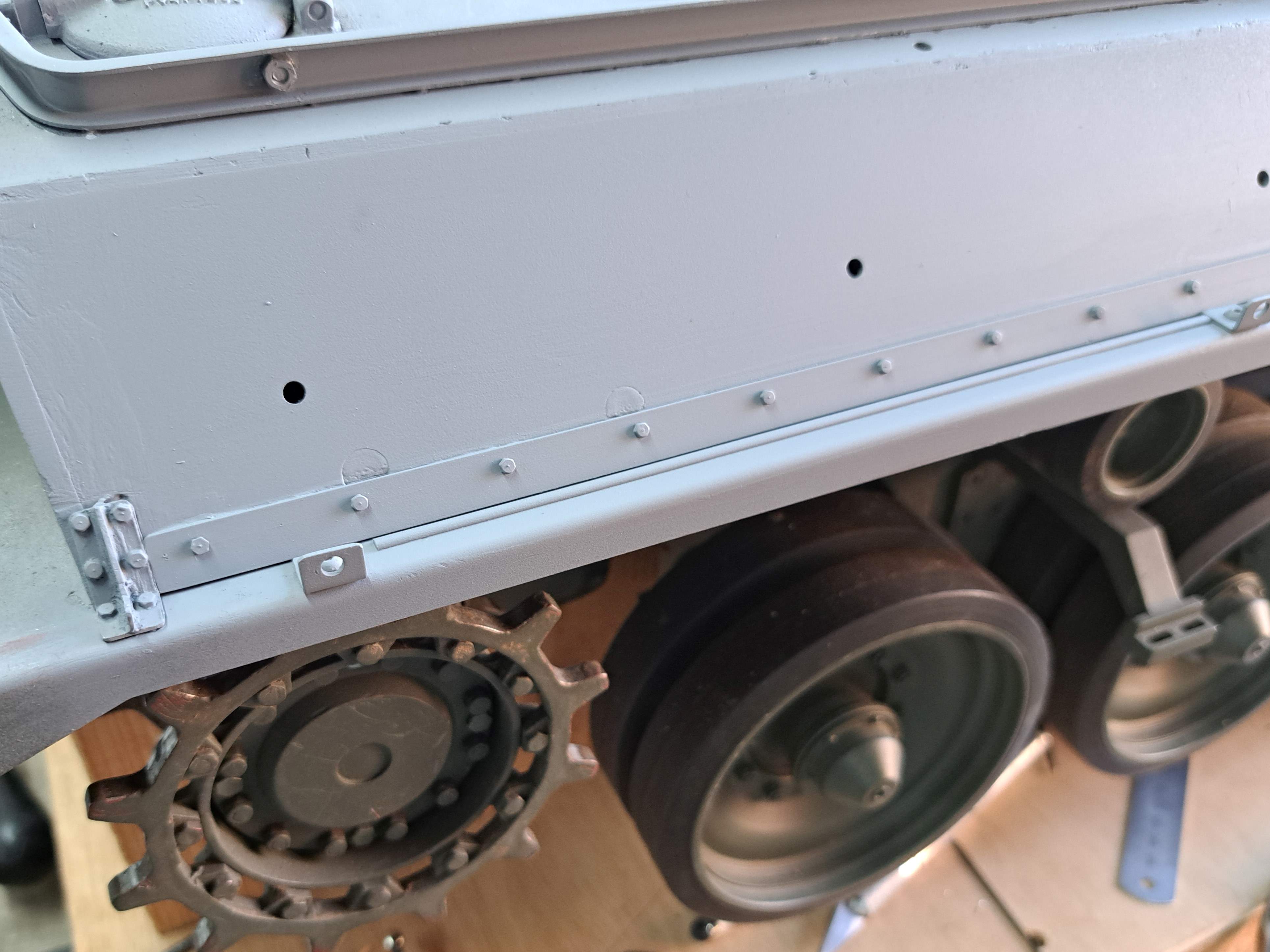

After some butchery, burning, hacking & bashing we arrive at:-
Looking better
Looking better
All I need to do now is secure the rail to the hull, so far I have drilled and tapped m3 holes, with the rail held in place buy screws, for now. Seems quite firm, which is nice :lol:
I hope you all enjoy your week. ahead.
Cheers Charles

Very nicely done Charles, but it's a step too far for me, there are so many mistakes on the model Chieftains rear deck, this one I'm going to let slide. When you fix one mistake, there's another one staring right back at you, chucking quietly "not yet sunshine, not yet"
Our deck/gun guard is very similar to the prototype Chieftain guard, running parallel mostly with the deck, some had a lot of weight saving holes, some didn't. The Mk5 on the other hand tapers from the forward wedge shape up lift, having only six holes as opposed to the eleven on the model.
I know, I'm looking too deep. "He's misstra know it all" 8)
