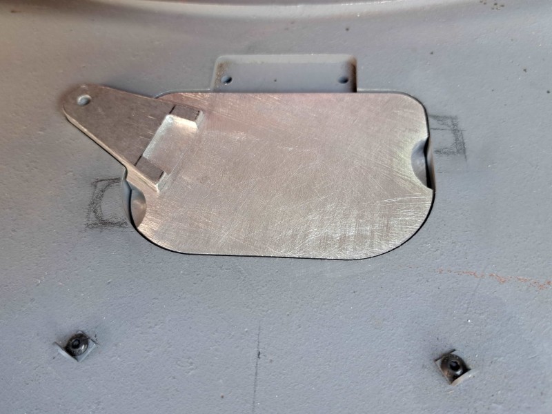

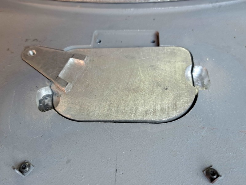

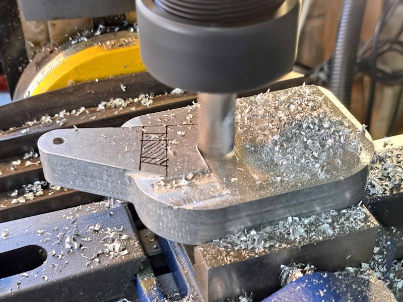

As has been mentioned on many an occasion, the Chieftain is a kit of many kits. Today I finally bit the bullet and attacked that huge lump of metal: The drivers hatch. Cue milling machine :D
Let's get started.
Let's get started.
Still fits, which is nice.
I was terrified at the prospect of attacking the hull.
The gray is Messr's J & B, I drilled a bit to far :roll:
Phew what a relief that's over.
Oh yes, it took an hour to hacksaw the excess metal from the hatch. Looks so much better, well in my eyes anyway. Just need to do a bit more filing, find the green house rubber(for it to sit on) I know its in the garage somewhere. Will also need to fettle a smooth lifting mechanism, lock etc. too
Have a good one.
Cheers Charles

Tis a lump and a half, and half you need to lump off to give that realistic look. So much better when sliced and diced, I made a little inner frame in the recess to sit hatch on.
Good Job, scratch that one off the list :D

Hi Charles,
You are right, that slimmed down hatch does look much better - well worth all the effort.

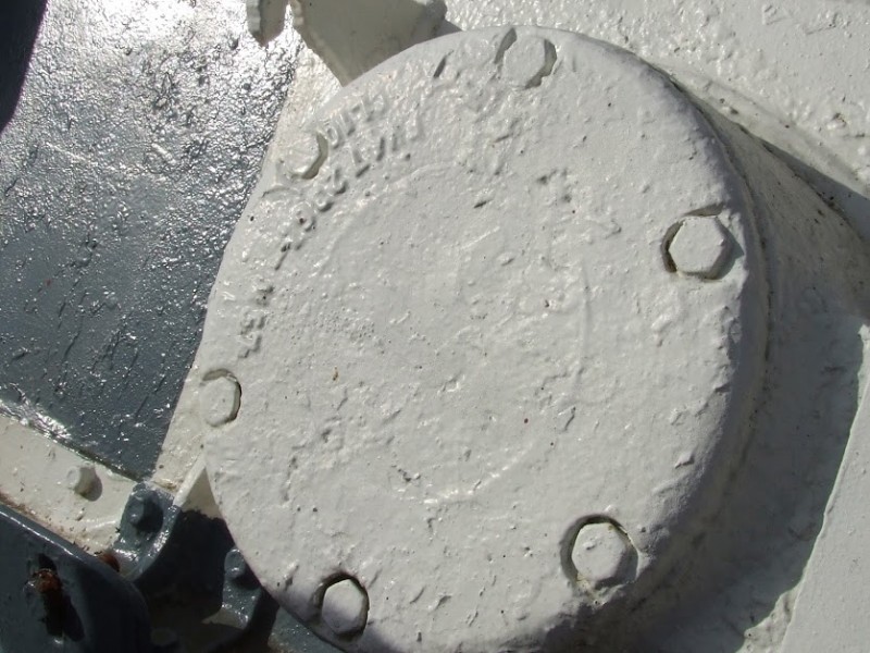

Anyone got a clear picture of these letters?
Charles
Posts: 1693
Been liked: 1842 times
Re: Chieftain No. 34
As with all things Chieftain things are not quite that simple. I've seen three different number sets on this cover plate and plenty of caked on paint covering the letters.
You'll struggle anyway with 2mm lettering on this smaller than normal piece in the kit, so I opted to remake it a bit larger and even then 2mm lettering is just ok. So I kept it to the minimum letters on my cover plate.
(Not with the kit, If you make the tin cover plate, the 2mm letters on the outlet under the tin cover can stay under the tin cover, you'd never fit them in) :|
There is four extra letters offset CL10 and FV472367-MS7, well, that's what I see.
Good luck in the house of the flying letters :D

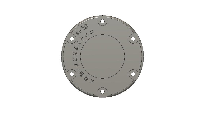

Many moons ago I had drawn up that cover but was never certain of it's correct dimensions. The OD of the cover you are going to see below is 42mm and the letters and numbers are 2mm high. I added the lettering that John suggested. Just for you to see how it would look. The font is Arial and bold.

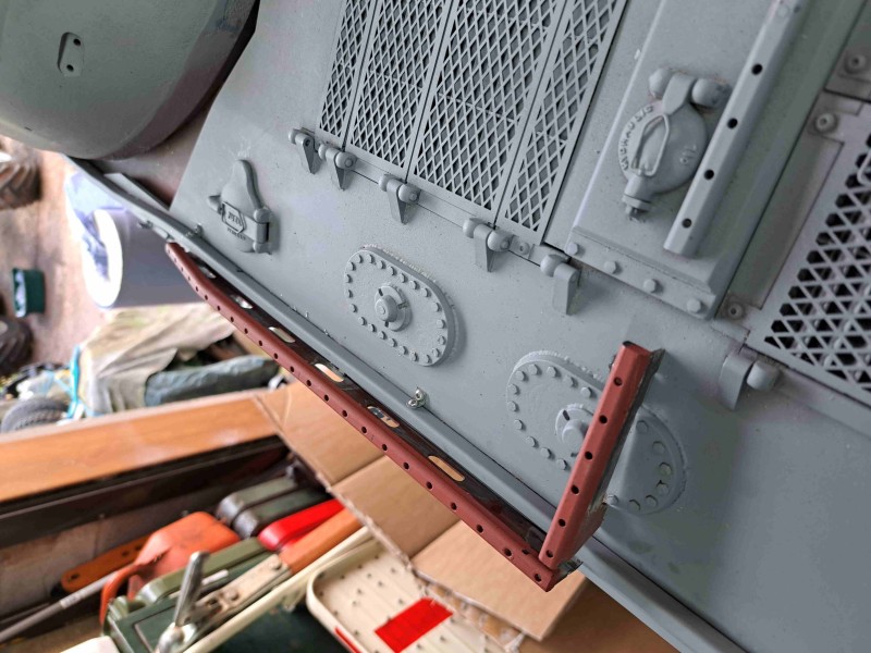

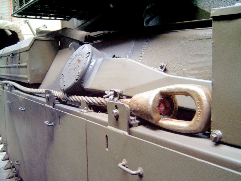

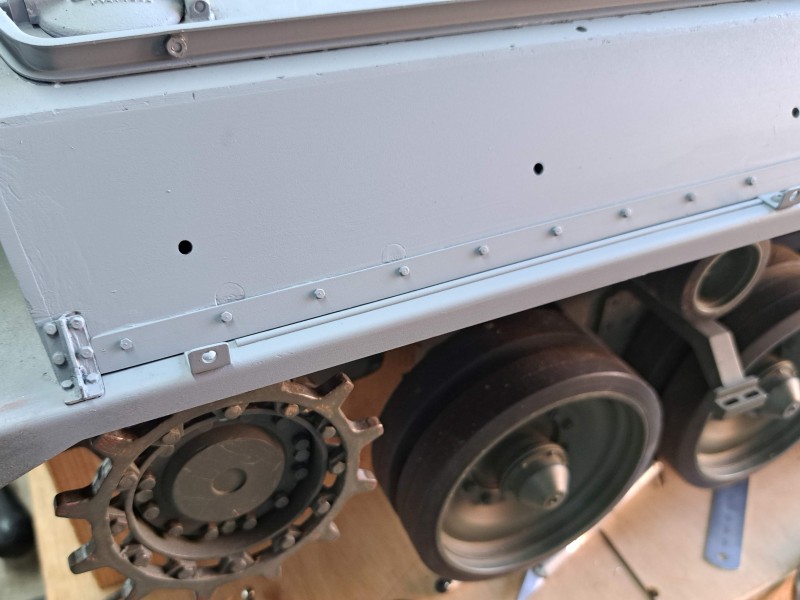

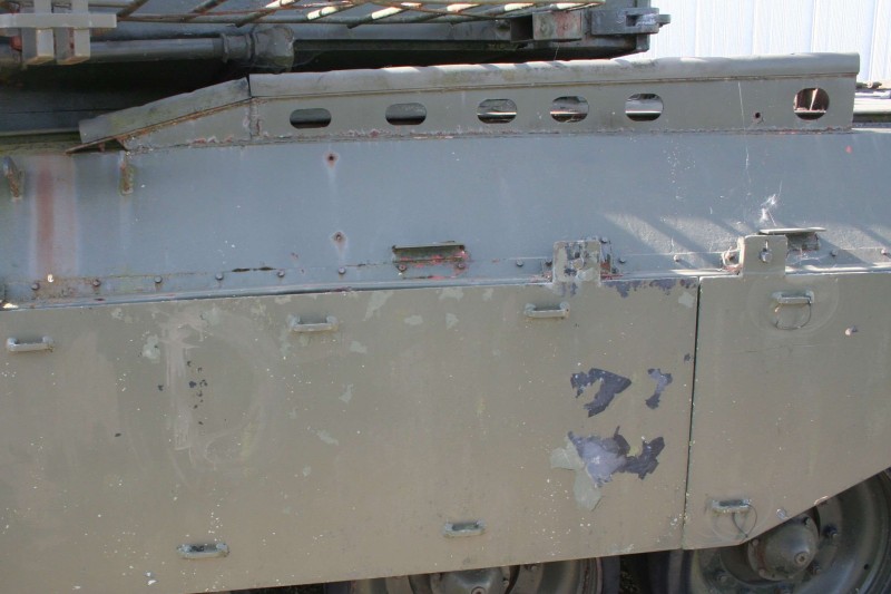

Small update. I wasn't planning this but when we visited the Tank Museum recently, counting nuts and bolts, as you do. I noticed this feature:- :-?
Gun bump rail (What is its proper name?)
Same feature on model:-
Somethings gotta change.

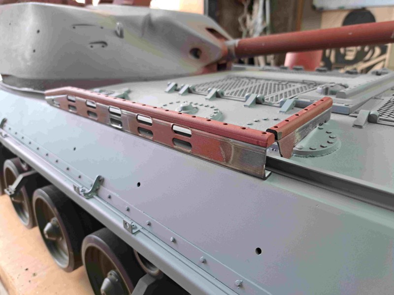

After some butchery, burning, hacking & bashing we arrive at:-
Looking better
Looking better
All I need to do now is secure the rail to the hull, so far I have drilled and tapped m3 holes, with the rail held in place buy screws, for now. Seems quite firm, which is nice :lol:
I hope you all enjoy your week. ahead.
Cheers Charles

Posts: 1693
Very nicely done Charles, but it's a step too far for me, there are so many mistakes on the model Chieftains rear deck, this one I'm going to let slide. When you fix one mistake, there's another one staring right back at you, chucking quietly "not yet sunshine, not yet"
Our deck/gun guard is very similar to the prototype Chieftain guard, running parallel mostly with the deck, some had a lot of weight saving holes, some didn't. The Mk5 on the other hand tapers from the forward wedge shape up lift, having only six holes as opposed to the eleven on the model.
I know, I'm looking too deep. "He's misstra know it all" 8)
As an Great Modeler once told me:
Compromise compromise compromise JC! .
Though he hasn't been doing much of that on the Centurion currently being titillated. :lol:
Lovely growl from the Chieftain :D
