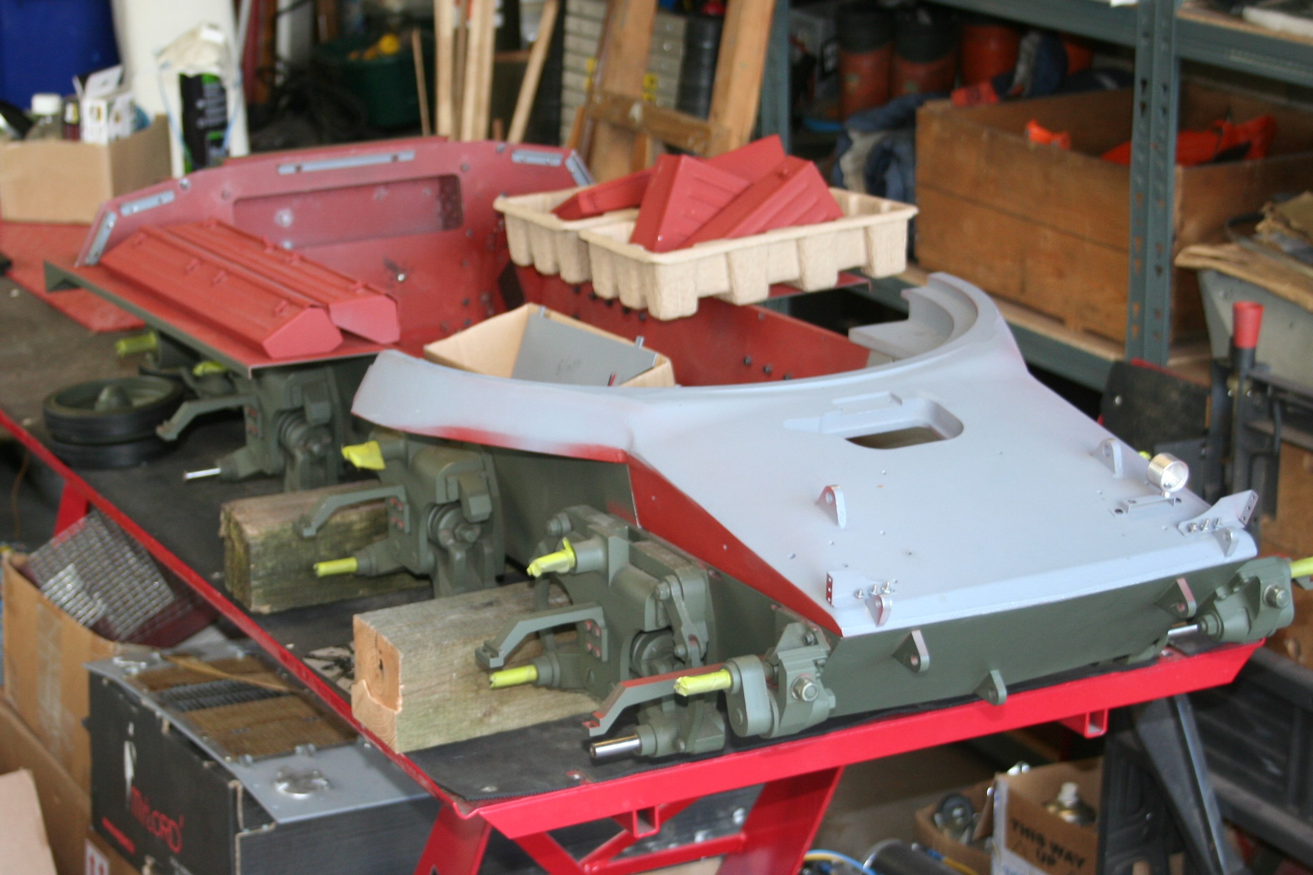

Good Evening all.
First off, don't expect of me the great works that Phil has just completed, this is my first foray into building this scale of armour.
Anyway, John Clarke recently and correctly pointed out where are the Chieftains?
So here I am. My aim is to have the chassis moving in the next couple of weeks. As I have said on the KT forum I am very easily distracted, especially by the Armopax/e-bay stuff, e.g. my Chieftain crew are equipped with compo rations, black overalls, helmets, GPMG, 58' webbing etc.
Still lacking a couple of Sterling SMGs though.

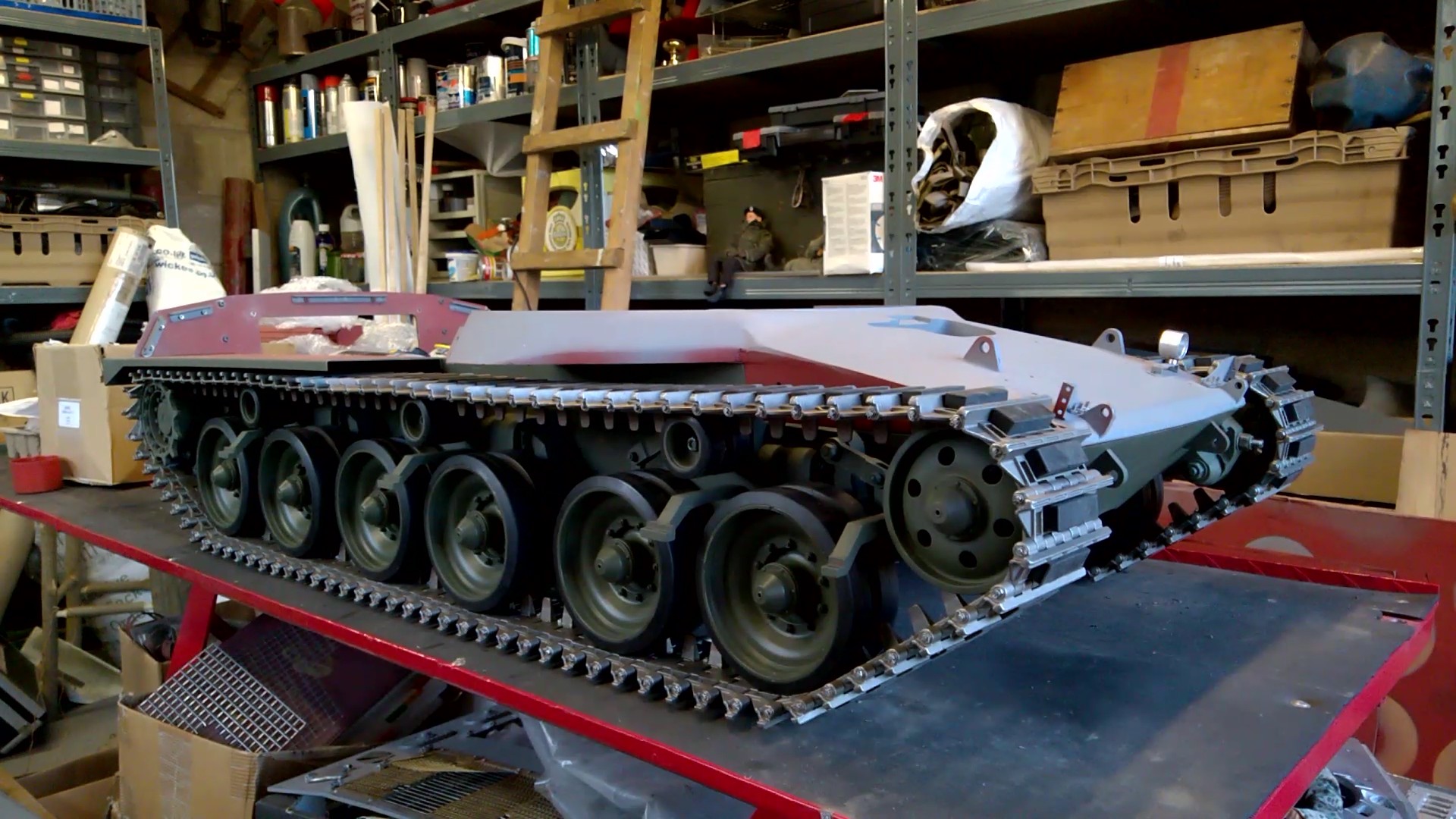

And here is the rear view, I hope.
- Posts: 1693
- Been liked: 1842 times
Re: Chieftain No. 34
Brilliant Charles, your a lot further forward than myself. Looking good

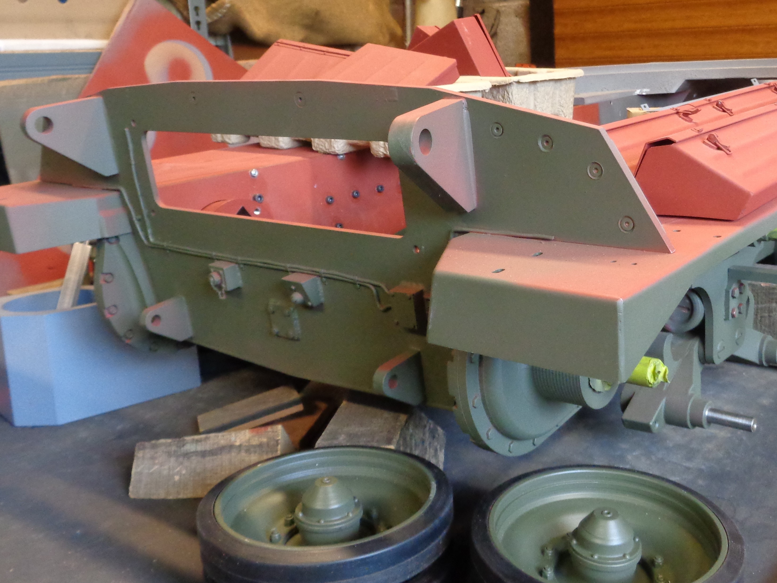

Although sadly, I think I will need to separate the tracks as the middle suspension units rattle a bit and adjust spring units.
The extra weight of batteries, hull plate and turret may work. I don't fancy trying to adjust suspension when vehicle is complete .

Hi Charles
I might be wrong, have been many times, but I don't think there's any adjustment on the suspension, other than relief on the spring by end part ESO206.
Once the weight compresses the springs that's it.
I have added small rubber blocks on the stops (on my post) to reduce over travel of the spring arm units, this prevents the spring units falling out
when no load is on the bogie unit, removal of track etc. There are modified bogie units by other builders, but the spring lengths and the pressure don't change unless you add different springs. I might be wrong though
Looking great
Looking great

Thank you John for your observations, always welcome. I think the problem solved itself.
Went to wiggle the units this a.m. Solid!
Must have settled/bedded down overnight, really can't wait to get the chassis moving.

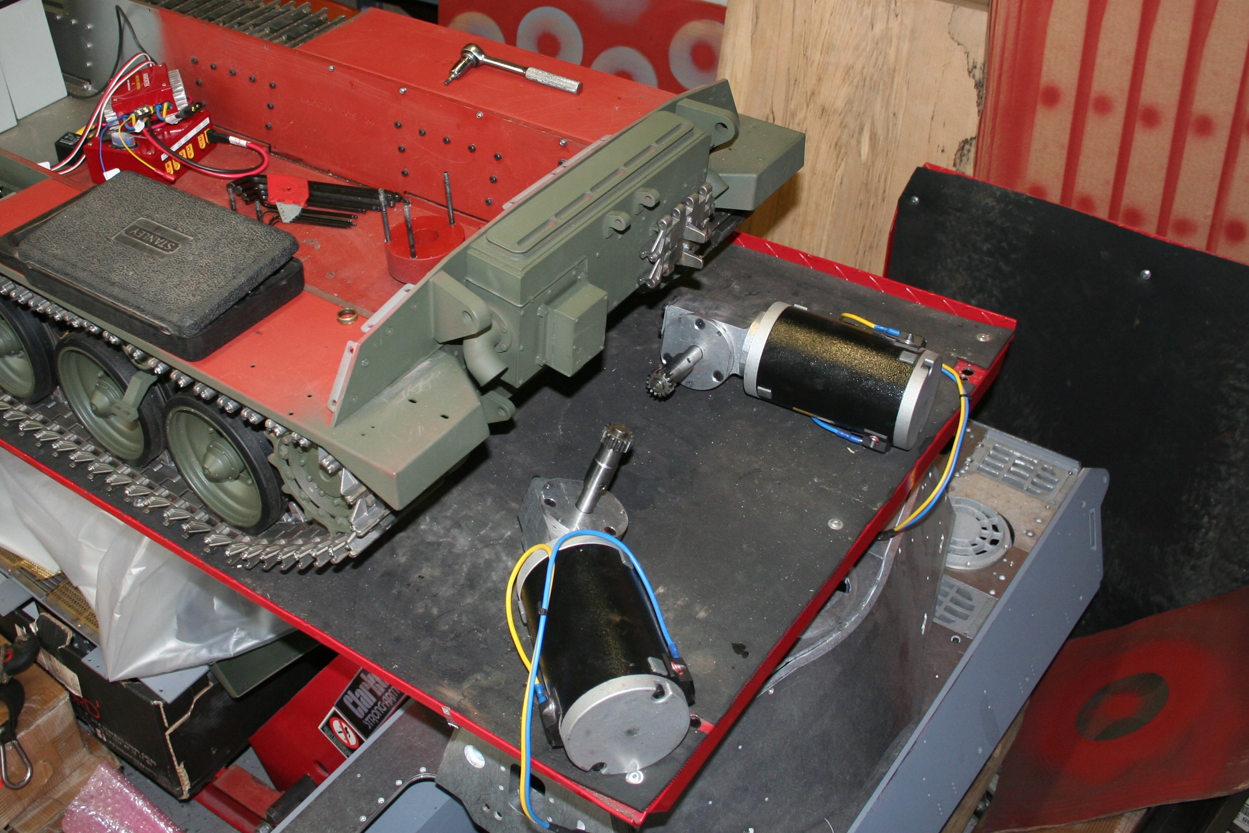

John, I have a beer in my right hand. Unfortunately on our maiden voyage in the garden we had a gear box failure
So tomorrow I will be talking to the engineering dept.
One saving grace though, the motors were not running at full tilt. We haven't got that far with that set up. The elevon worked well but needed reversing, which will now have to wait to be tested.
We have a video but won't post it until we are sorted.
Sorry about the disappointment.
Charles

Dreadful news Charles
.mixed emotions about this.
The cold beer should be in the left hand and the control of a wonderful model in the other, driving back to base should be the norm. Having to push the heavy lump back should not or be a very rare case.
On my reckoning of the known seven running Armortek Chieftain hulls that have completed, three have had running problems.
I'm a long way from running my model around, but I'm starting to think I need lots of access to the mechanical bits. Once the rear deck is tied down welds run and painted, the last thing you want to do is tear it up to get at the rumbling bits.
I'll be looking forward to the autopsy report to see what can be done,
May be set up a toten pole investigation.
