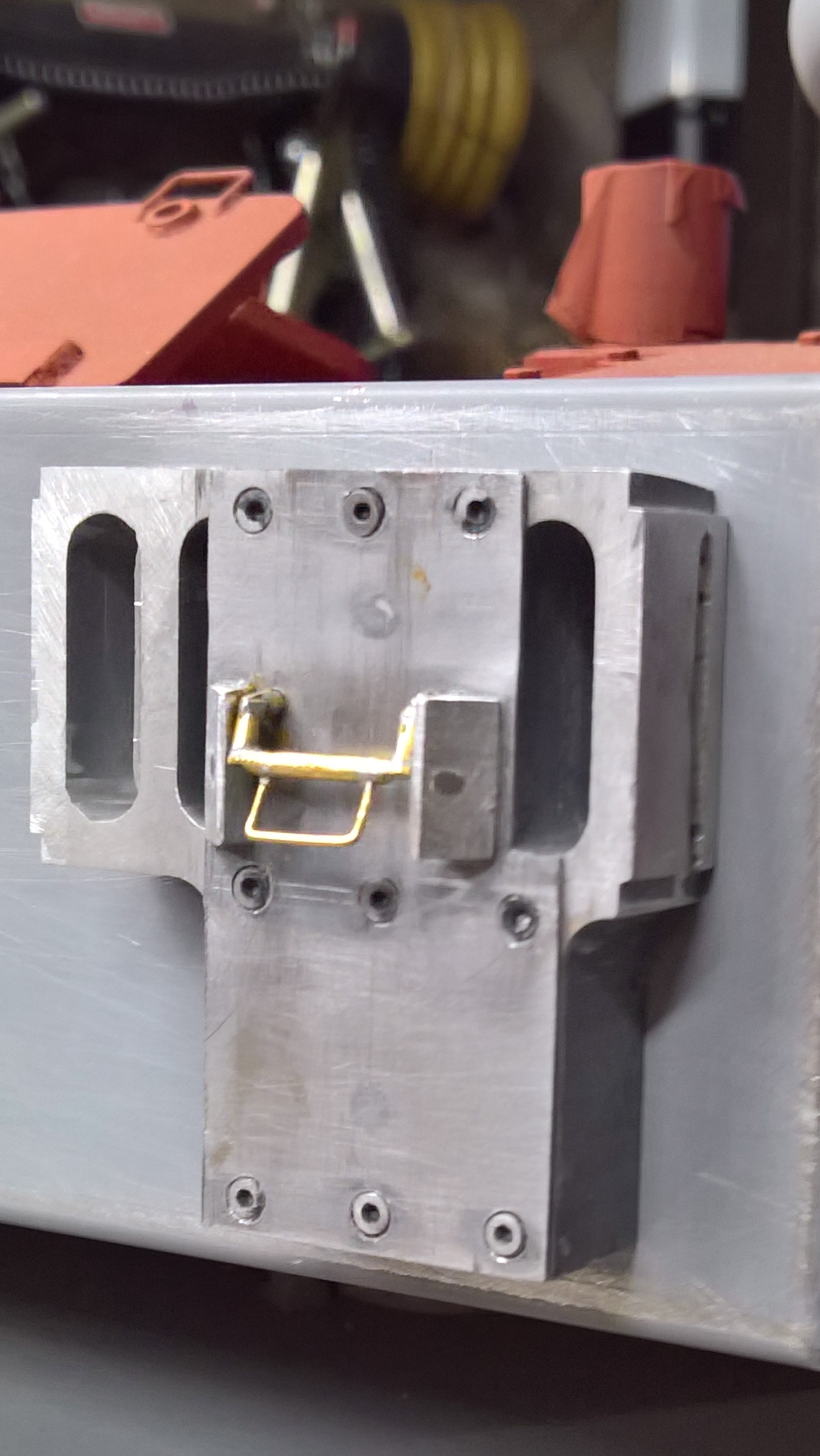

May I proffer this week's (actually2weeks) hacking and bashing: Yes, it's rough, but we are getting there. I present the NBC pack: -
Still some filing to do & a catch to do too.
For info I used M2x10 cap heads, M1.6/BA (?) an option possibly & replaced the AT plate & bolts, but I haven't squared off the inside of inlets.
Bolted to the NBC door by threading the existing hole, M4 and filling.
How's the plate hung on?
Tap(M2) the angles & super glue. At least one of screws though the angle will hold the plate in place, I hope.

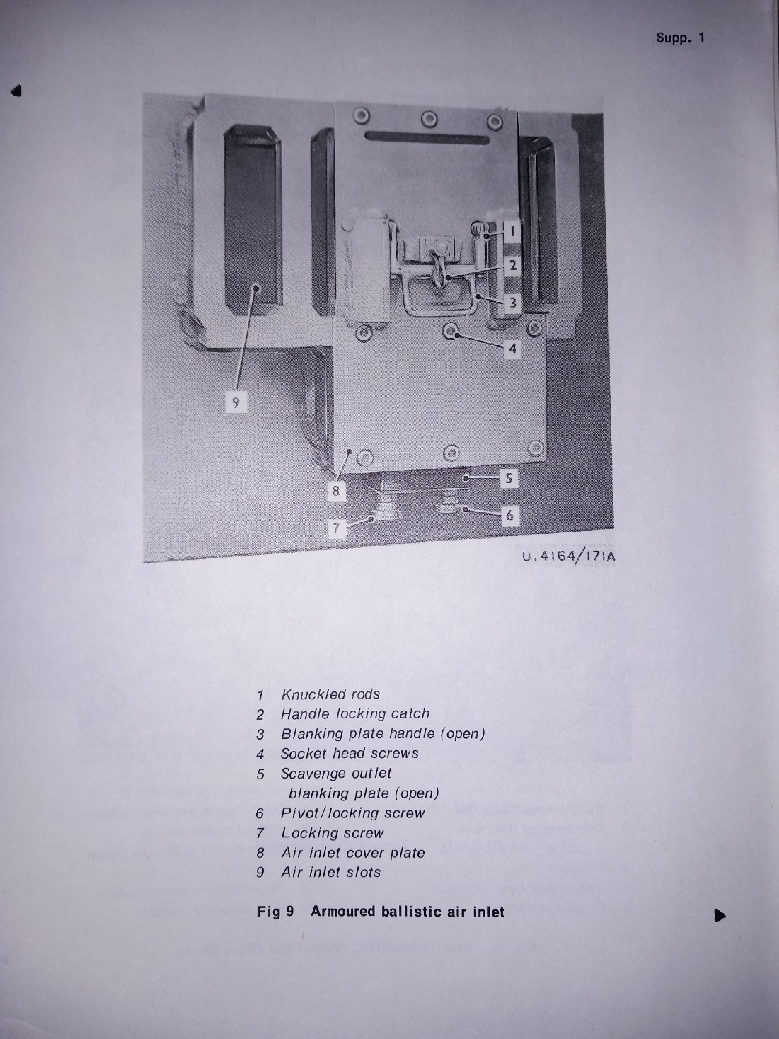

More nice details coming together there. Didn't understand your 'plate' query , does the attached extract from the official 'User Manual ' help?

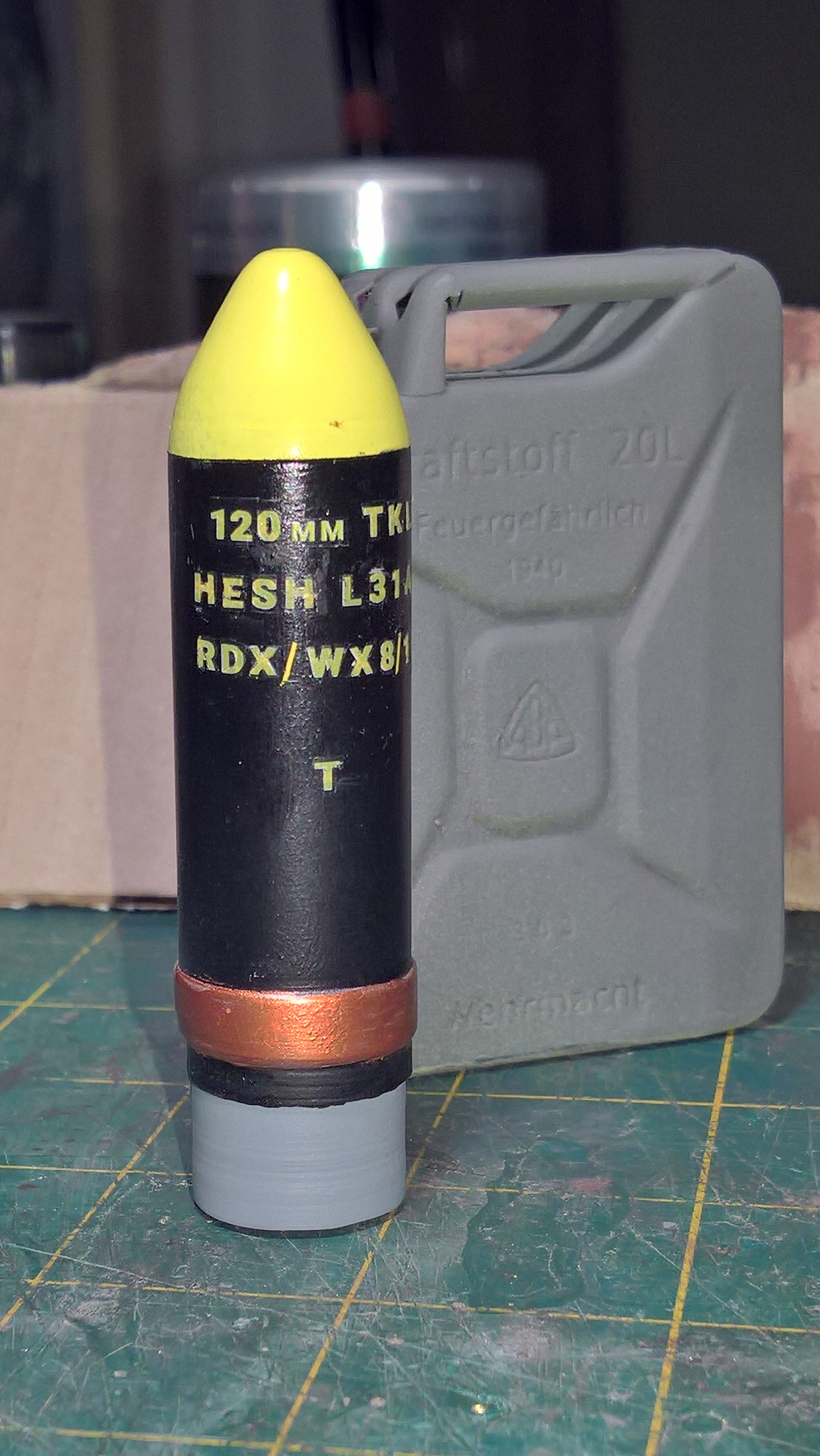

It has been so wet up here; I had a daft idea and a lathe: -
Another coat of varnish, a touch of wear & tear and bobs your whatsit. Though if anyone has one a good closeup of the drive band, that would be handy for the next round, (Boom Boom).

High explosive rounds HESH ( High Explosive Squaush Head ) and the training round SHPrac did not have a drive band. The copper band was a sealing ring and would have imparted minimal spin to the round.Charles A Stewart wrote: ↑Wed Nov 02, 2022 11:05 pmThough if anyone has one a good closeup of the drive band, that would be handy for the next round, (Boom Boom).
Charles
The kinetic rounds had drive bands so that the rifling in the barrel started them spinning giving them more stability in flight and making them more accurate.
- Charles A Stewart
- Posts: 584
- Location: Cumbria
- Has liked: 512 times
- Been liked: 933 times
Re: Chieftain No. 34
Thanks for the info, Mark, never too late to learn something new, as it is raining again tomorrow, I will rework my ordinance.
Vince (thank you) forwarded a link I had forgotten about from Phil's build, very useful too. I may even have a go at some of the other ammunition.
Cheers Charles
Cheers Charles
- Has liked: 1040 times
This is incorrect. All natures of ammunition on Chieftain were spun. One of the reasons the Royal Armoured Corps favoured HESH from a rifled barrel, as opposed to smooth bore and HEAT, was the increased accuracy of a spun round and the dual nature of HESH (H/E and anti-armour).High explosive rounds HESH ( High Explosive Squaush Head ) and the training round SHPrac did not have a drive band. The copper band was a sealing ring and would have imparted minimal spin to the round.
The only difference between natures was that APDS and Fin had nylon driving bands and a rubberised sealing ring, whereas HESH and Smoke had copper driving bands. The reason APDS and Fin had nylon driving bands (and front centering bands) was to make them frangible to allow the three petals of the sabot to fly off down range.
See the diagrammes from Pam 33, the Armament manual, I posted earlier.

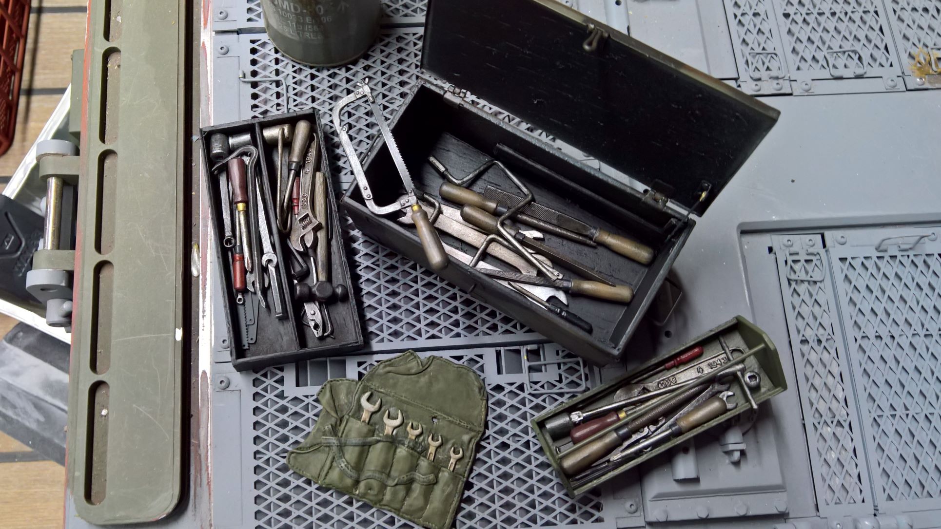

Cold & damp, therefore in the house, warmer, beer & snacks handy. As I said previously, I will pass on snippets of progress, so here is the latest.
The tools have been lying around for over a year, at least. Time to have a go: -
First the toolbox, based on one I acquired in the 1980's (the replacements were metal) before they went for "disposal".
We then added Armopax tools,
Any comments about "1943" dated adjustable spanners in the Chieftain tool kit, I will defend this, as I regularly use a 1954 WD spade (£21 years ago, bargain).

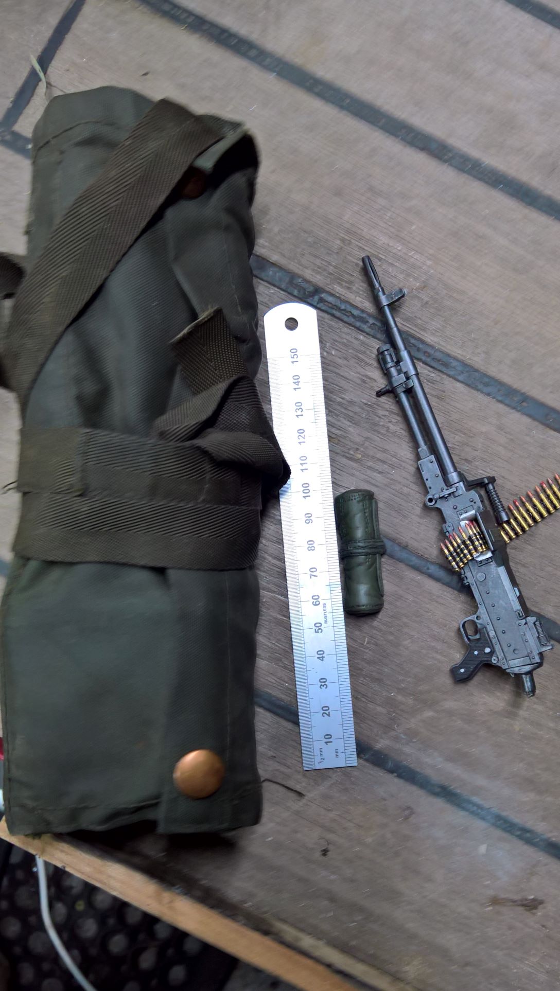

Last bit, the tool roll from Armopax will double as the GPMG cleaning tools.

The painting of those tools looks fantastic. I had to blow up the images to look for signs of photo shop trickery. The wood and metal effects are really very convincing.
