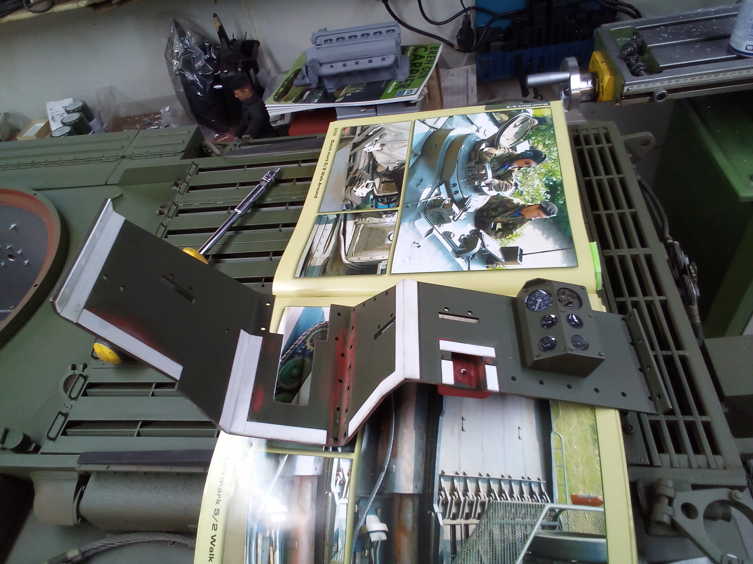

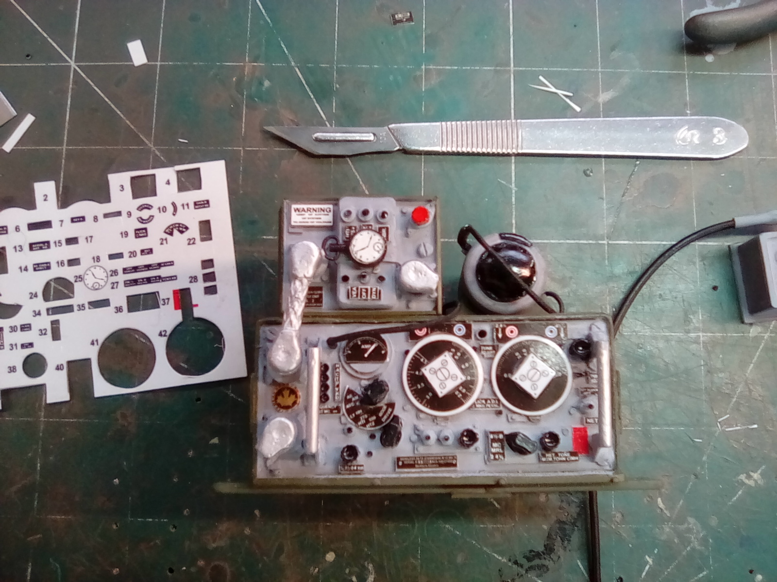

Re: David's carrier build.
Dave I have mounted the decals onto a piece of .5 plasticard and the technique is working well, it supports the fragile decals and provides a nice flat stable surface so I'm happy, you just need a steady hand with a scalpel.

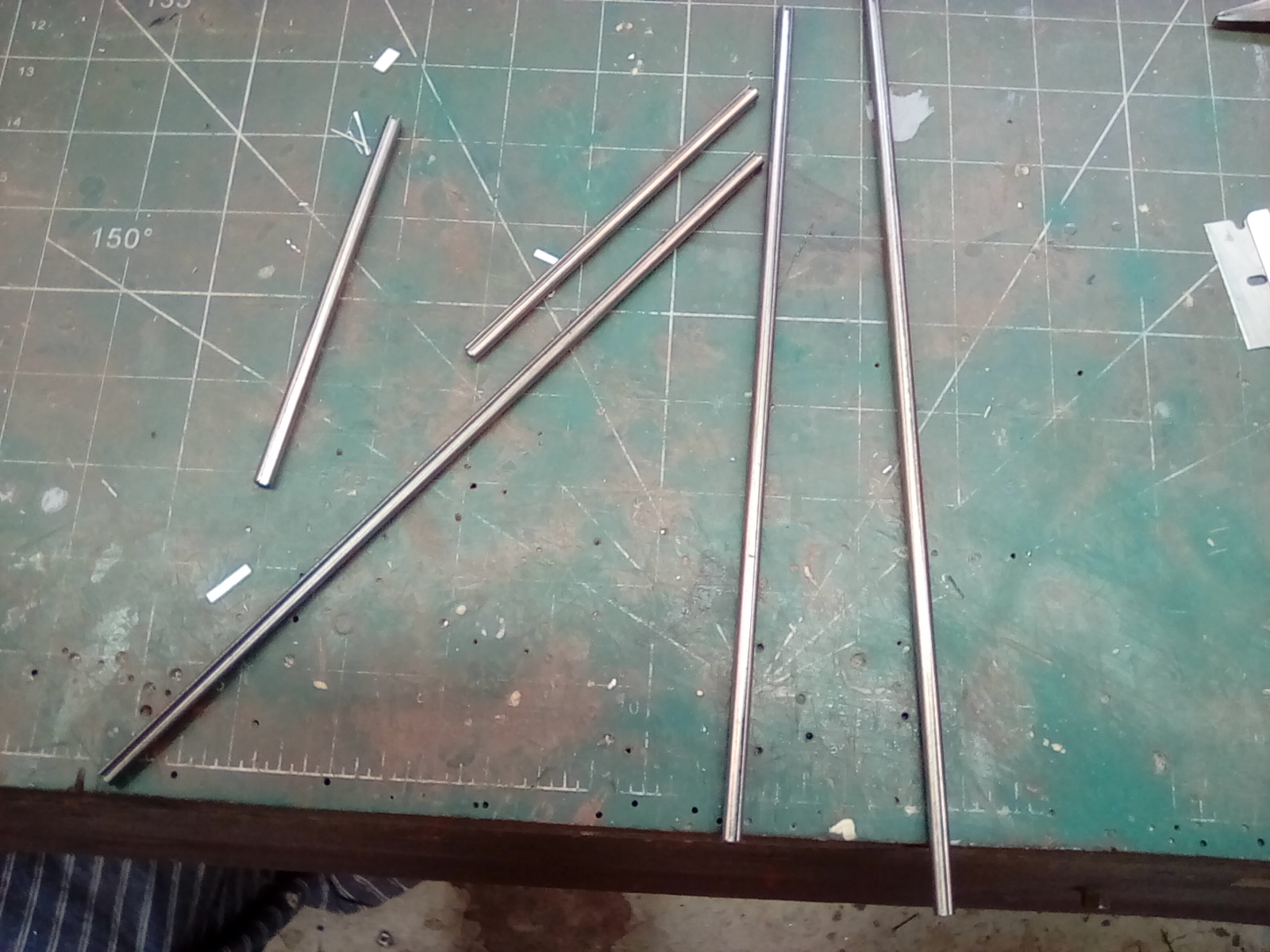

Lots done, forgot to mention ref the decals, you will need to use clear lacquer to seal the decal sheet once it's transferred to the plasticard .
Fiddly and time consuming job but worth the effort, you will need to remove lots of little screw and switch details to give you some room to apply the decals
That's better
That's better

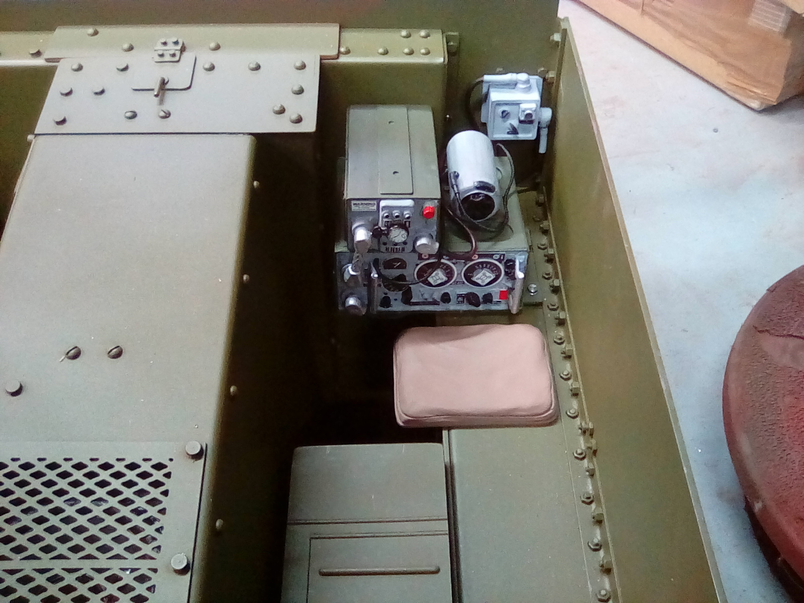

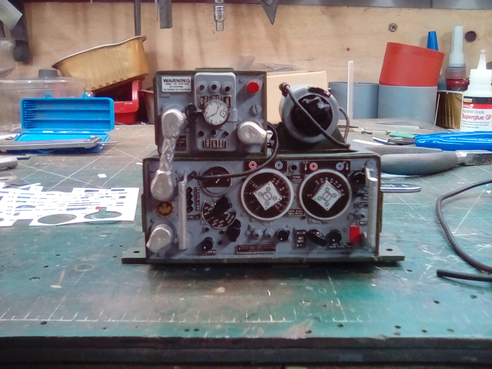

The radio bolted in but easily removable
Hand rails
Hand rails
These need fixing with Velcro
Dave do you want the front sand guards fitted?

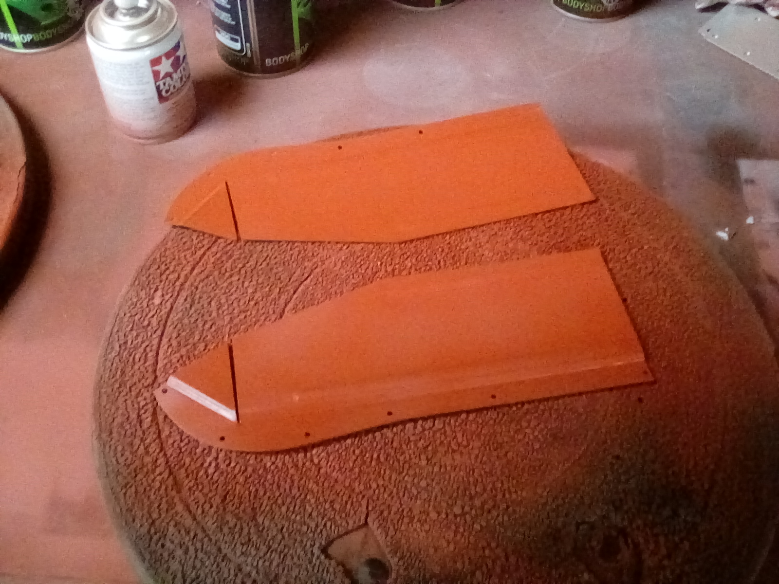

The rounded hull side tops now fitted

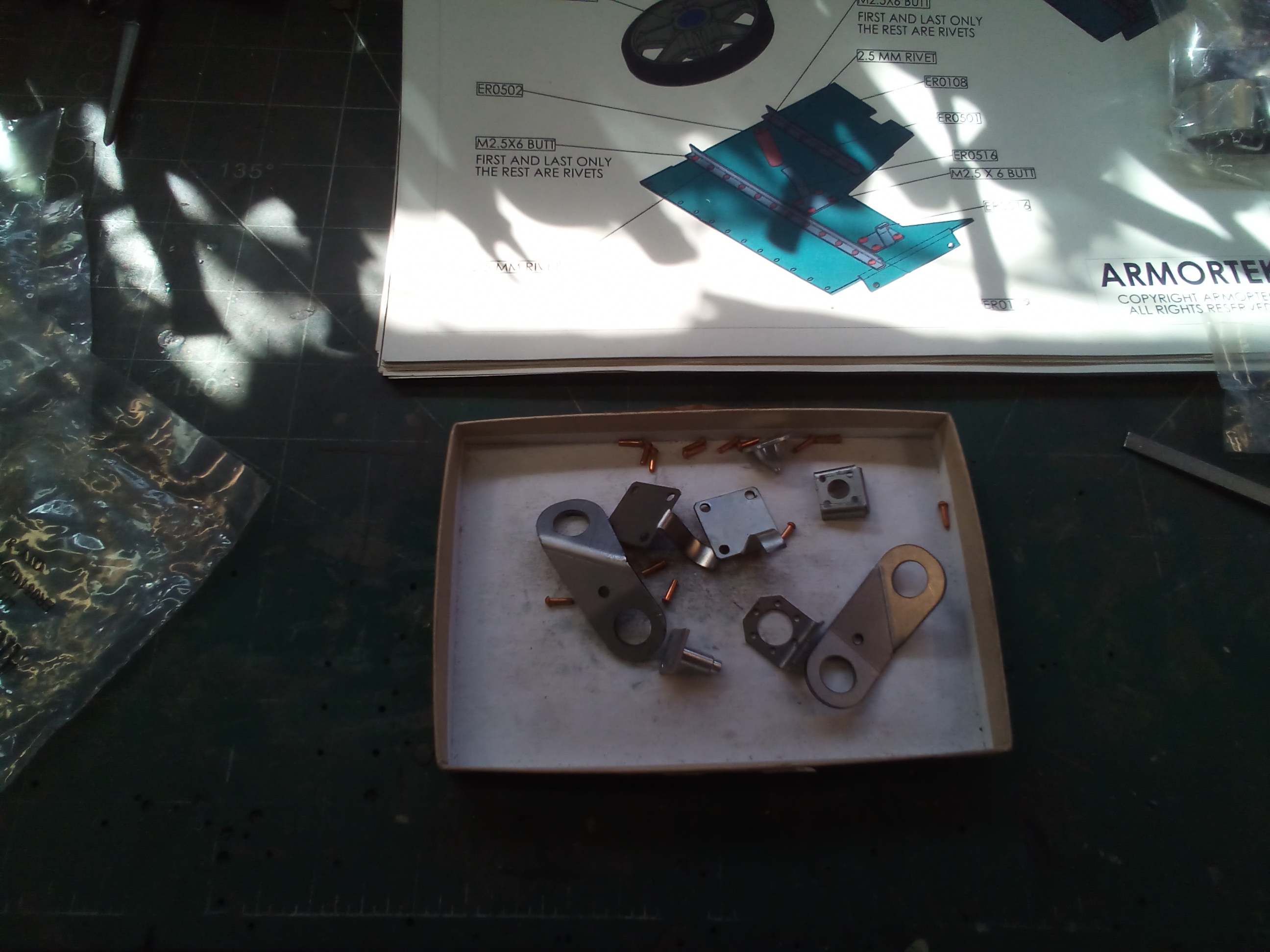

A bit more done
Final track link journal dressing maybe for the last time
A little tip, a small amount of cyno to hold the difficult to get to m2 bolts in place

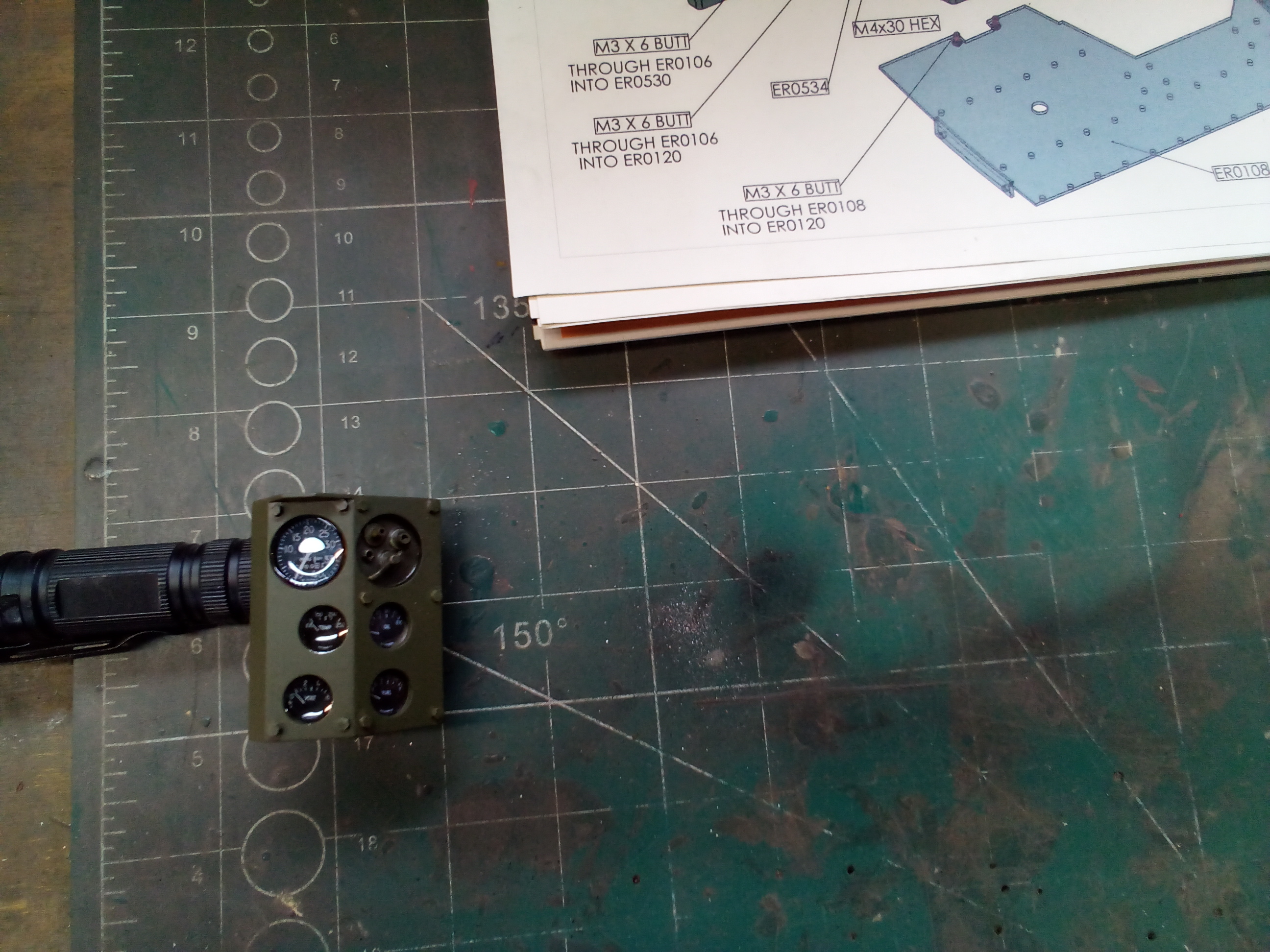

Using uv cured resin to make the instrument glass, a tip, be patient and let the resin flow out then apply the uv lamp to cure the resin, to much light and you will get bubbles!

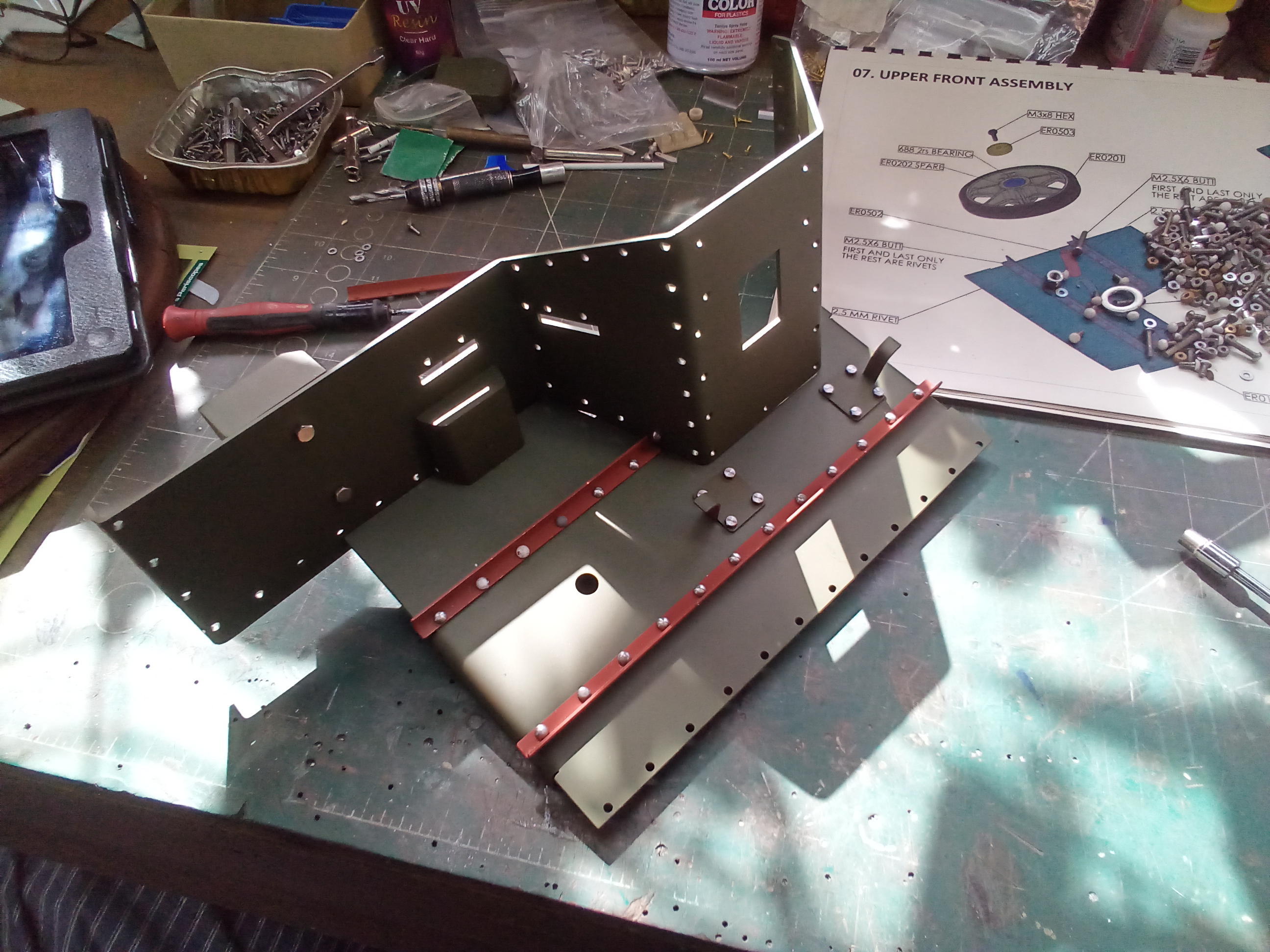

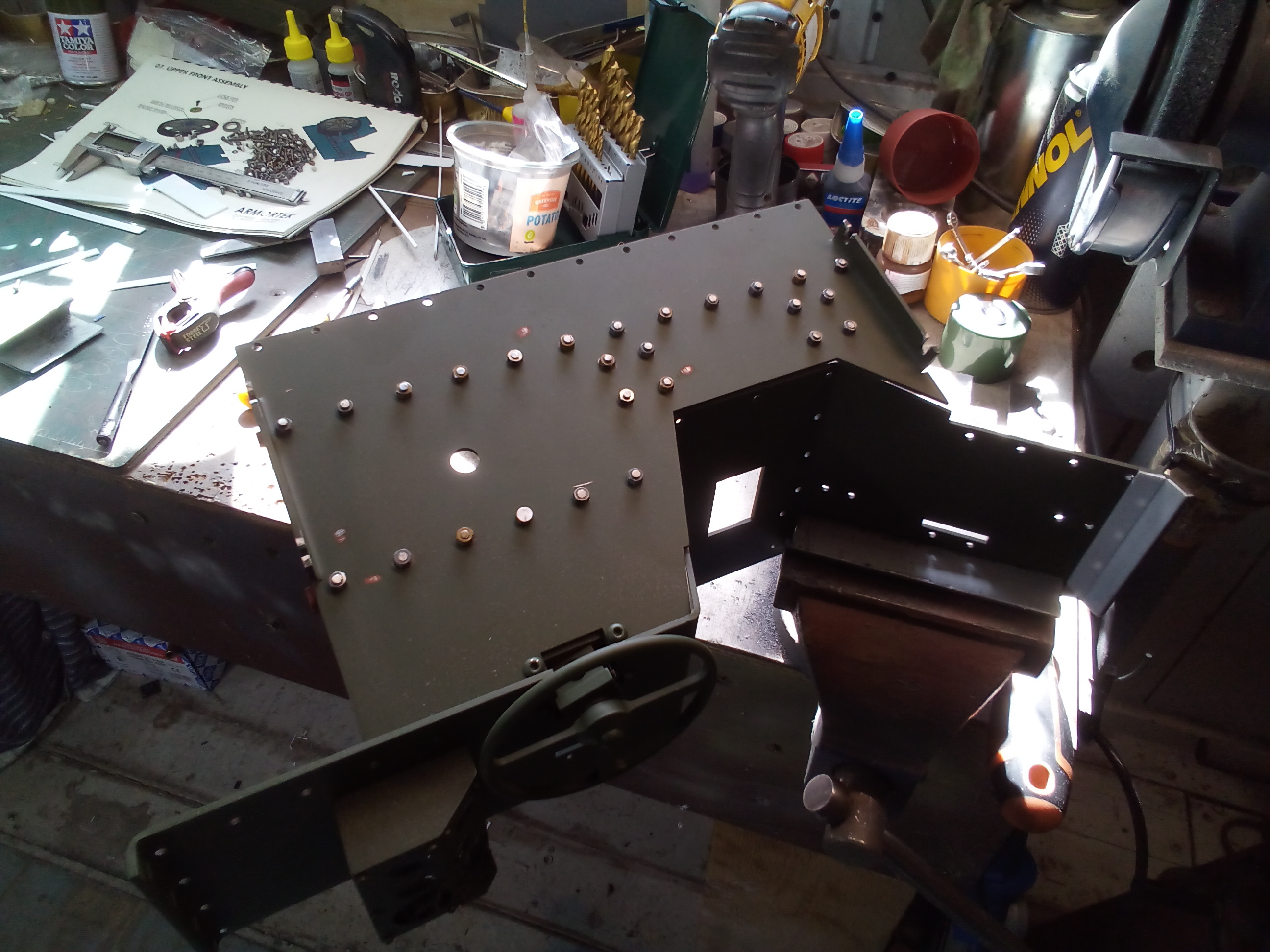

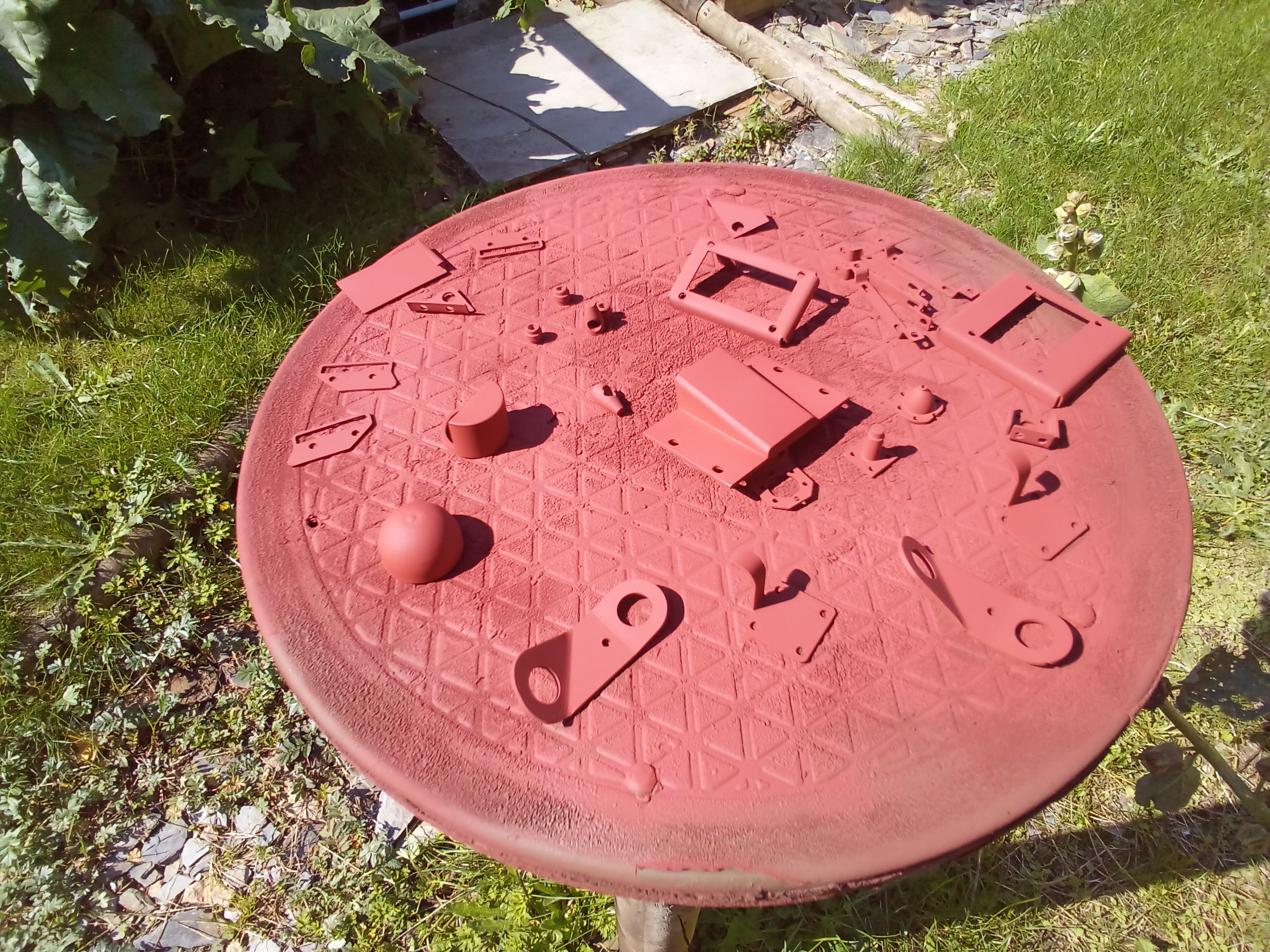

Just a couple of hours today prepping and painting the myriad of small parts associated with the front plate .
If you can get over the track fetling with this model then you will love it, there so much in such a small kit.

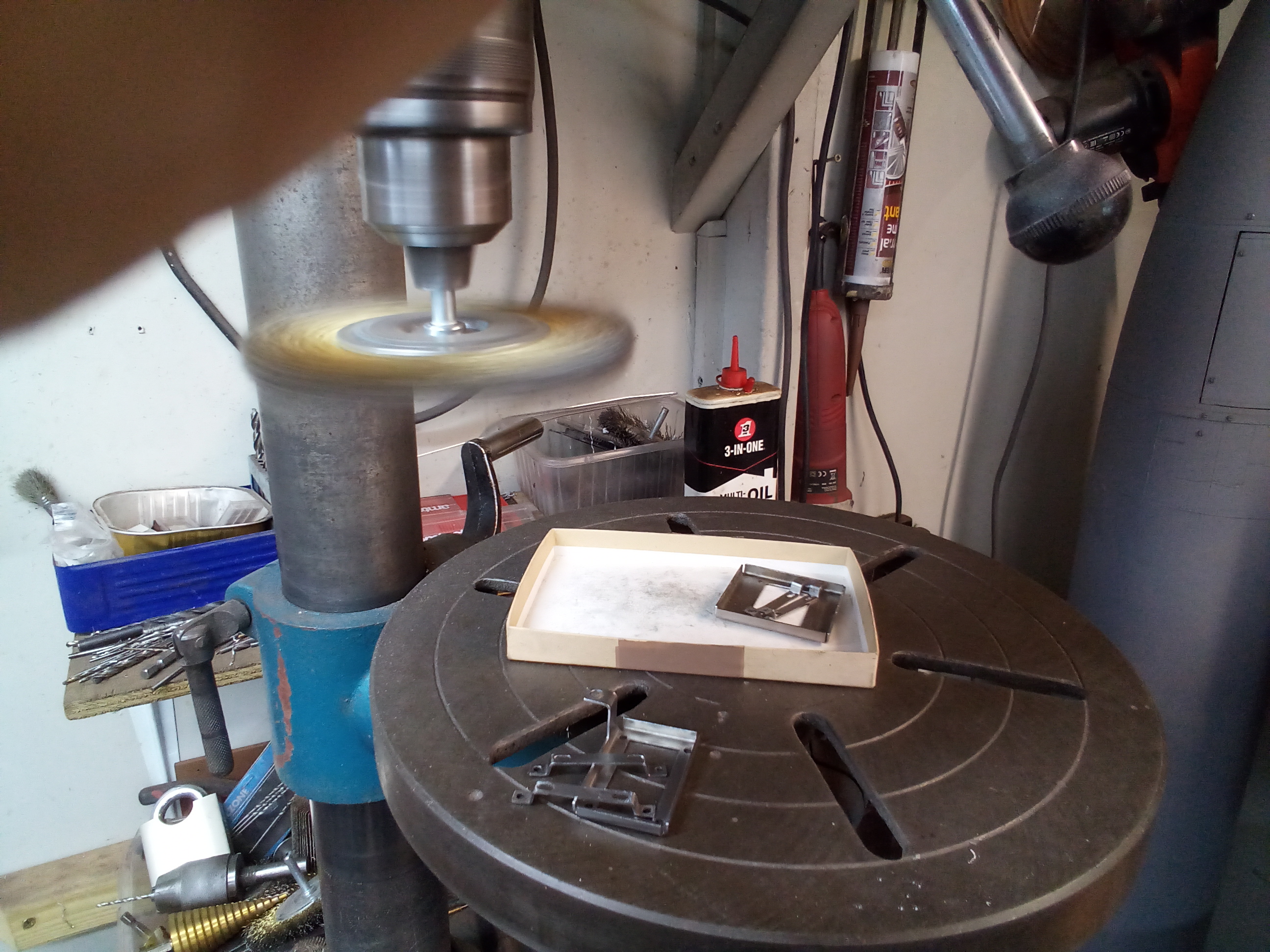

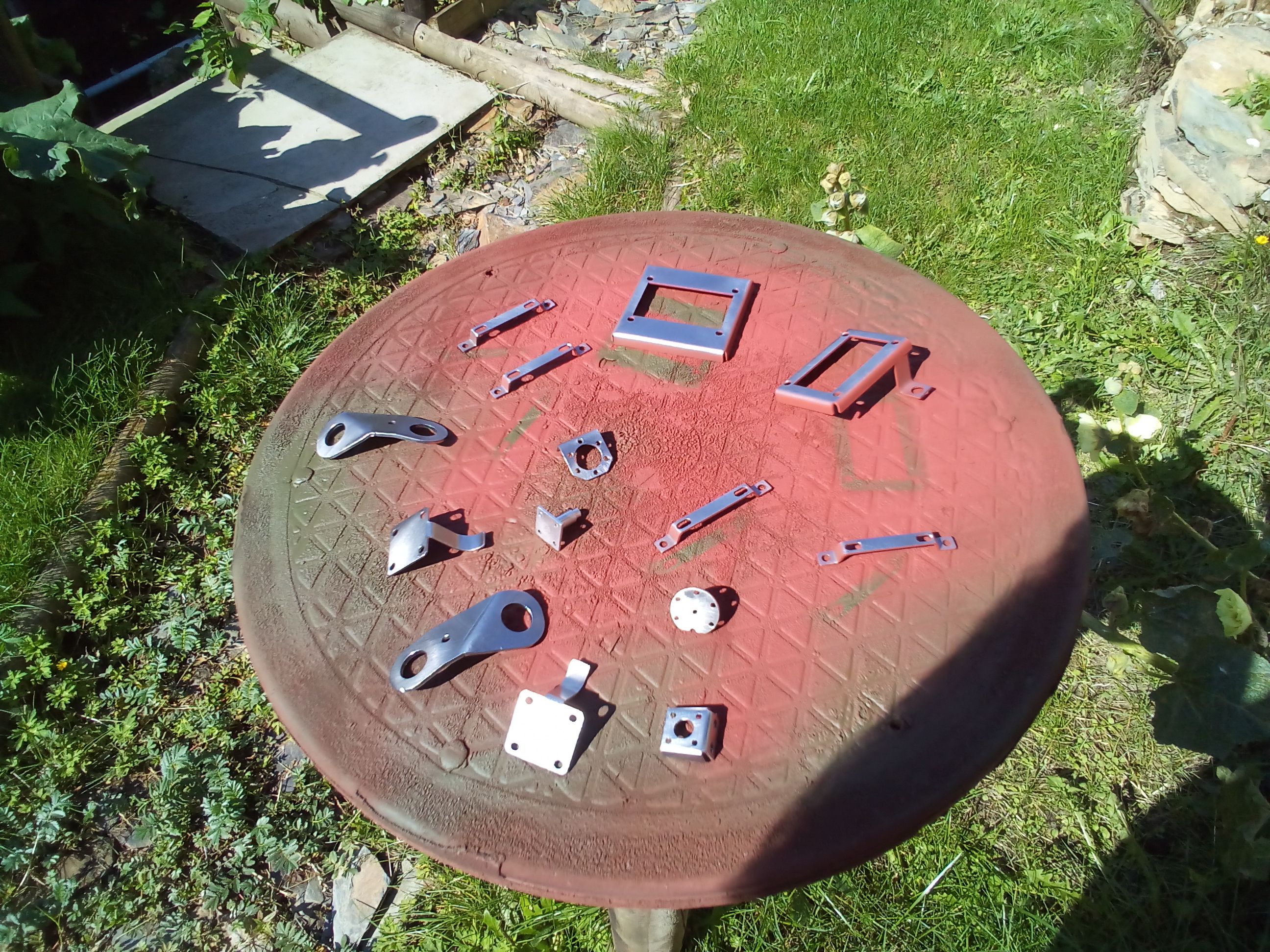

Everything goes through the brass brush treatment
Not a great deal of cleaning up to do but each piece needs a little attention

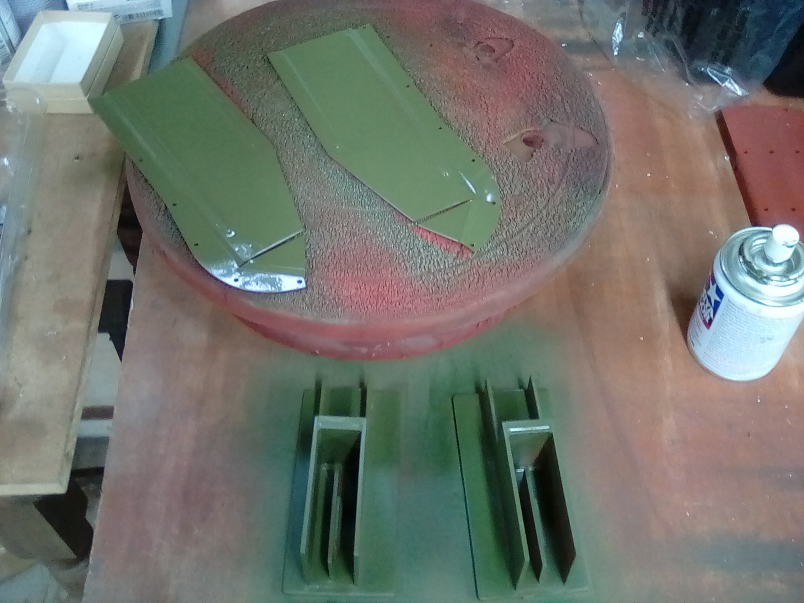

The sun was out so paint curing is so much quicker

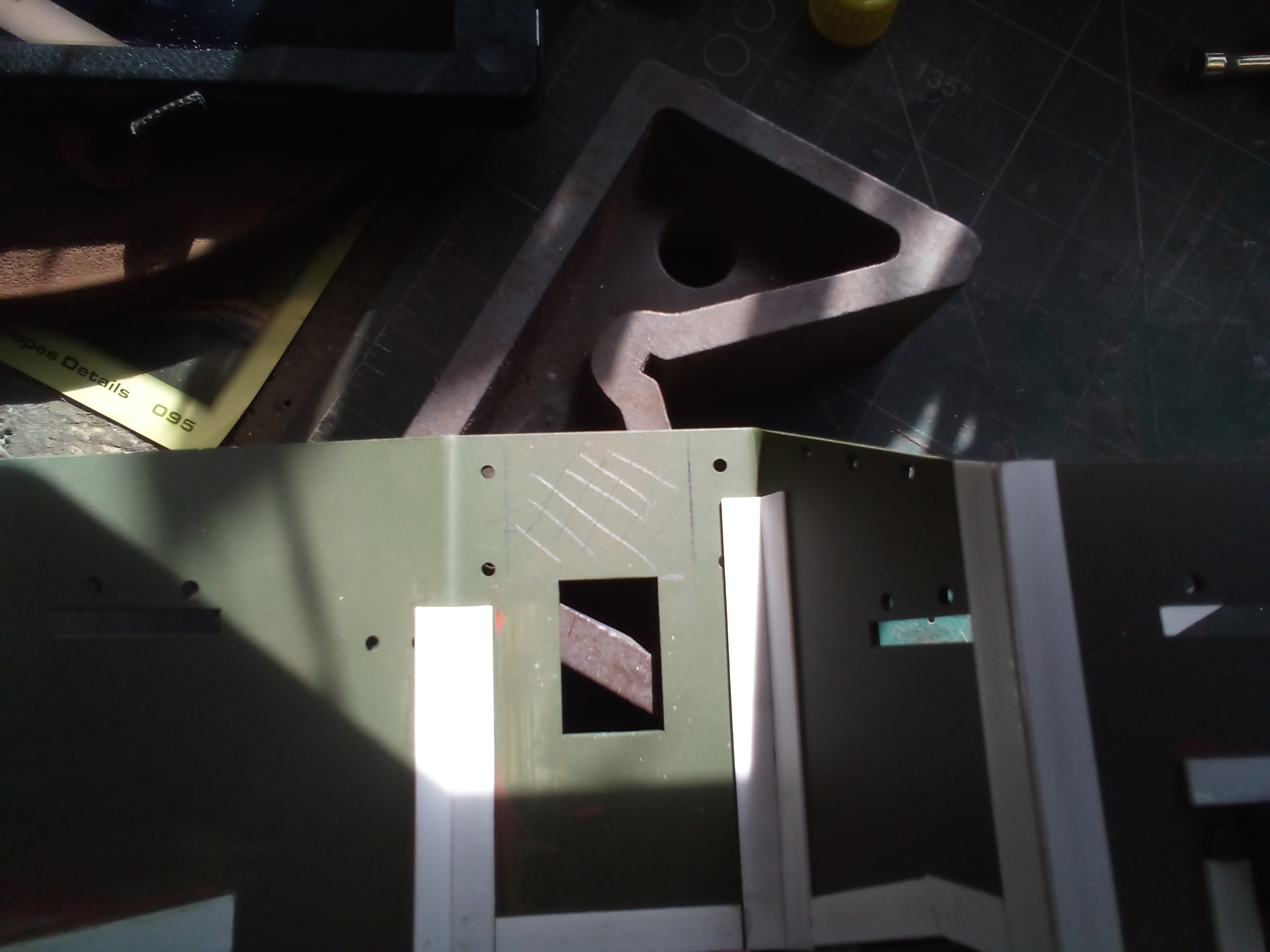

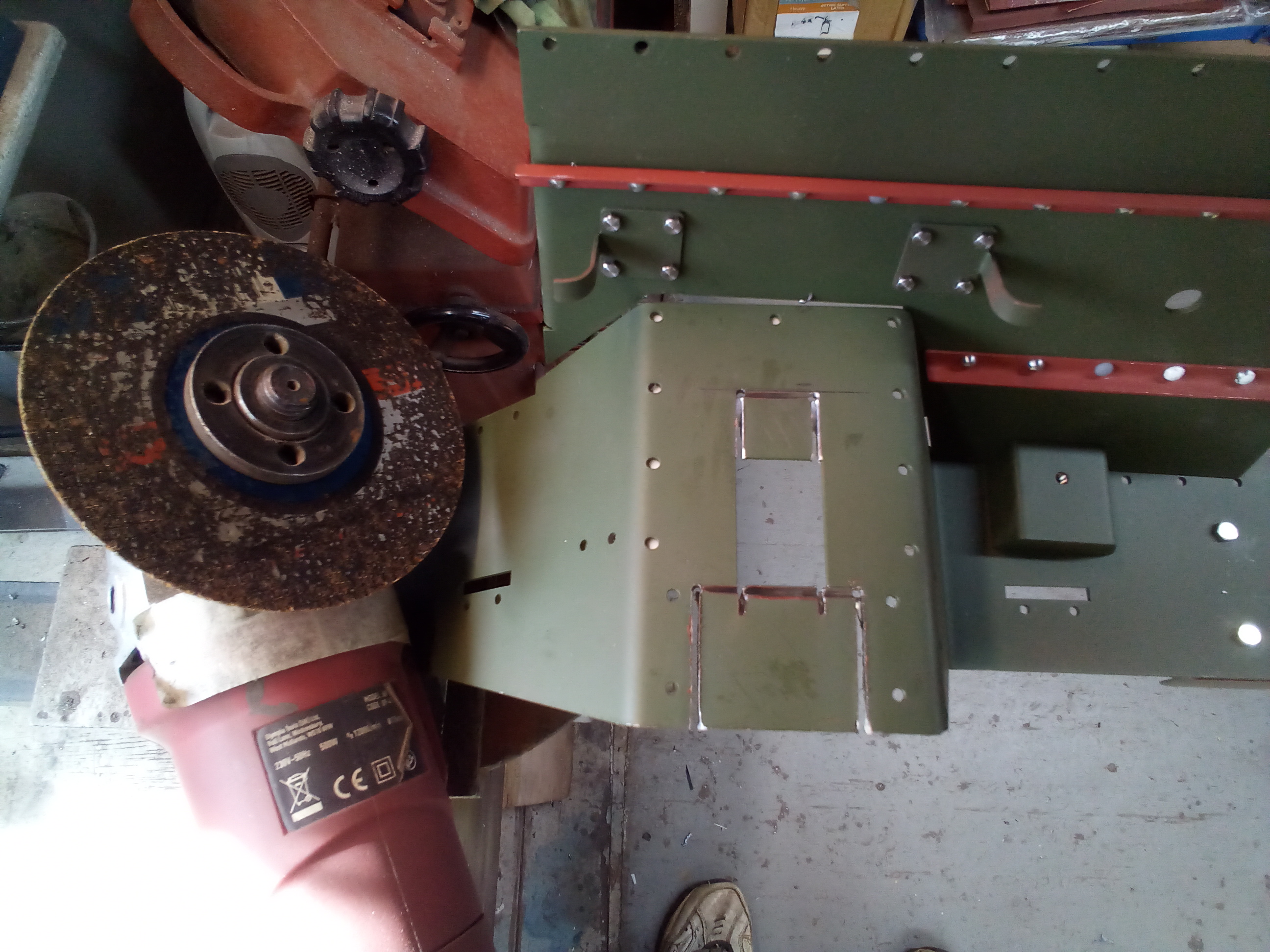

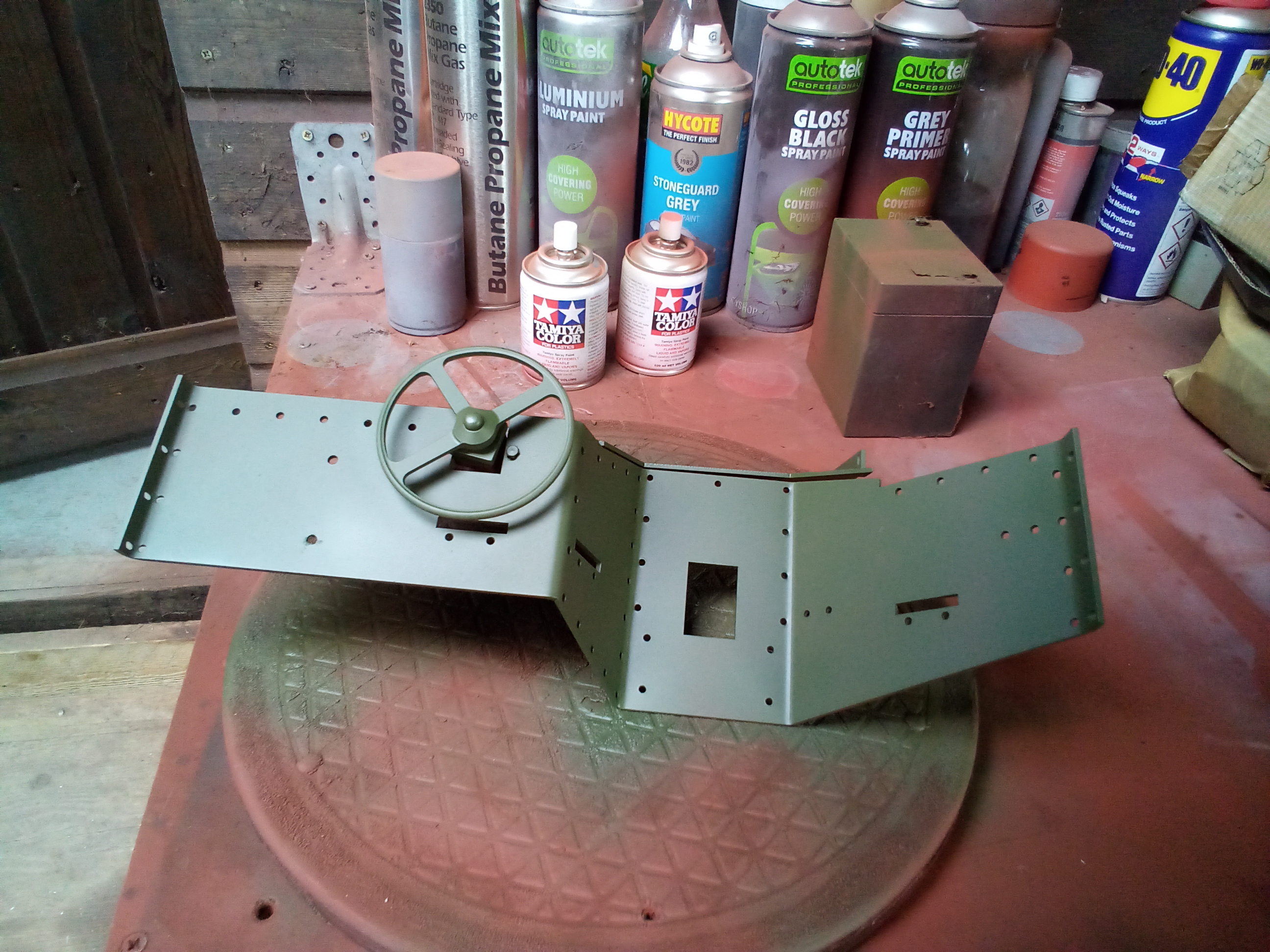

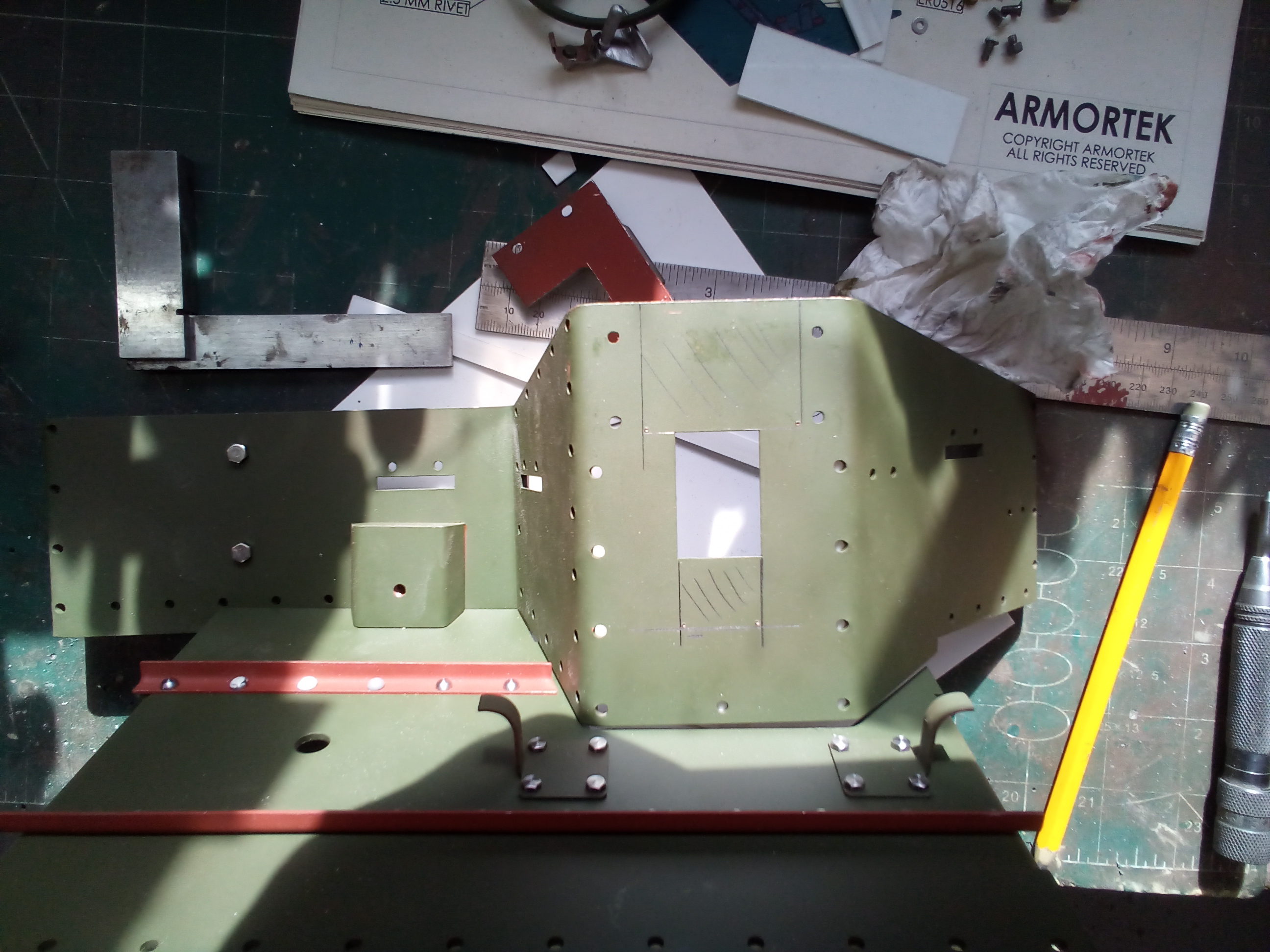

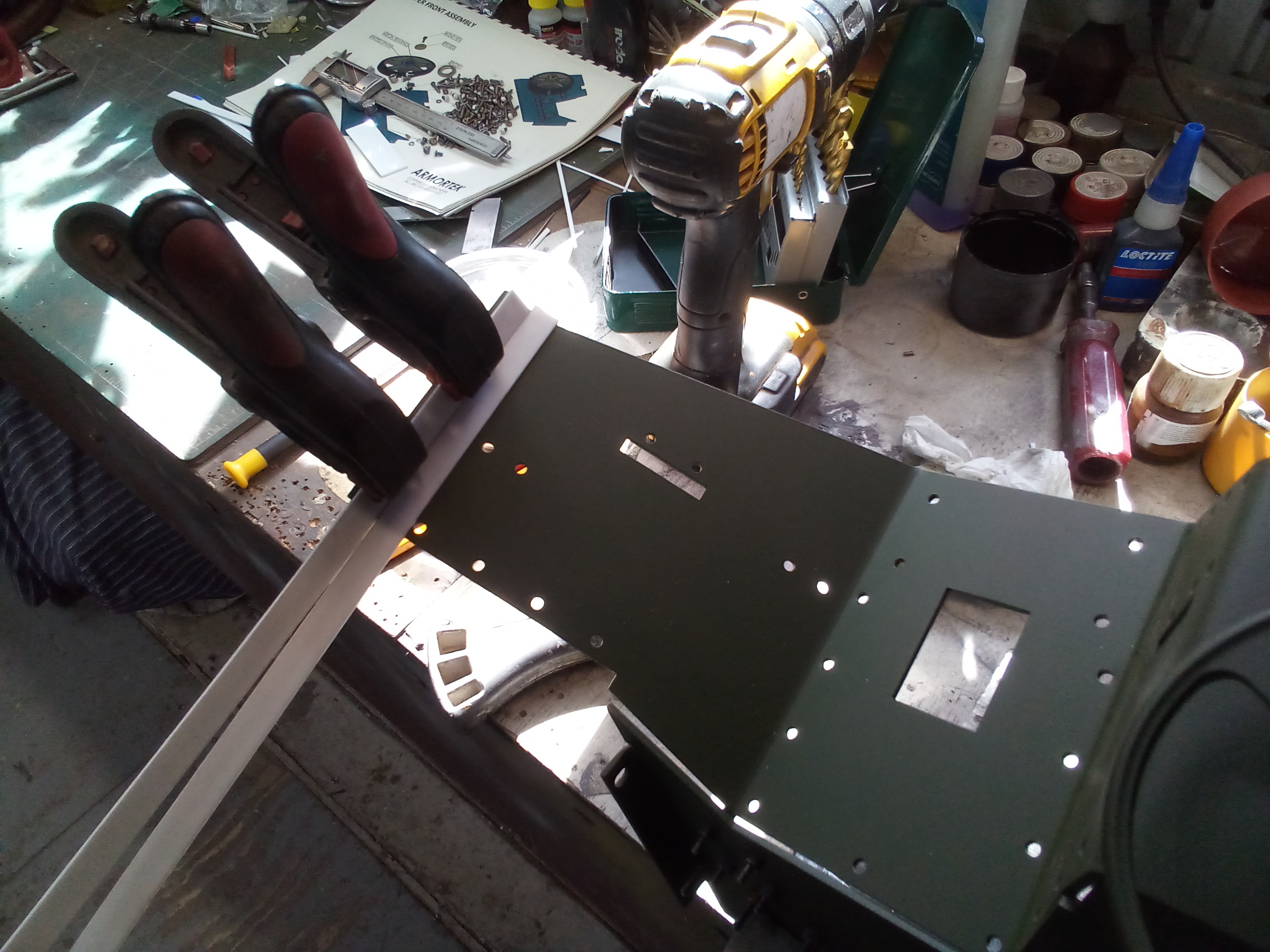

A good afternoon working on the uc
Meters of this required
An awkward piece to hold

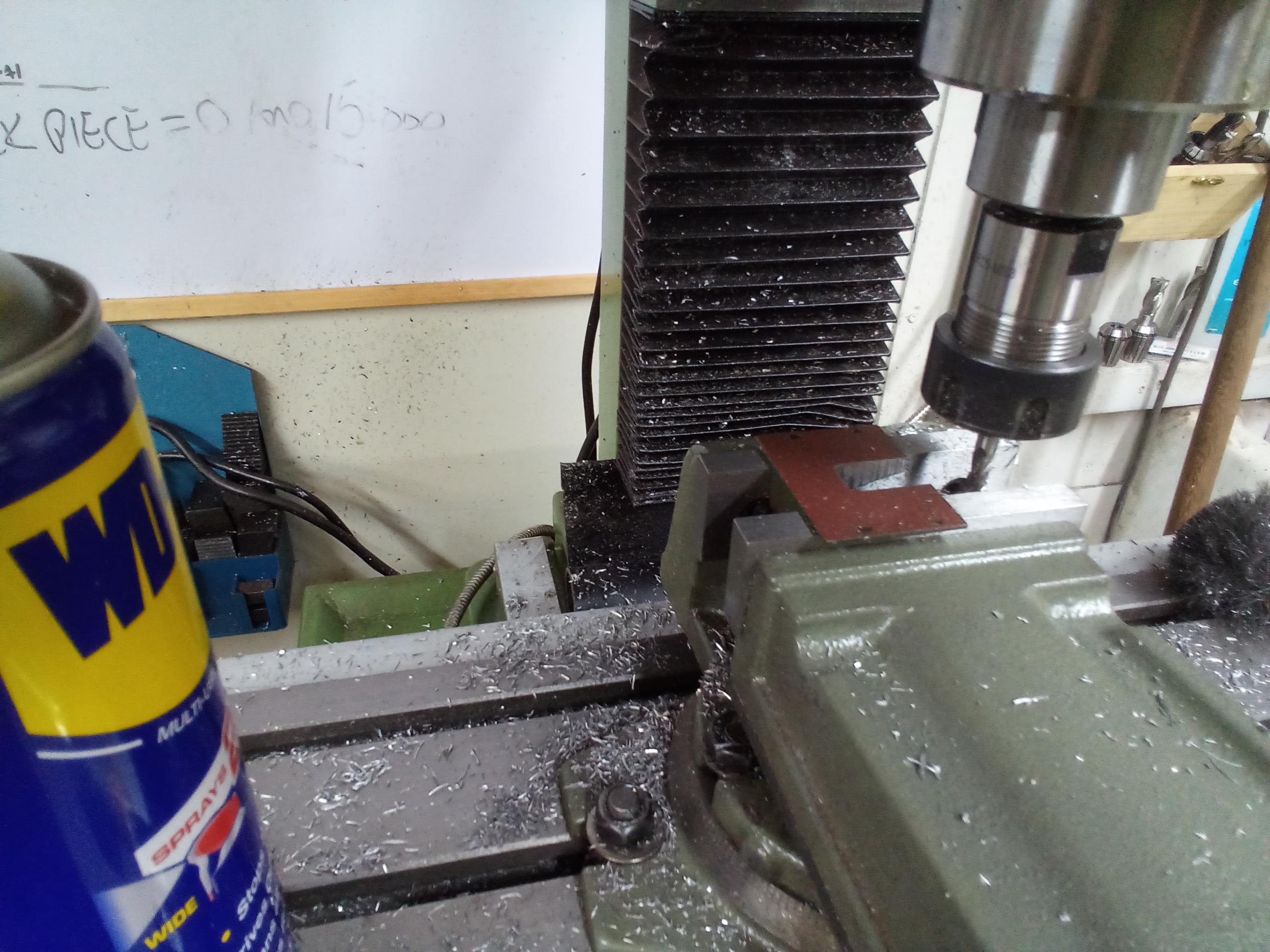

Lots of material to remove
These areas need removing
Lots of this required

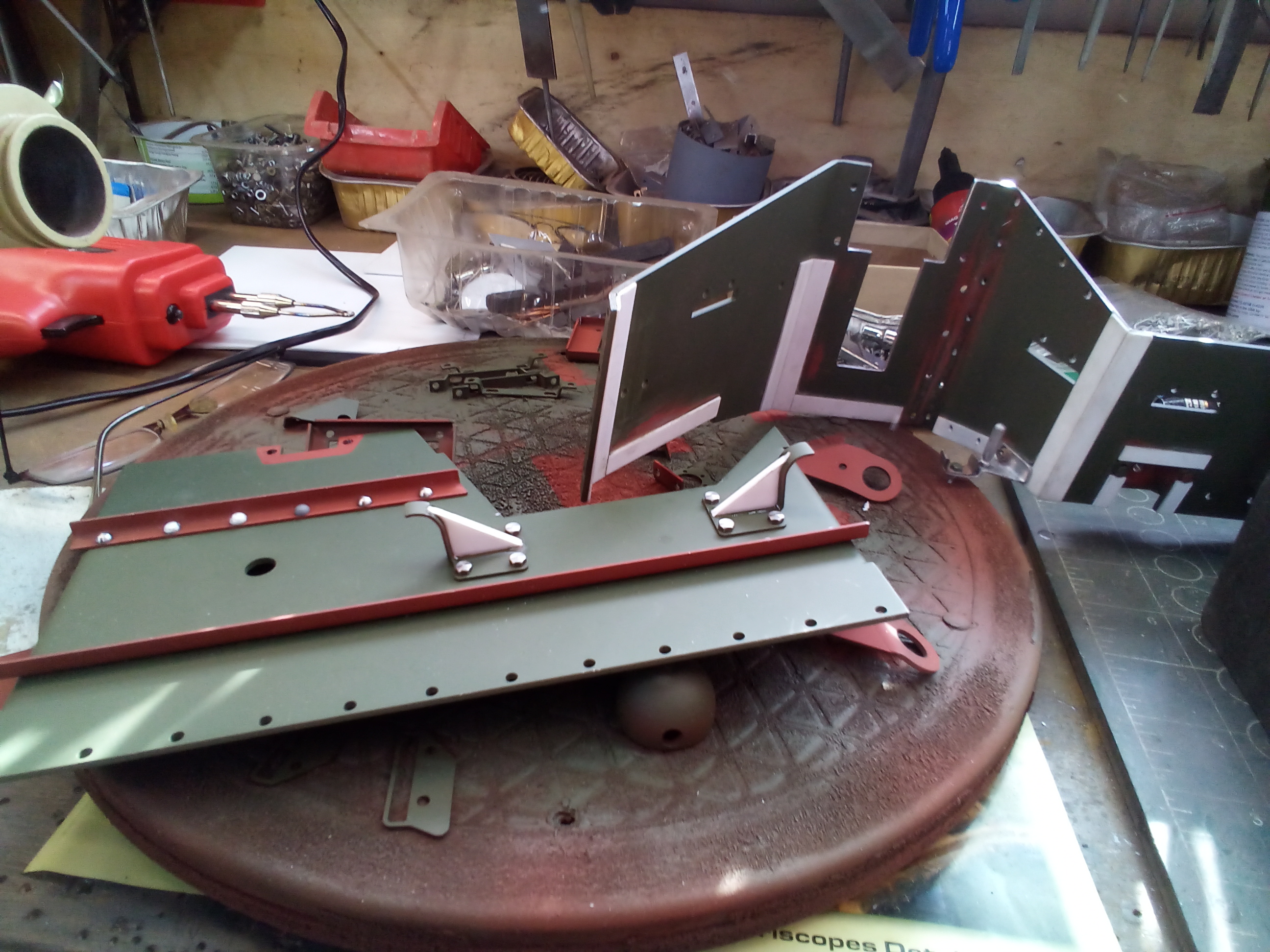

Plasticard stiffners added to the rope stowage

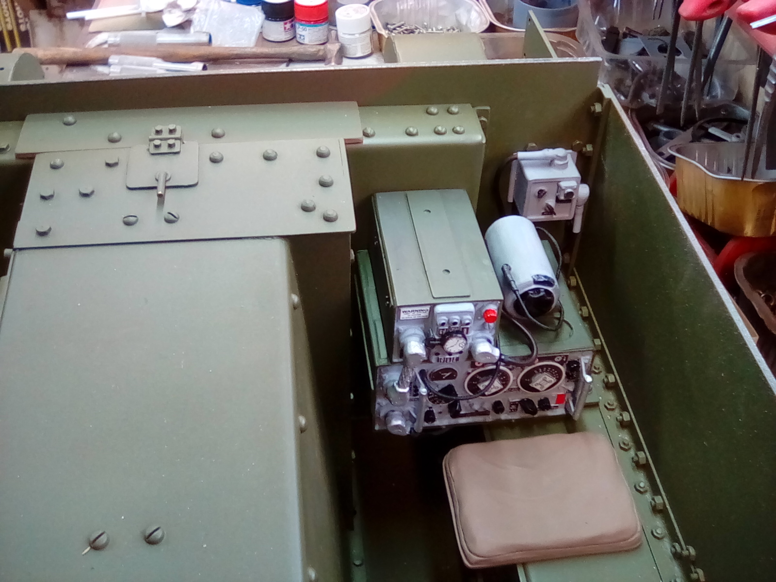

Another flap open and bren ready for action
