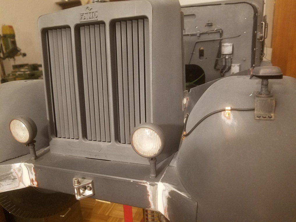

Some more details on my Famo. Many thanks to Michal for his great work at the lightning...

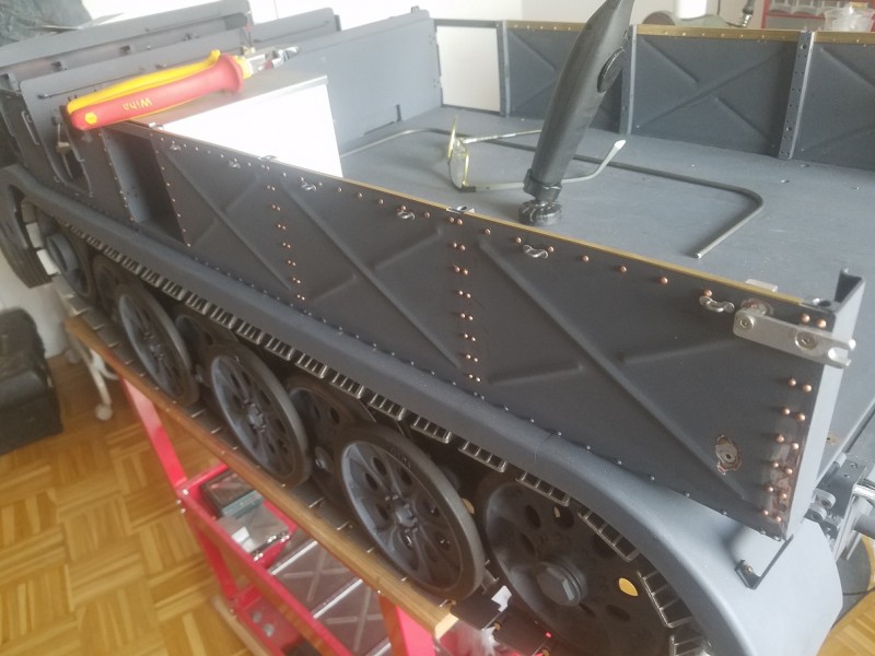

Re: Florians FAMO build

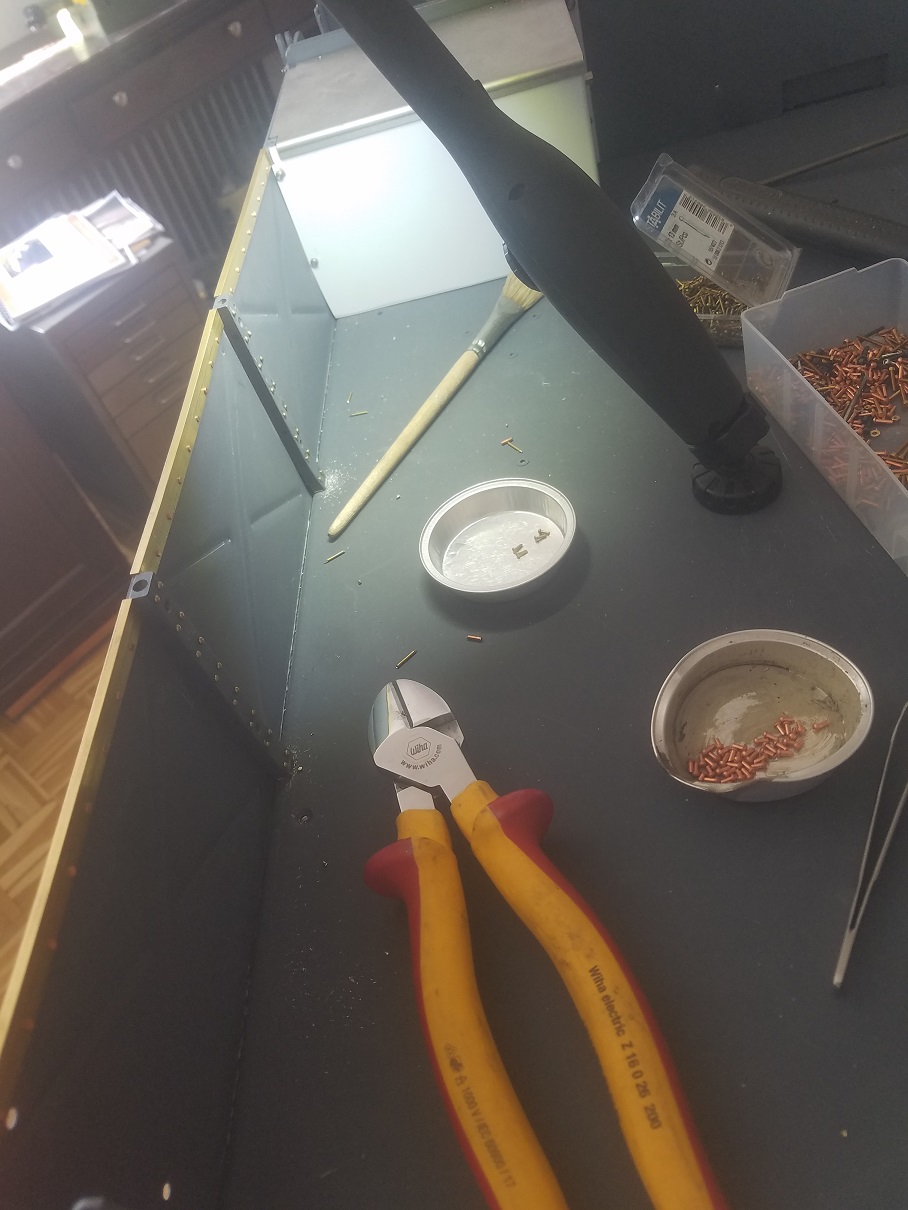

With a bit more detailing work, the Famo is getting better and better. So I installed some more rivets in the loading area.

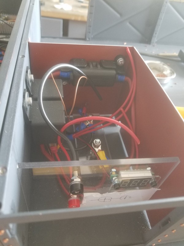

The electronic parts for the switch and controle panel is nearly finish installed. For switching the main electric I installed 2, 150A relais. One for the engine controler, and one for the other electrik. So I can switch it seperatly with smaler switches. For the safety I installed one 125A fuse for the engine controler an one 20A for the rest.

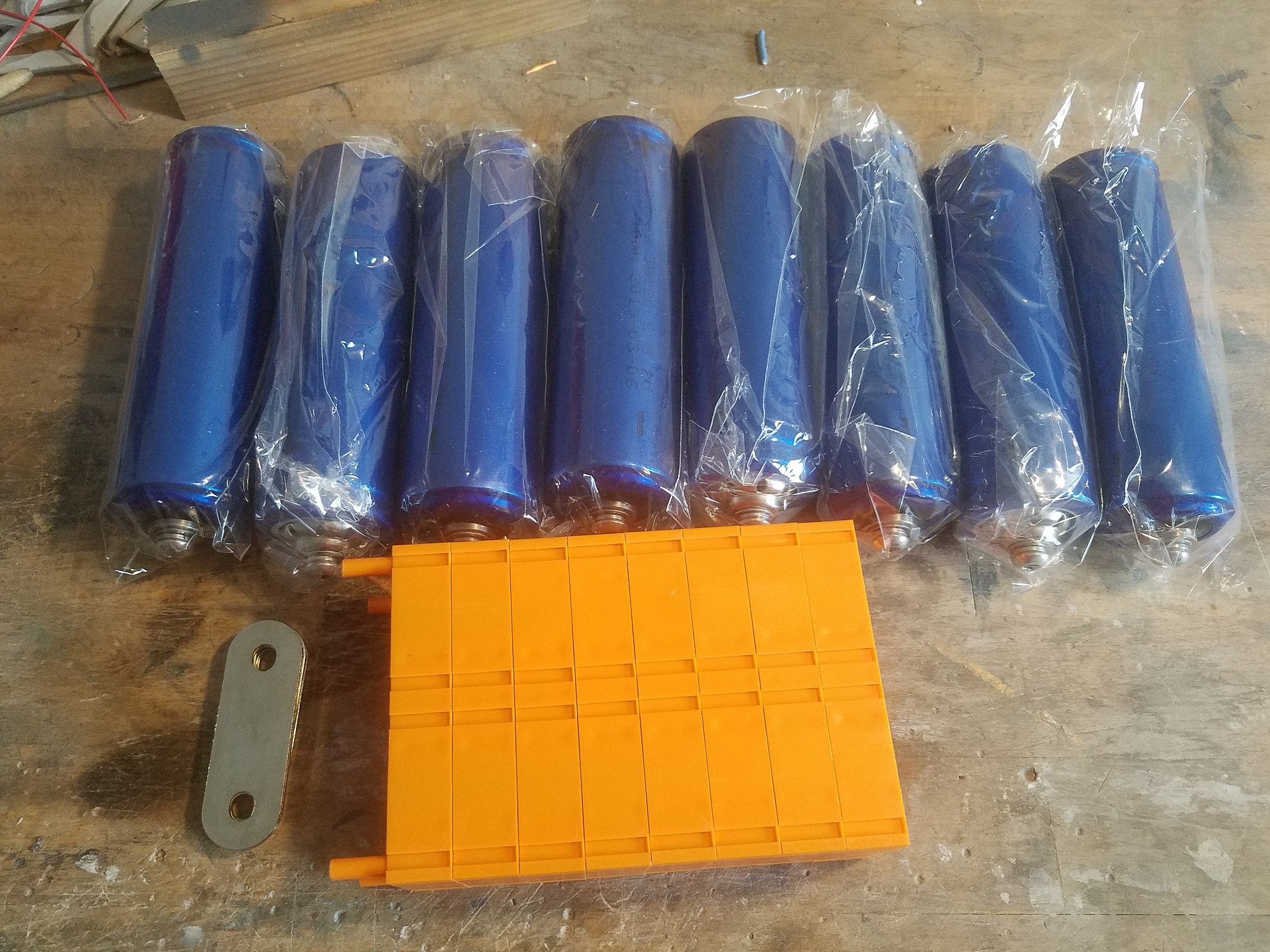

Hello guys,
yes I am still alive. Had much other things to do, so I could'nt work on the Famo. Fortunatly the weather is going sick, so I will do something inside.
I ordered some parts and plan some special

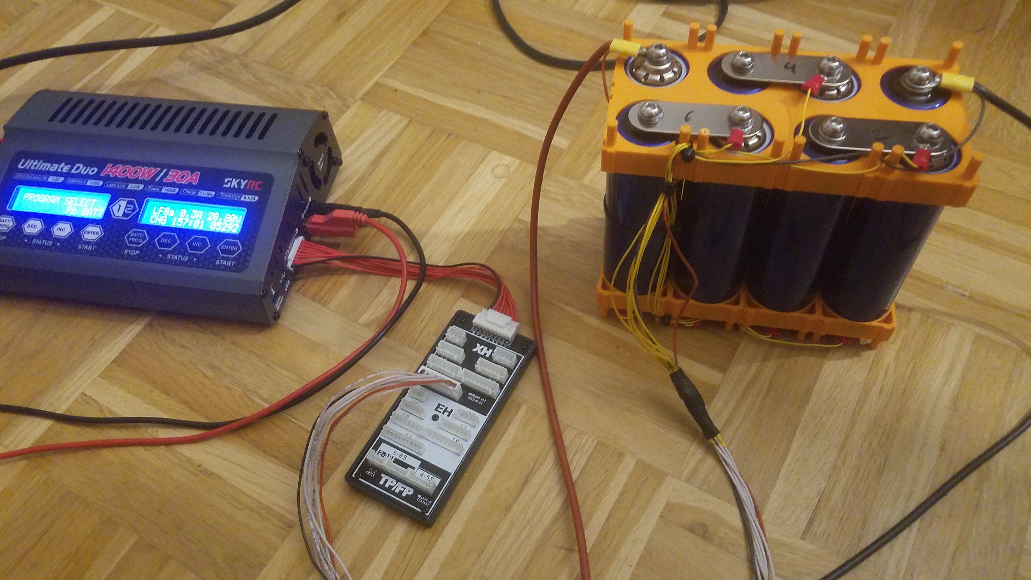

At first I ordered a kit for my powerpack to build.
Its LiFePo4 with 10Ah. I think thats enough power for the Famo and the battery is also not so heavy.

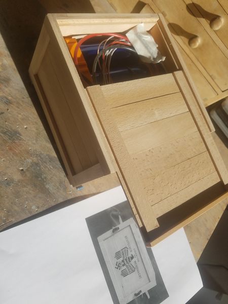

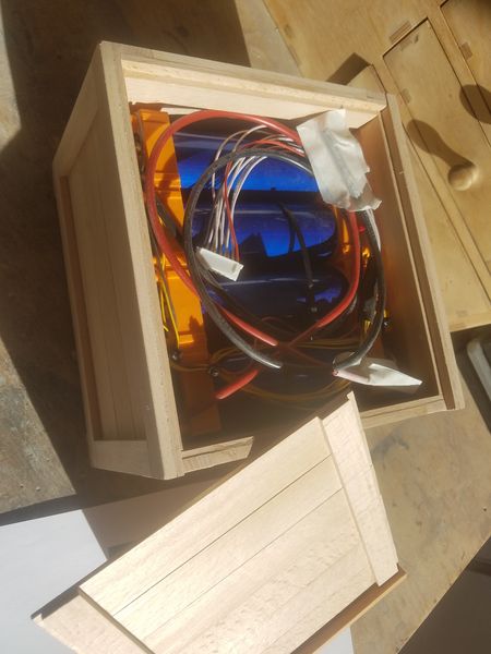

Yes indeed. the LiFe Power is awesome.
Well in the last view days I did some work on the batery box. what would you think it going to bee? - Tipp its from a movie... The original Famo i mkae was in north Africa

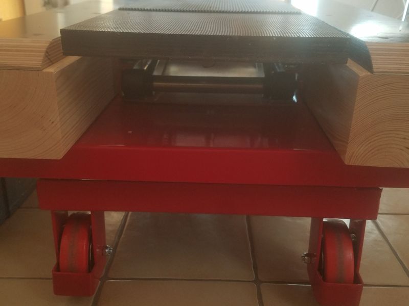

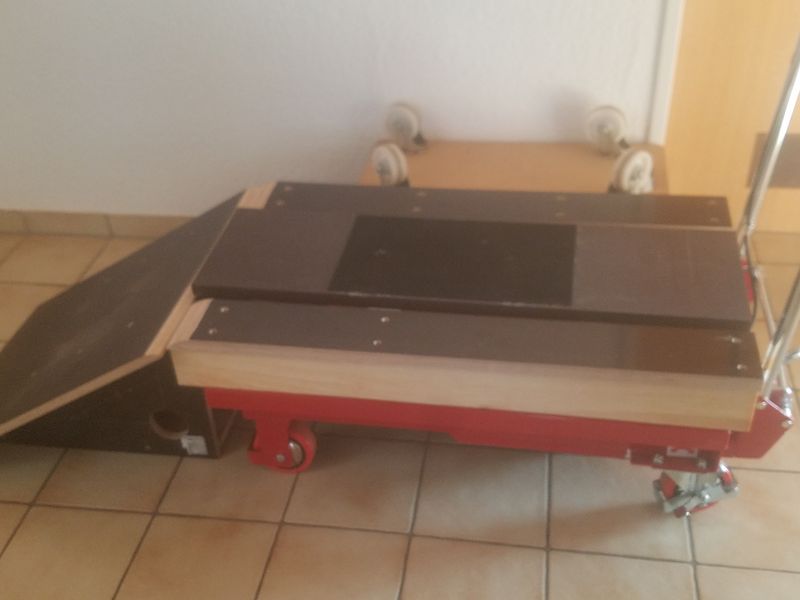

The next I made the lifter for this monster
Florian, that crate is excellent. No doubt you had some TOP MEN working on it!?
- Has liked: 792 times
What a beautiful wooden crate. Reminded me of the film "Raiders of the lost ark".
- Posts: 678
- Has liked: 297 times
- Been liked: 645 times
Yes thats ist.
I build all by my own all by my own
Than I know its right build
