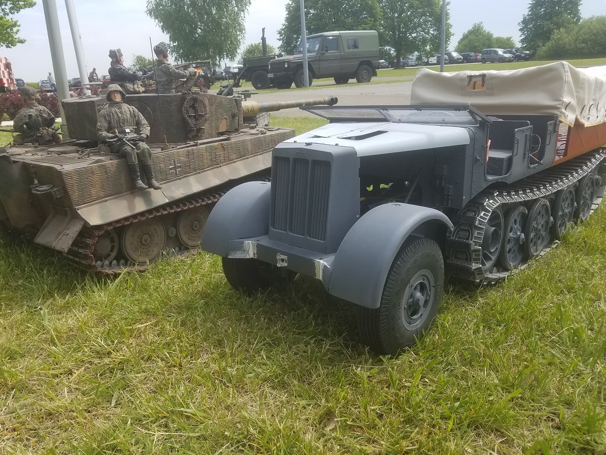

Re: Florians FAMO build

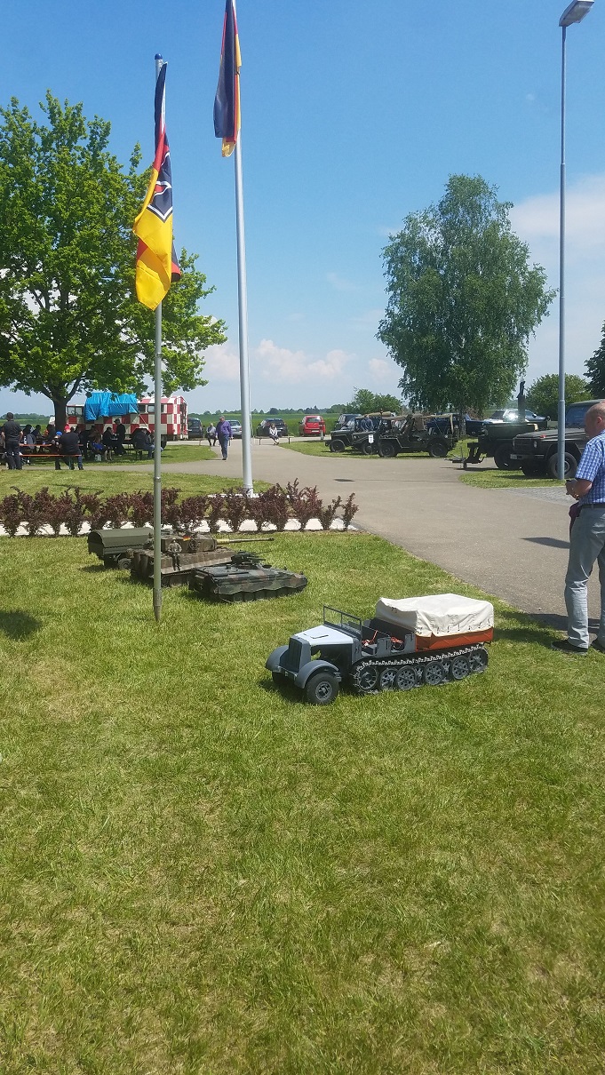

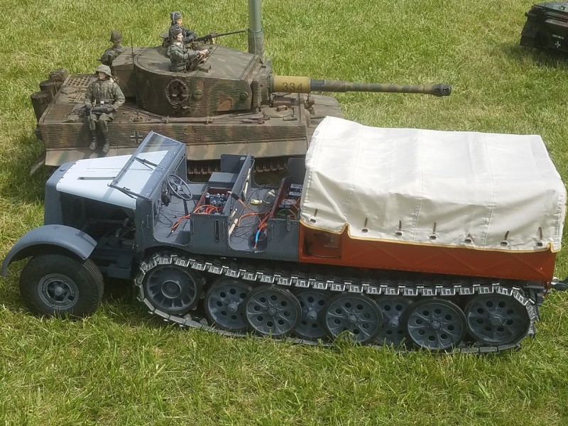

The first roll out.
I remember some problems at my Sdkfz251. The same I have with the FAMO.
I have to do some work at the track. Also some electrik problems, but nothing difficult.

So nice to see your Famo out in the sunshine, she's looking good

Hi Phil,florian rudolf wrote: ↑Mon May 27, 2019 12:08 pmThe first roll out.
The FAMO looks good.
I reckon two 12V batteries were laid on the cargo area. Is there any photo of them?

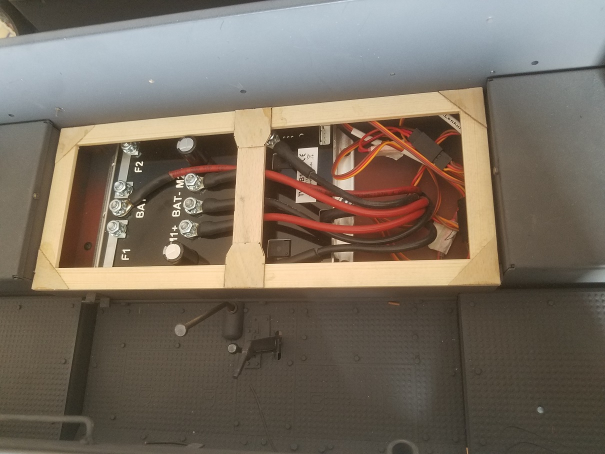

Hello Chang,
I make another solution with the battery. In one of the stowage boxes are the switches, the other one get the 'original' inside...
its only one 12V akku each stowage box. This are smale LiFePo accus I think. With only 6 or 7 Ah.
I want ti install an 24V / 12Ah accu.
Florian
Florian

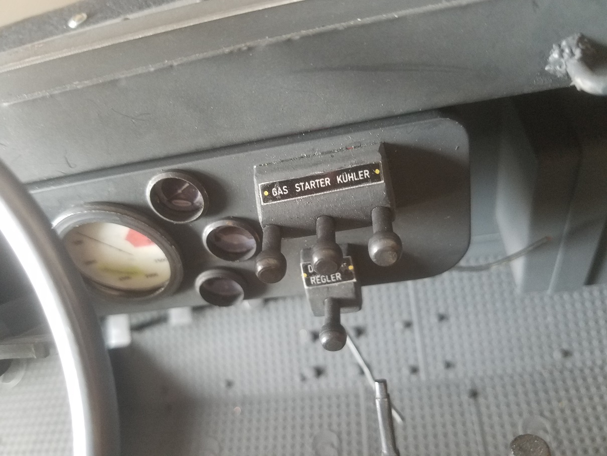

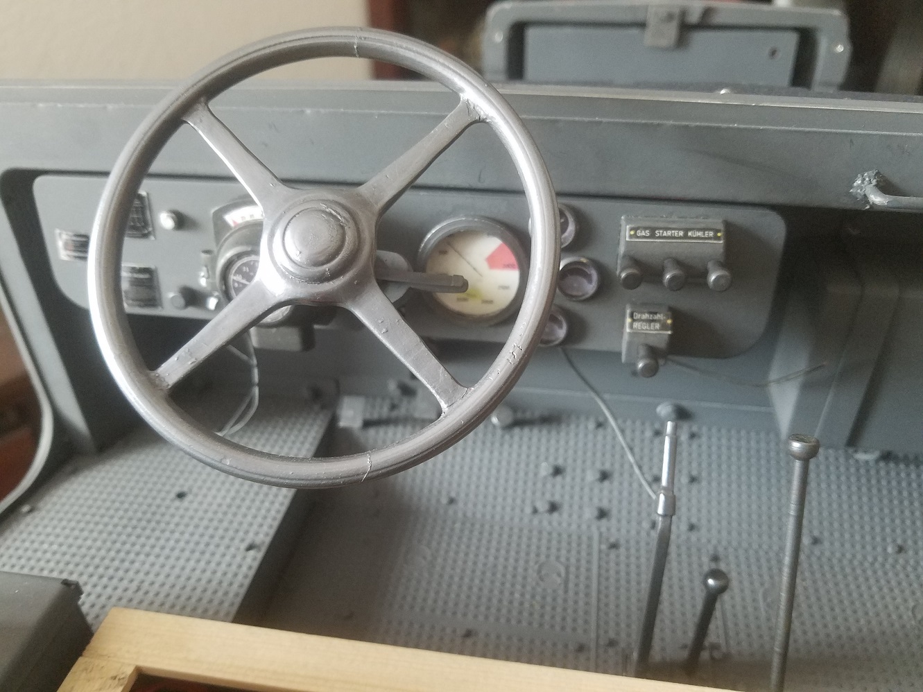

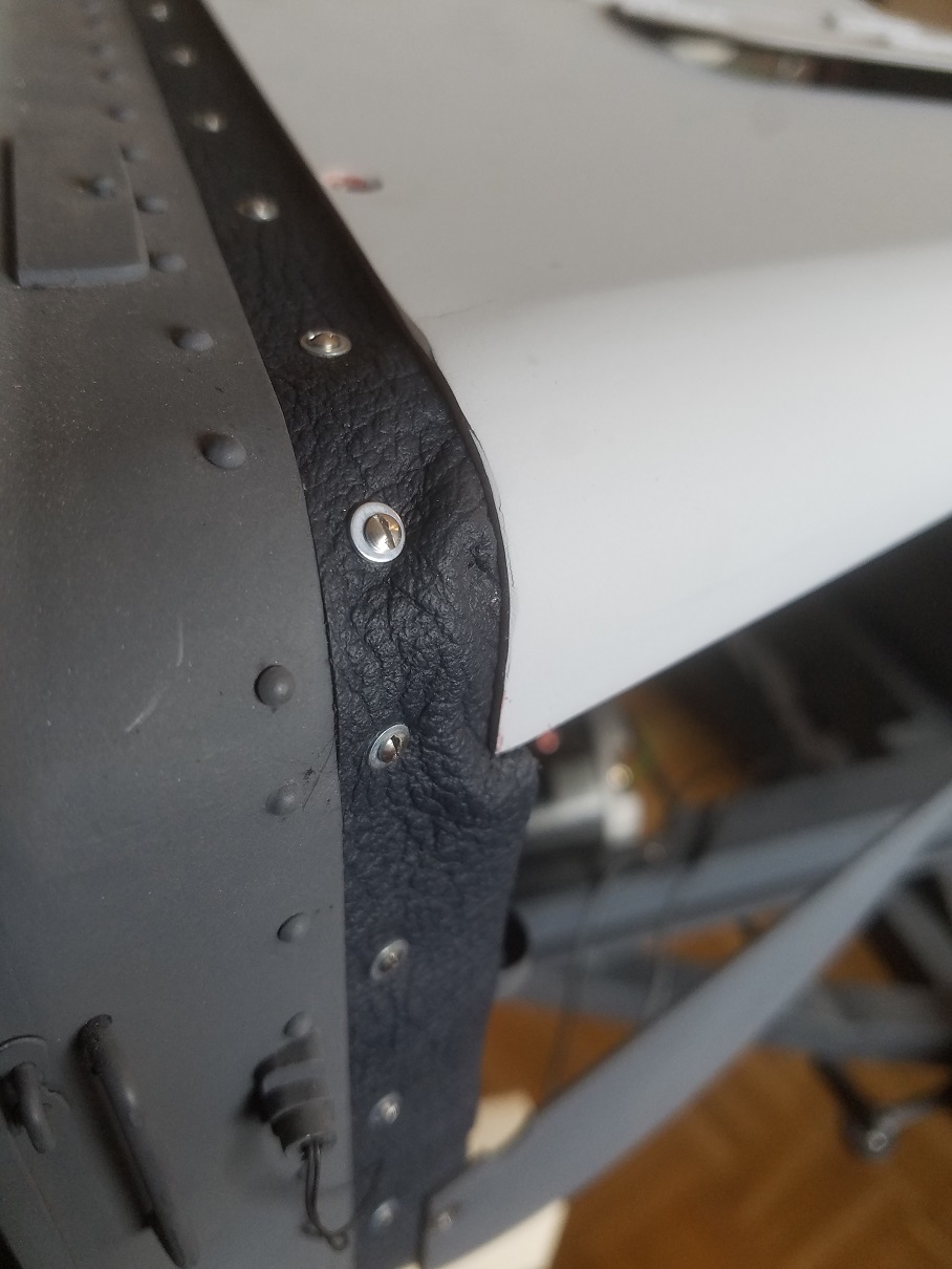

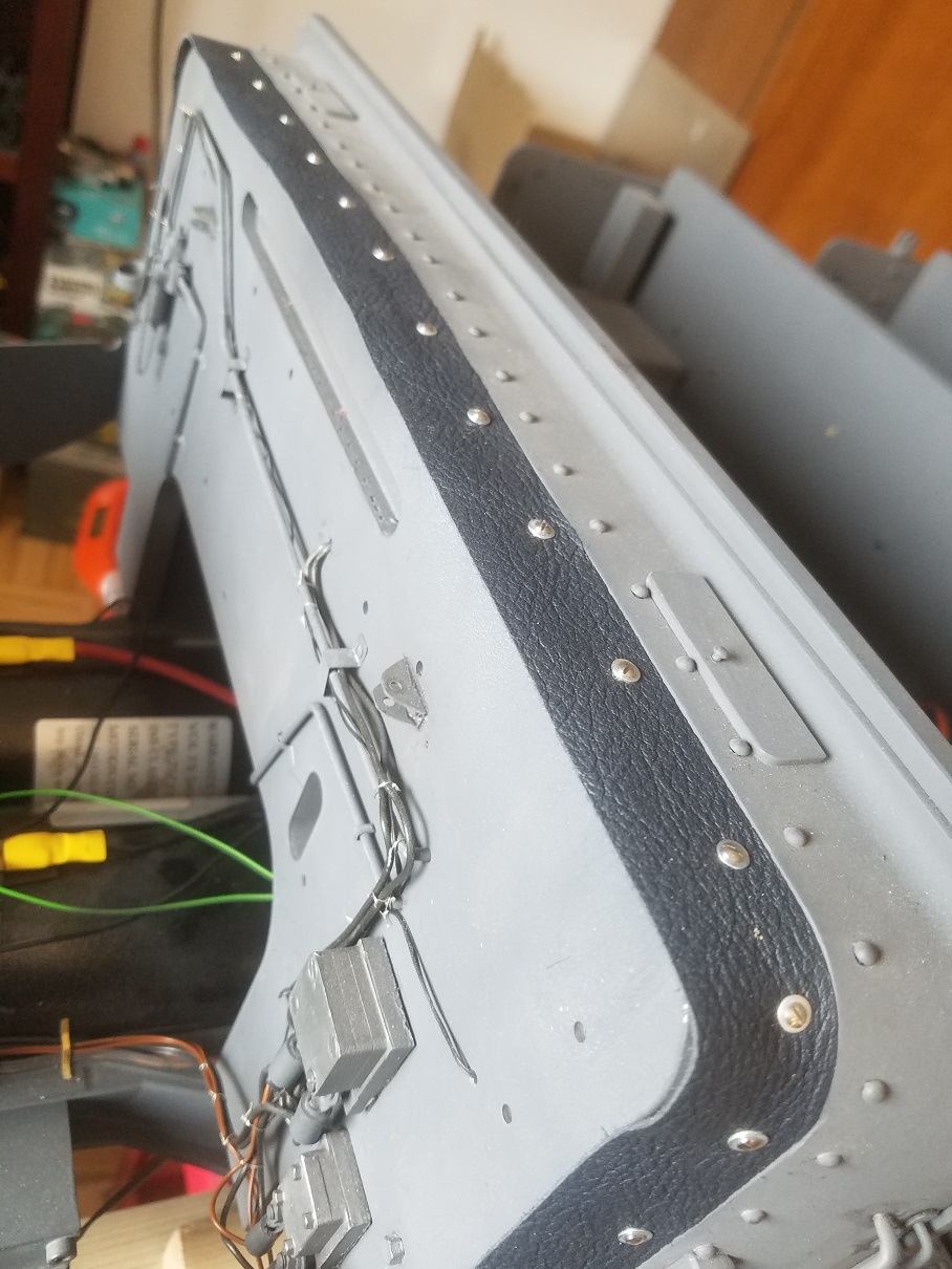

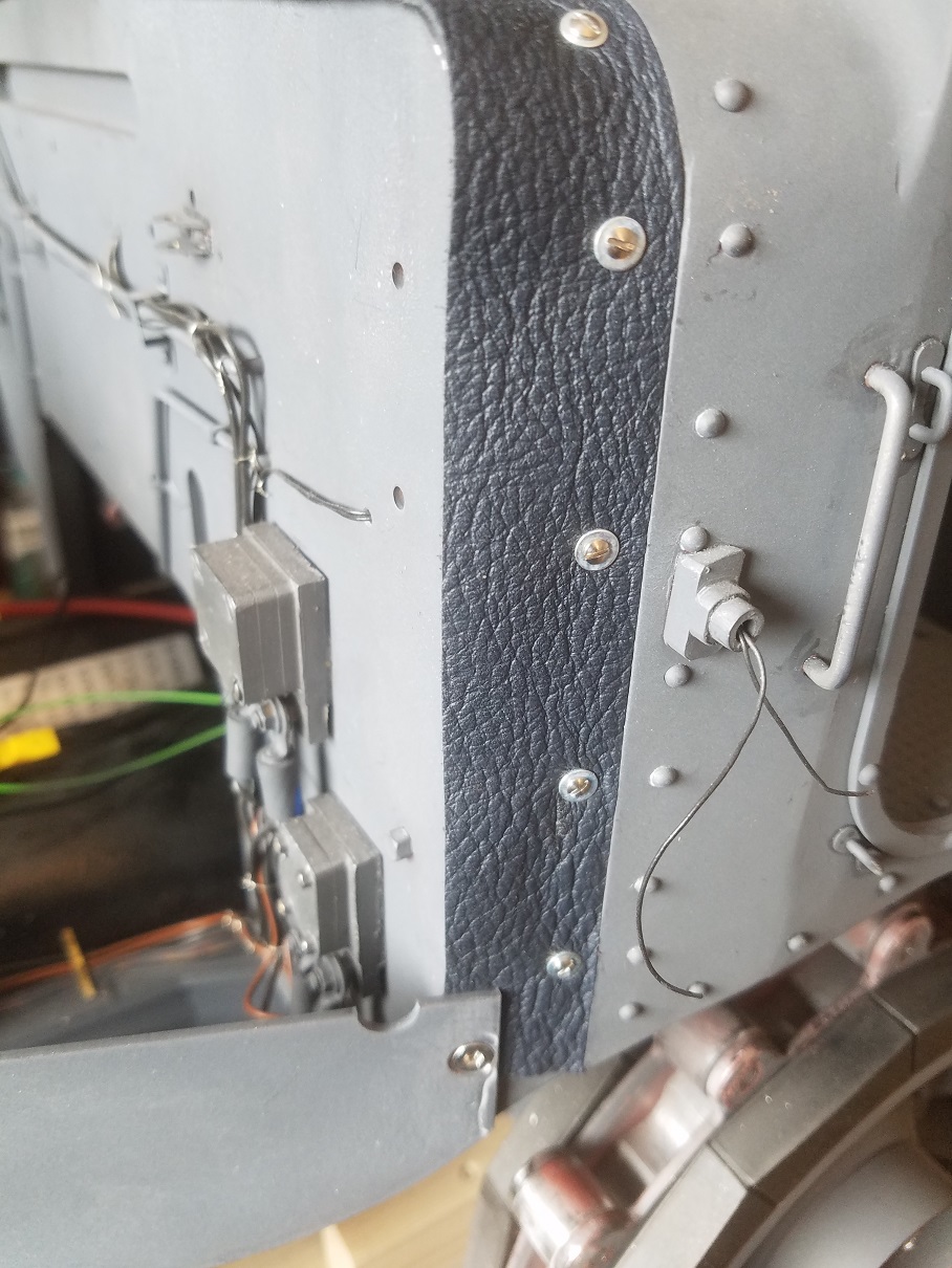

I had some time to build a little more details on my FAMO.
so I made the frame for the drivers seat, and while having a good friend is saddler, I've got some thin leather in the right color for the poetry between the fire panel and hood...

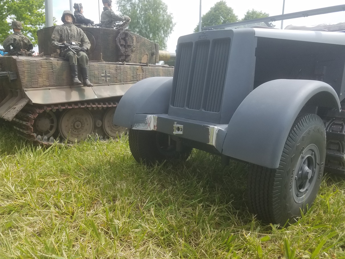

At my first roll out I noticed some problems with the track. The same I had with my SdKfz 251. So I have to modify my track a bit.

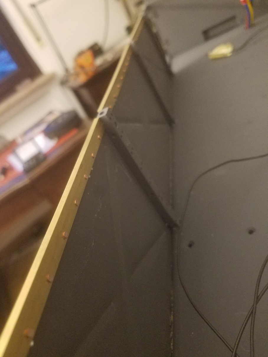

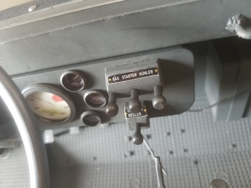

Some more details finised and fixed at the model.
If my modified tracks are complete and at work, I'll make some photos of that.

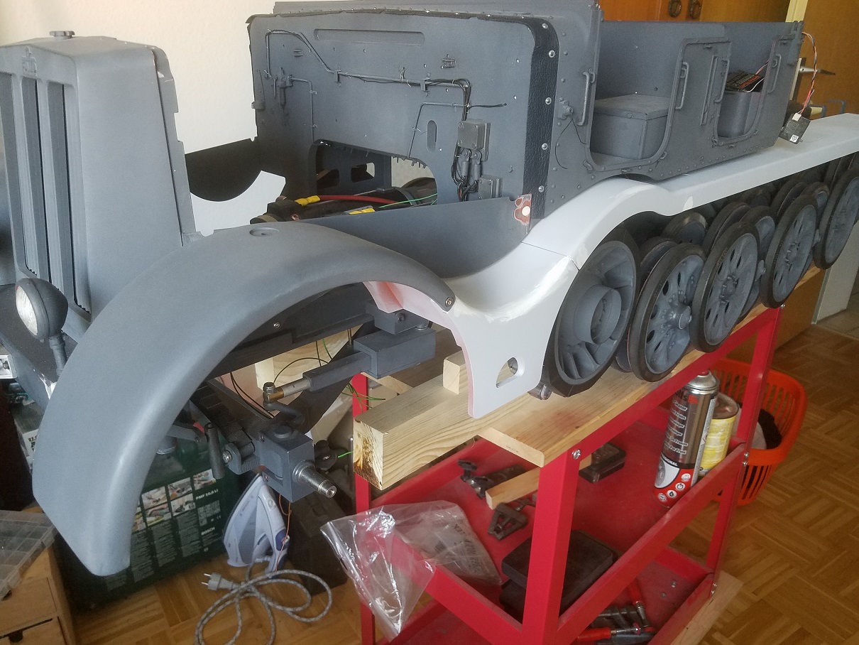

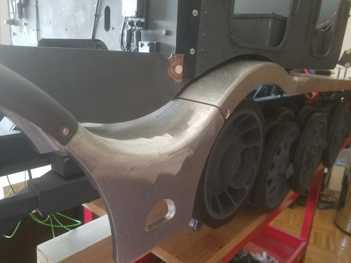

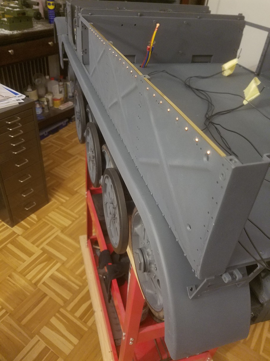

A little work on the fenders. I milled the alu at the middle section so it looks some more scale. The weight I lost at this position I'll put later into the engine dummy. You need the weight because the steering function on slippy bottom.

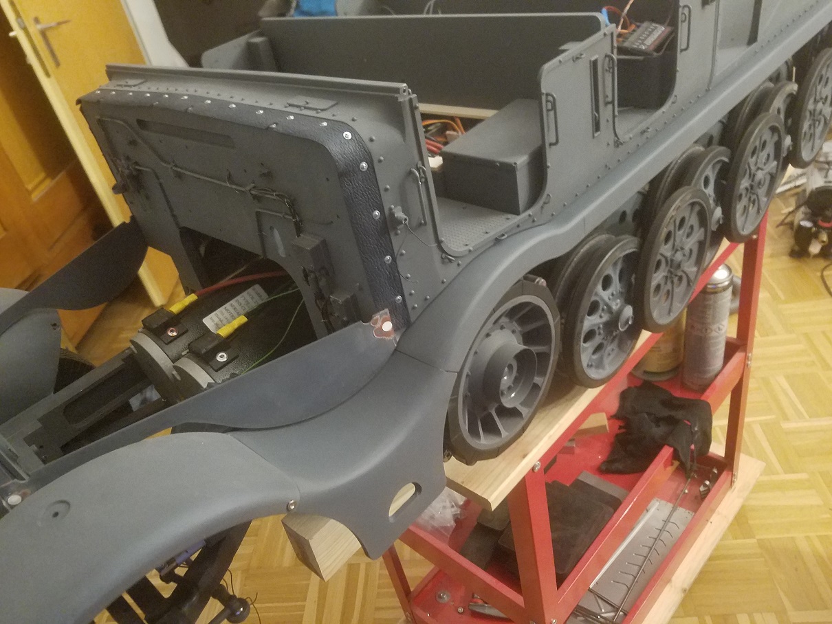

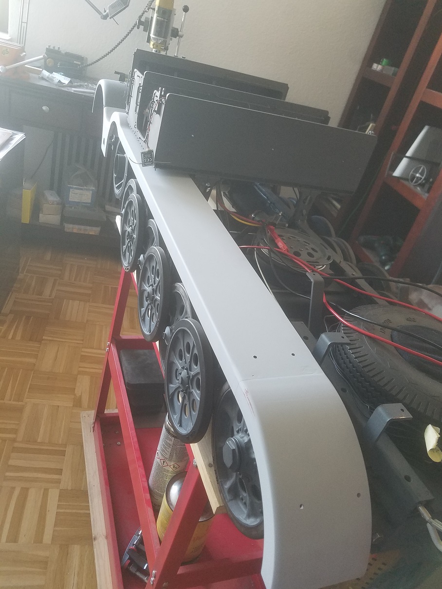

Some work on the loading area and fenders.
The fenders instalation is quite difficult, because a long part with some fasteners to fix. - So if one part does'nt haf the rigt position in a bit of a mm, you can't get it fixed.
Now my loading area and fenders come together on the famo and looks amazing.
