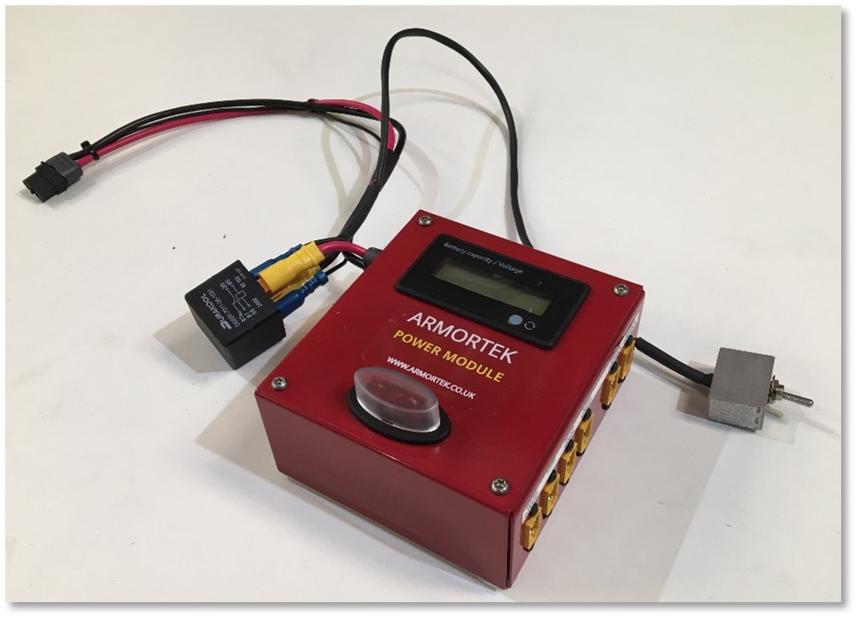

If you have the old style then there are no issues - see images below:
NEW STYLE - STOP USING AND DISCONNECT FROM POWER
NEW STYLE POWER MODULE
NEW POWER MODULE.jpg (96.81 KiB) Viewed 3058 times
OLD STYLE - CAN CONTINUE TO BE USED
OLD STYLE POWER MODULE

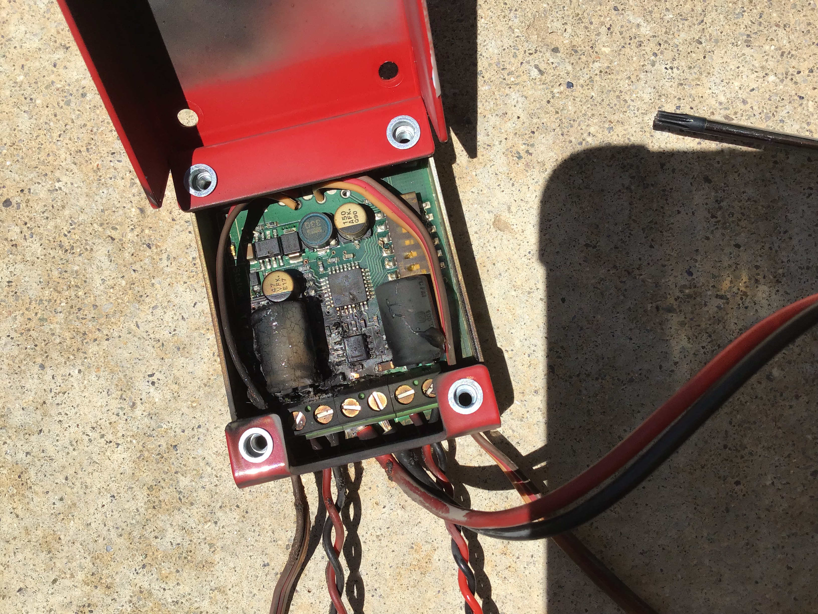

Just to follow up on my Mod B fire post here is a pic of the inside. This was a bench test with zero load.

Chris - your issue has nothing to do with the Power Module. As mentioned in my emails to you, it looks like your module B shorted. The only time I have seen this happen to a Module A or B was when the drive motor leads touched each other.
With regards to the new style power module - we had tested this under 60A loads and had no issues. We also ran it to the point where we destroyed two main drive motors and still no issues. However, we did find another board that had a problem when we put it under a very light load.
Our hypothesis is that the copper trace in the vias was inconsistent or the solder pads had some sort of issue - this meant there was a bad contact which then heated up and caught fire.
We could spend time investigating further, but that would delay matters further and as we will not use that design anymore there is no point. Instead we are providing replacements for all the impacted power modules and we are moving back to our tried and tested previous design.
