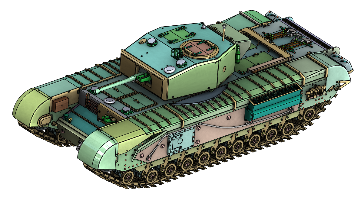

Re: Churchill Prototype

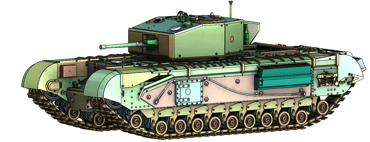

The complete model:

Here is the latest look at the Churchill Mk III. You will notice some changes compared with the previous render, and there will be a could more changes going on - visible and not so visible.

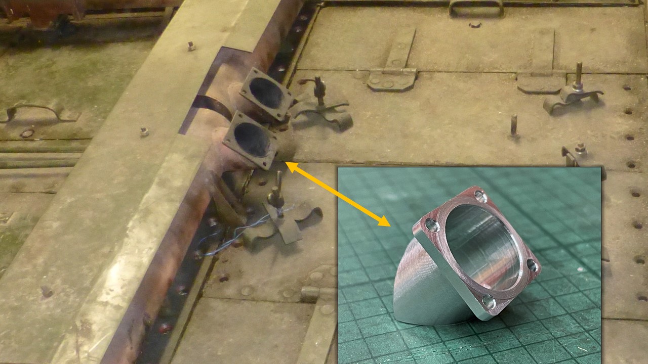

We made this today - Exhaust Outlet - part number EX0634 for the Churchill.
The image below shows the actual part on a MkIV Churchill at the Tank Museum in Bovington and the part that we made.

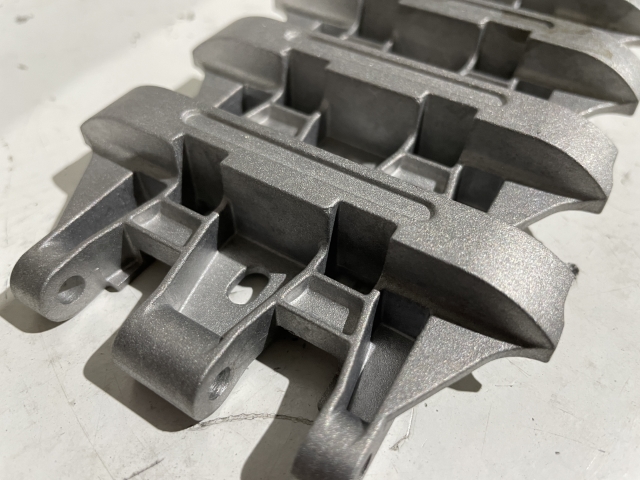

Churchill tracks - to avoid people having to weld plates on the links to hold the pins in place (like the real thing :o ) - the track pins are are knurled at one end. As a belt and braces approach we also have a grub screw that will lock the pin in place.
A_IMG_2028 (640 x 480).JPG (215.94 KiB) Viewed 4713 times
A_IMG_2026 (640 x 480).JPG (179.14 KiB) Viewed 4713 times

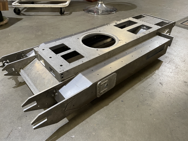

Progress on the Churchill

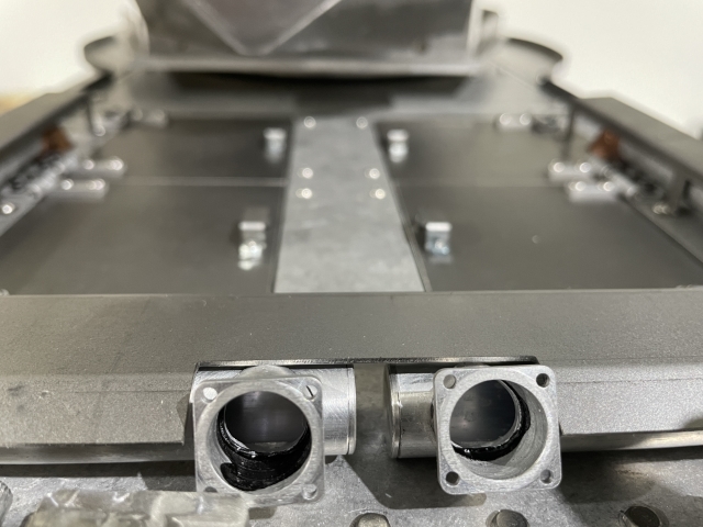

Engine air intakes for the Mk III - these went through several changes during the evolution of the Churchill Tank

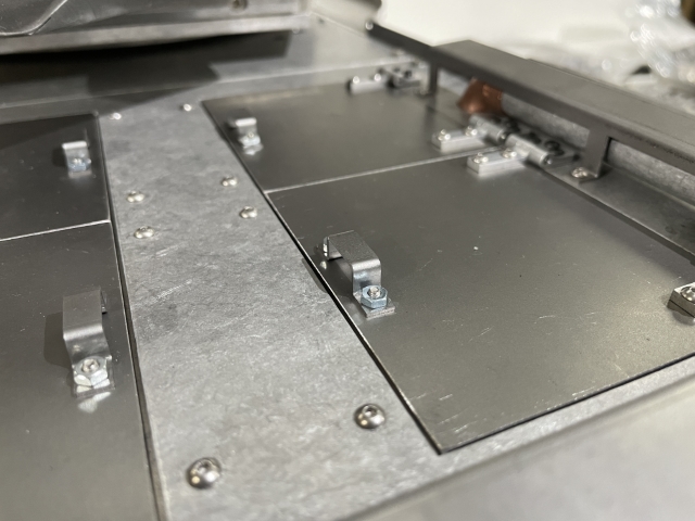

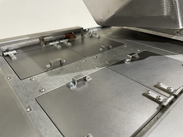

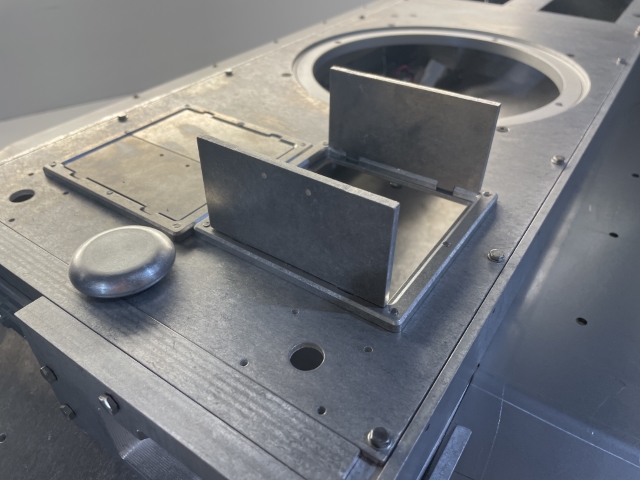

Rear deck details on the Churchill. Pretty much complete at this stage.
A_IMG_2052 (640 x 480).JPG (182.79 KiB) Viewed 4708 times
A_IMG_2063 (640 x 480).JPG (181.94 KiB) Viewed 4708 times
A_IMG_2053 (640 x 480).JPG (182.3 KiB) Viewed 4708 times
A_IMG_2062 (640 x 480).JPG (189.14 KiB) Viewed 4708 times

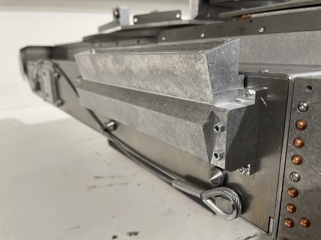

Turret bin - bent and welded. Needs the lid and a couple of fire extinguishers.
A_IMG_2056 (640 x 480).JPG (187.46 KiB) Viewed 4709 times

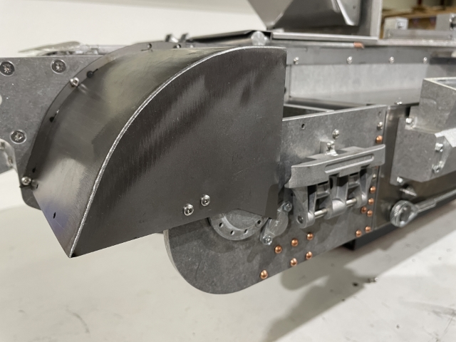

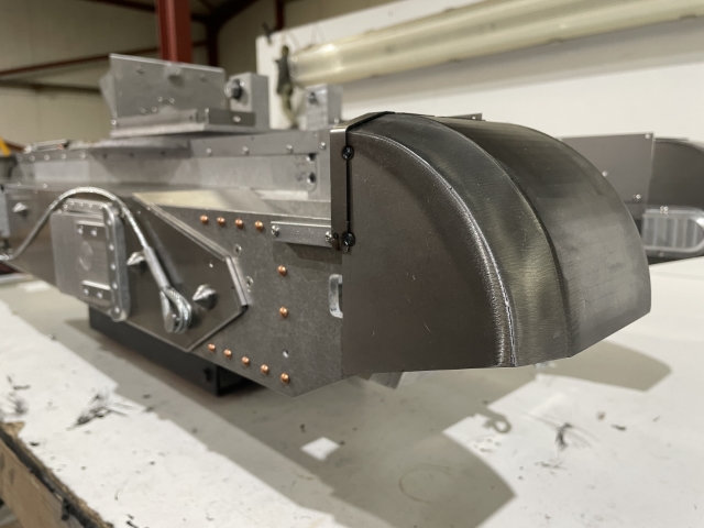

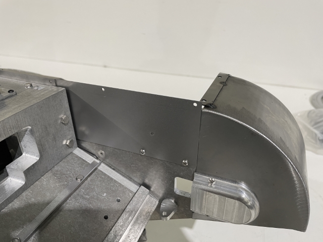

Front and rear mudguards - also bent and welded steel.
A_IMG_2059 (640 x 480).JPG (169.3 KiB) Viewed 4709 times
A_IMG_2057 (640 x 480).JPG (181.5 KiB) Viewed 4709 times
A_IMG_2051 (640 x 480).JPG (180.24 KiB) Viewed 4709 times
