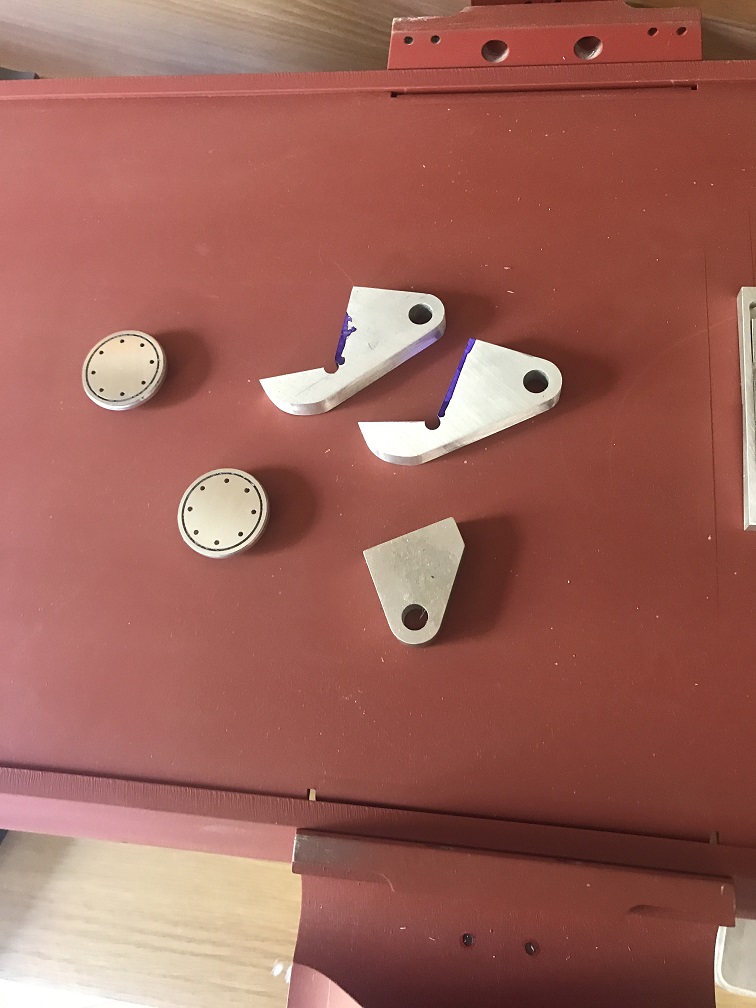

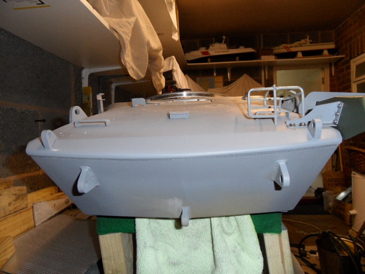

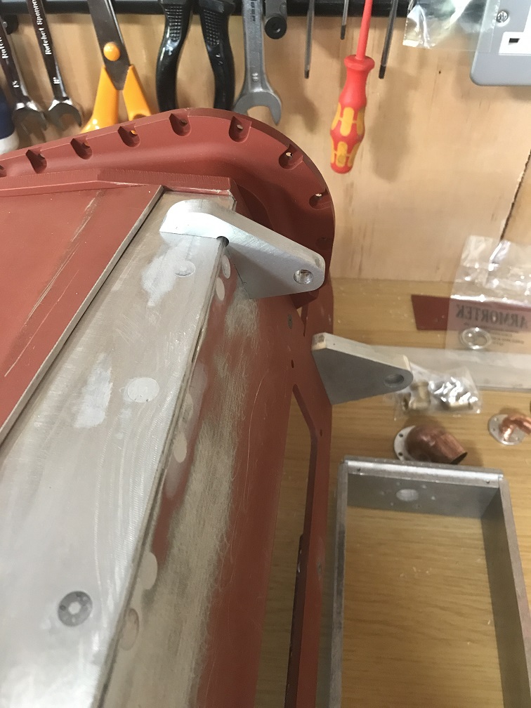

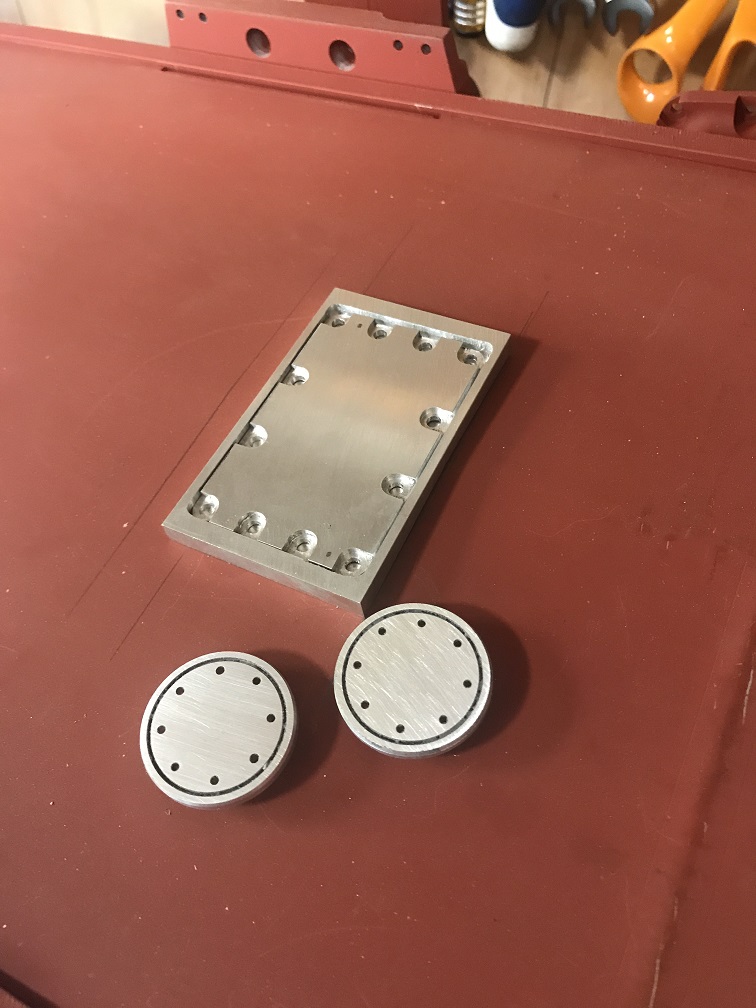

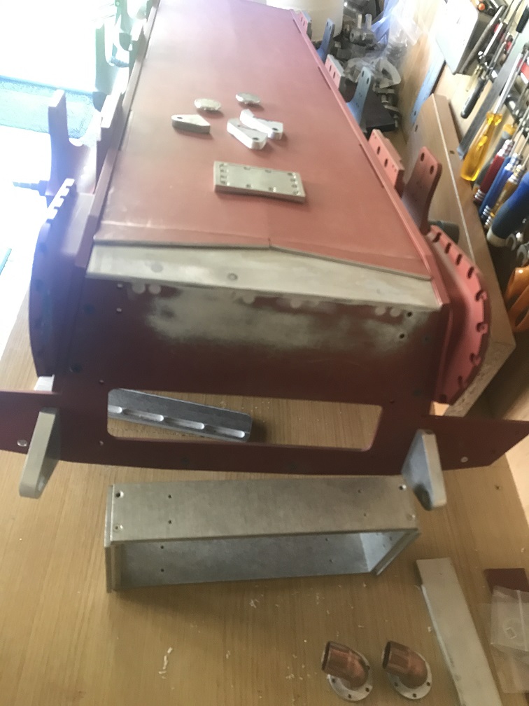

Ok so i them also made up the round plates but am stuck for a bolt size - any ideas guys ? the disks are about 21mm Dia
Also can be seen replacement Tow brackets, not 100% sure about the shape of these and might remake them yet, ill try a bollard on and see ow they look. feedback is very welcome :-)
First thought are also forming for the exhaust box... as it can be seen in bits - still mulling it over on which way to go with it.

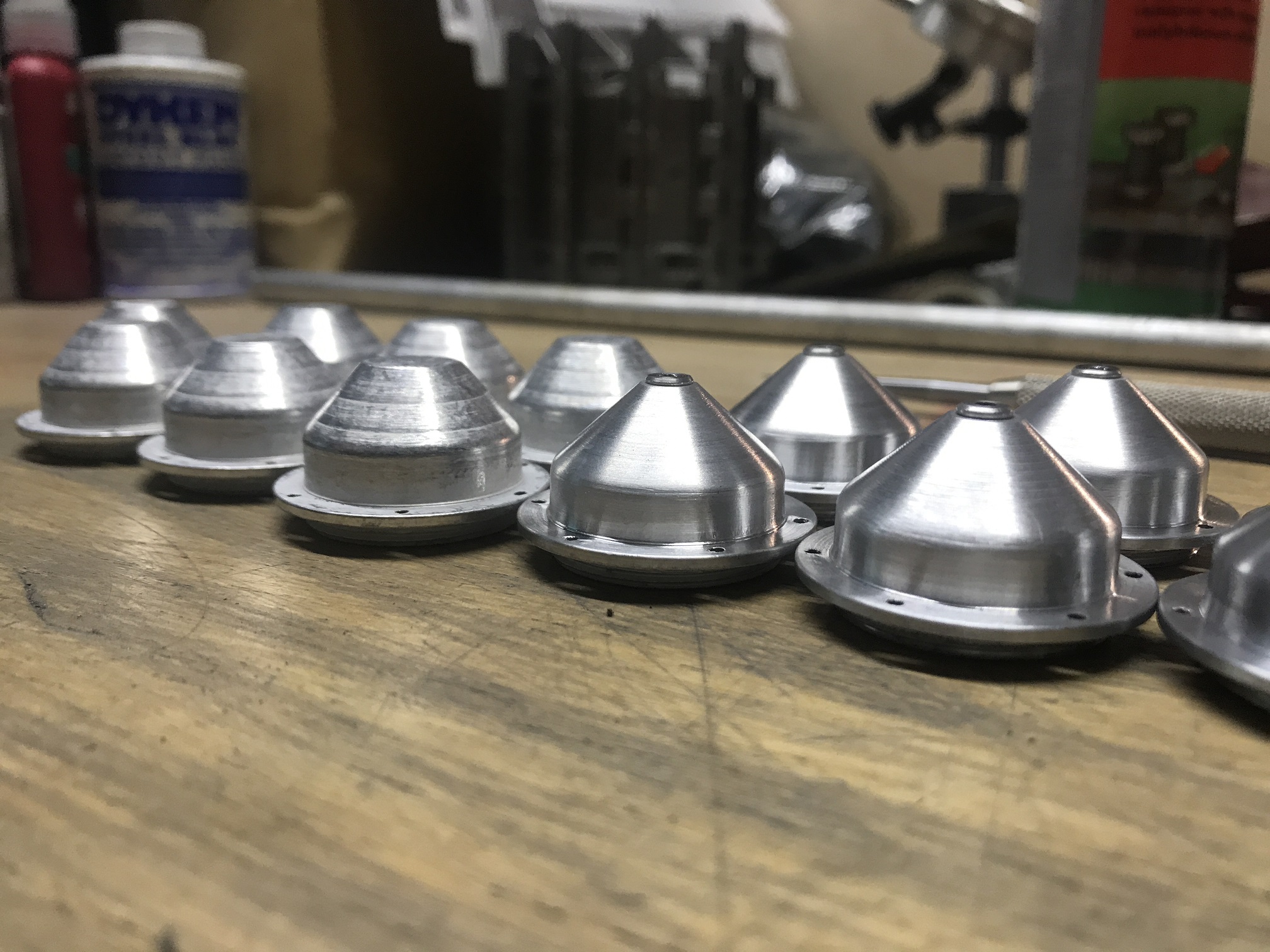

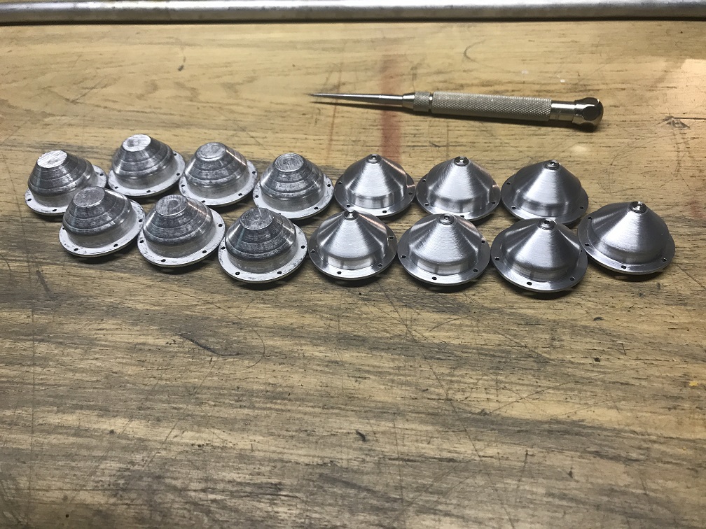

A little spare time yielded some time on the lathe with the Hubs and this is how they turned out - half original half Nearly finished - still got to drill the 2 extractor holes in each one.
I used a 3mm Button head hex Bolt for the filler level Bolt in the center. skimmed off whilst still on the lathe

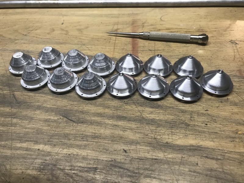

And here they are done - nice little job which i really enjoyed doing.

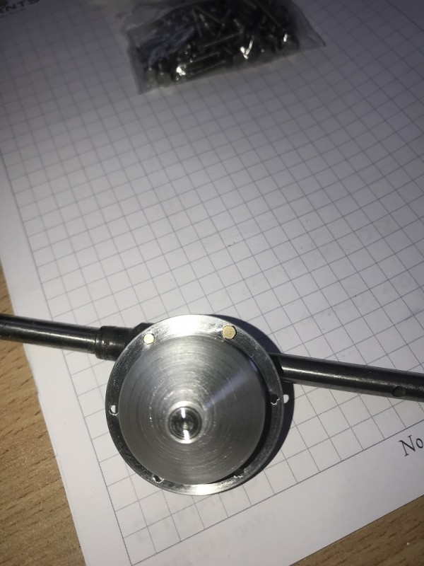

Now Decision time do i go for the M1.4 or the M 1.6 Bolt for the hubs... :roll:
M1.4 on the Left M1.6 on the Right
Posts: 5133
Has liked: 1490 times
Been liked: 1697 times
Re: Chieftain No 26 By Andy Musgrove
Judging by the pictures in Richard's thread, I would have said 1.6mm. However, he used 1.4mm but used nuts instead of hex heads.

Thanks Adrian. I am leaning towards 1.6. As I think the 1.4 looks a little small.

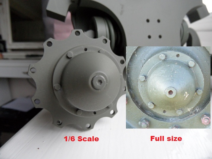

Great to see you "Going for it" on the Chieftain detailing Andy. It's a tricky build in basic form. Richard and I both thought the M1.6 converted nuts and threads seemed the closest match to the original.
The reason I went for the fake M1.6 conversion bolts was purely cost, also after several coats of paint, definition on the hex heads will diminish on the smaller hex head.
By the time this model is completed it will have cost and arm and a leg in fasteners alone. The cheap converts saved a few bob, allowing monies to be spent on stainless retainers holding the rest of the model together. Using stainless Nuts, Bolts, Set screws and washers allows me to leave the internals au naturel.

Thanks so much for the detailed reply and advice. I will use the M1.6. I made up one hub and they do look better than the M1.4. I’ll post up some more pics of it tomorrow
Also M2 certainly looks ok on your round plates. What dia are your S? Mine are about 21mm

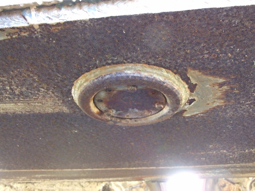

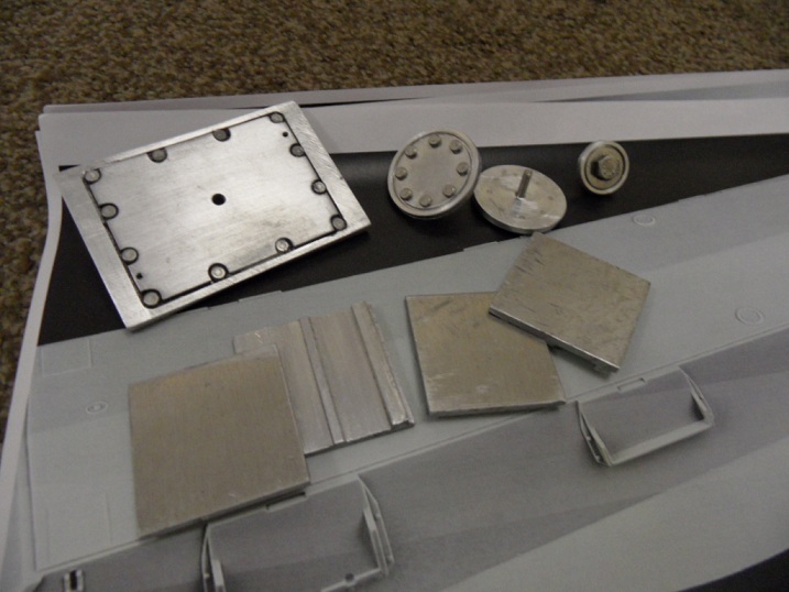

Well you've certainly got some treats ahead. I'm taking a chill pill at the moment and will hopefully spend sometime on a Armortek Comet. Getting the fantastic model up and running again after a bit of storage. "A change is as good as a rest" they say. :D
Very nice workshop you have there, lovely finish on those parts you've made, we'll be expecting great things Mr Potter Musgrove 8)
I measured the original inspection hatch including weld at around 220mm. I did make a smaller pair to suit the kit as they looked big at scale but went for near scale in the end, I believe the whole inspection hatch including weld came out around 35mm and the disk in the middle 26mm. I wouldn't worry about scale, there's not much in scale. if you do start make things to scale, your making a right rod for yourself.
BEWARE of the Takom "trap" in positioning the disk bolts. That what I like about accurate plastic model kits.
"Absolutely Nothing" :x
I've added a picture of the bits I knocked out to compare sizes.
