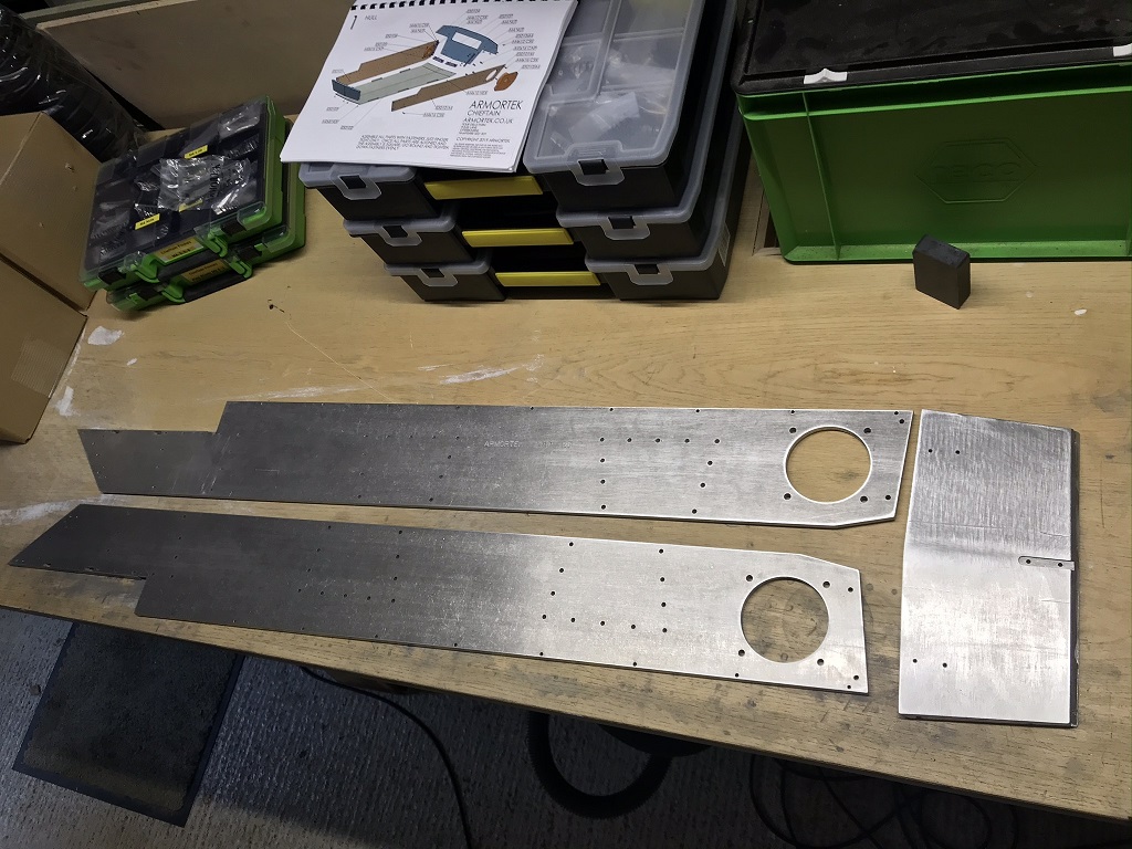

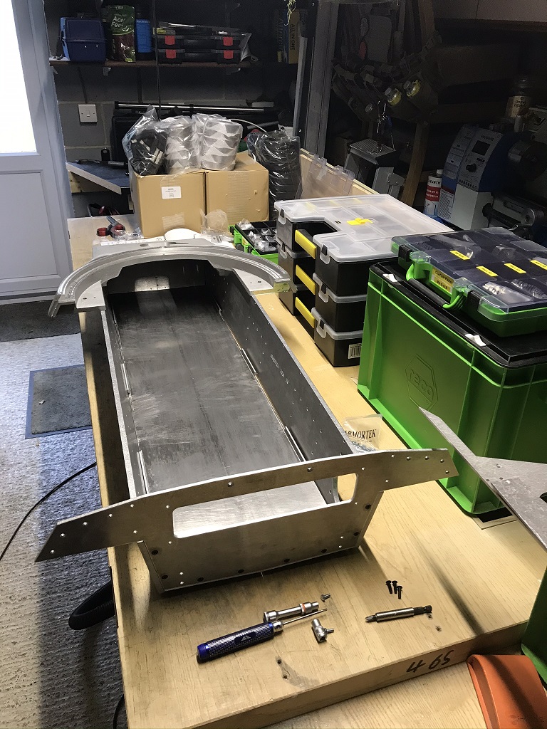

Clean up ans first test assemble of the hull.
Had to straighten the hull sides as they were a bit like a banana..
but the basic fit looked ok
Then degreased and sanded down and trial bolt together.

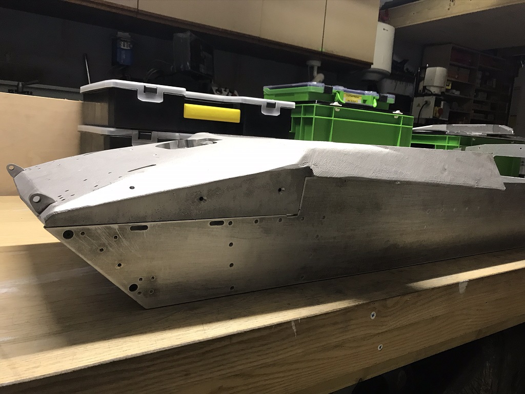

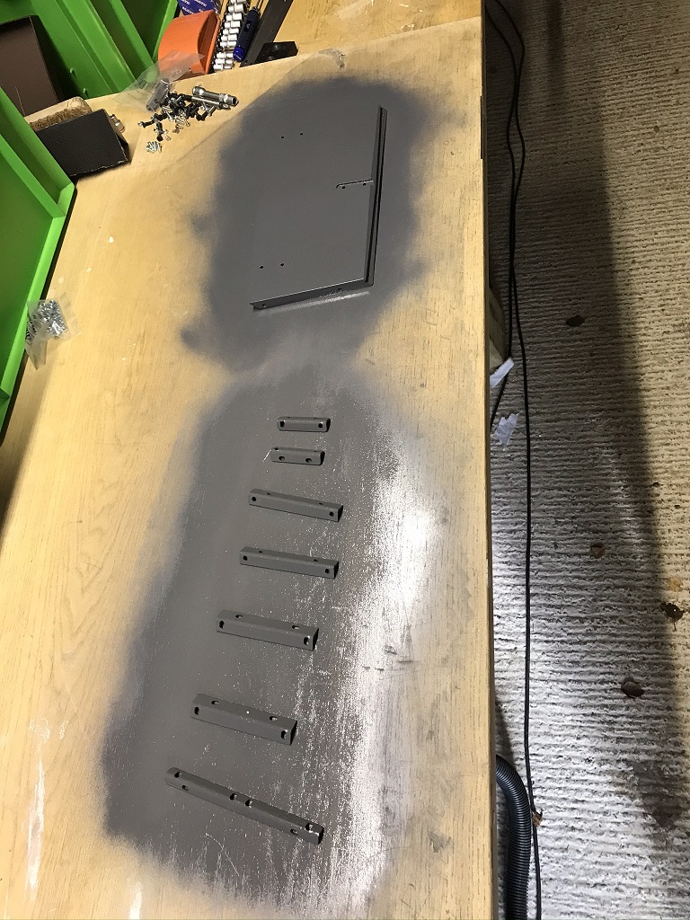

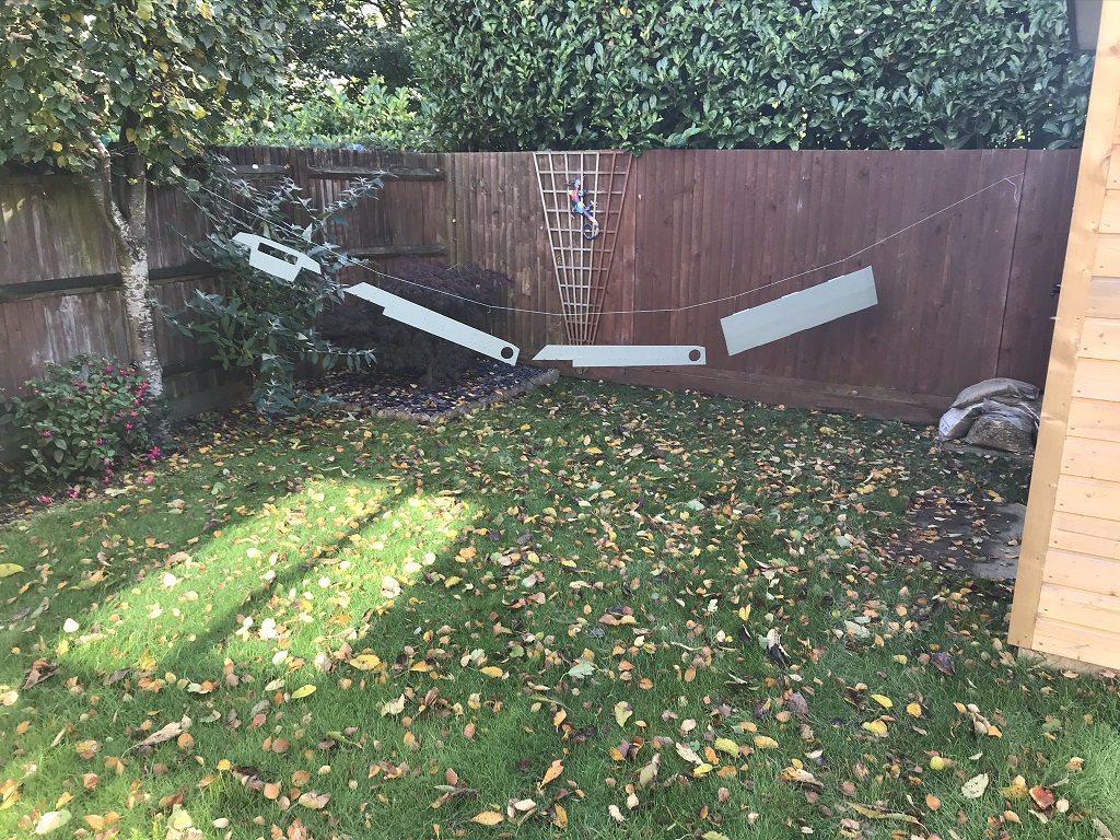

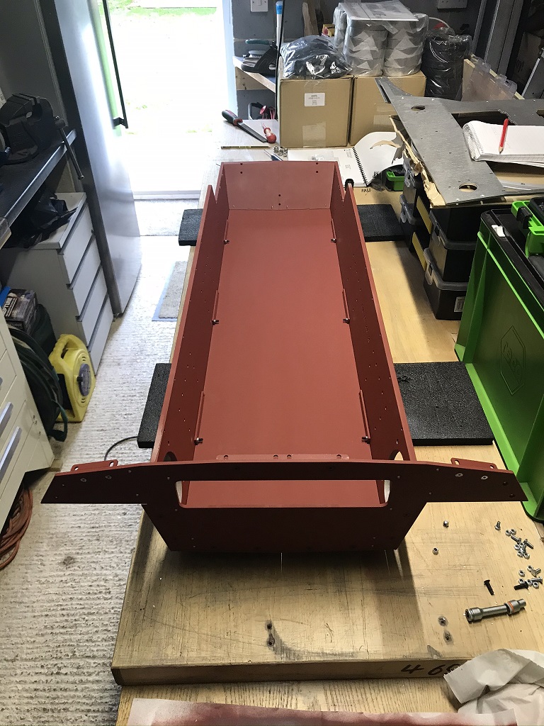

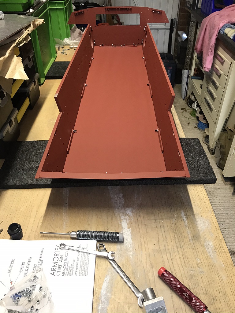

Hull Etched, Primed and Assembled - loosely
Final Drive housings Etched and Primed.

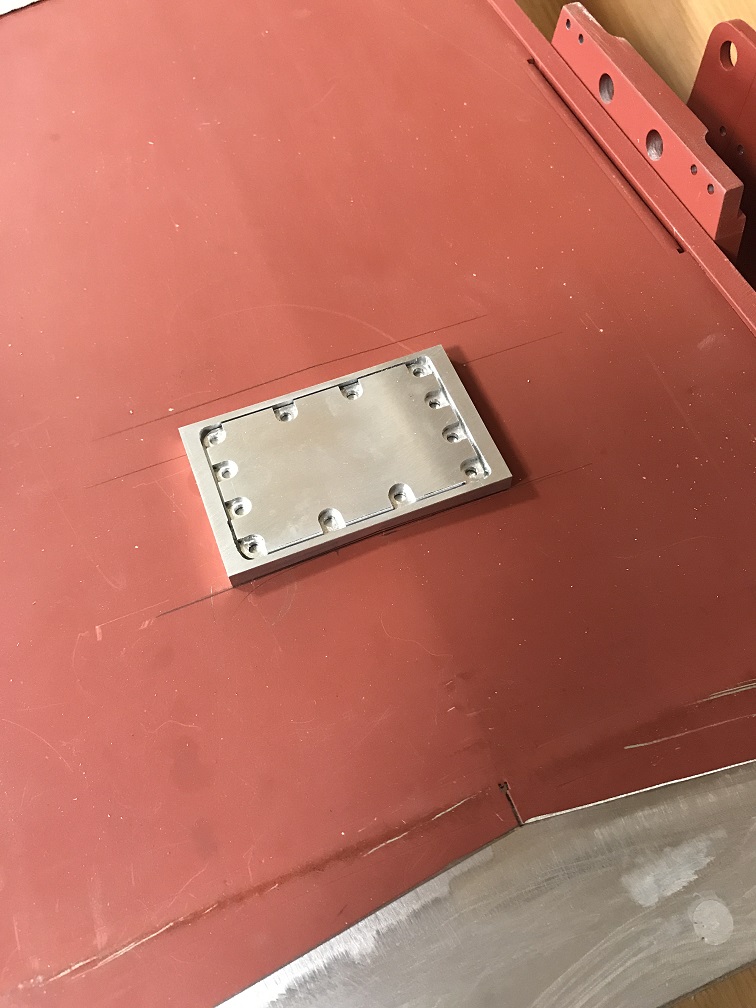

Ok so i took the plung and cut the back off my tank - but completely forgot to take any progess photos of this bit - but take it from me 1/2 a days work lots of cutting filling and drilling involved and its still not finished..... the new rear plate is bolted in and i an waiting to see if i can get a friend to weld the inside... ill let you know if that happens or it gets bolted down - watch this space. also shown is an unfinished Hull inspection hatch. i made it too thick and need to get it bacl on the mill to thin it down a little.

More pics of the too thick access hatch.
The outer frame was made from 5mm Ally plate and the loose hatch made from 2mm Plate.
