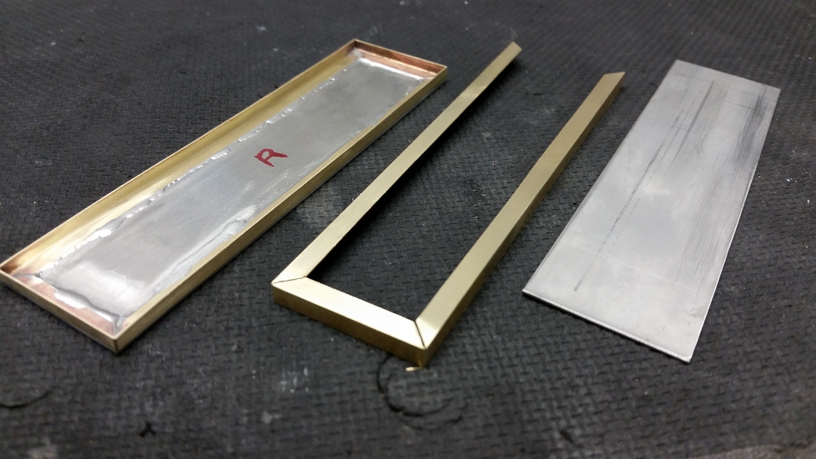

Post by mark j. radick »
Notched, soldered ribs and installed fenders - skirts...

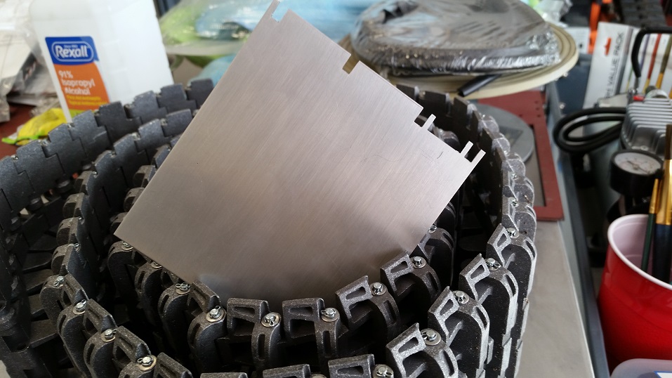

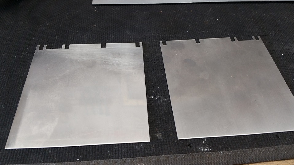

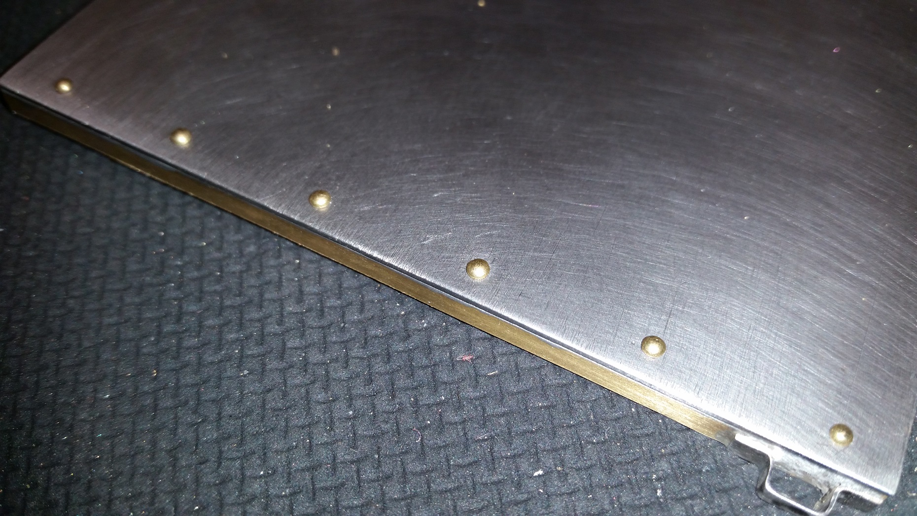

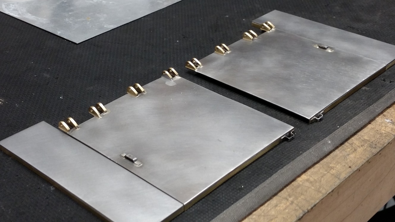

Started front mud guards ...flaps today..I chose .035 inch stainless steel because I had it......tough stuff to cut !!! I doubled up on the base of the piano hinges as on the Bovington tiger

Last edited by mark j. radick on Thu Sep 08, 2022 5:04 pm, edited 1 time in total.

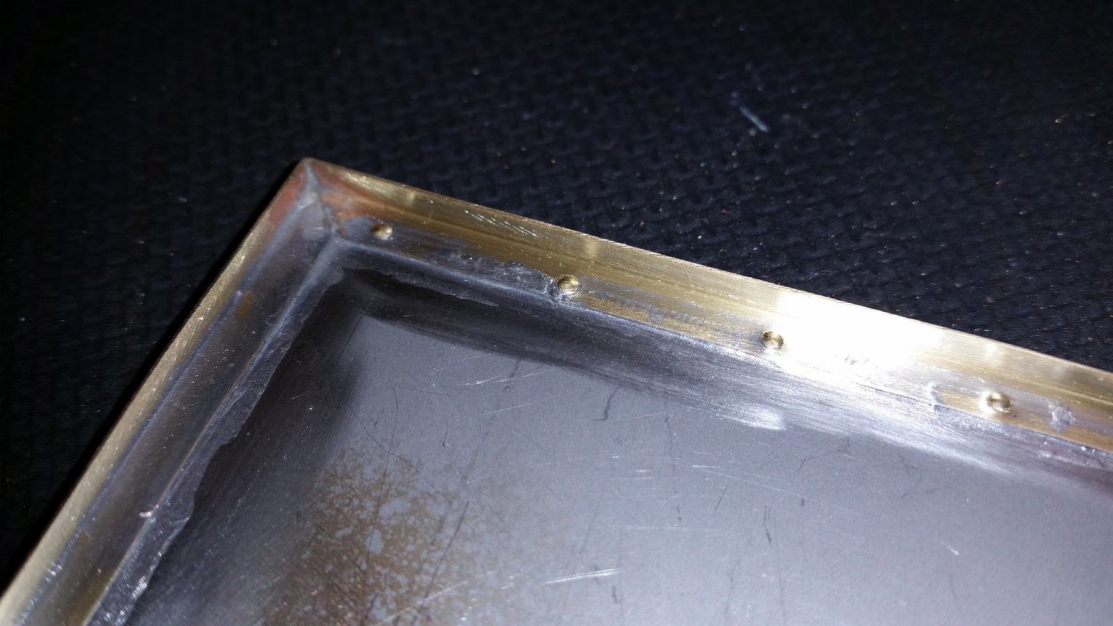

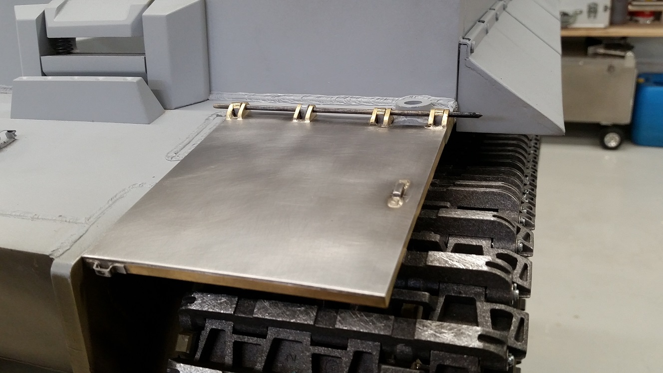

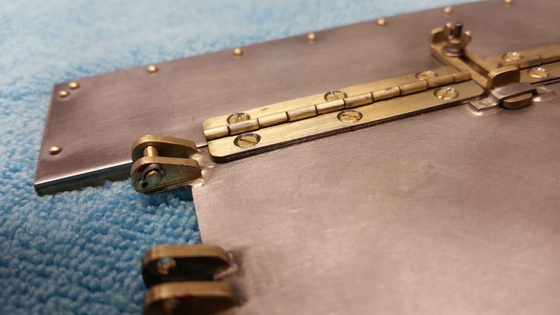

Just need to add rivets, piano hinges and slide locks....hard or silver soldered hinge ears....much stronger

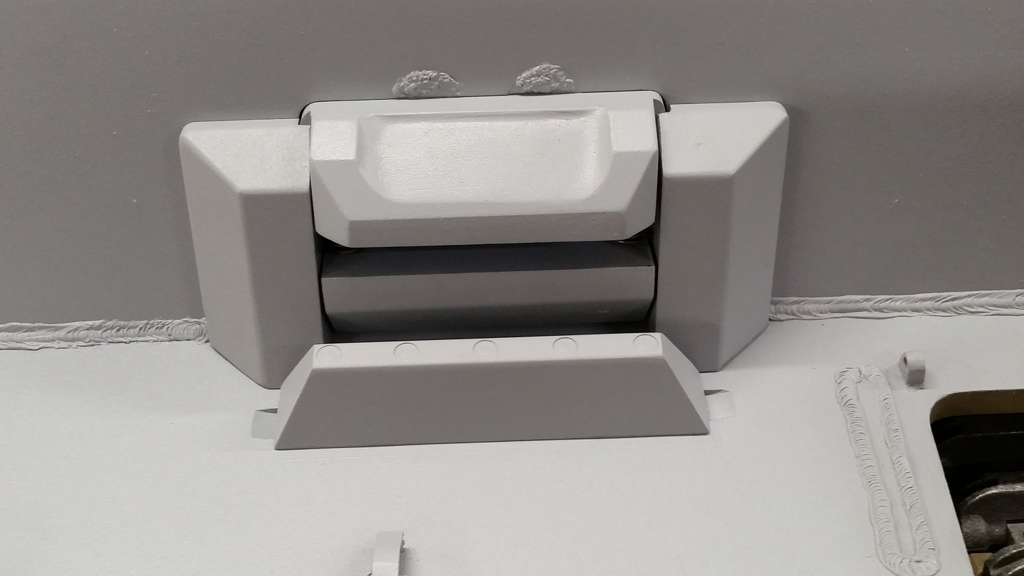

Looking very good so far.Your welds have come out fantastic and I like that you have corrected the front mudguard attachments, very few have done this. Only thing I can see that needs to be modified is the drivers armored visor.

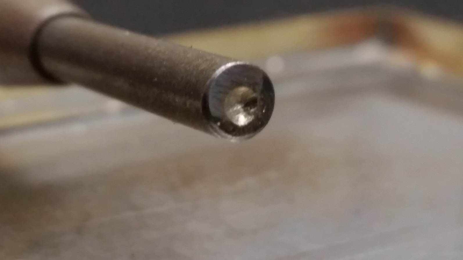

While working on the rivet detail on mud flaps I wanted to try and form a dome on the through stem of the rivet on the underside rather than just smash in down. I ground a small concave depression on the punch...worked well !

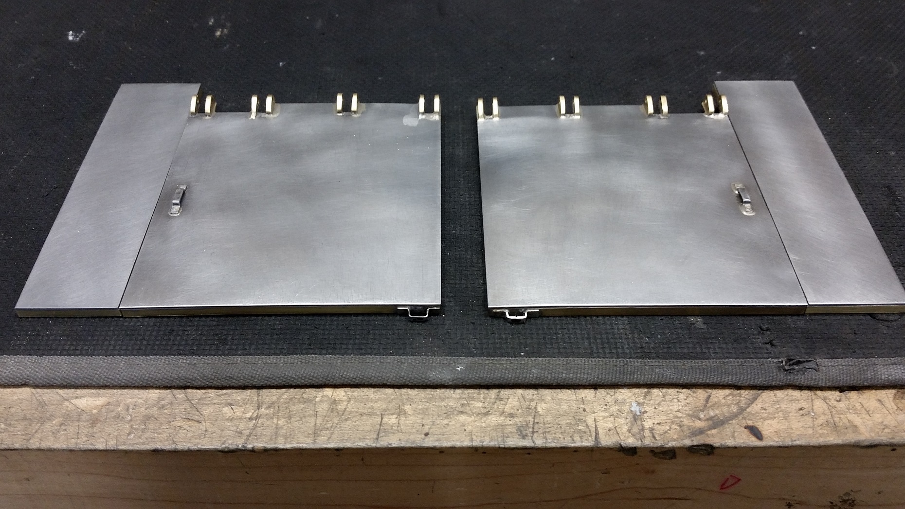

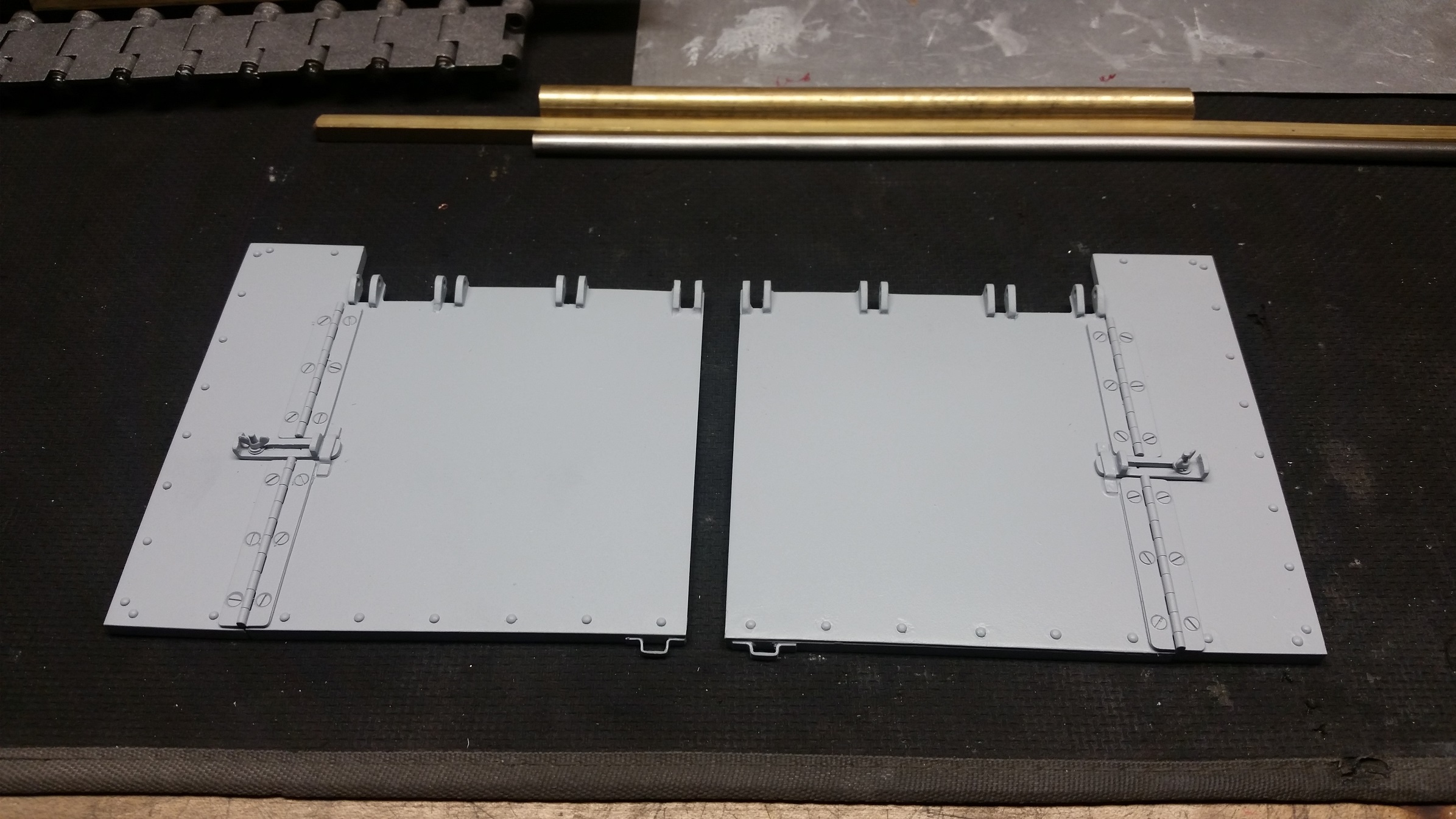

Mud flaps are done...off to the paint booth ( trash can just outside my garage )...seems a shame to paint them..I like the bare metal look.....

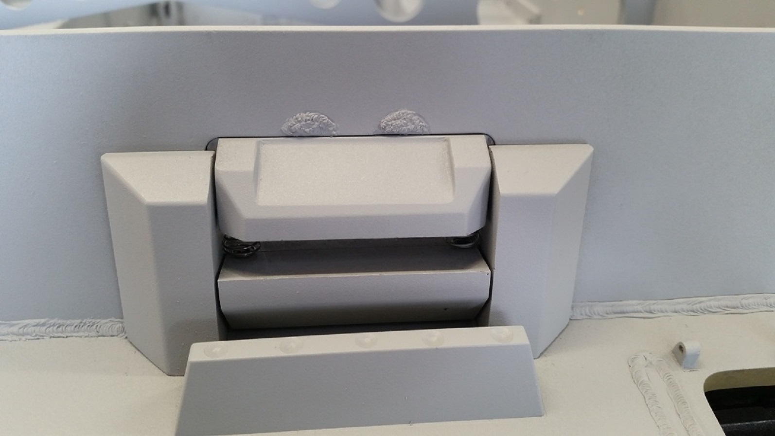

Reworked drivers visor armor..closer to scale now..before and after

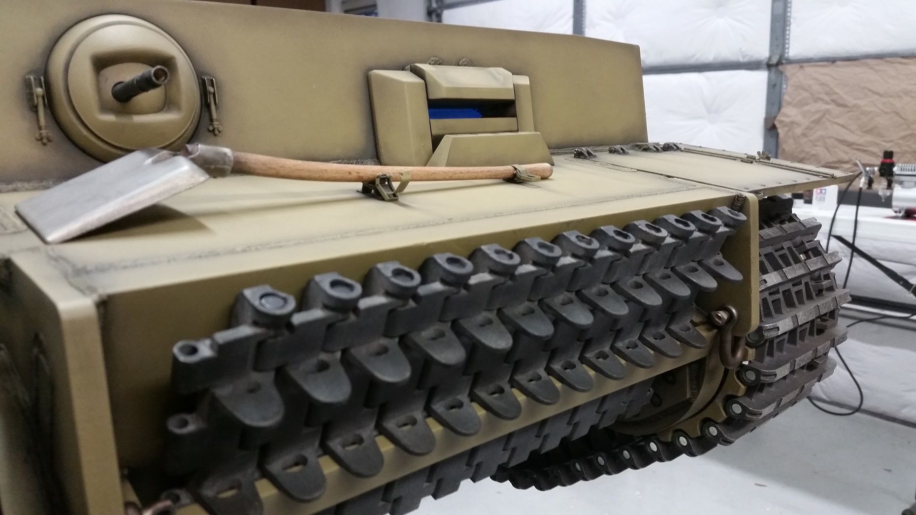

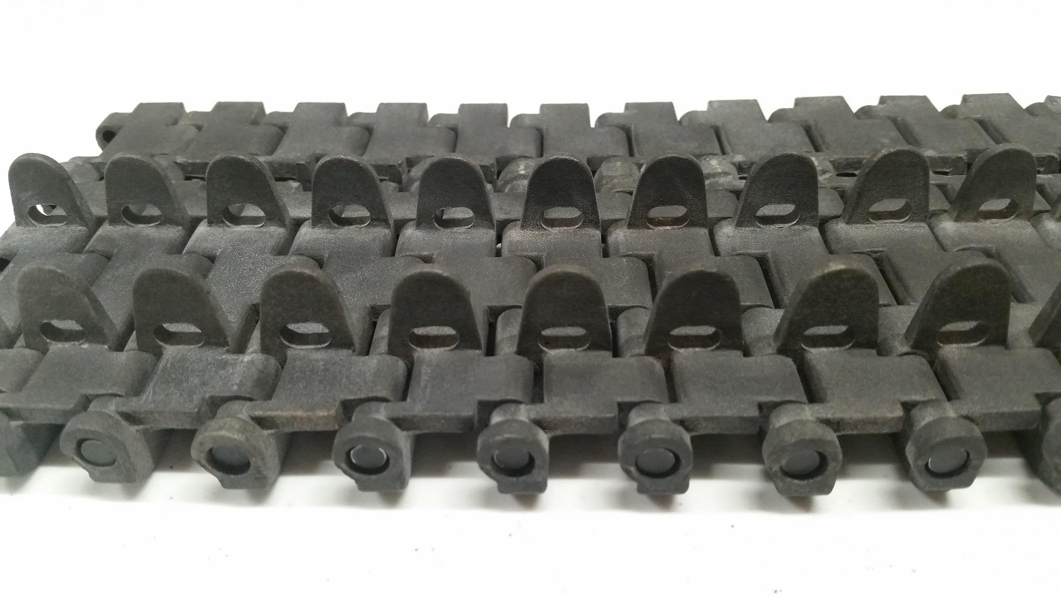

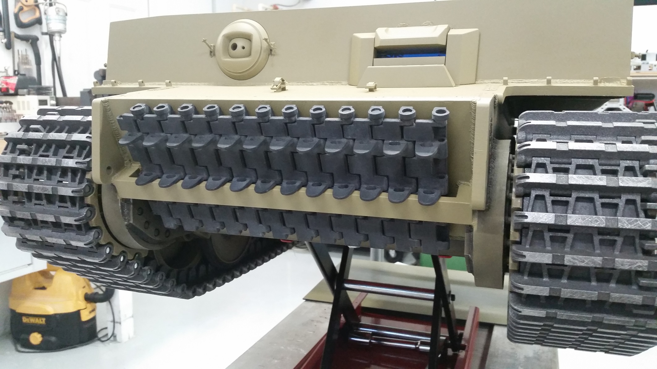

Modified some old original spare track links...cut relief holes in horns and weathered to look like the links on the Bovington tiger and added spare track bar
Marco Peter
Posts: 548
Has liked: 1530 times
Been liked: 797 times
Re: Tiger build
Post by Marco Peter »
OMG those correct holes in the tracks are awesome!

Re: Tiger build
Beautiful work Mark - I agree those tracks are perfect. I was planning on doing similar to my Late tracks, plus adding the ice cleats etc. Great details all around. Your Tiger will be superb when finished.

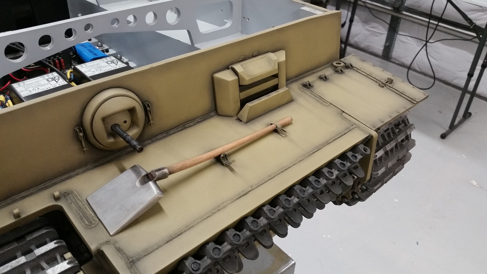

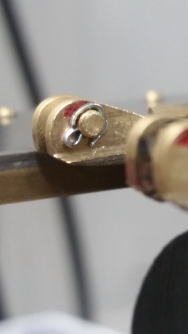

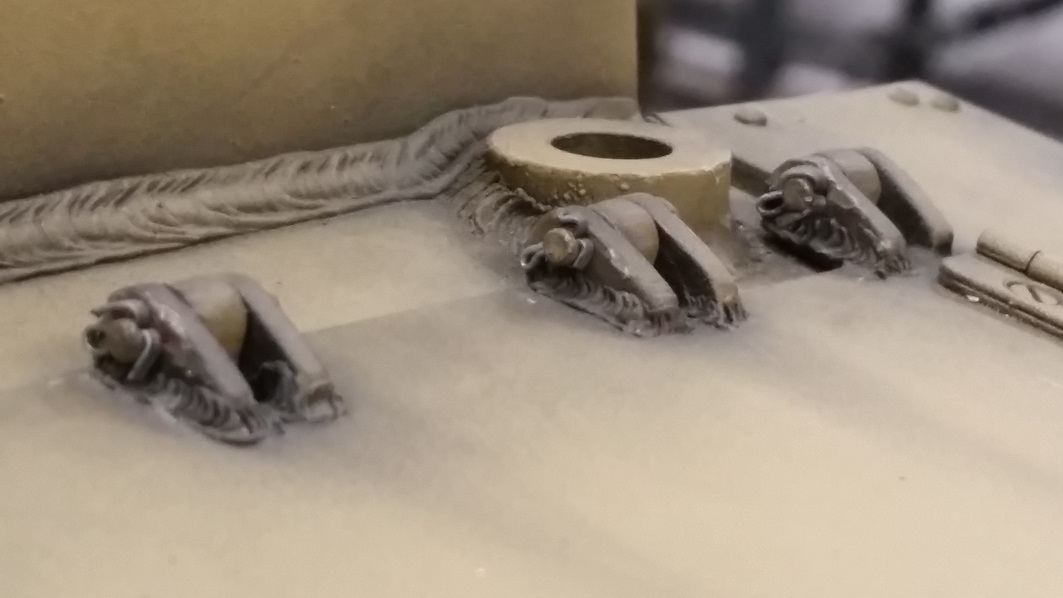

Messed around with some weathering and heat colored the stainless shackles
