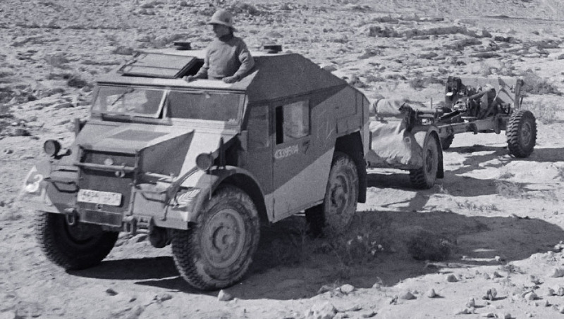

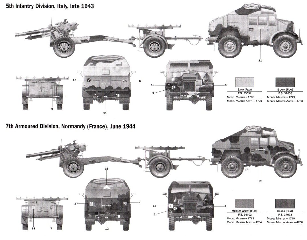

So what colour/what unit?
I have to start thinking of the colour scheme as top coat is not that far away now. I rather like the idea of a Quad Battery in France during the invasion to retake Europe, so what colour/what unit?
I am also drawn to a desert yellow applied in the North African campaign fighting against Rommel's Army.
Also a bronze green for parade in dear old Blighty all bulled up (no weathering).
Any input would be gratefully received, cheers Phil.
North africa .jpg (17.15 KiB) Viewed 6274 times

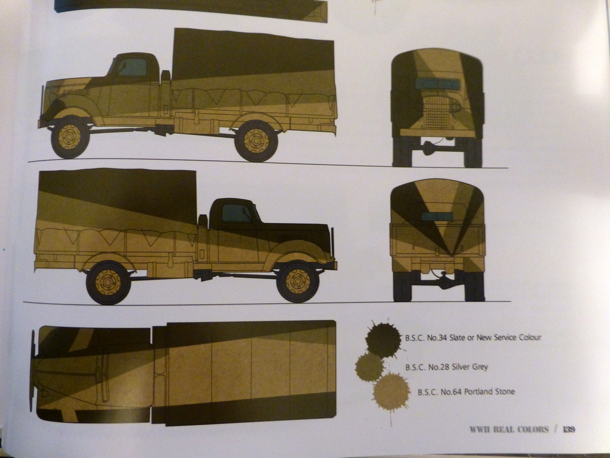

How about Greece 1941, Caunter scheme? Mike Starmer has a lot of research on colours and patterns in his booklets.

I'm watching with interest and I have been researching colour schemes also, and I'm currently detailing this as the Caunter scheme, however it is very difficult to find good reference material.

Thanks for the replies guy's but Im not convinced that this type of camo scheme works in 1/6th, I prefer a more simple single or possibly a two tone scheme with different shade of the same to add depth and interest, I may be wrong! Please keep the ideas and info coming it's all very interesting, things evolve all the time as the build goes on and more research is done ( i love the research aspect and spend many hours doing so).

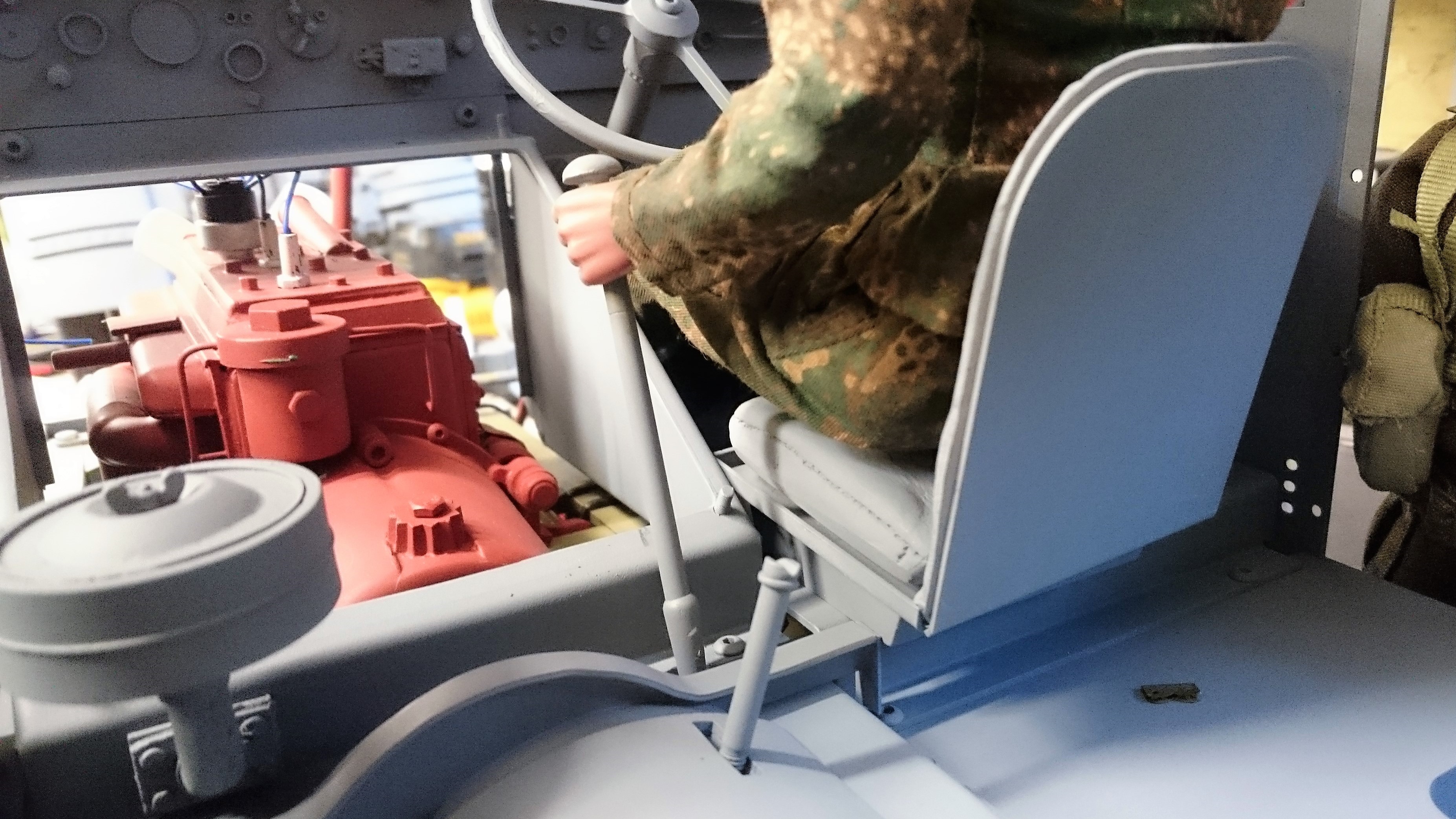

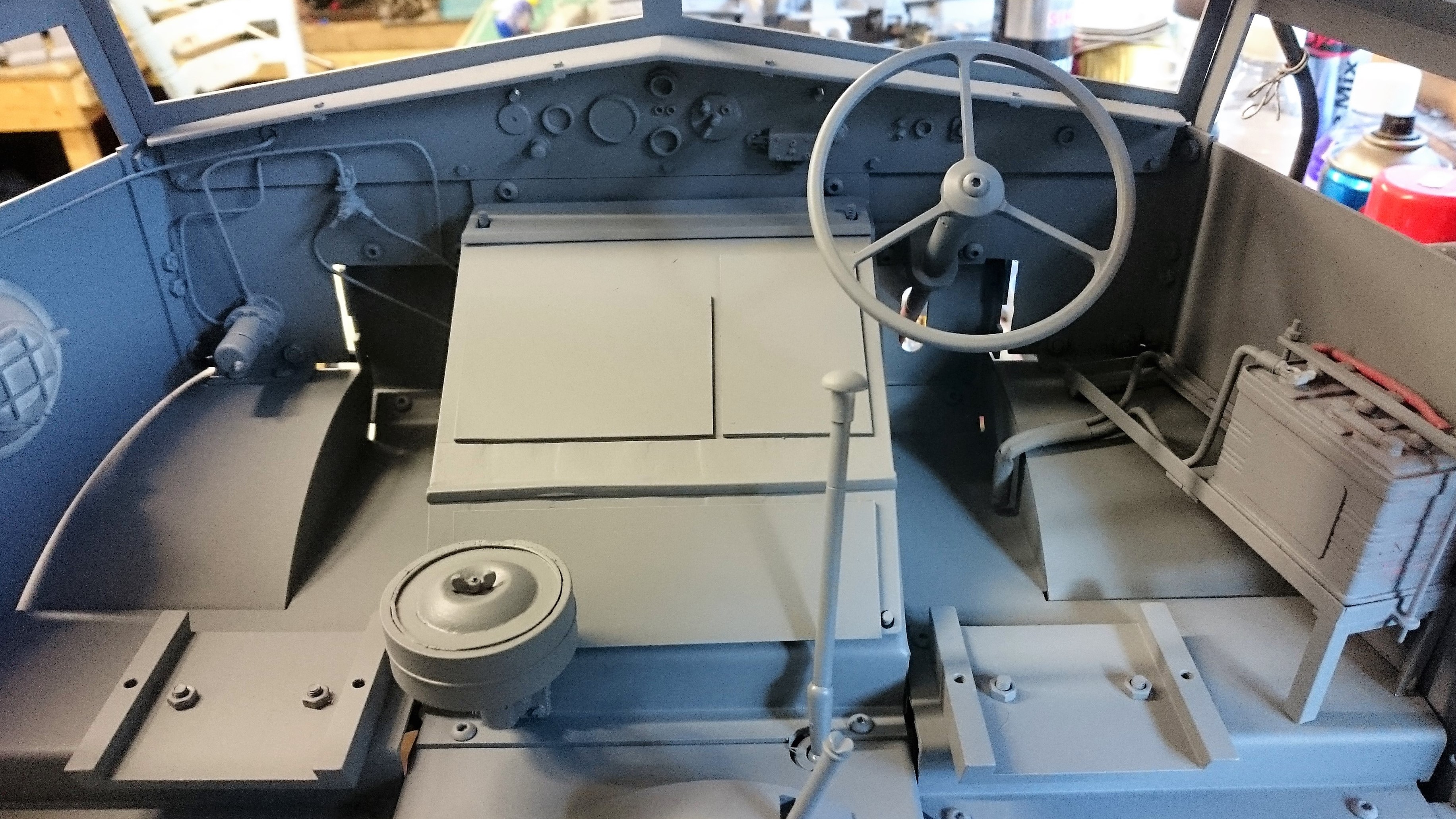

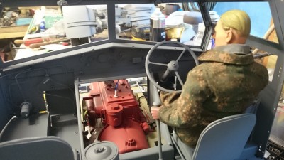

You may be interested in my latest addition to the Quad, it's a working gear stick, at present manually selecting the stick to provide drive or neutral, this allows the operator to rev the engine (remember I have installed a turning dummy engine) whilst the vehicle is stationary, I may also connect the gear stick to a servo.....more to come tomorrow regards Phil.
Re: Me Quad.

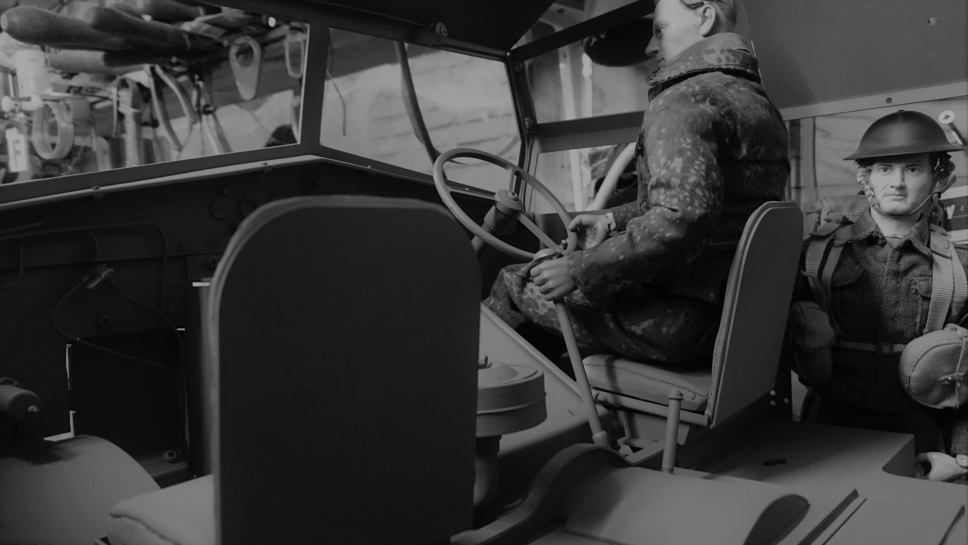

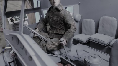

Interior detail is coming on a pace.
Now I am aware that this guy bats for the other team but we are short staffed at present.
The gear lever is now part of a high quality heavy duty switch, the switch simply disconnects the current to the main motor , the action latches nicely from a neutral position to a forward gear position, the forward position being 1st or third gear. You can now select neutral and have the dummy engine running with proportional RPM from the esc and proportional sound from the audio module, simple but effective.<br />A  servo could be added to shift gears with the drivers hand and arm moving along with it, giving the illusion of the figure shifting gears by himself!
Last edited by Phil Woollard on Tue Nov 28, 2017 4:38 pm, edited 3 times in total.

Hi Phil, love the details and quality of the build, now that’s my kind of modelling

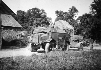

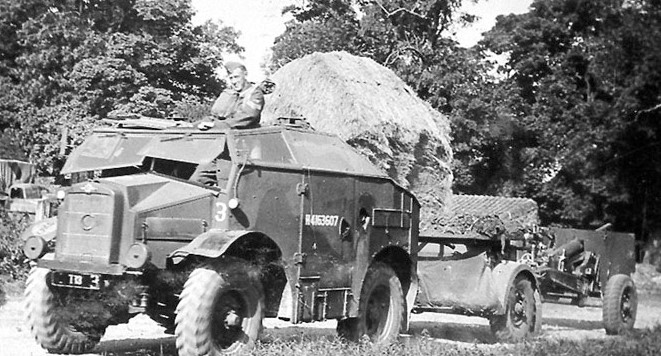

One of my favourite photos of a Quad in occupied France. The colour scheme is (although I can't be sure as the photo is black and white) two tone and probably the American khaki and black. The American Khaki was in plentiful supply and used extensively on British vehicles especially in the late War years. I do prefer this to any thing else I have seen so far although I also like the desert colours :? ....Phil.

Re: Me Quad.
Phil Woollard wrote:
Wed Nov 29, 2017 1:02 pm
Ah, the British occupation of France, getting our own back for the Normans?
Phil, photo is by Second Lieutenant W H J Sale, 3rd County of London Yeomanry (Sharpshooters) and taken in 1939/40. The location could be France but it looks more like an idyllic rural English scene. No matter, the colours you're after are:
Base colour - Khaki Green G3
Disruptive colour - Dark Green G4, until May 1940 when replaced by Nobel's Dark Tarmac No 4
Vehicles were disruptively painted before embarkation to France. The colours are much darker than they appear in the photo. Mike Starmer has some paint mixes for these colours.
Hope that's of help.

It must be France as the sun is shining lol, yes those paint codes are just what I was looking for, I have 500 mls of deep bronze green that I may experiment with. Cheers Phil.

Good luck Phil. Hope it goes well on such a fine model. Just a comment on Deep Bronze Green (it has a fairly tortuous history). Deep Bronze Green No 24 was used pre-War. Khaki Green No 3 was a new colour introduced in Feb 1939 as one of a range of "Service Colours" (I believe DBG was a type of Brunswick Green widely available and not made to a military spec). So Khaki Green isn't DBG (the pre-War variety). It was produced to a military spec and is reported to have had anti-mustard gas properties. DBG and Khaki Green were produced to different British Standards. Cut then to post war and a gloss DBG appears, which is a dark tone. I don't know if it has any relationship with the pre-War colour. I suspect not because it seems unlikely that the post-War DBG wasn't produced to a military spec.
I gather the builder of this model used Mike Starmer's mixes for Khaki Green No 3 and Dark Tarmac No 4.
Whether any of this matters in one sixth scale in the eye of the beholder.
For anyone doing a Caunter, this photo was taken in Green 1941.

Re: Me Quad.
If you look closely at the roof behind that hay rick.....those are pan tiles if i'm not mistaken! A very European roofing material? ....Detective Phil :)

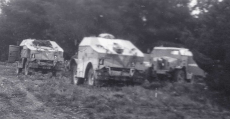

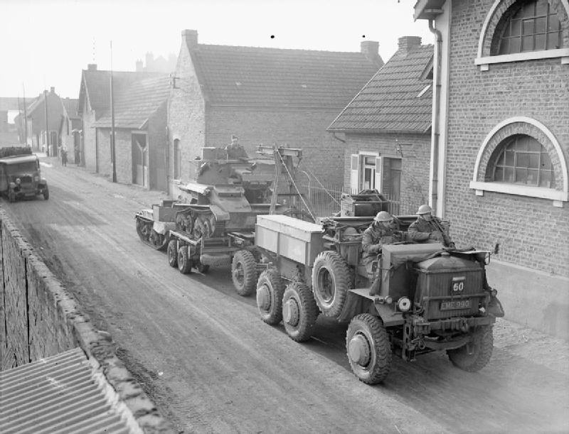

Another interesting photo below, what a rig! There' a lot going on behind that truck.
