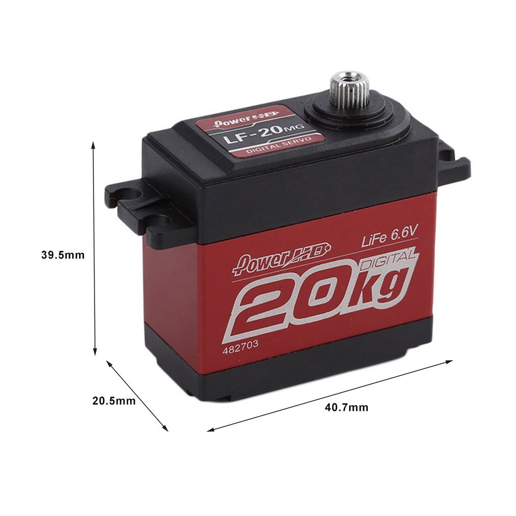

So far, I have painted the Elefant in sand yellow, installed two drive motors vertically, and locked two spare track links on the front armour. More of bench test are carried out yet un-satisfied:
The gun elevation servo became no-responded and so replaced a new 20kg-cm one. Luckily the size is the same as QZ501.
