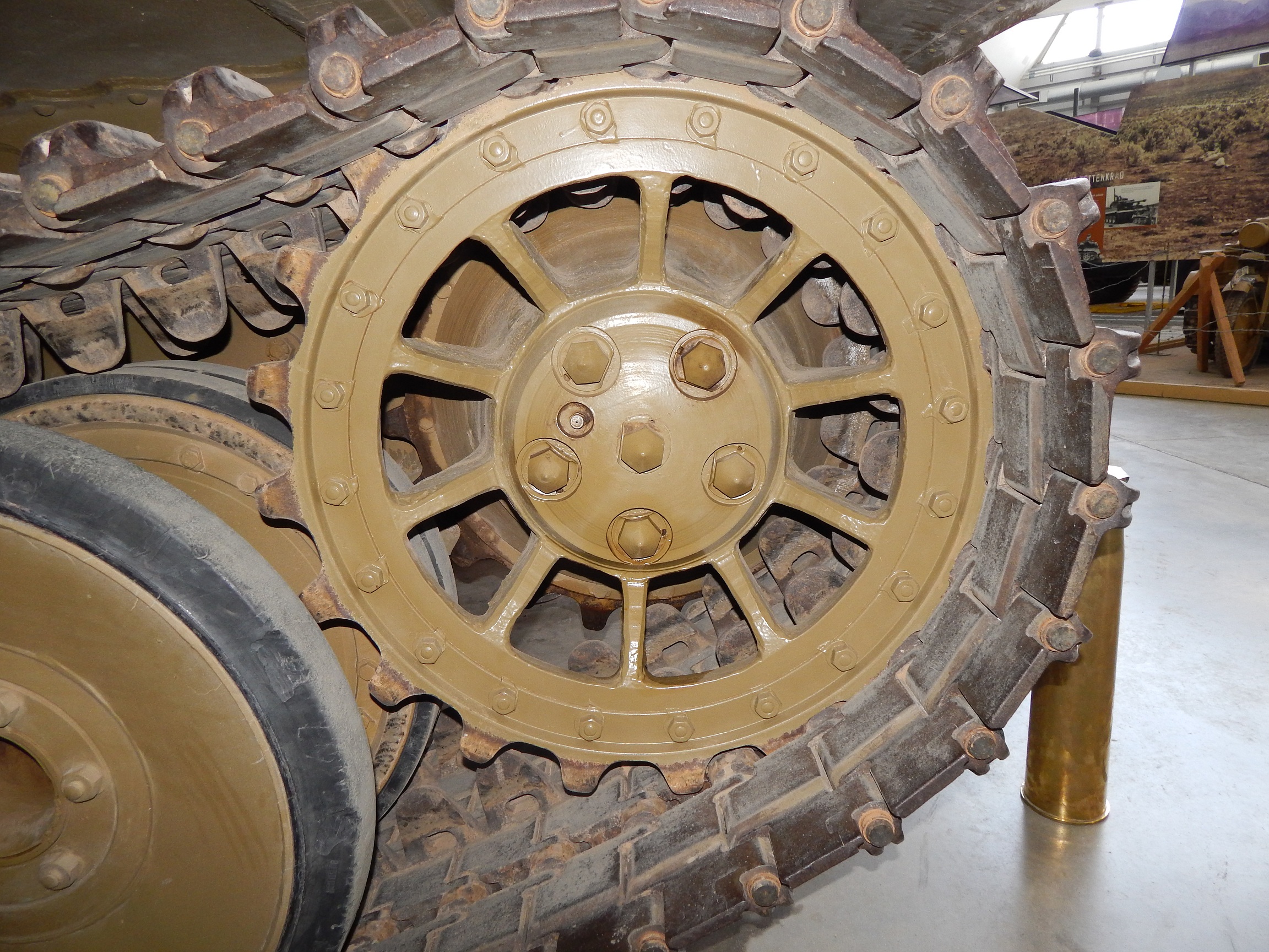

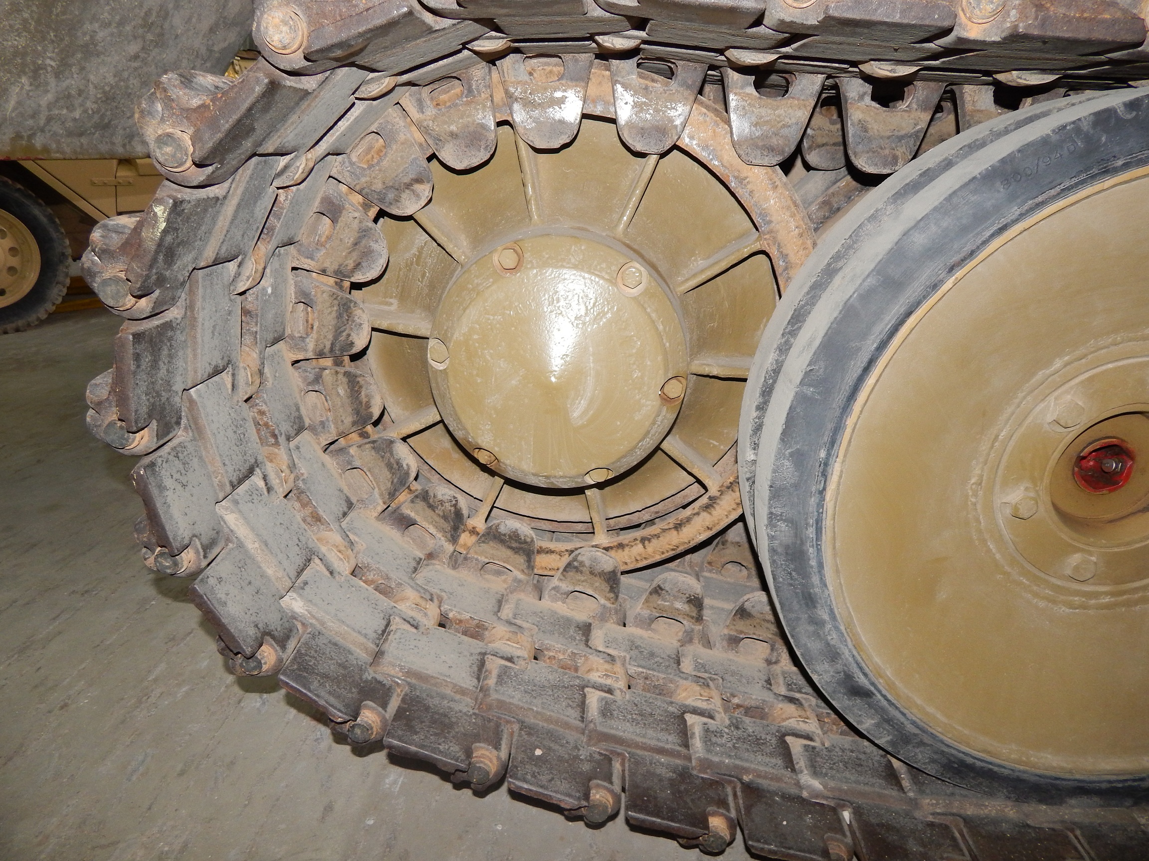

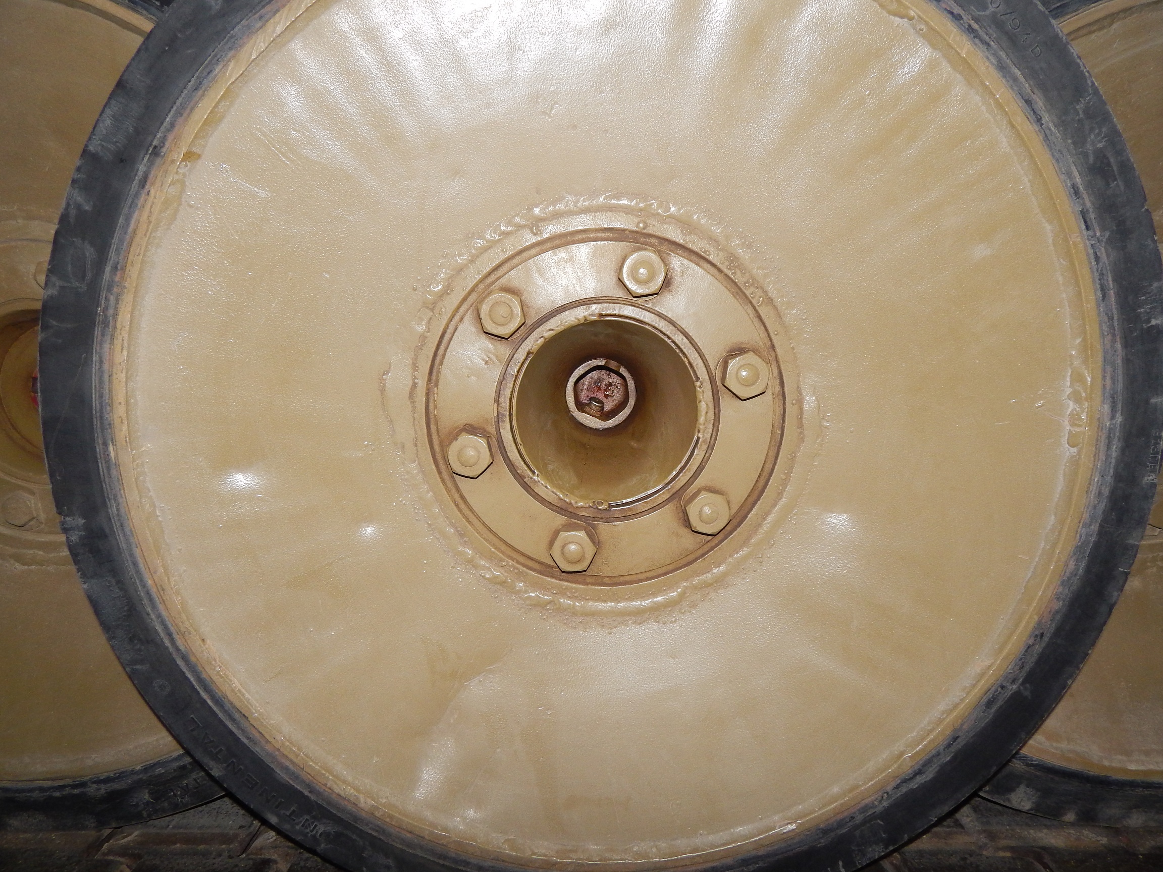

maybe of use for your build some pics of the wheels on Tiger 131 I've taken at TankMod 2016.
Regards from the Cologne Area,
Uwe

Thanks again David, I always wondered whether the m3 hex was a tad to big for the outer but you have put my mind at rest, I will sort through my nuts and bolts box to find the closest I can for the others, I have spent the day taking the backlash out of the cross slide on my lathe as I want to turn smaller more delicate components(like the hex heads) without it chattering and ruining the surface finish.
Thanks Uwe for the photos of 131, always good to see the old girl in detail, they will help the cause.I havent really noticed the tooling/press manufacturing marks in the road wheels before, they sure show up in that light, I wont worry to much about the casting texture of my wheels so much now.

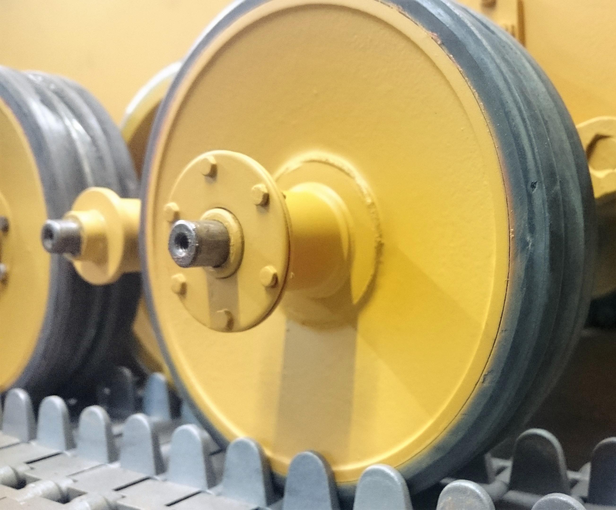

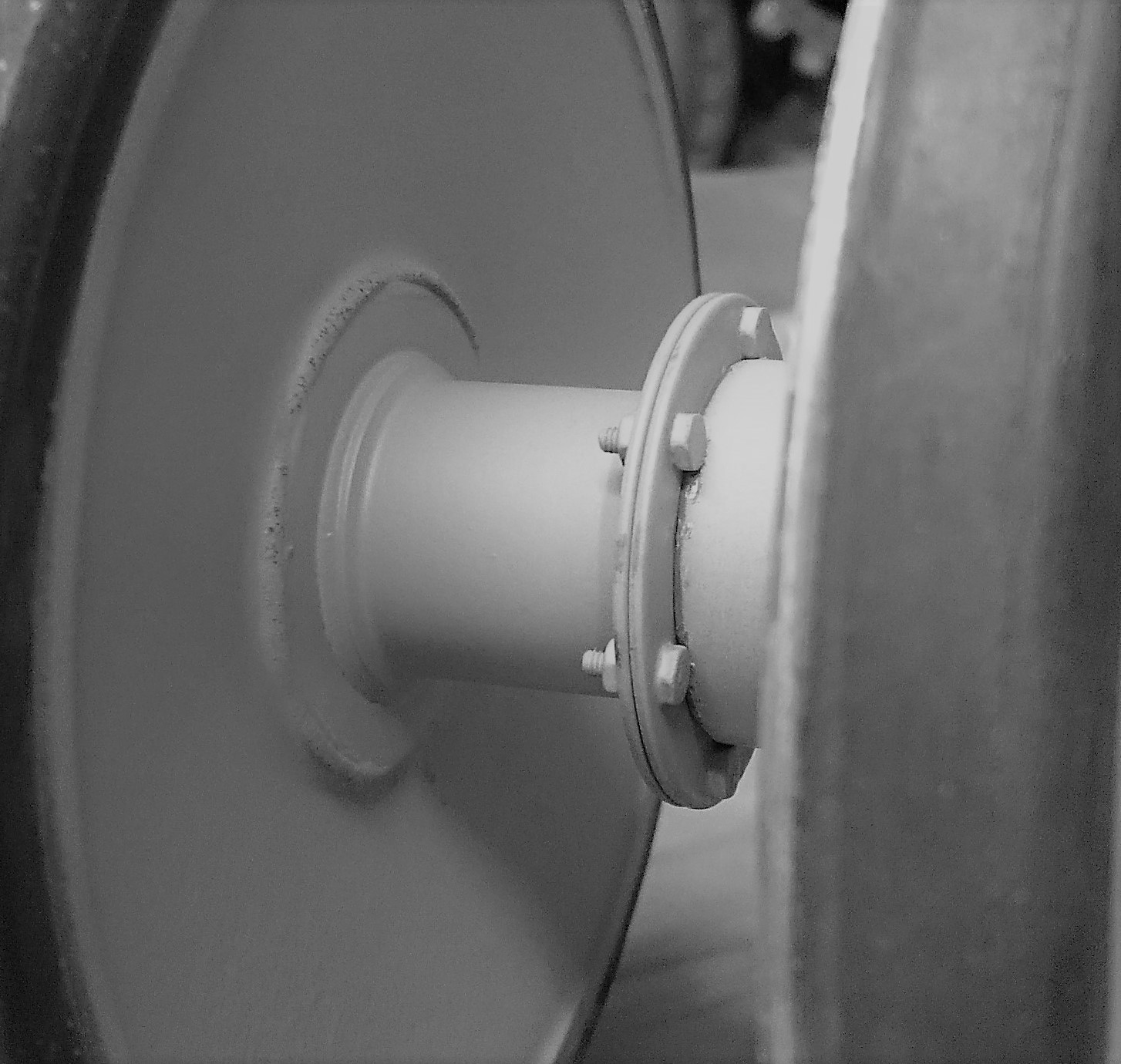

Re: New build Tiger 1

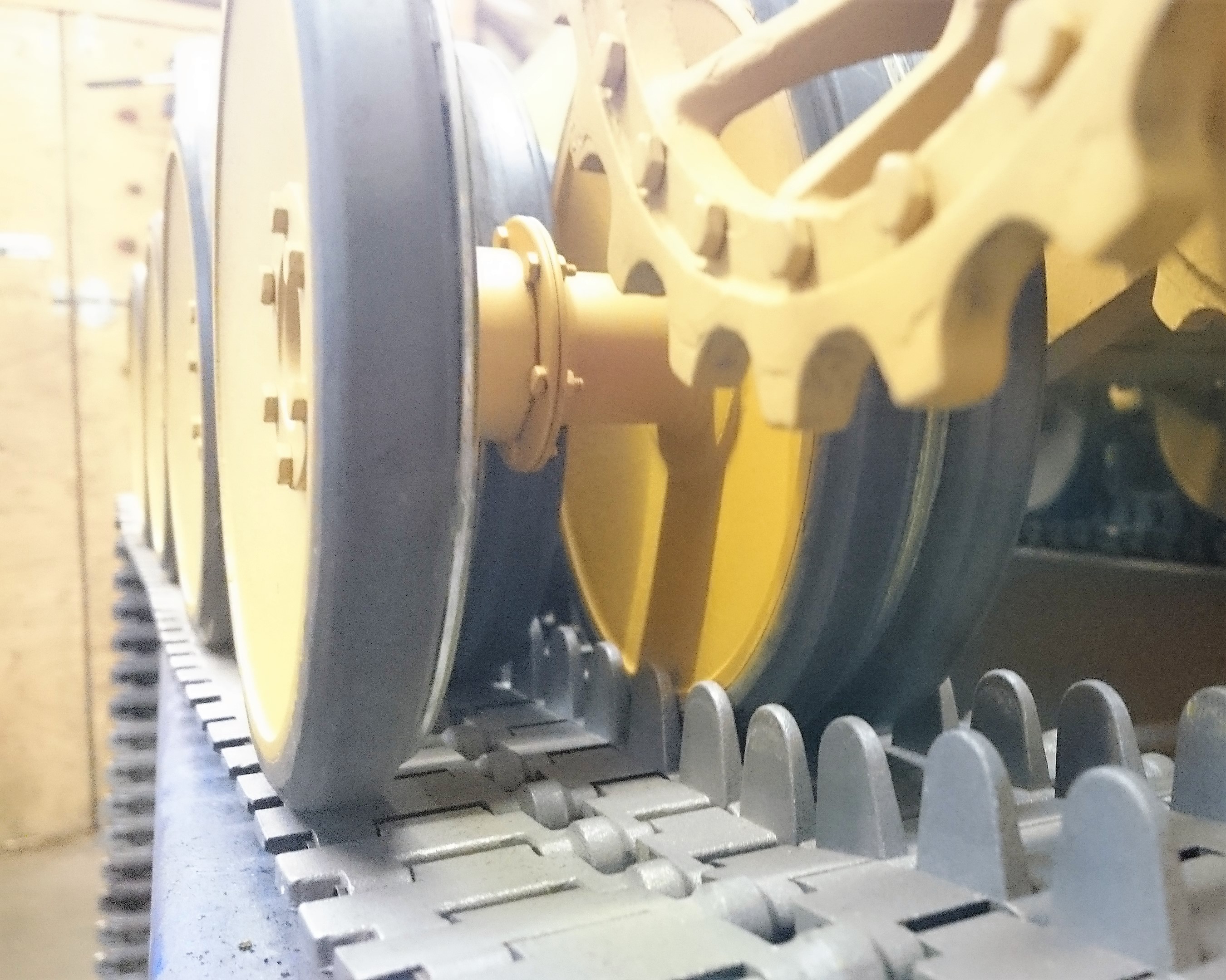

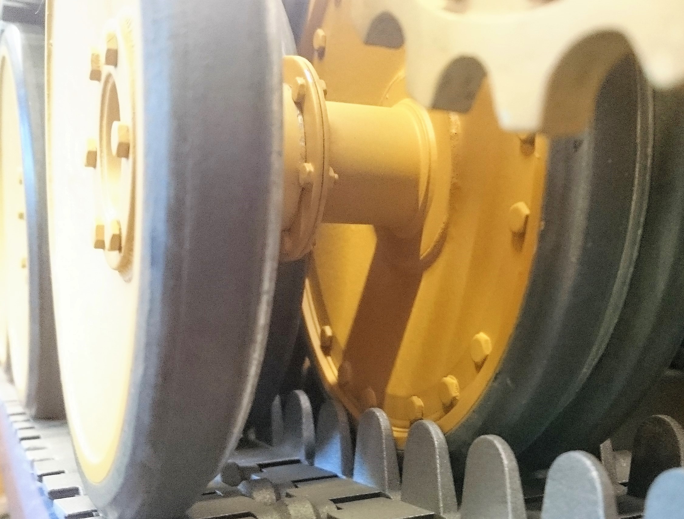

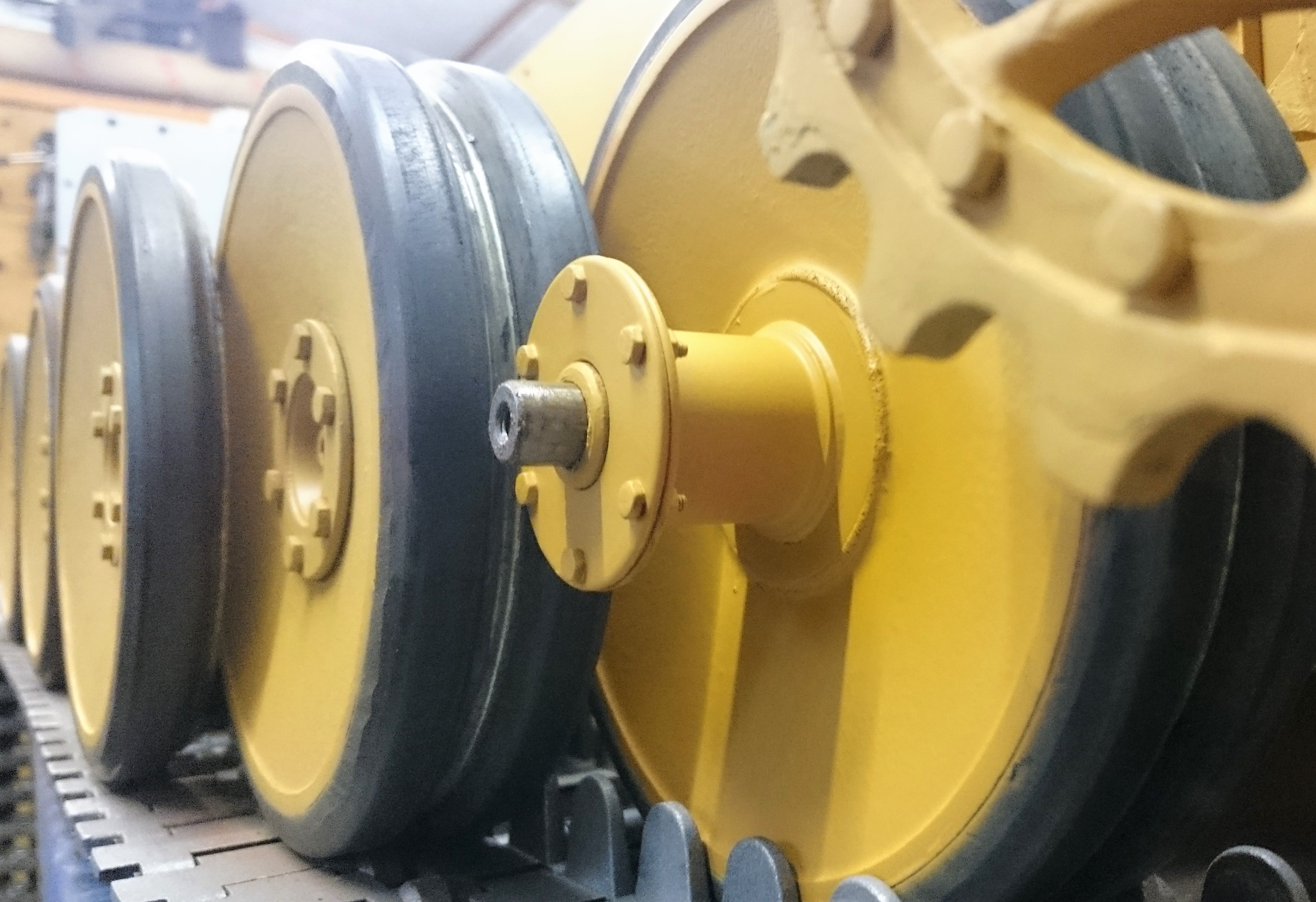

Close ups for David and Paul of the one piece wheel assembly, the once separate bobbin/spacer is now bonded to the wheel with a disc to cover the threaded holes and form part of the hub, this is then held by a machined lip on the spacer and the ID interference fit to the same , then bonded right up to the bearing (taking care not to contaminate the bearing) and a fake weld added just like the full size Tiger.
For those using a double inner bearing the spacer/bobbin would need to be machined down accordingly, the bearings should not bind on the spacers or the end of the axles so you would need to factor in some essential "end float" or it will just not run smoothly.
Its a lot of work and each axle assembly/component needs its own careful fitting ("fitting" as in mechanical term) to run smoothly, and as I have said before..... its not necessary to do any of this machining and fitting with your own Tiger, I just want this to be special
- Due to the overlapping arrangement the outer wheels are bolted to the spacer but I am not prepared to undo six 2.5 bolts behind the hub every time the wheel requires removing for the build , so I use the m4 cap in the end of the axle, this will be replaced with a more realistic fixing along the lines of Liams build when its all complete.
Not to dissimilar to the original.

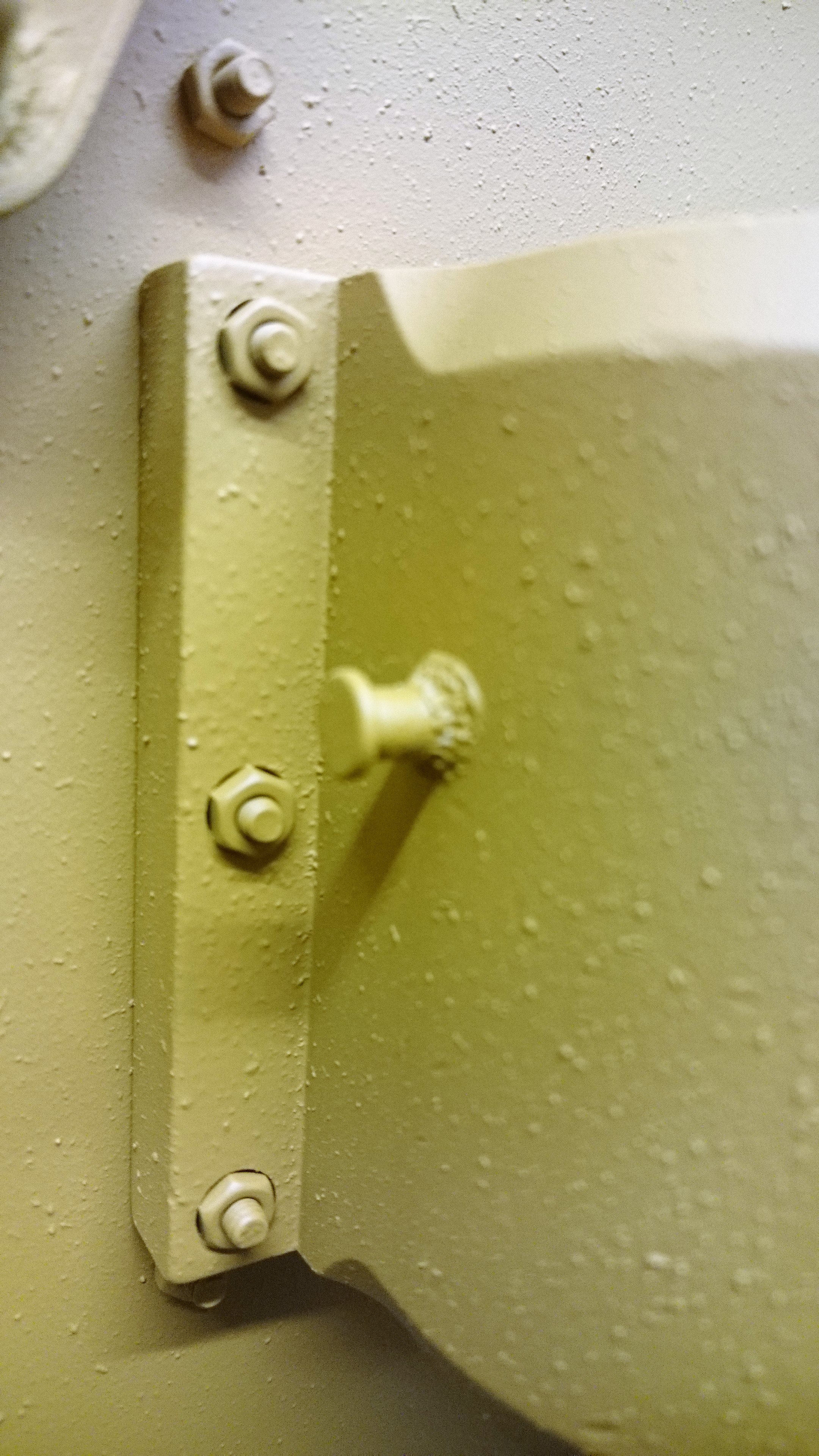

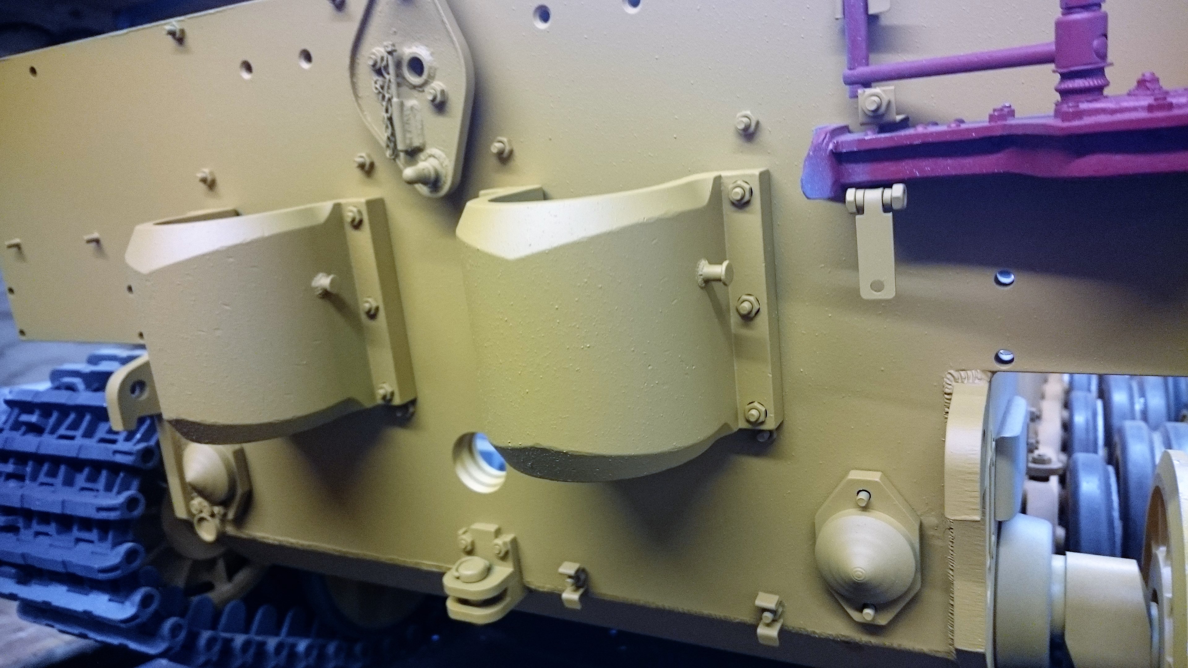

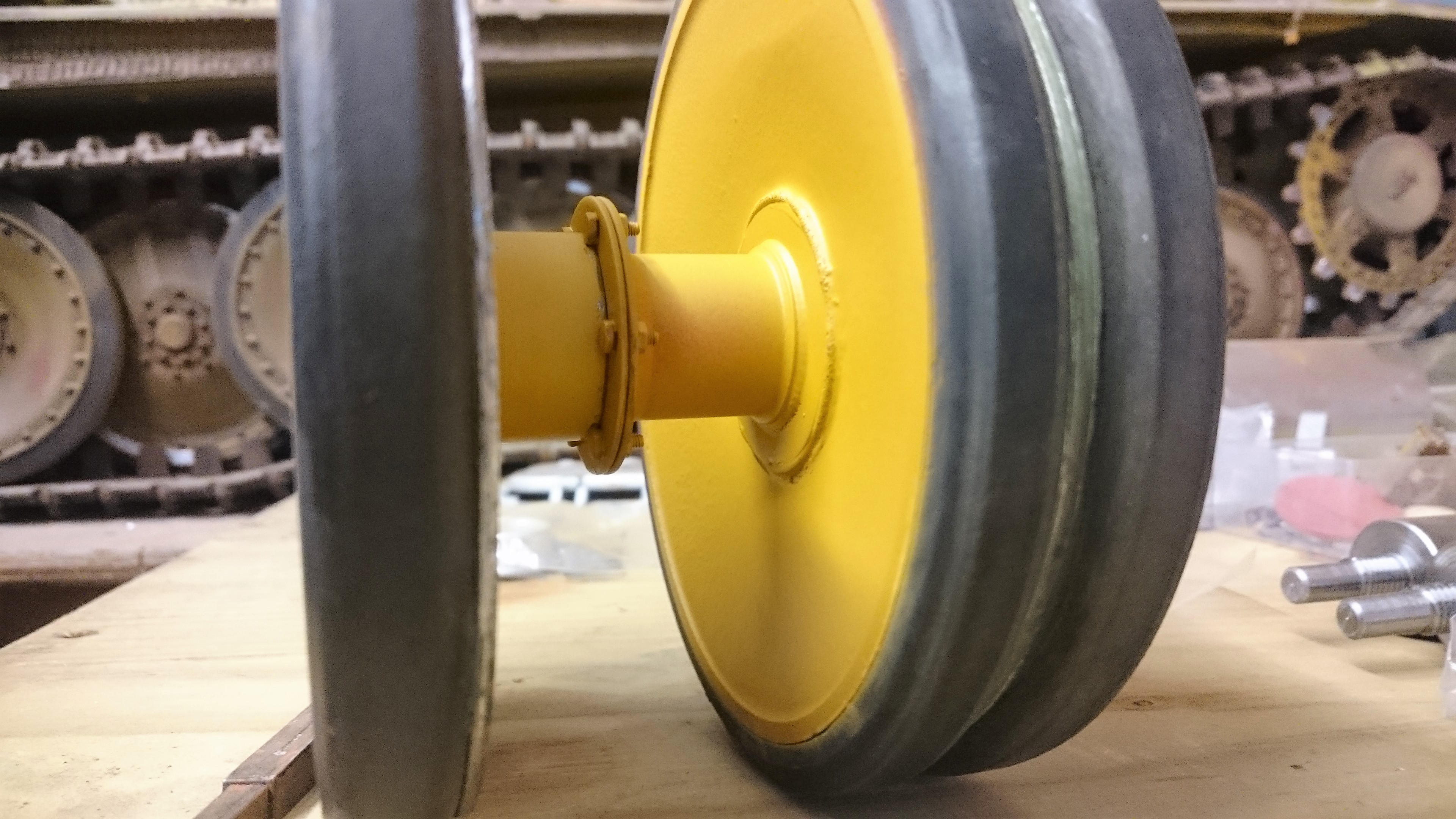

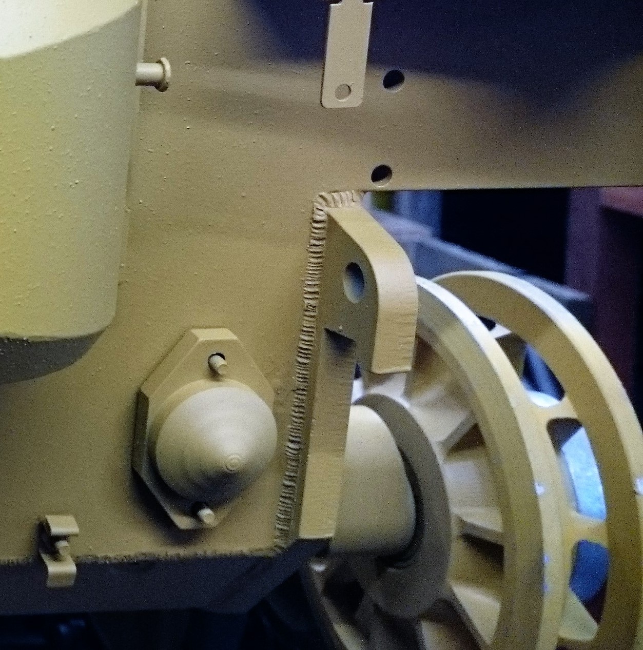

I have been slacking of late as have farming to do but I have finished the Tiger wheel assembly,well as much detail as I think is necessary anyway like the hub weld and the double wheel rim bolts, and a bit to the back plate.
- The weld around the hub or just off the hub is a bugger to reproduce as its position can be quite different (depending on which example you are following as reference) I can see now the trouble some of the other guys have had, but its well worth the effort me thinks.In reality its maybe only 12mm or so wide so ends up slightly over scale in milliput.
- Paul Wills

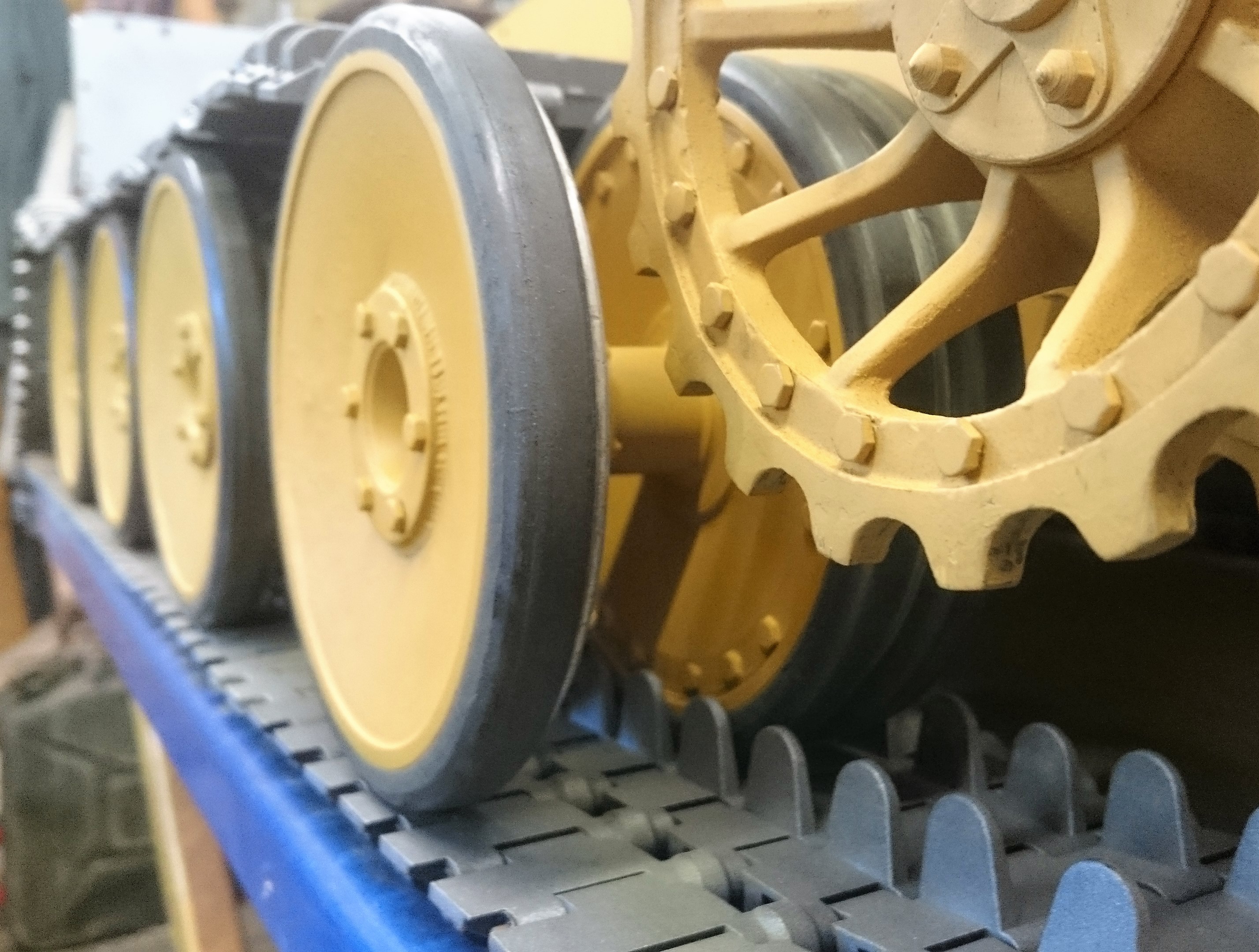

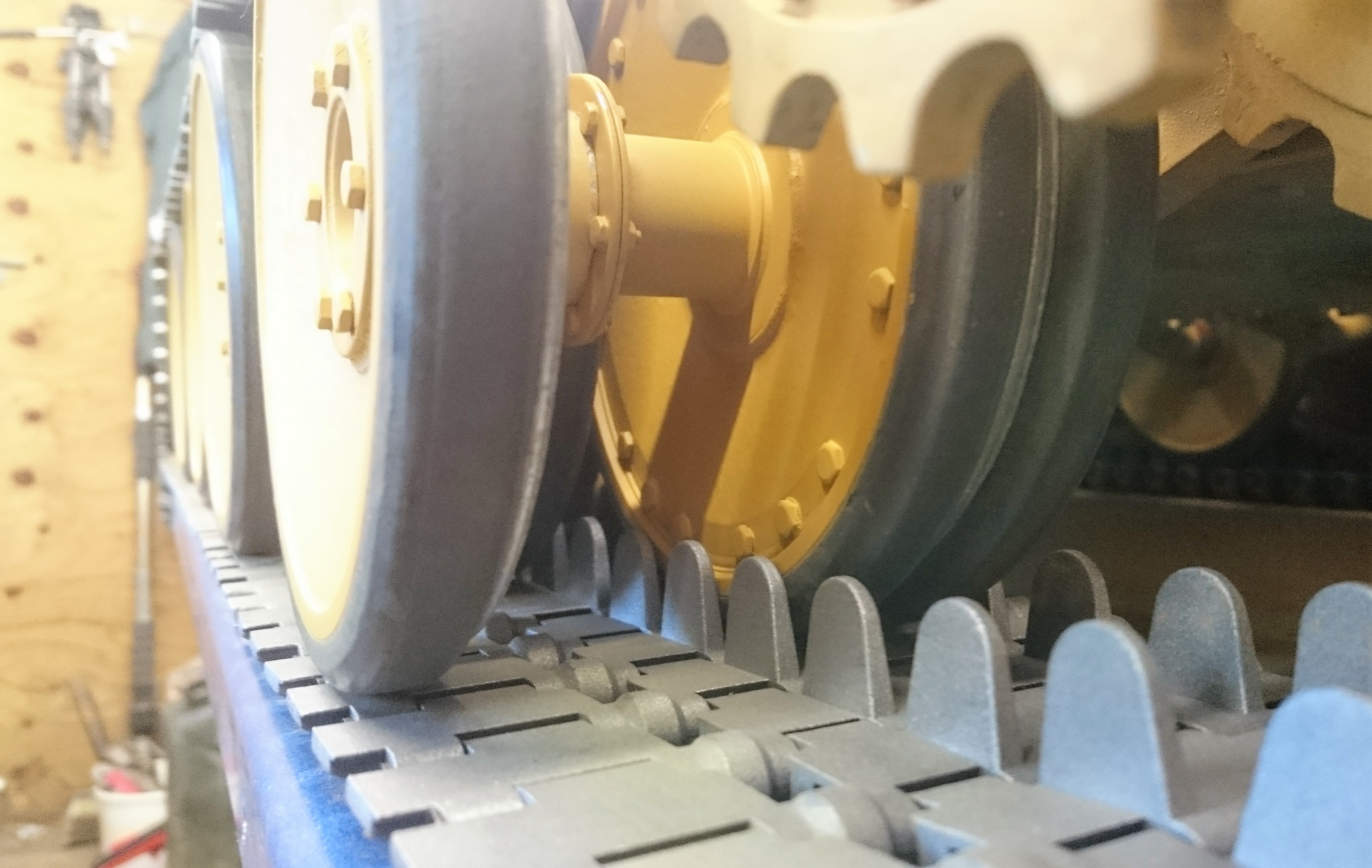

Hate to bring this up now but I just noticed it, on the outer wheels the hub should be recessed.
Here is what I did on mine.
Here it is completed and after running the tank for a while, compare this with the pics above of Tiger 131.

Hi Mike, yes I agree the hubs will need recessing to look correct, I thought I could get away with bringing the weld bead right up to the hub but im not happy with the look, so I shall turn a recess for the hub and a shallow groove to take the weld bead (its almost impossible to make a weld bead look right in and arc) out to a more correct position, and then apply as small a weld bead as is humanly possible with milliput.....Phil
