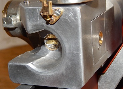

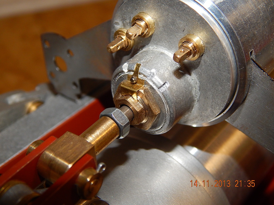

There is a wide range of work( just the normal rework I think) on the KIT content, plus my individual changes and add on's. That is what makes the fun on the build, isn't it ?
Today I've finished vs. added again some bits and pieces on the recoil tube and breechblock and I'm happy for now with the result ..

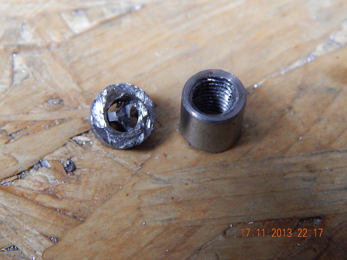

The quite little insert on the "Spanner" blocker has been flown away three time, so I'm fed up for now and it is time to go for some bigger parts of the Flak
Uwe
thank you

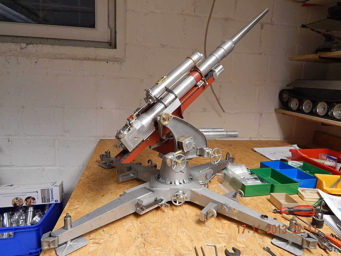

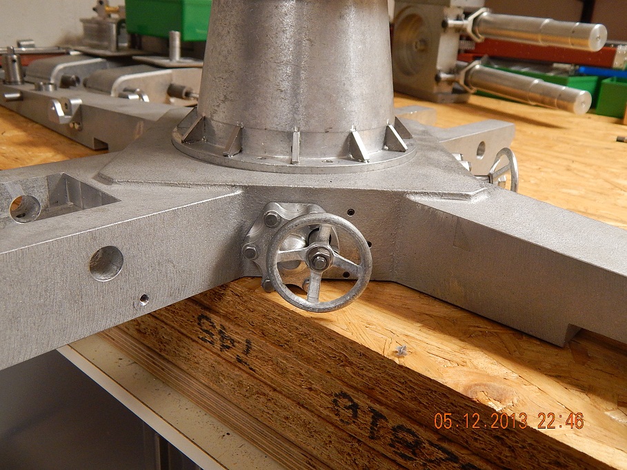

Hello and thanks to all interested in my build
Made a bit of progress and finished so far the cruziform.
For now the cruziform is just as it is out of the KIT to get the fit & functions along..
With some "obstacles" I managed finally to get the gun on the base and the leveling working smoothly
A million treads made ok, I found the only one helicoil insert
Maybe I should play Lotterie
cheers so far,
Uwe
cheers so far,
Uwe

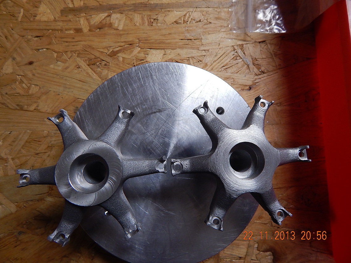

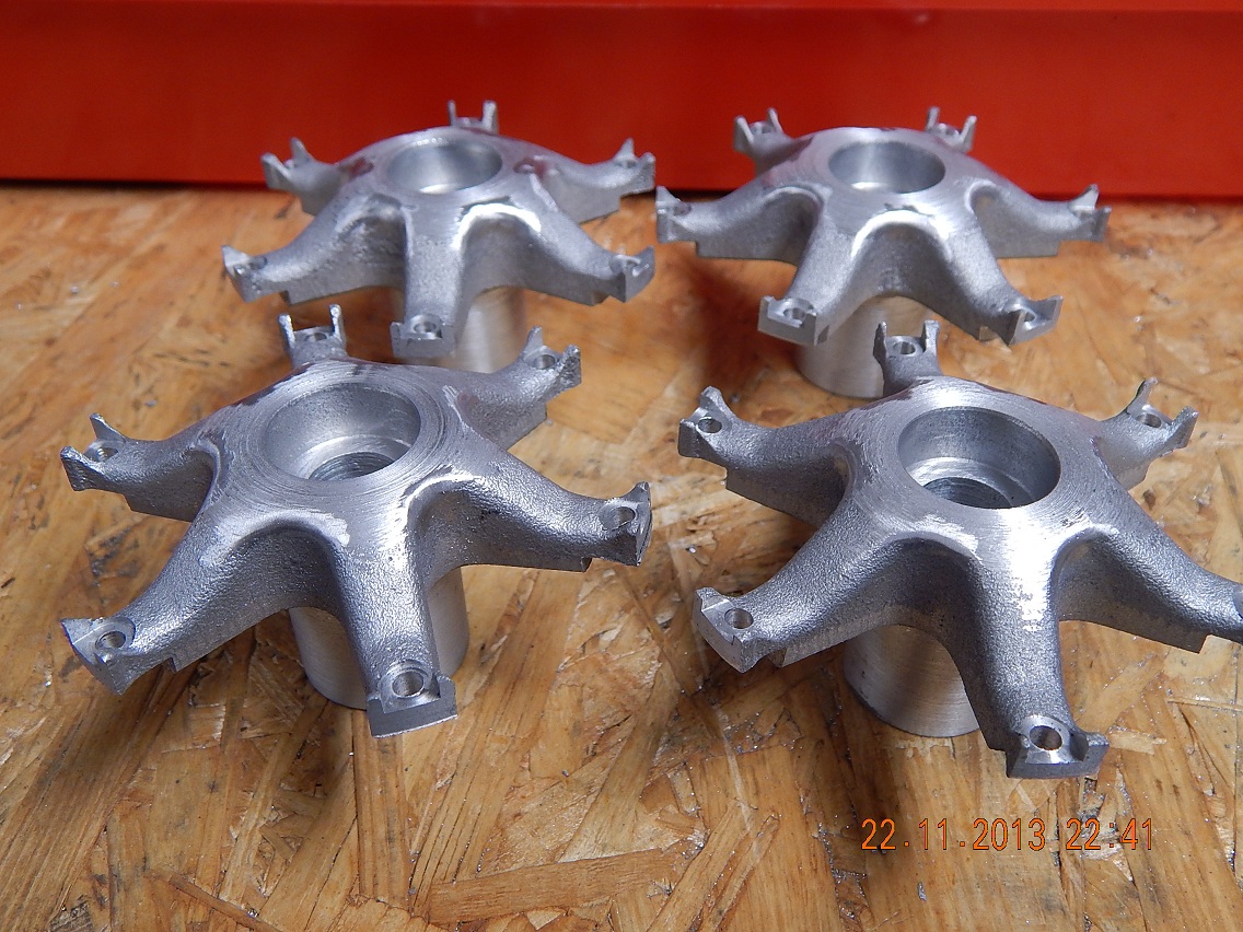

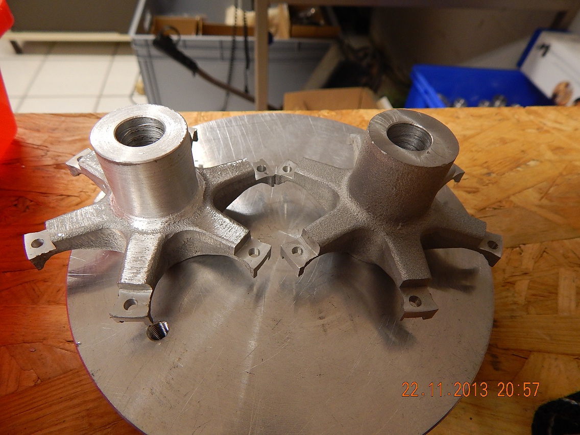

still busy with the cleaning up and preparations on all the cast parts for the next steps. Not much time left at the moment for the FLAK
I've had a look at the "Trilex" wheel components and had to do "some" corrections
Today I've finshed at least the first step, centering and shape corrections on the inner stars.
Next step to get the surface mods blasted to align the appearance
cheers so far,
Uwe
cheers so far,
Uwe

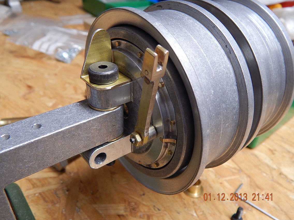

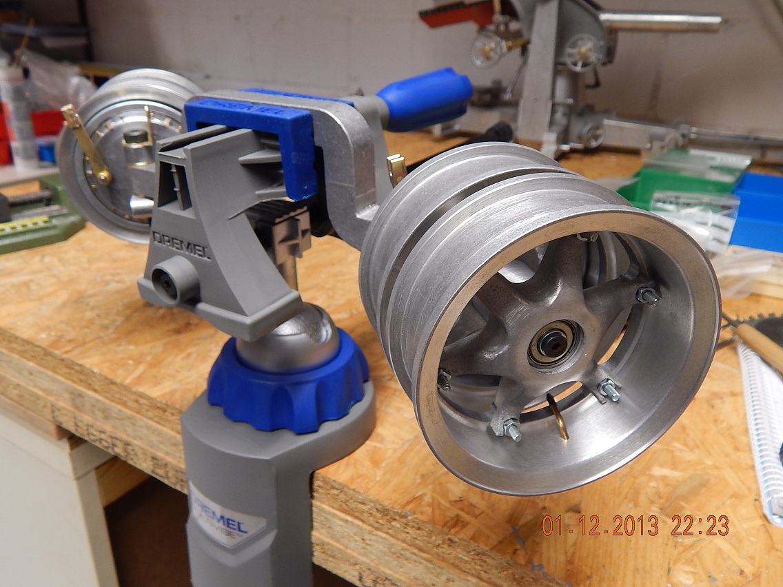

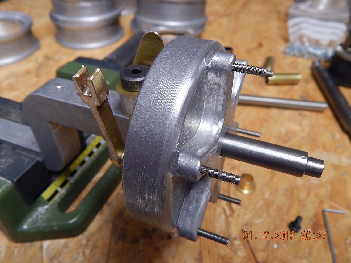

In between business and family demands I made at least some progress on the Trilex Wheels.
The blasting op has to wait a bit, so I made some other mods on the "wheels-story".
Up 'till now I'm quite happy with the results and can finalize it once the missing bits and pieces are in place Anybody an idea what will be realized
Attached are some pics of the progress so far,
cheers,
Uwe
thanks a lot
cheers,
Uwe

Just have made a new leveling bolt to sort out my "Helicoil" win
Working again on the cruciform I started with the first mods....

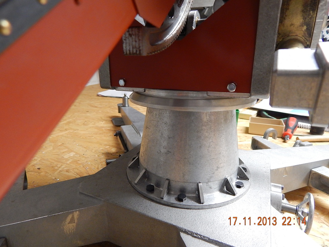

Re: Uwe's 88

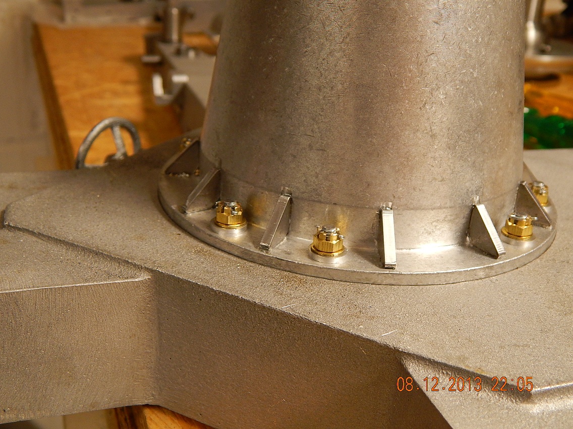

Some small progress on the base.
I couldn't find ready ones so I made the thicker washers and nuts myself.
Busy with the bolts for the movable cruciform legs and some shaping on the small bits and pieces for the cruciform..
Hi Paul
it took a bit more than just spinning around, but it's not that complicate
cheers ,
Uwe
Hi Paul
cheers ,
Uwe
