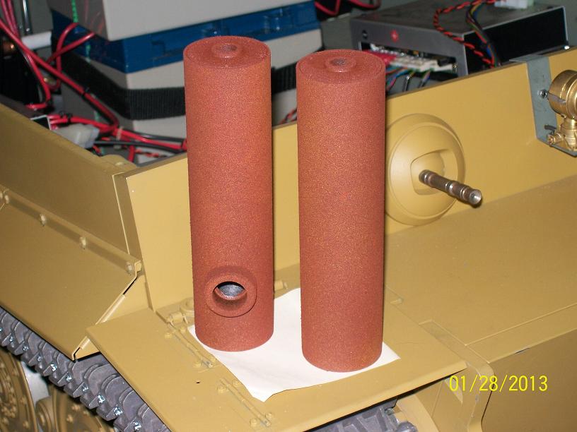

I hate to tell you this, but your engine, although supercharged and unmuffled, just won't do. :wink: But the rest looks very good! I particularly like your mechanical on/off arrangement. You probably spent less time on it than I did on my electrical counterpart! :lol:

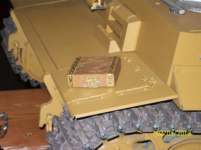

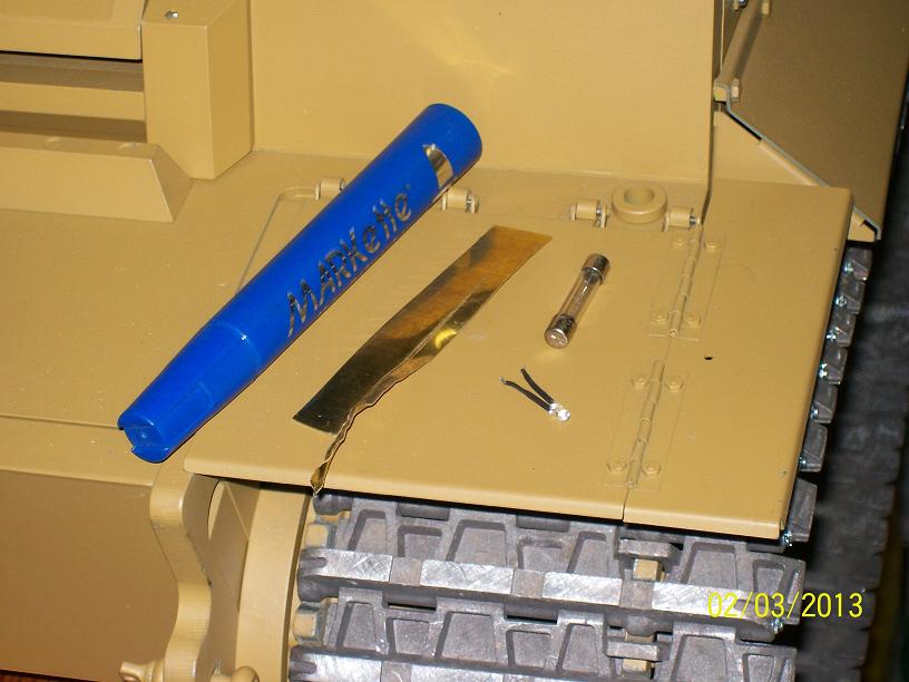

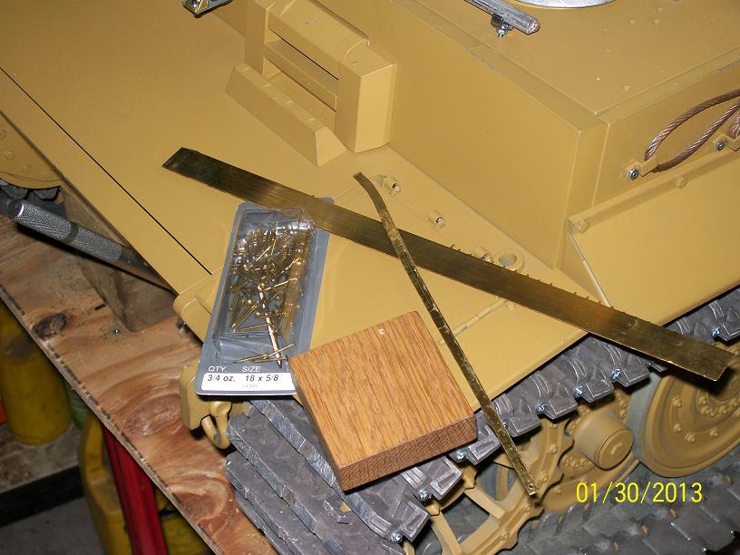

Hi all.

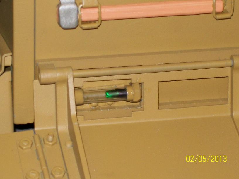

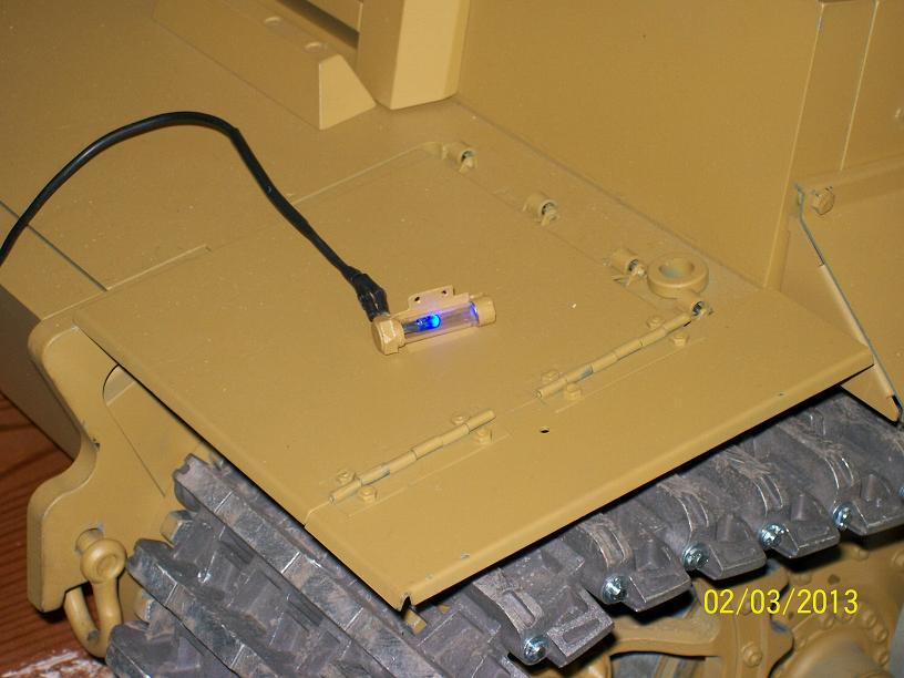

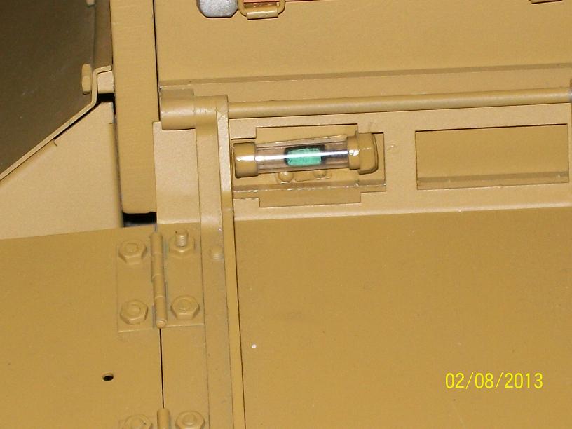

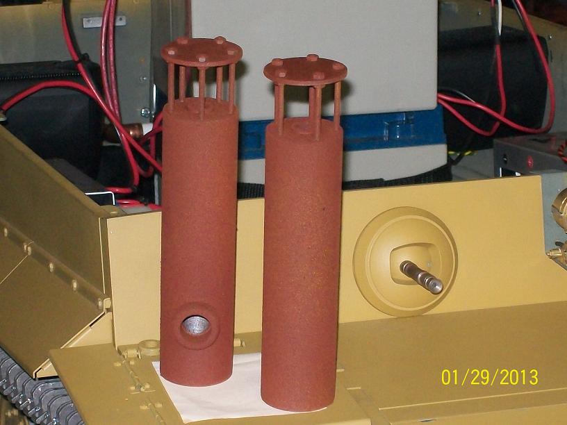

Here are a few pics depicting my first ever attempt at simulated rust . And spiffing up the supplied jack block with brass scrap and brass pins and a piece of paper clip . Also a scratch built rear light made from an old style automotive fuse , brass scrap and a blue LED scrounged from a novelty ink pen . The LED actually shines blue but the housing was clear , so I colored it with a marker . That's all for now .
/Steve .

Love the use of the fuse but you may want to change the colour of the LED:

Looks like I need to scrounge for a green LED ! :oops:

Presto ! Now it's green !

Thanks for the kind words.Unfortunatly I burnt out that led trying to hook up to the r/c system.Going to need someone to draw me a picture as I am not that versed in electronics and such.

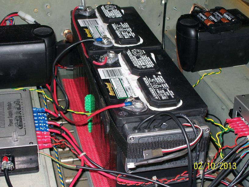

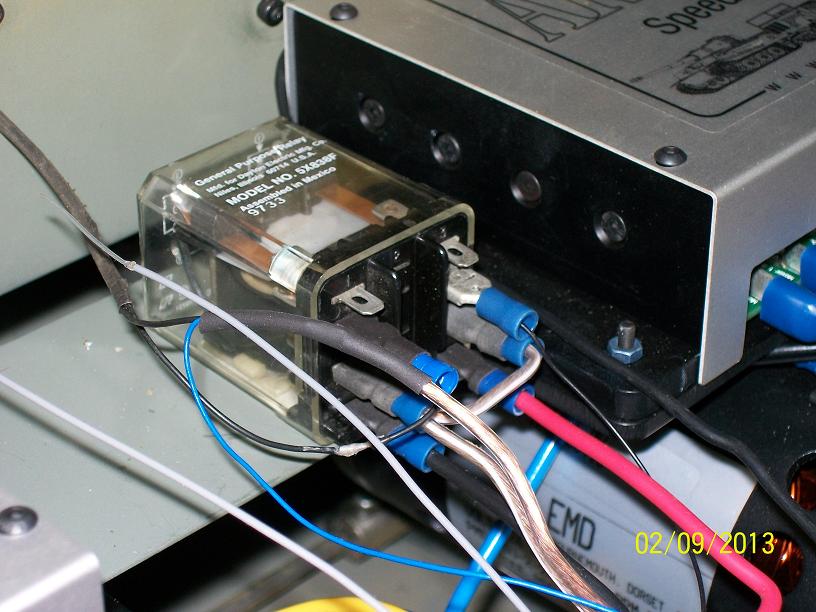

Hi all!

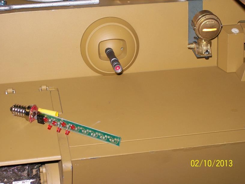

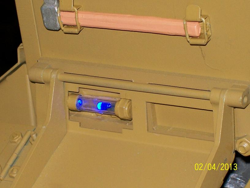

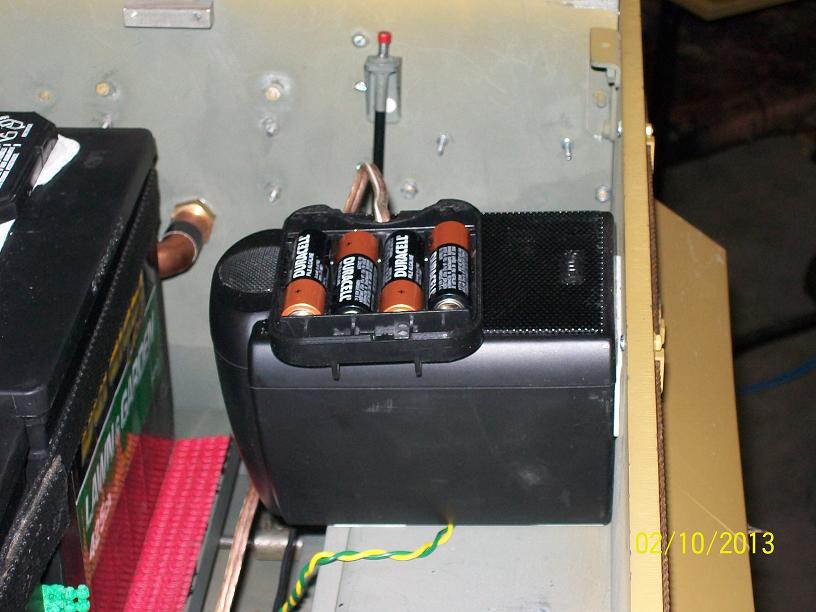

Here are a few more pictures showing my remote lights solution,my stock machine gun converted to flashing LED using an old emergency light for parts,different batteries and a new toy for the commander.The batteries were needed as the old ones were not in as good of shape as I thought.And they crapped out on me twice out in the back yard.Even though I am 6 feet tall and 300 lbs,it is still quite a task to drag it back into the work shop alone!I should have taken a pic of that! :lol:
Thanks all.
Steve.

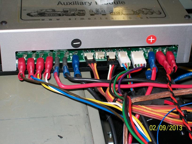

Steve,
Do you know that you can drive the m/c gun led direct from the TBS5 in the amplifier module so that when you select m/c gun sounds on pos 5 the led will flash in sync with the sounds. If you want details of connections then let me know.
Dennis.

Yes that is how I have it hooked up.Now all I need to do is to try and not wear it out from using it too much! :lol:
Thanks!

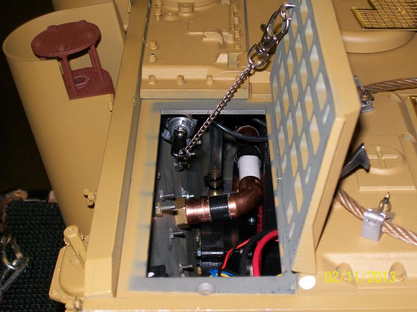

Hi all.

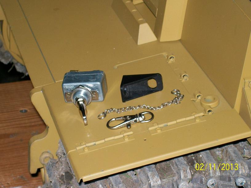

Just a couple of pics showing my improvised engineered emergency kill switch set up.
Thanks.
Steve.
Dennis Jones
Posts: 893
Location: Poole, Dorset
Has liked: 10 times
Been liked: 224 times
Re: Tiger I 2012 037 build
Post by Dennis Jones »
Hi Steve,
Just make sure that switch will take the current, needs to be at least 30 amps either that or use it together with a relay. I usually use a double pole switch and strap both poles together which doubles the current rating of the switch.
Dennis.
