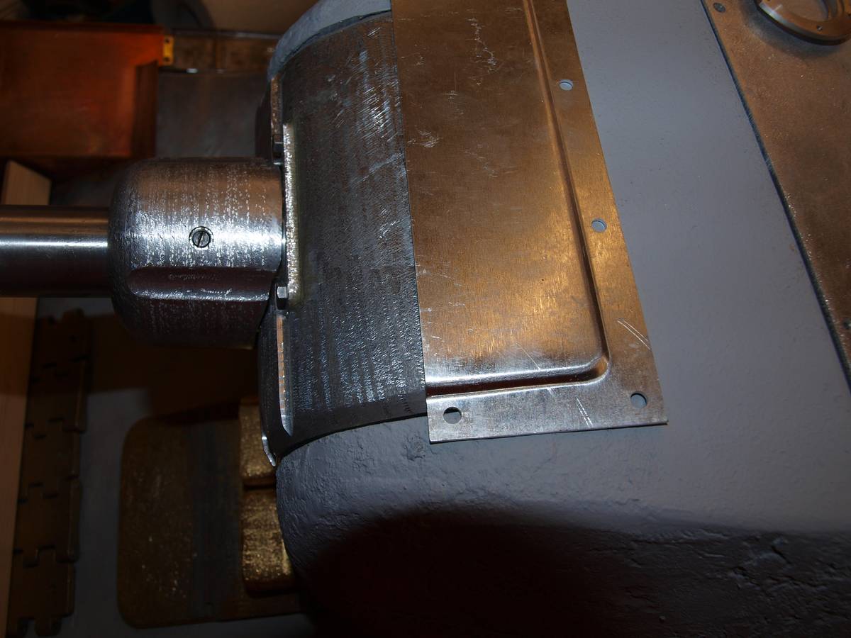

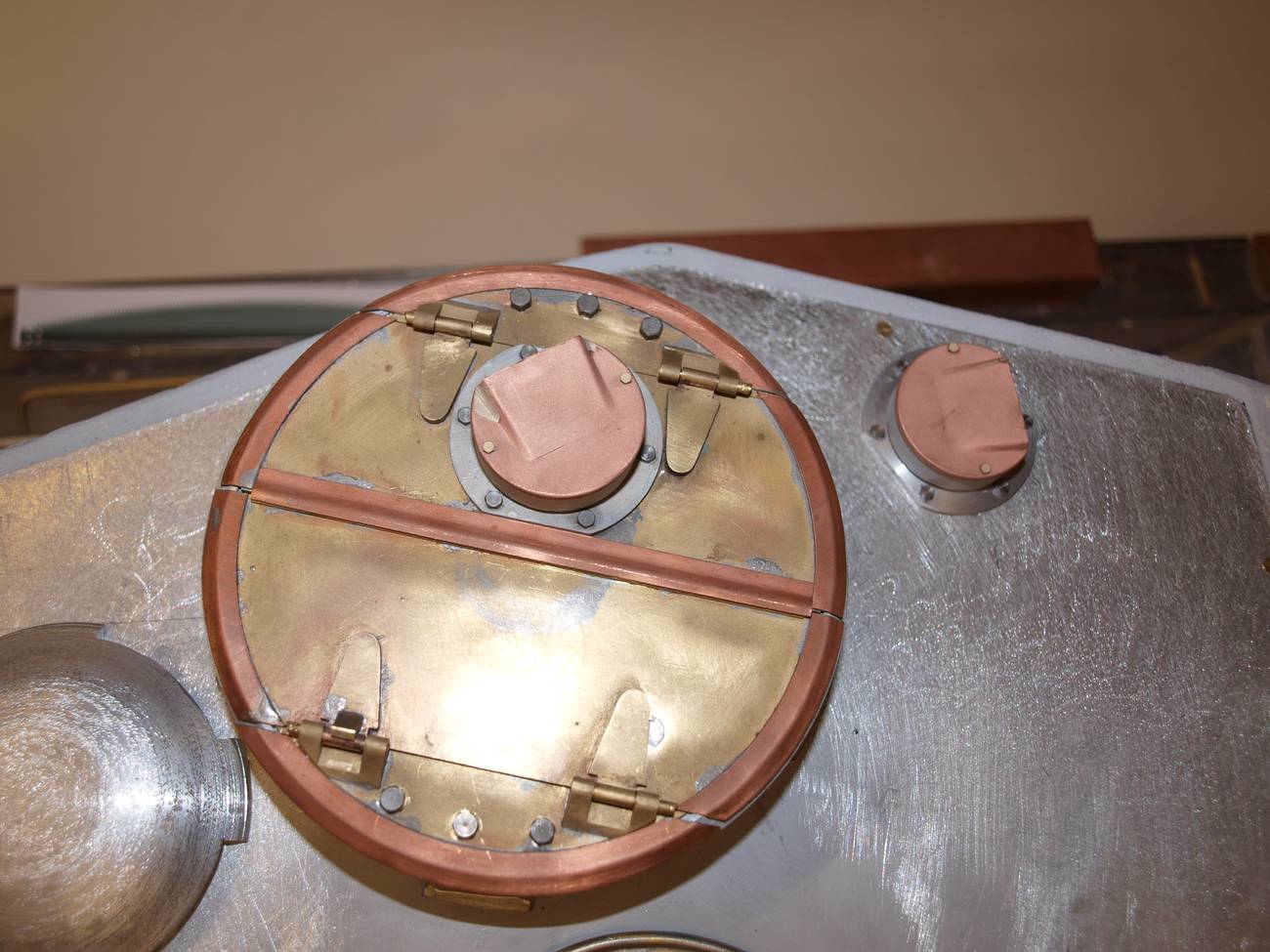

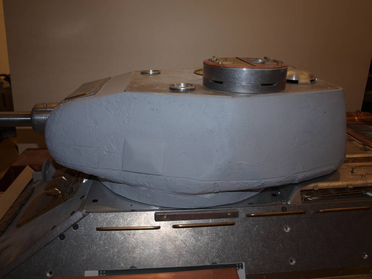

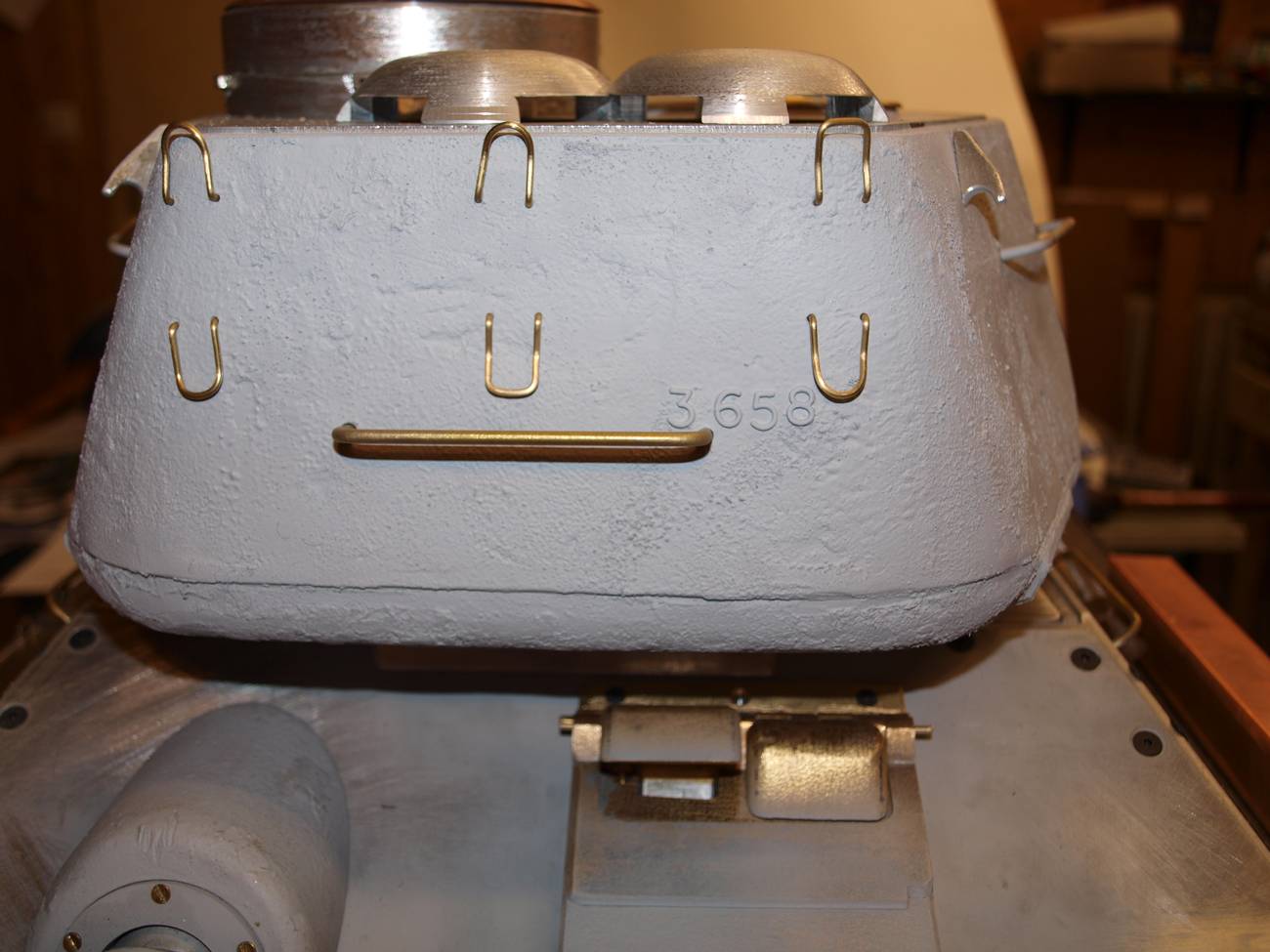

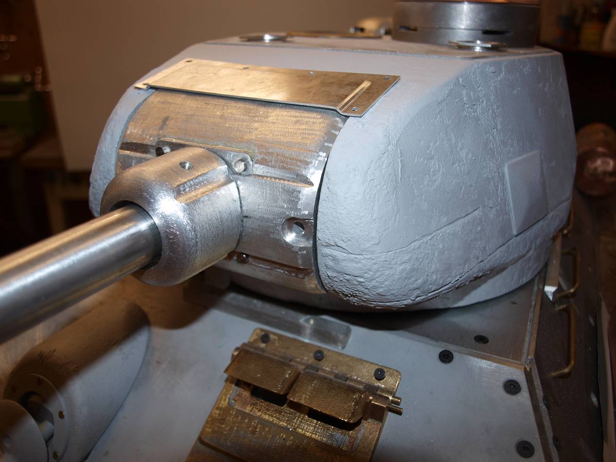

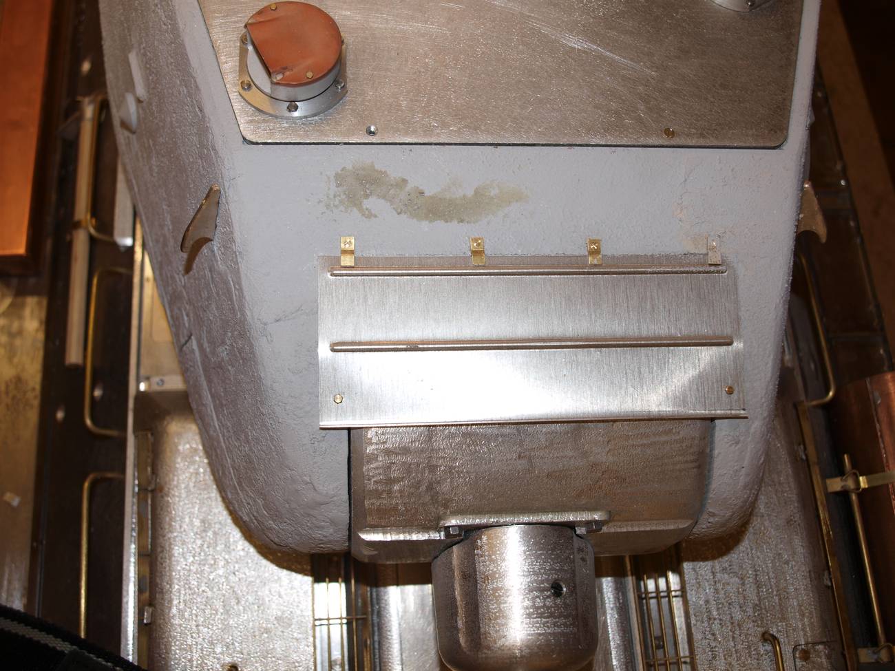

Hi all,

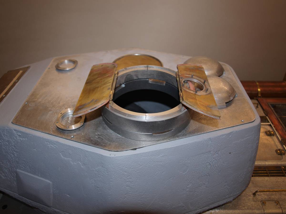

I have started to reshape the turret and give it a casted appearance. Not finished at all. I changed the cupola into the cupola with the splitted hatch. Maybe somebody could tell me, if the hatches were pivoted, because on some pictures the hatches are in different positions. Also it would be nice if somebody has a picture showing the locking.
Regards Bodo
Regards Bodo

Re: T34 Idlers
Hi Bodo, what shall I say
--it blew away my socks!!

Re: T34 Idlers
Hi Bodo
Nice work,I like the detail parts that you are making yourself and
the casting looks good.
Phil
Phil

Re: T34 Idlers
another masterpeice bodo, the turret looks superb, a great rough cast texture, the build is going well, regards simon.

Re: T34 Idlers
Hi Bodo,
Stunning work as usual from you, this one will be awesome and another masterpiece from Germany.
Regarding the two-leafed folding hatch it was revolving on a ball-bearing support and therefore will be seen in different positions.
The later one-piece hatch was also revolving in the same way.
Sorry but I can’t help you with the locking photos.
Kind regards
Kent
Kind regards
Kent

Re: T34 Idlers
Hi
thanks to all for the nice comments, especially Kent for his support. Have to start working on the cupola again!!
Bodo

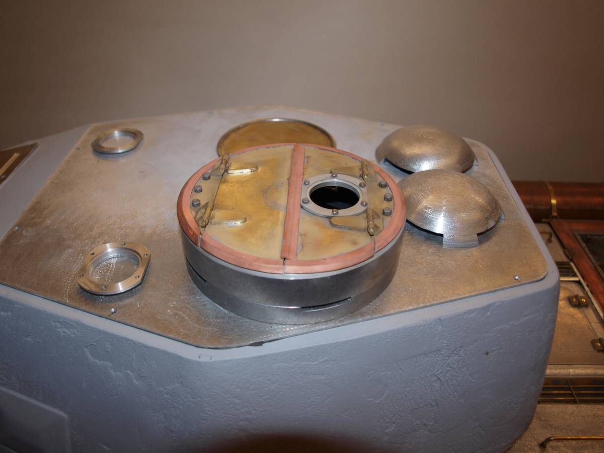

Re: T34 Idlers

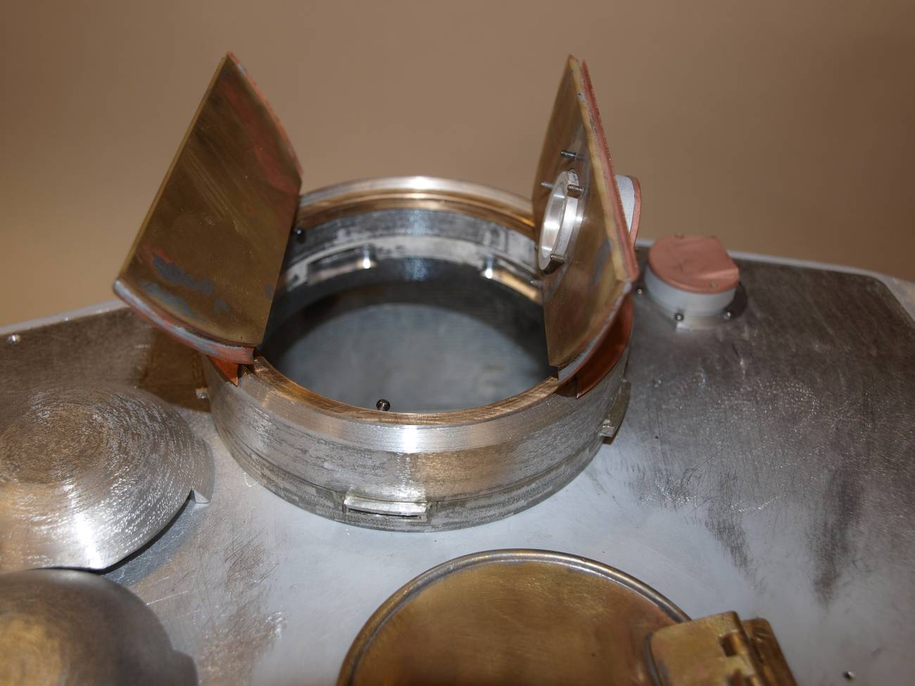

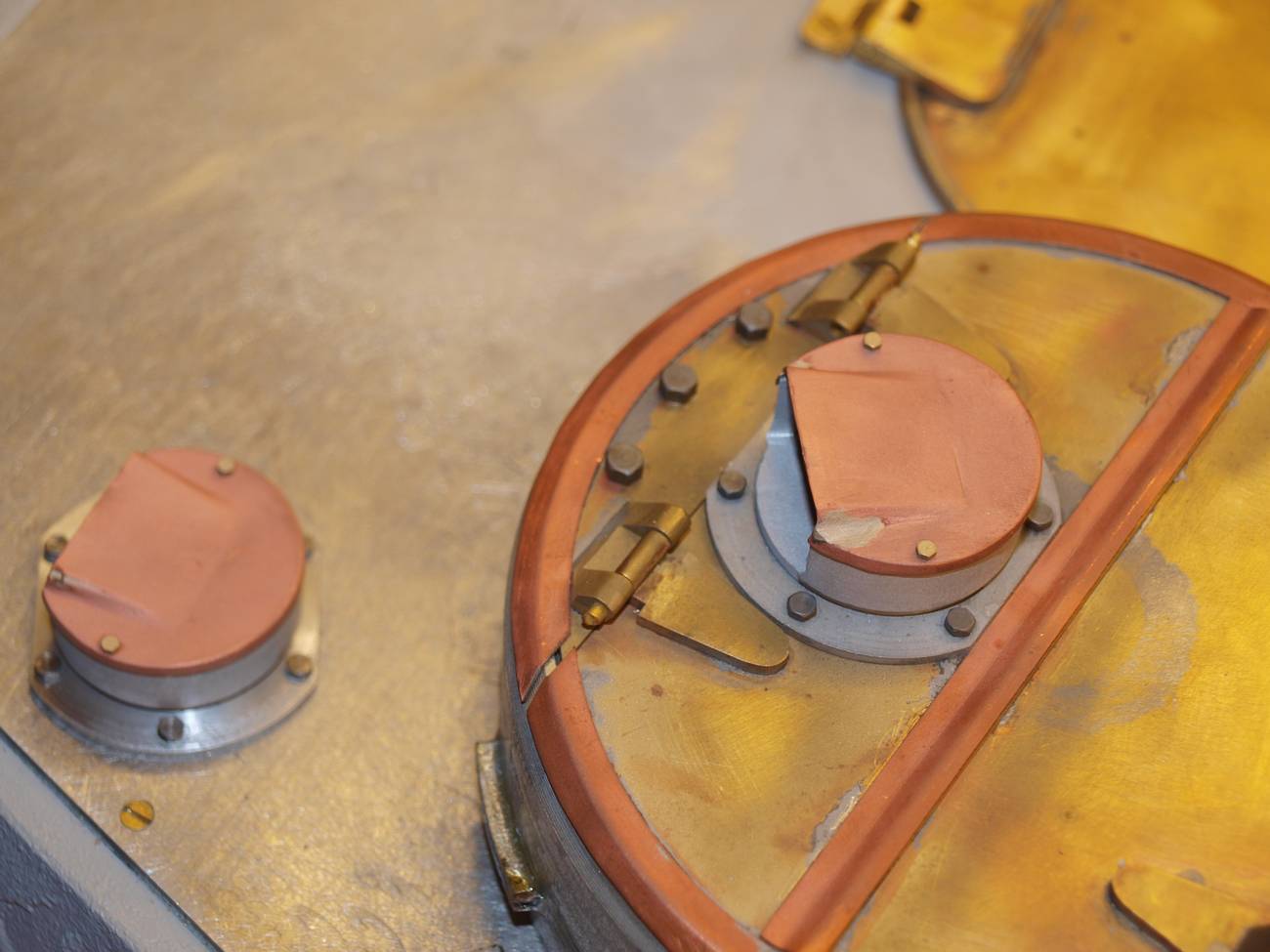

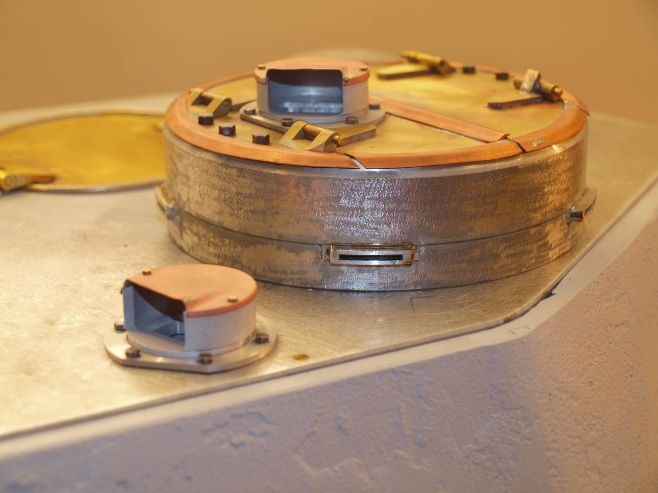

Hi all,
I have redesigned the cupola, now the hatch is revolvable. (Thank`s again to Kent!)
Also the prism housings and the loaders hatch are finished.
Bodo
Bodo

Re: T34 Idlers
Hi Bodo
Outstanding detailing and parts! but then I wouldn't expect anything less from you.
Will be an amazing T34 when you are through with it.
kind regards
kind regards

Re: T34 Idlers
Ho Bodo
More excellent work on your T34,its inspireing to see the parts that
you make or adapt yourself
Phil
Phil

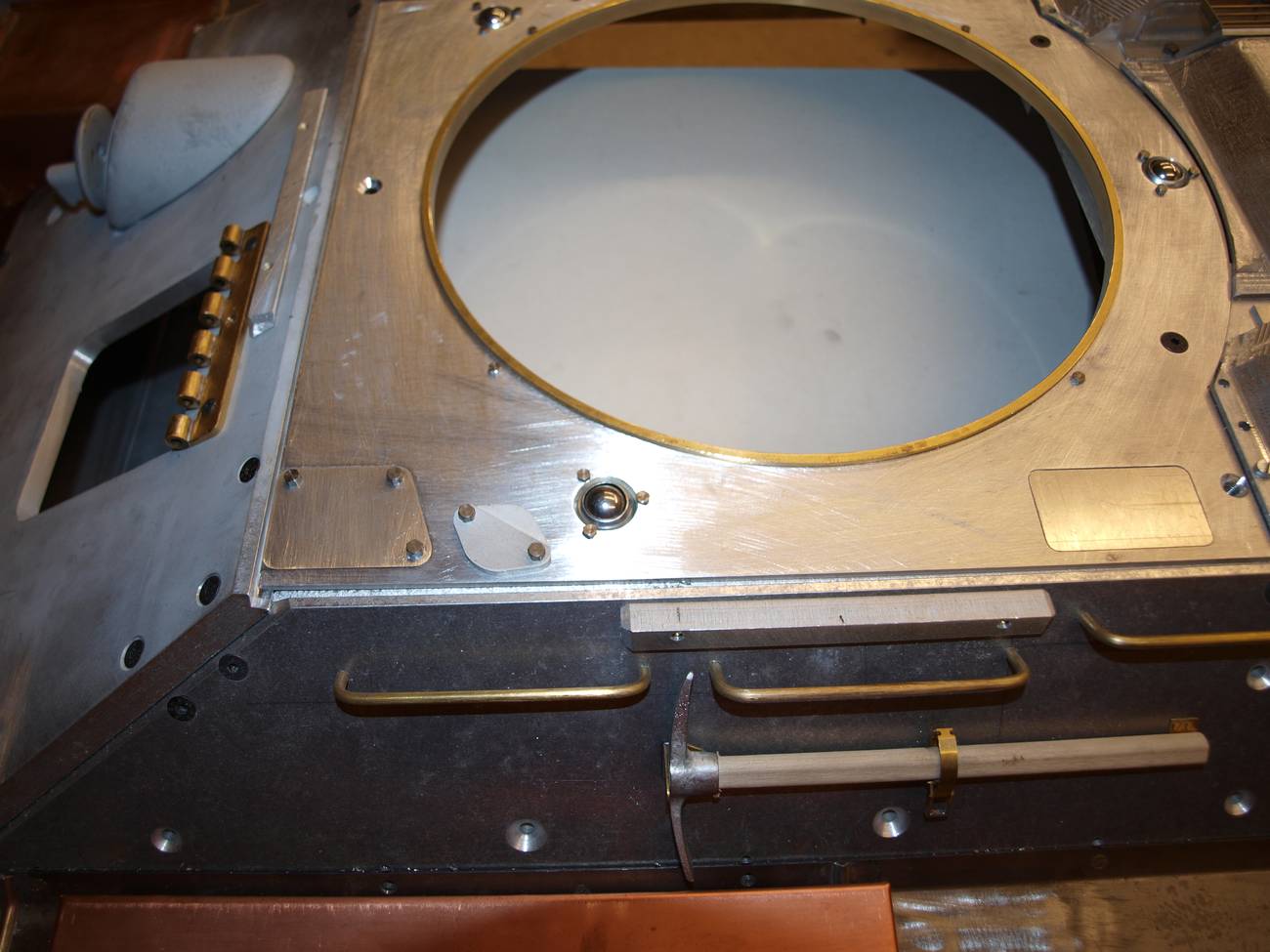

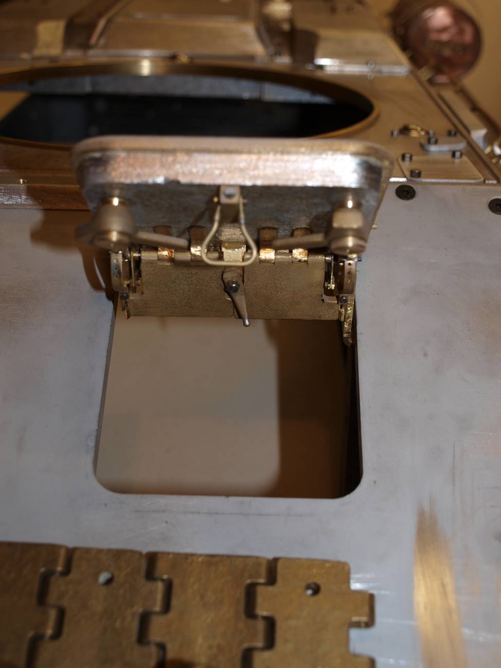

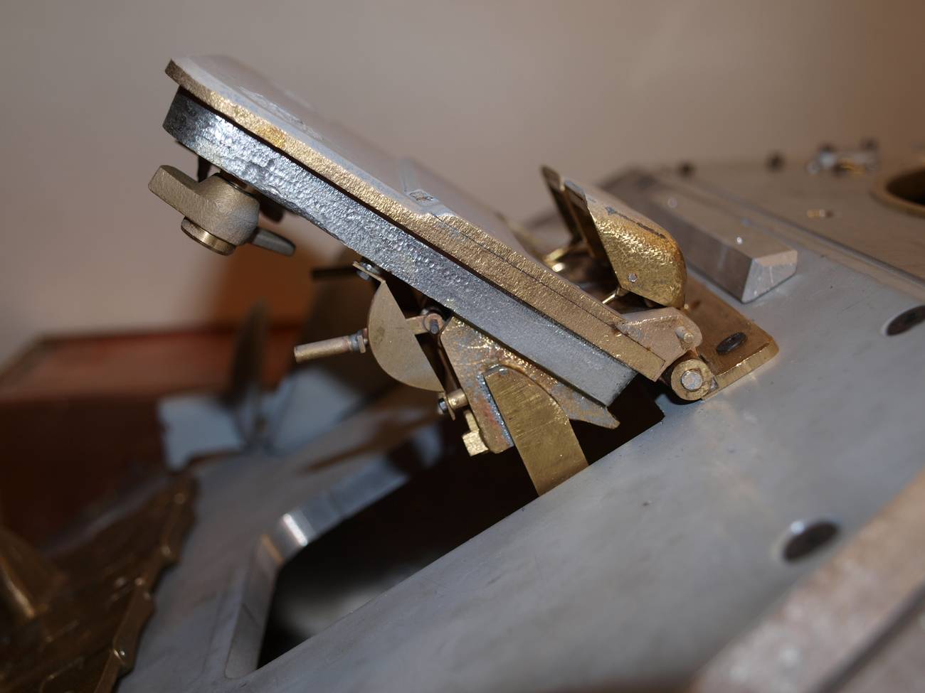

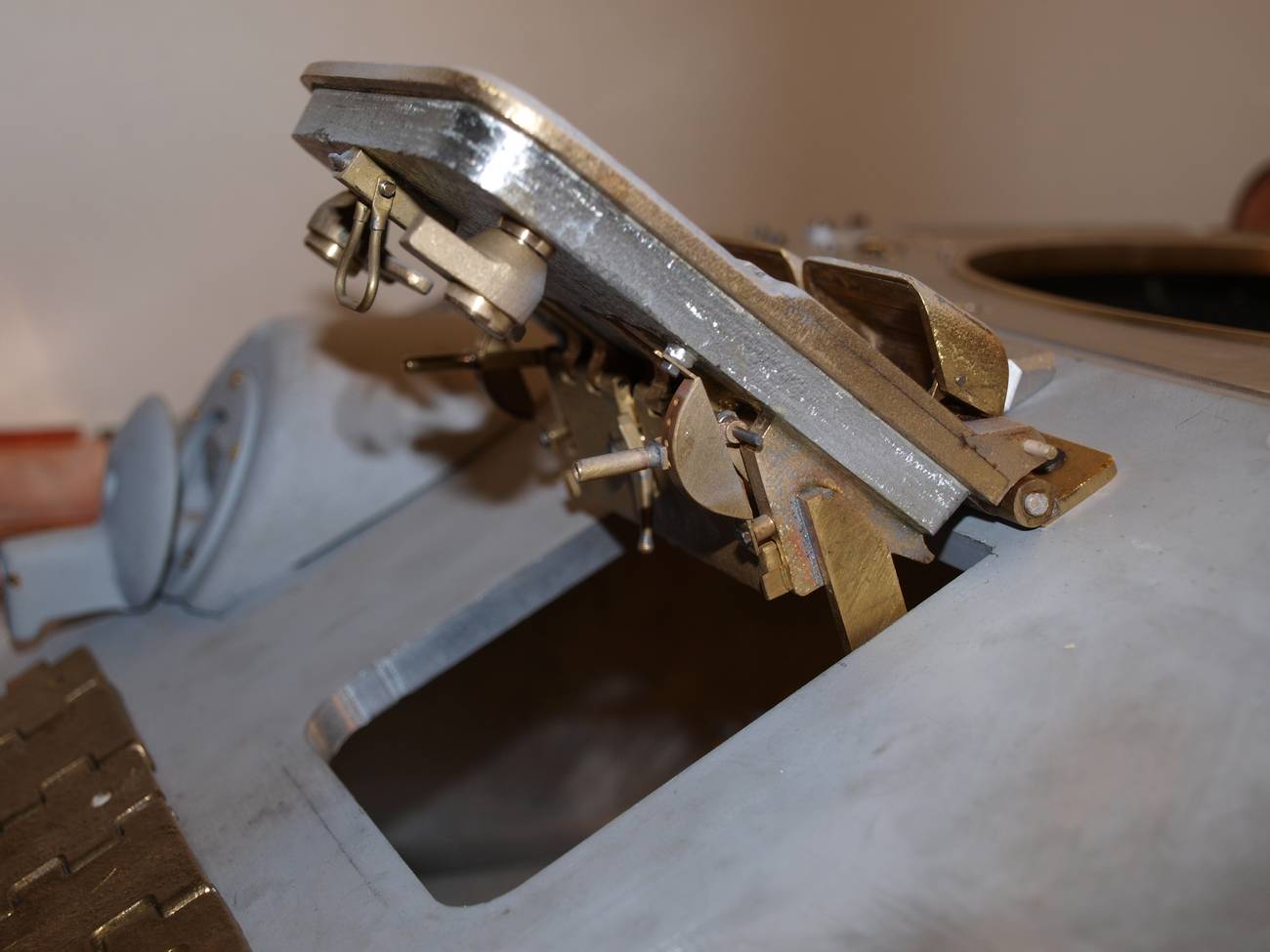

Re: T34 Idlers

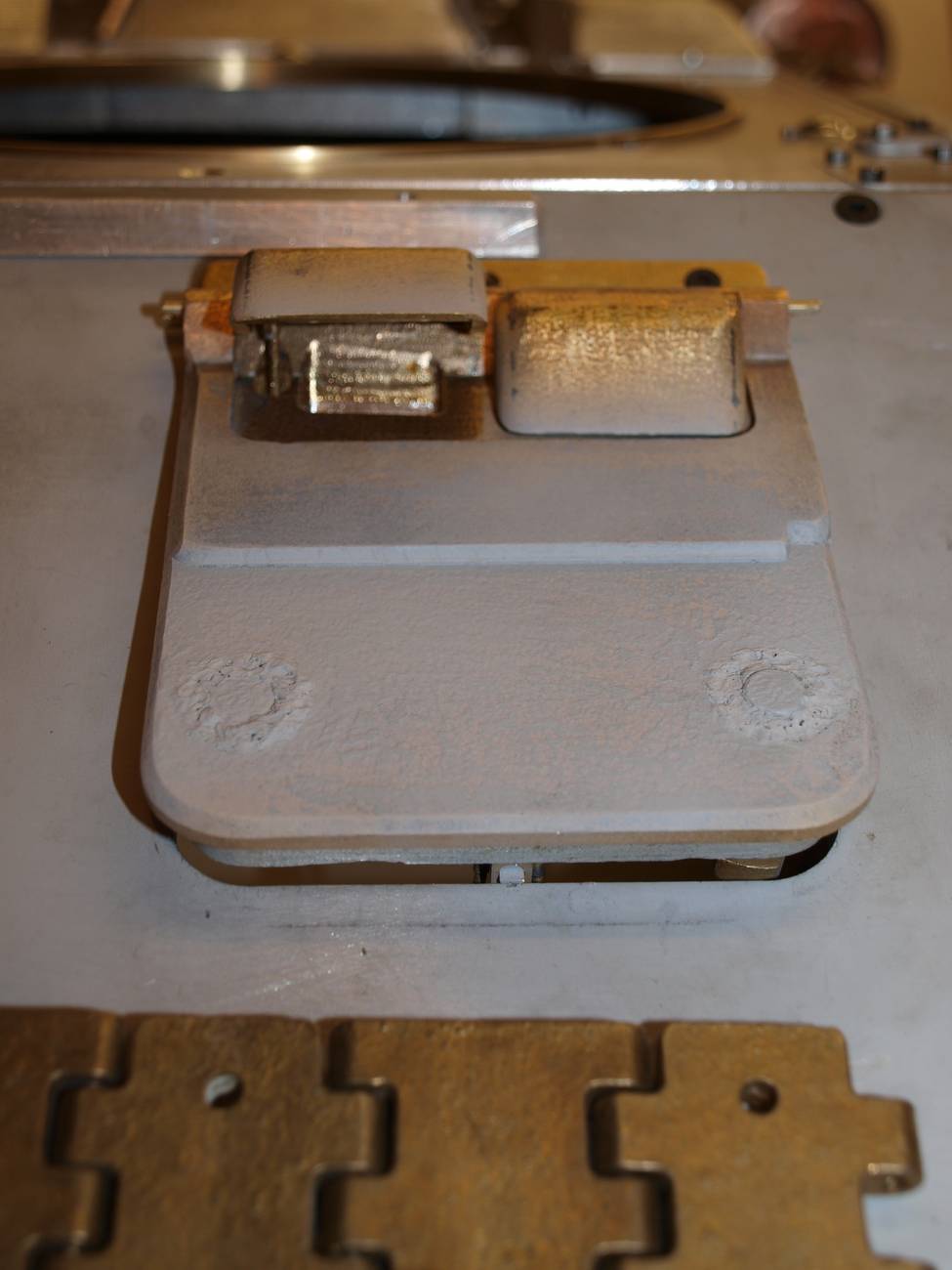

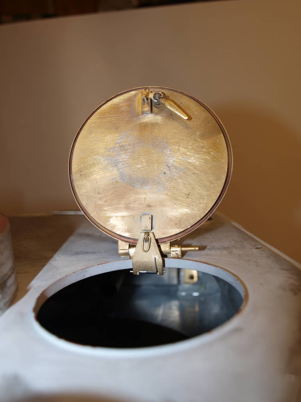

Hi all,
I have added some details to the hullroof around the turret and modified the turretbearing. Also I have finished the drivers hatch, except the prisms. The hatch is fully workable, It is possible to open the prism housings from the inside.
Bodo
