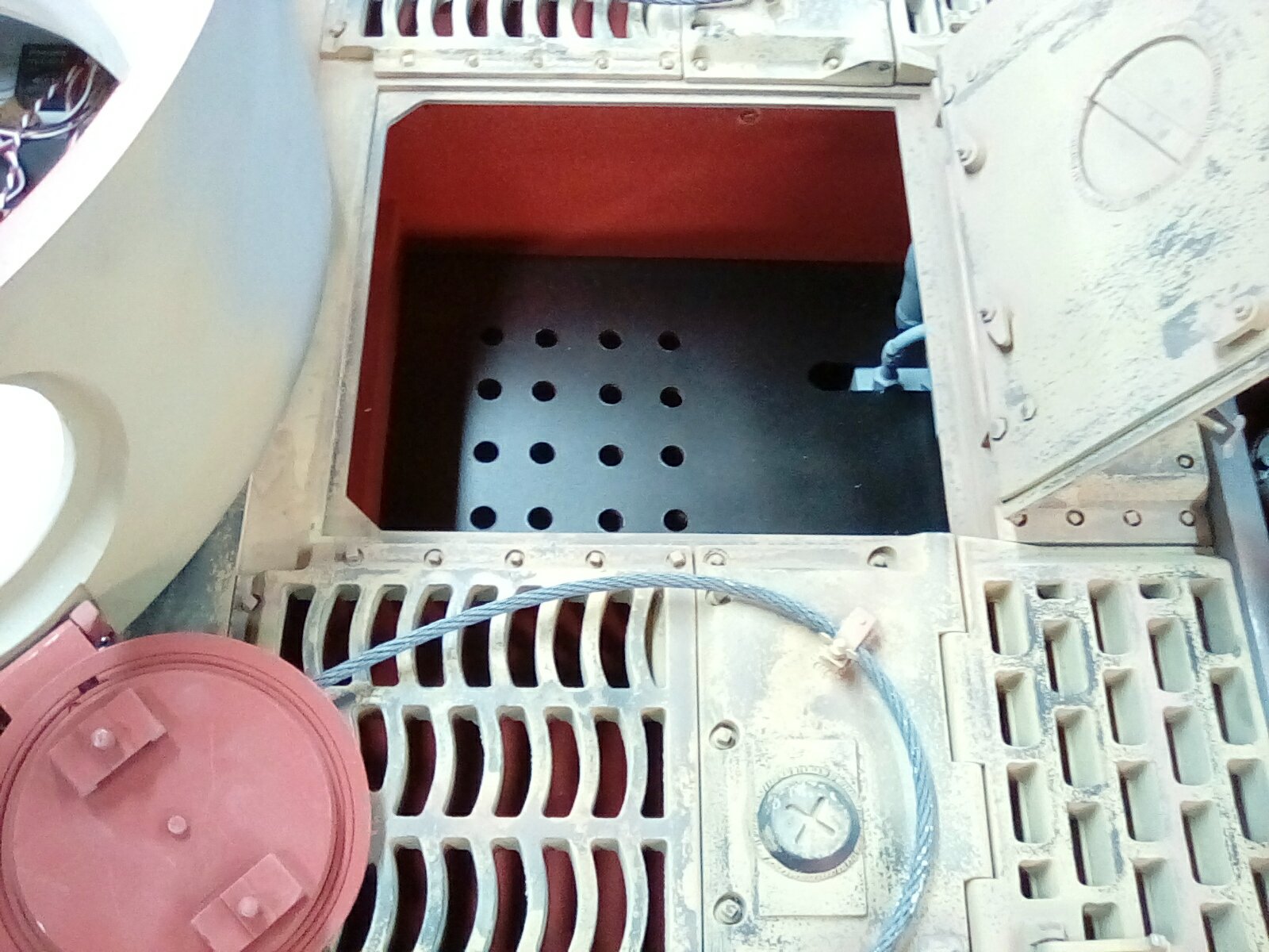

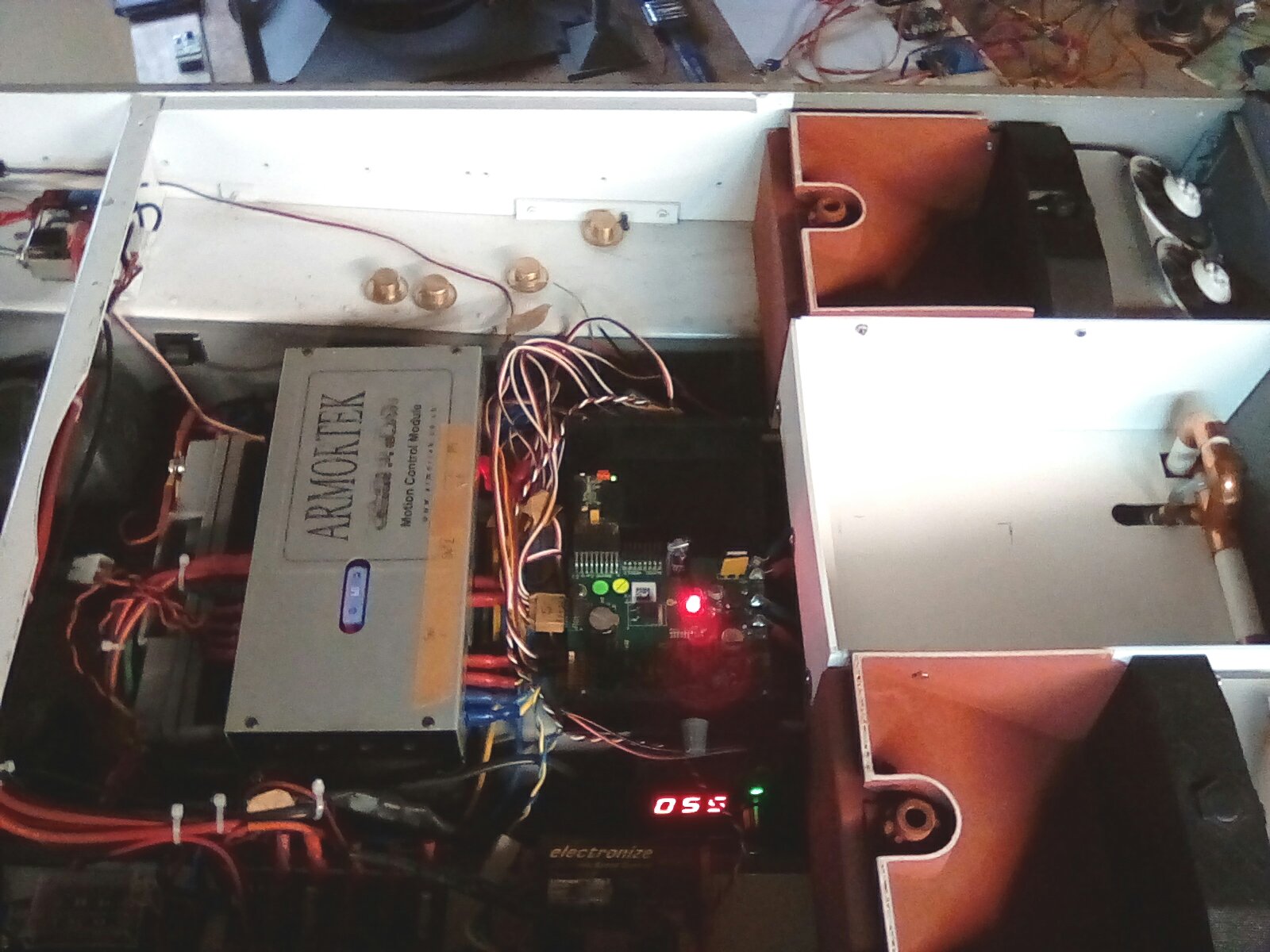

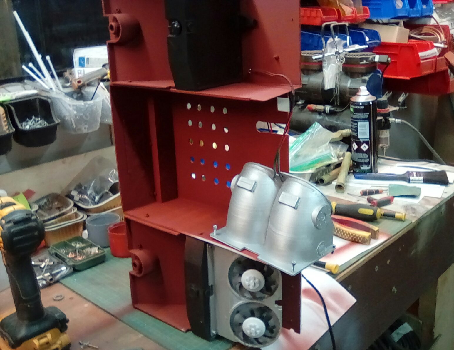

This unit just lifts out for maintenance.

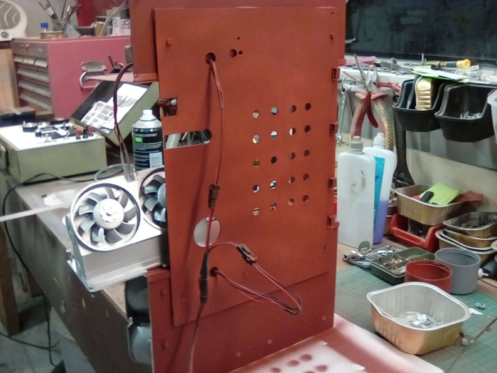

Finishing this lot, the cooling fans now work proportionately with the Maybach engine revs.

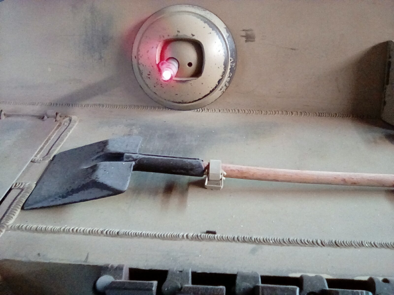

Mg led now connected to the tx mg function.
It's getting very busy in there, very complicated but I do label everything which makes life a whole lot easier .
Lots more work to get this right!

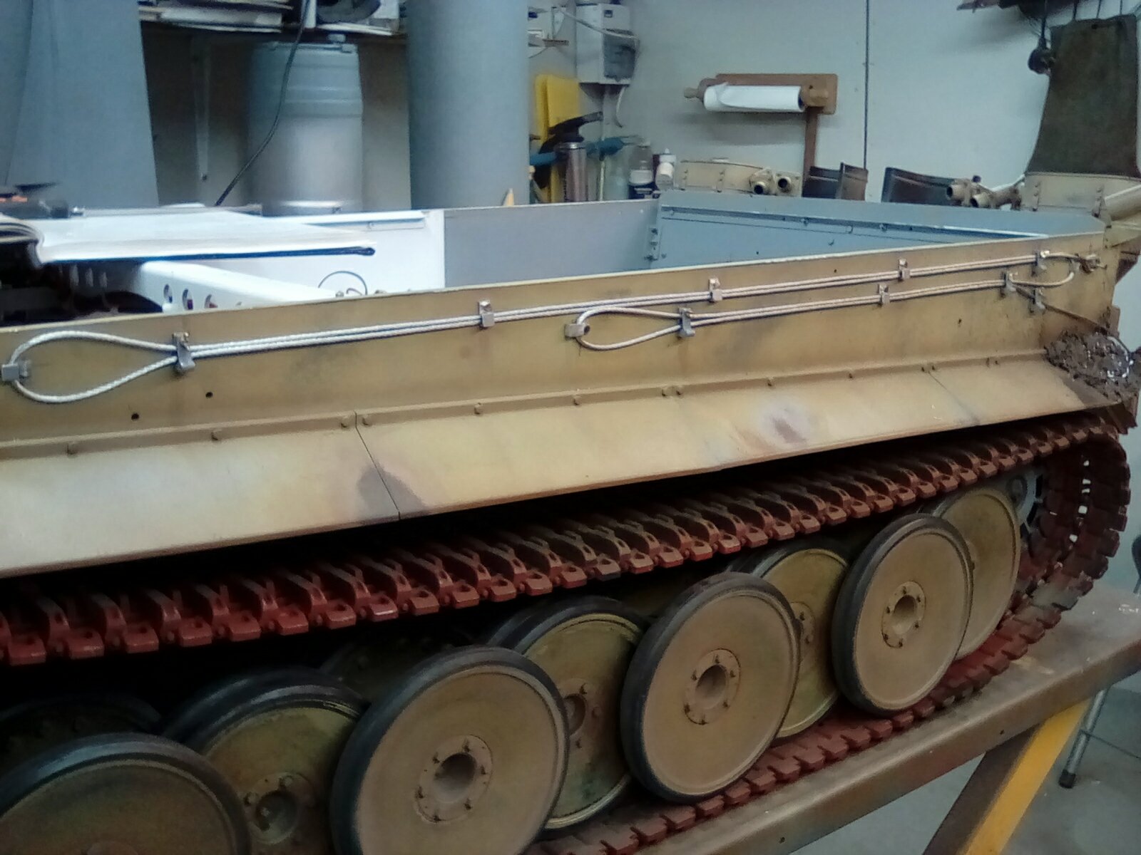

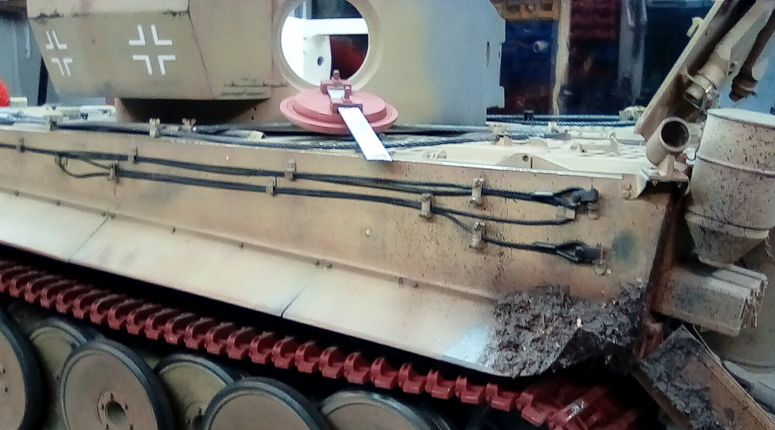

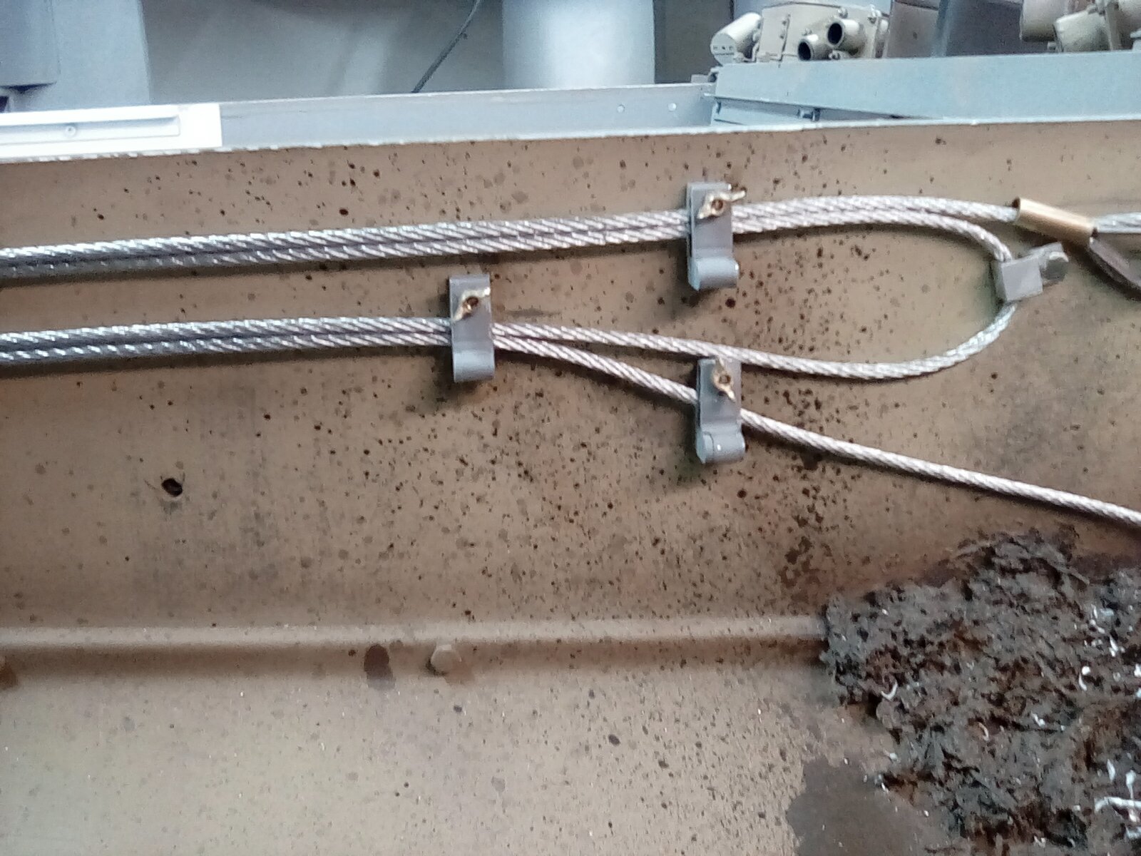

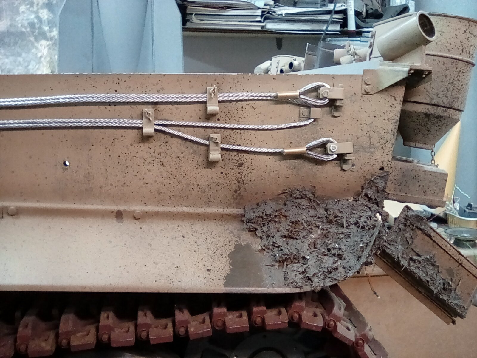

Thanks Bob, got that track pulling rope finished, two days work on that! 8)
All hand made, well mostly.

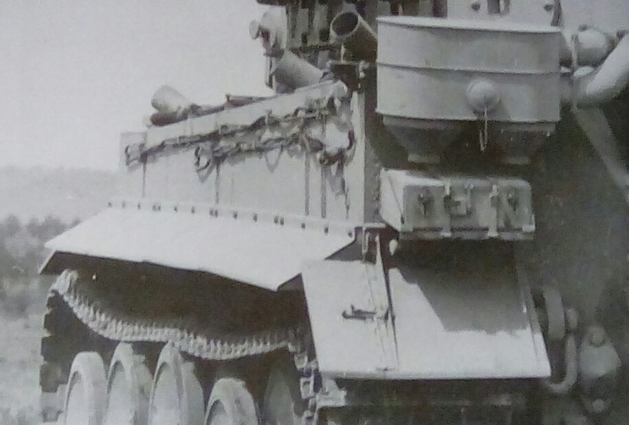

January 1943 for the rope configuration.
A tip, to get new wire rope to look used and in period burn the plastic core with a blow torch, this takes the spring out and relaxes the whole thing, careful as it actually burns.

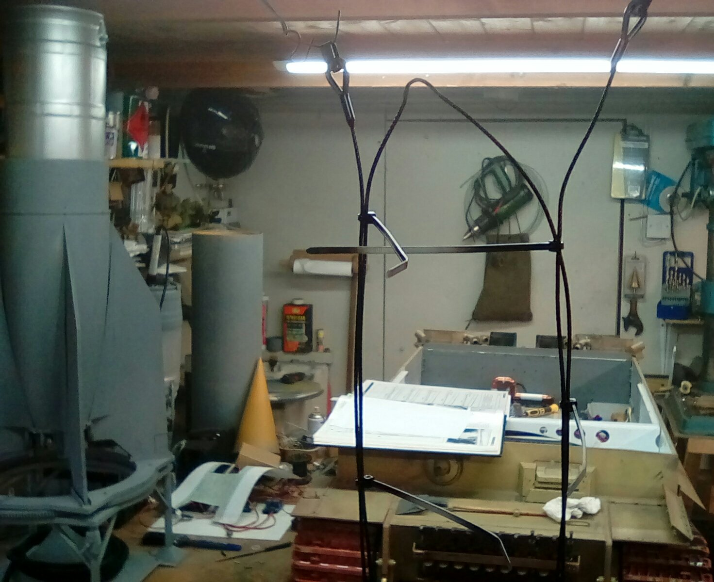

I use cable ties to hold the rope in the position while I work on it, this makes it a whole lot easier to take off and mount again.

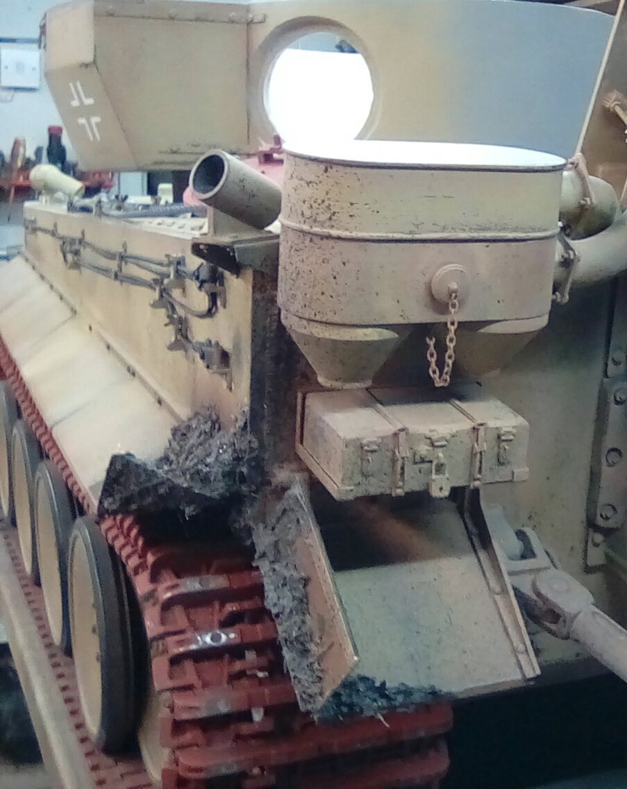

I think it looks ok.
All ready for the Maybach. The turret next.

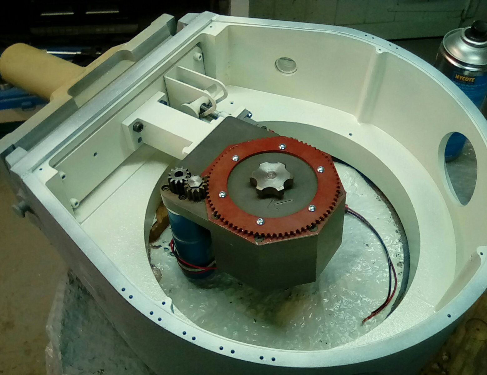

I've started on the turret. 8)
You guys with the latest kit have it easy with the new turrets, the old cast variety do take some fetling that's for sure.
That's the last of my new old stock turrets.

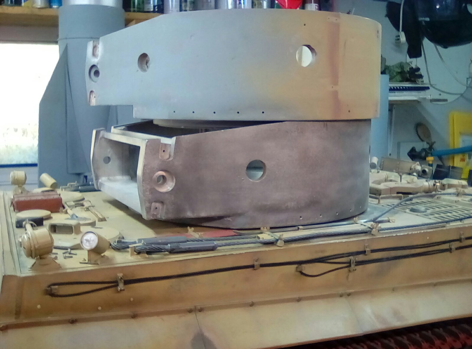

The turret on the top can go into store for when I revamp the old range target.
The vehicles starting to take shape.

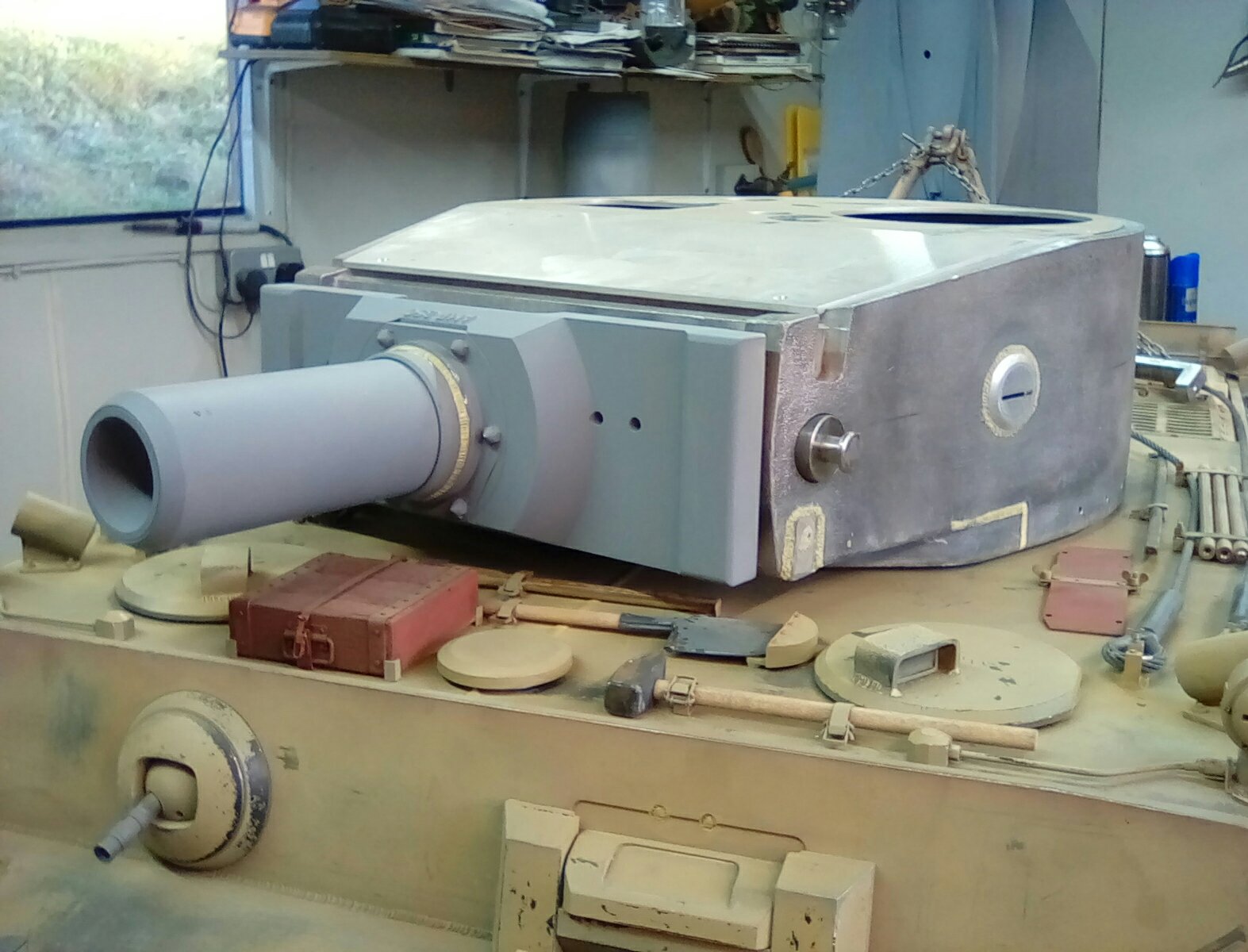

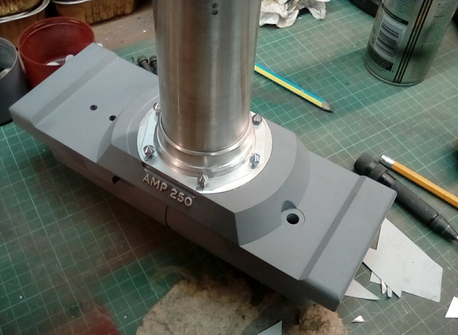

Been busy with the mantlet, recoil tube and the fixings. 8)
Very nice piece the mantlet, lovely job by Armortek. The casting numbers, some examples had just a single number like a "5" but I like the look of this type.

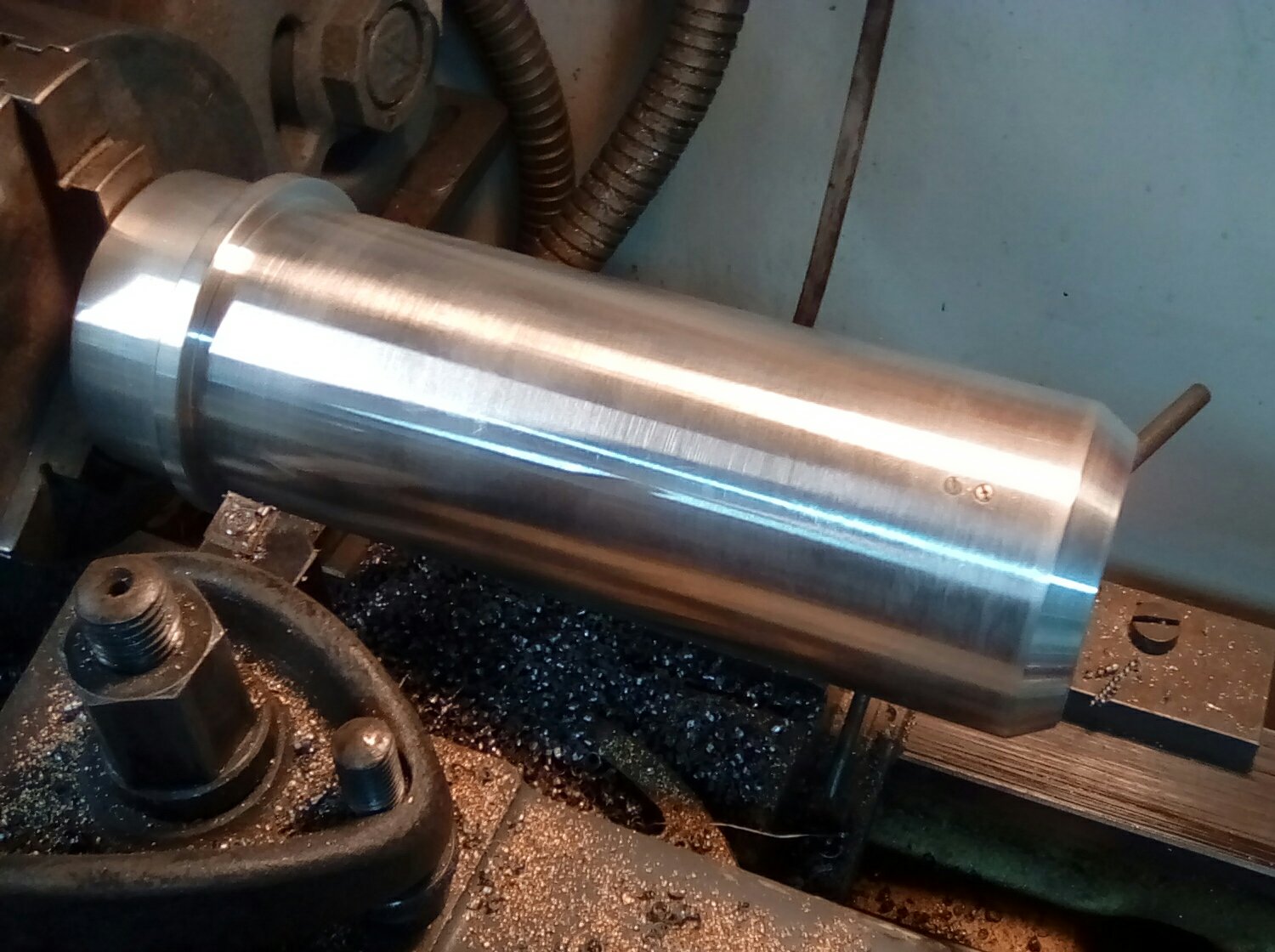

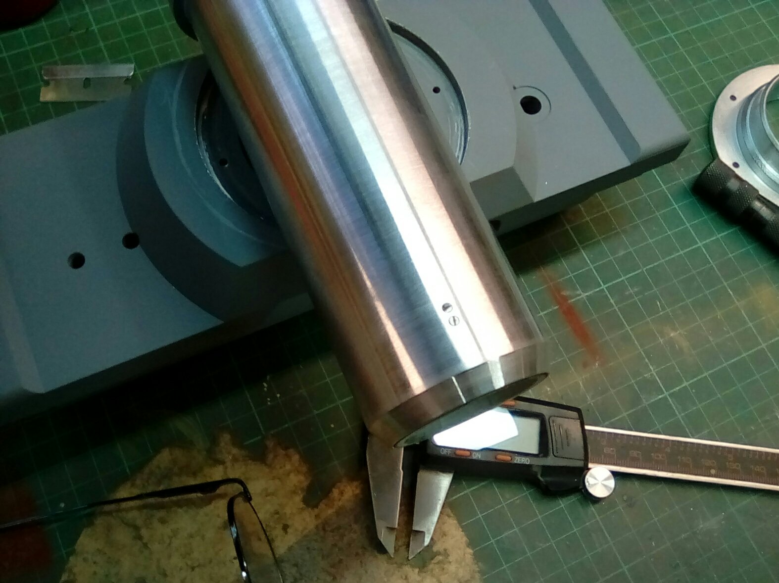

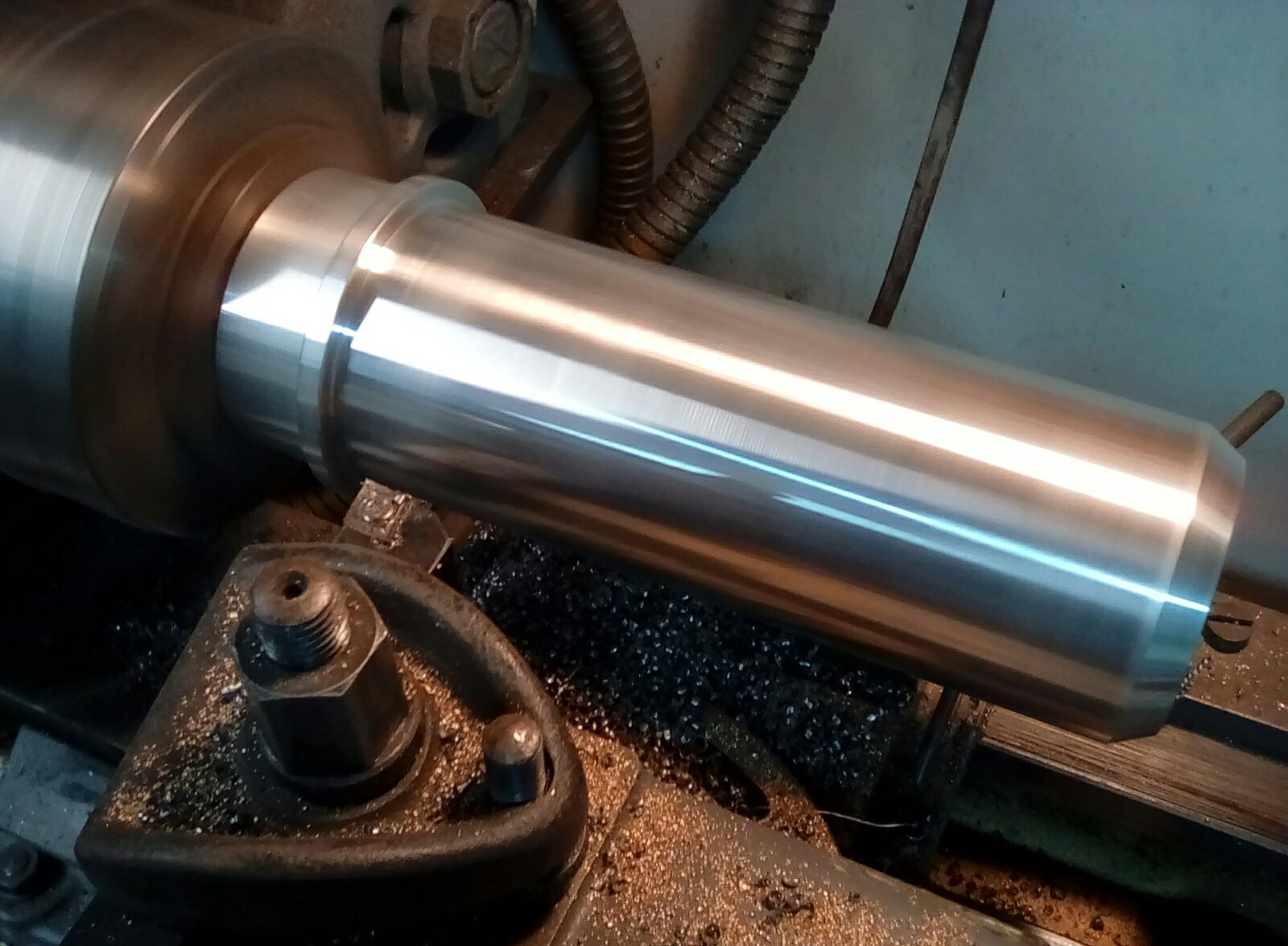

The recoil tube had a very good finish on the 1/1 example so we should have the same.
The sealing collar screws added, they are so small and very easily lost but despite being so small they really do stand out.

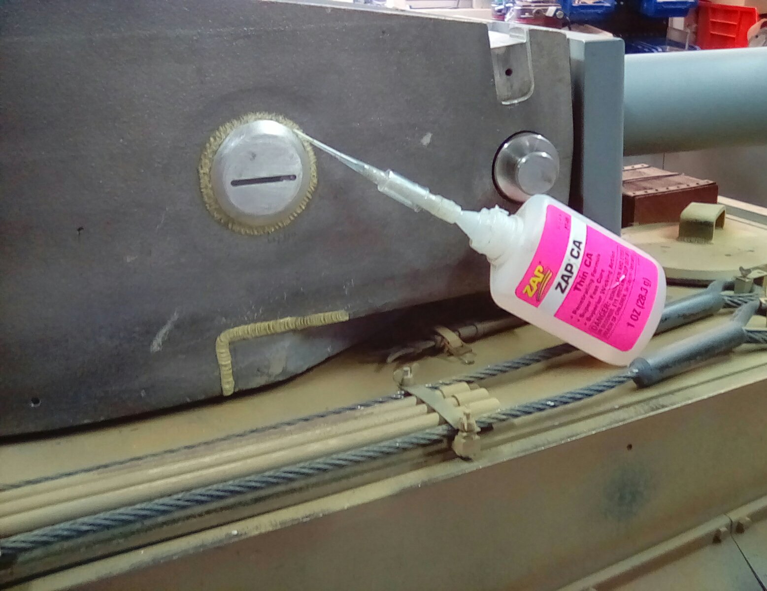

Here's a tip, use this stuff to completely secure your milliput welds. Respect this cyno as the capillary action if breathtaking, it will stick you fingers like crazy.

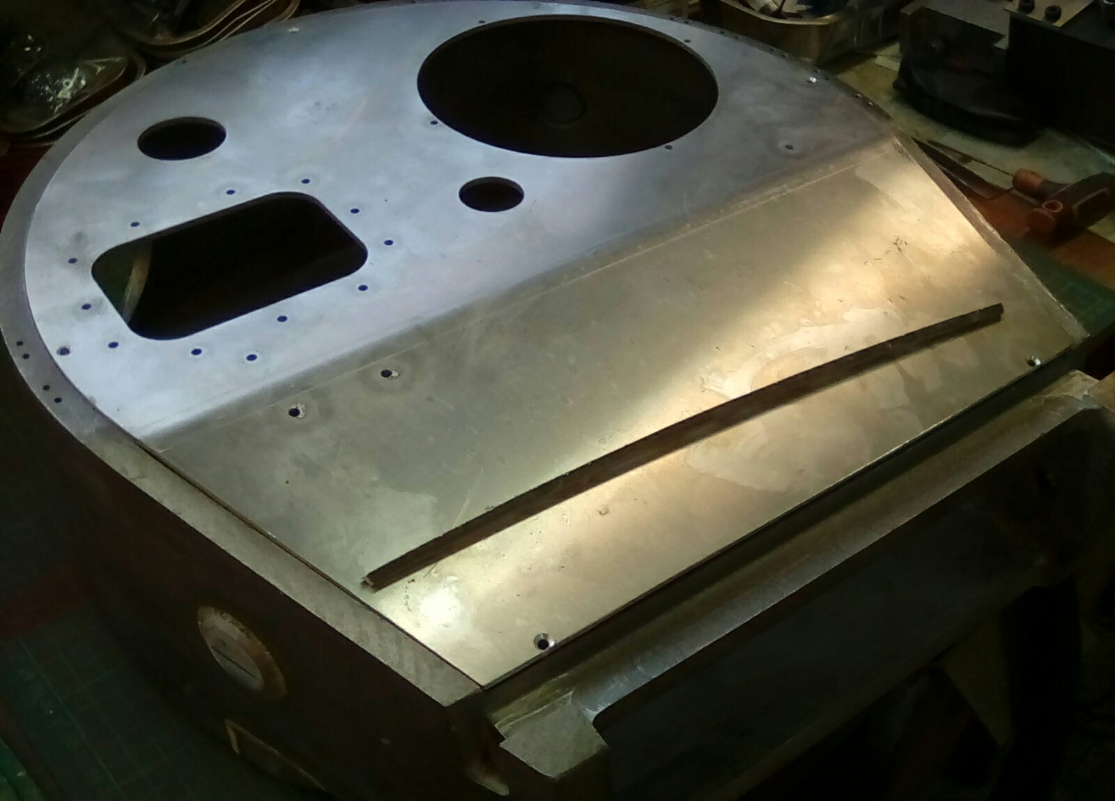

You will need to cut a strip off the turret roof front edge if your using a cast turret and a newer kit turret roof.
Draw filing, the most satisfying.

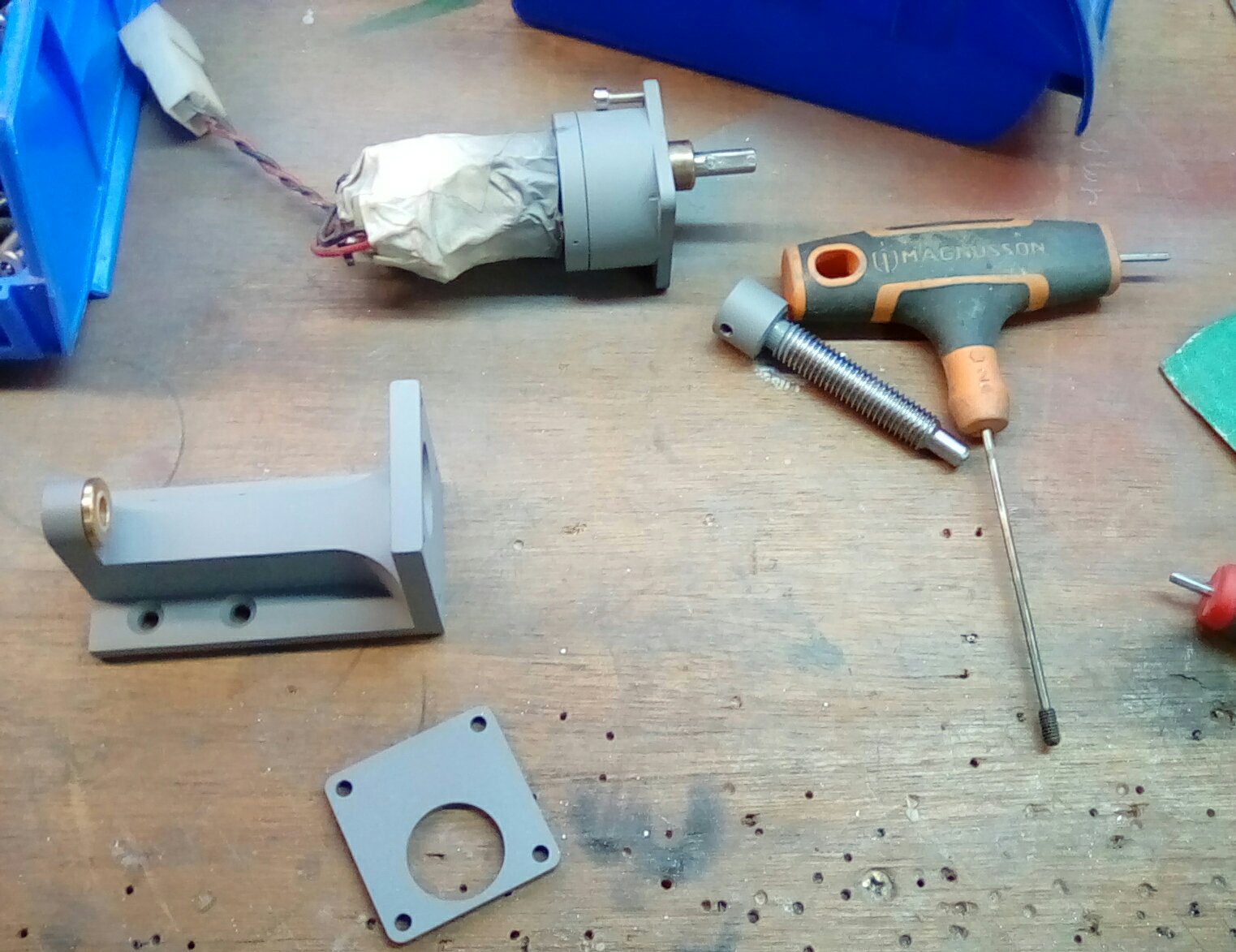

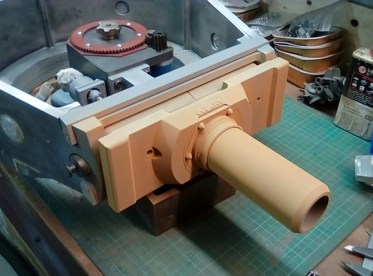

Putting the elevation mech together.
Those with a keen eye may notice the different blank firing device orientation.
That's far to clean, I'll will sort that weathering out tomorrow.

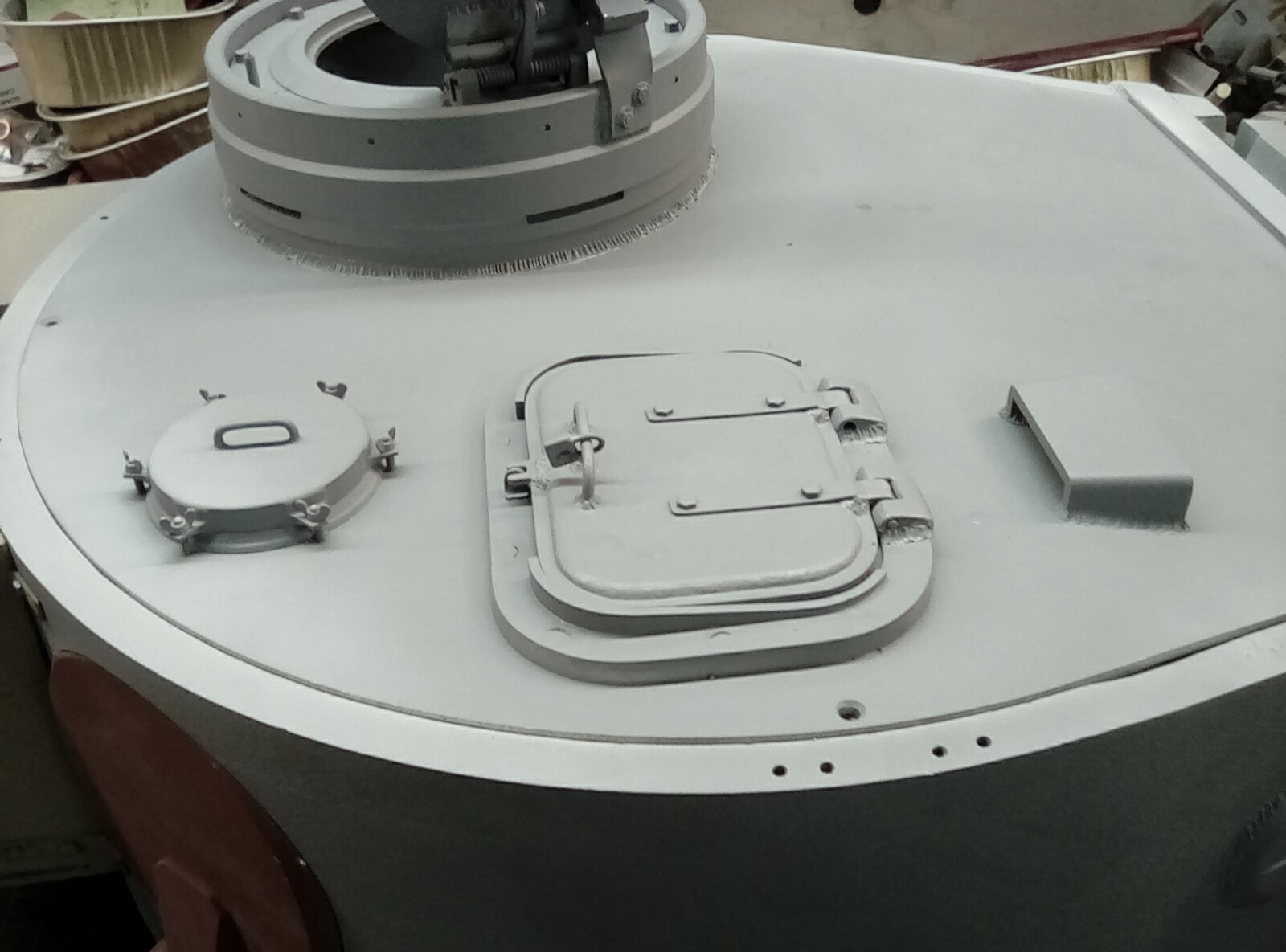

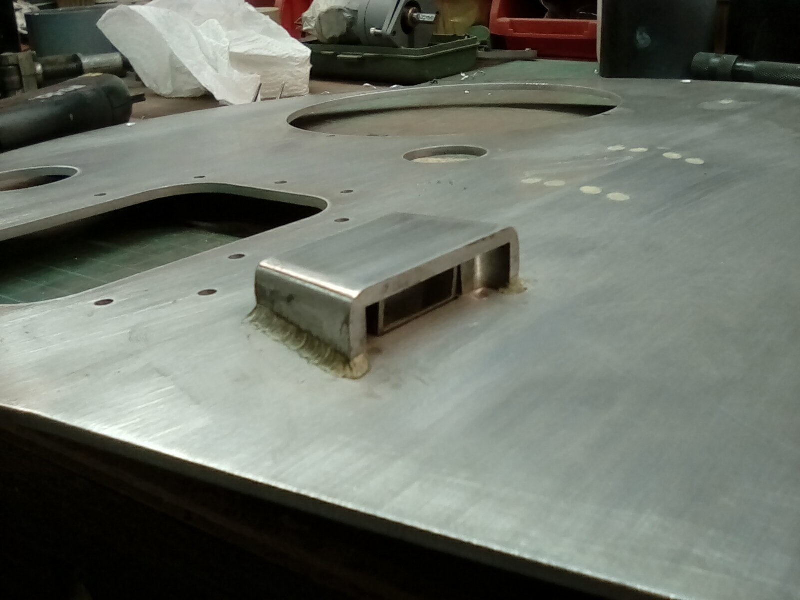

You will need to improve the profile of the loaders periscope armour from square to round.
Periscope added.
Periscope added.

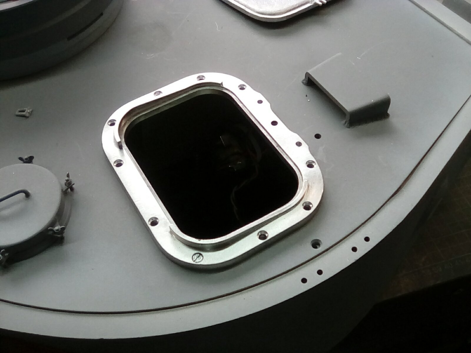

You will need to cut out the aperture for the periscope in the turret roof, if you want to fit one that is.

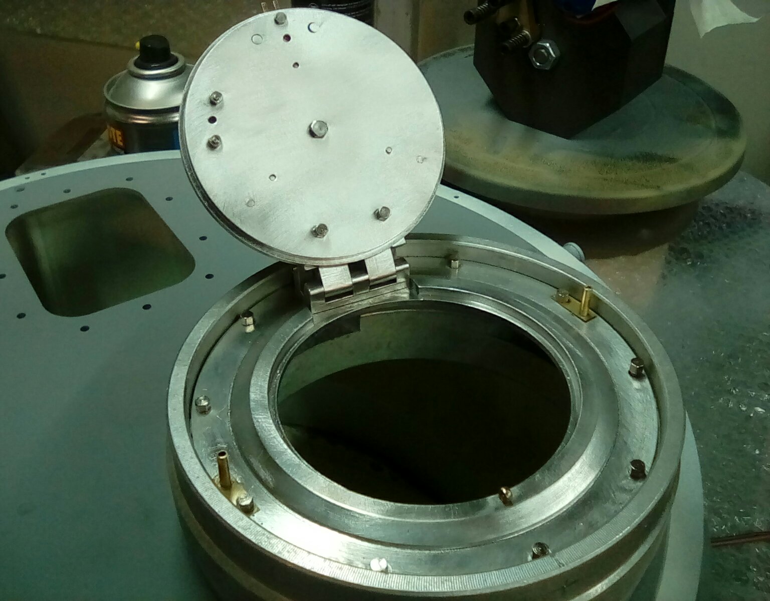

Lots done today 8) I may fit the weld detail tomorrow but really I should have a day away from the workshop.

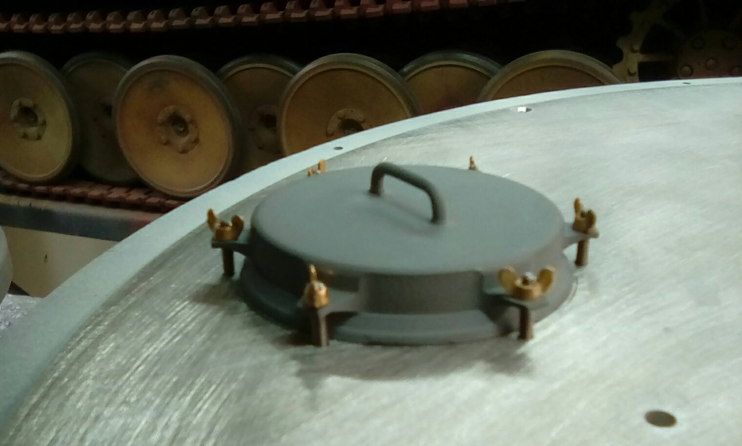

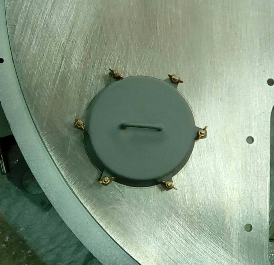

Detailing the turret vent, as it has the cover you really need to add the wing nut detail.
The cover that we can see here was removed for firing for obvious reasons.
Good reference pic this one.

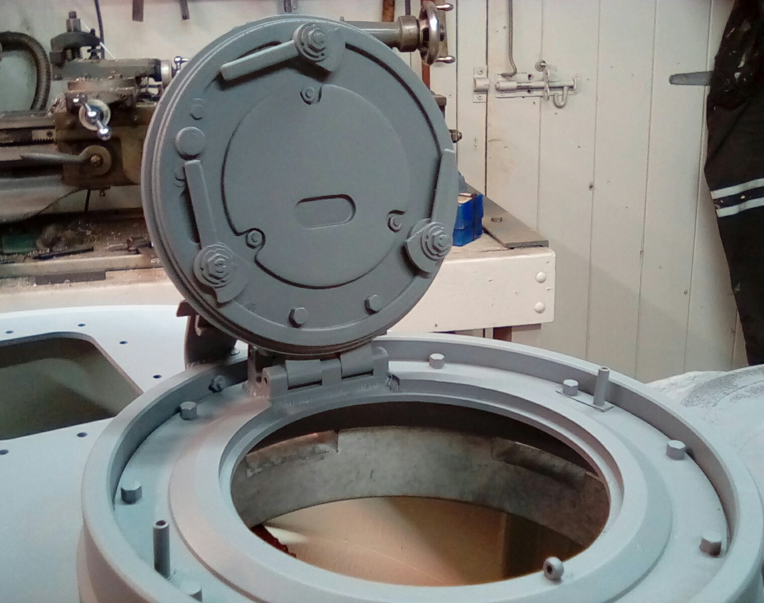

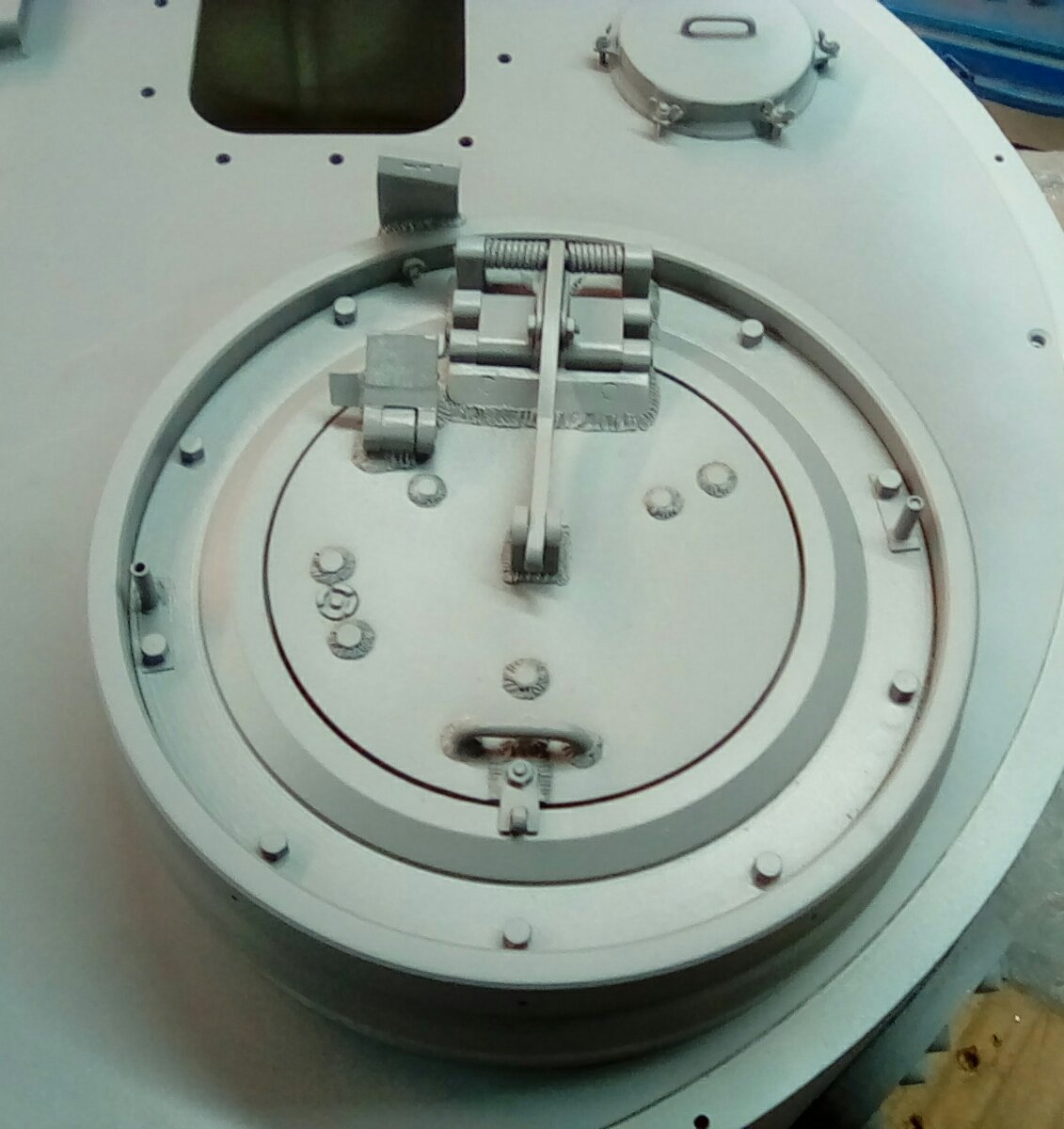

Making the hatch assister springs .
There's much more to add.

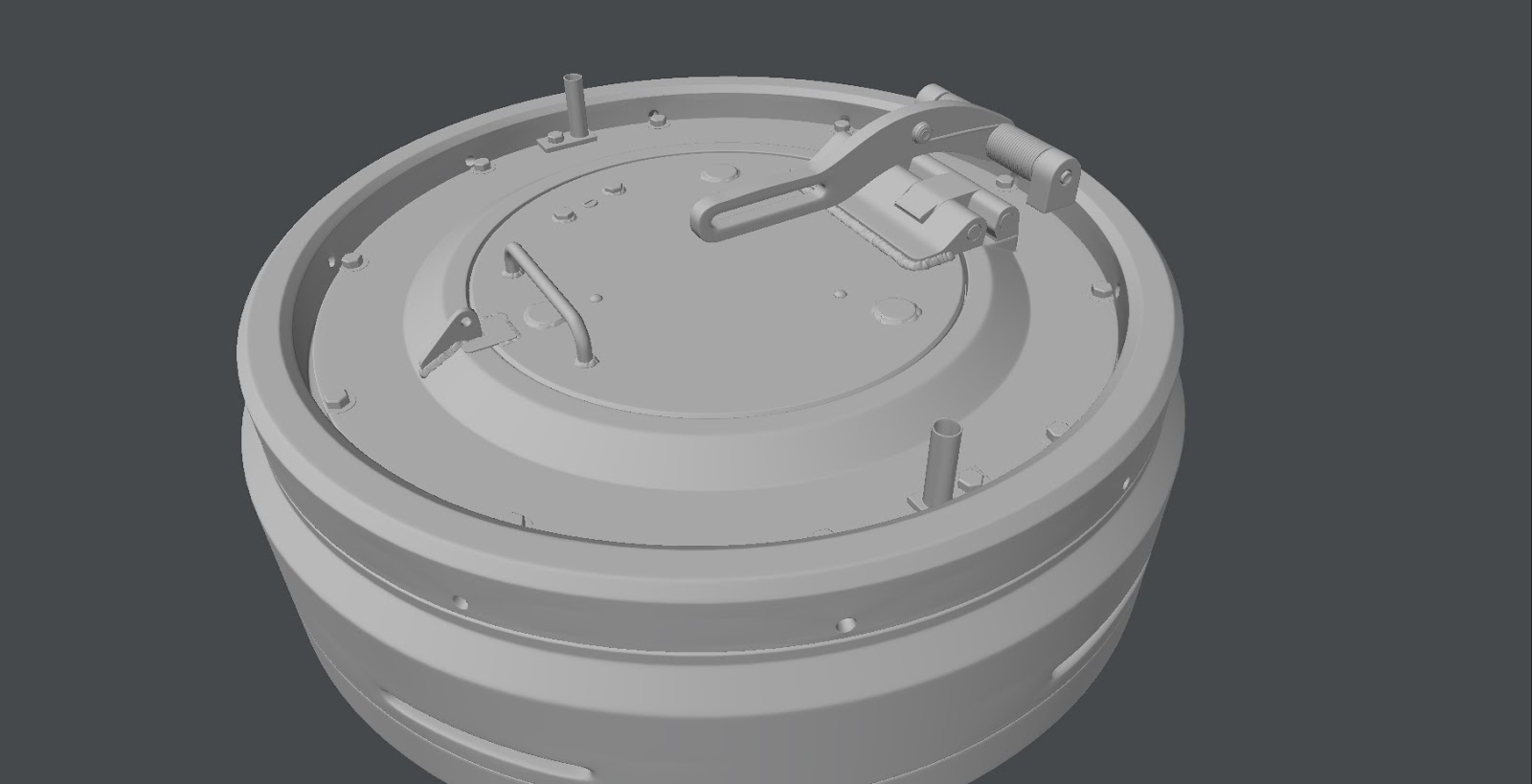

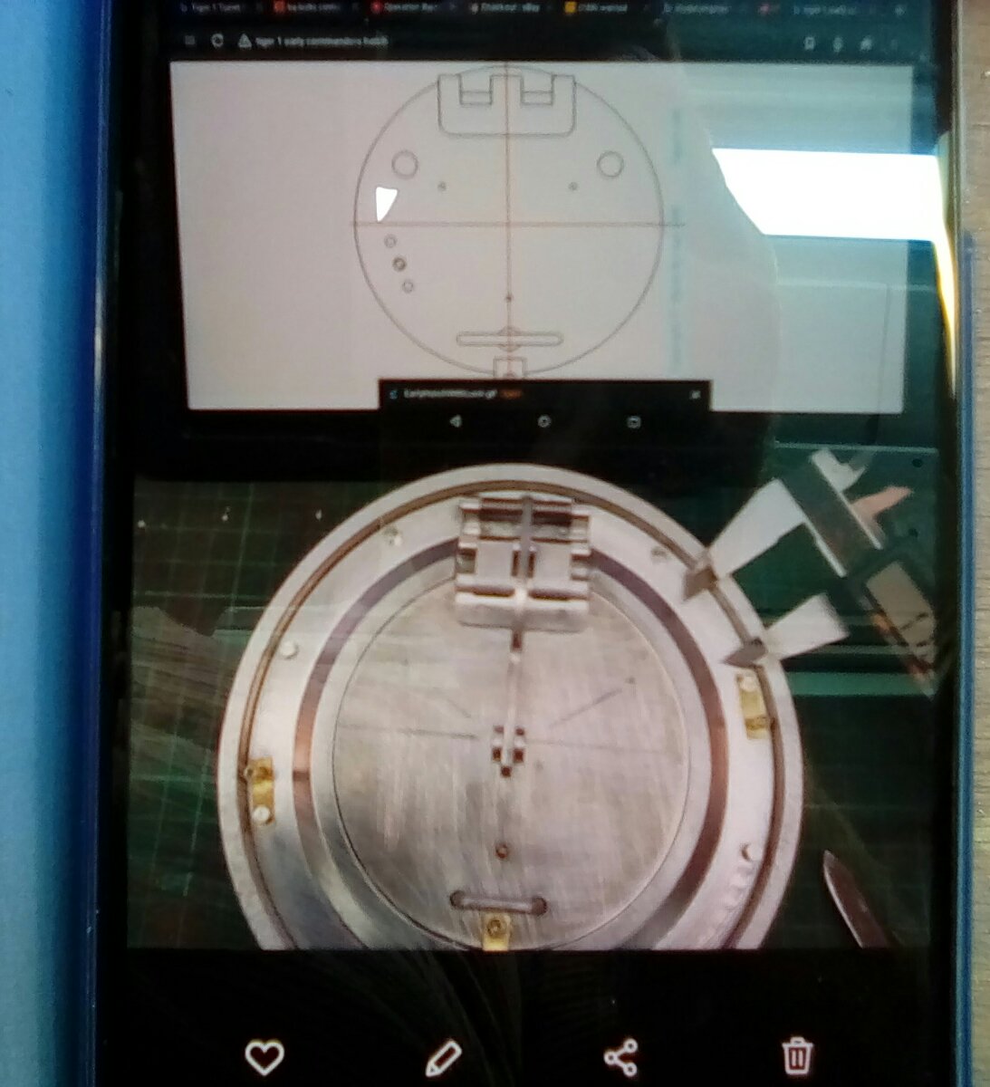

Using my pad to scale the exact position of the fittings.

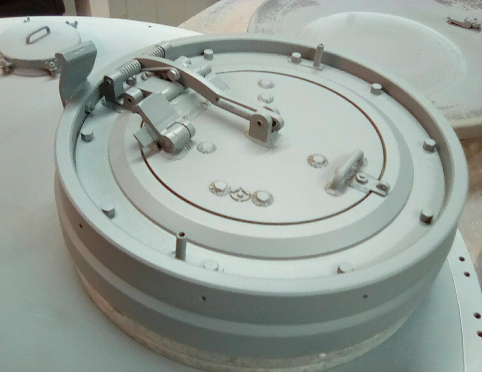

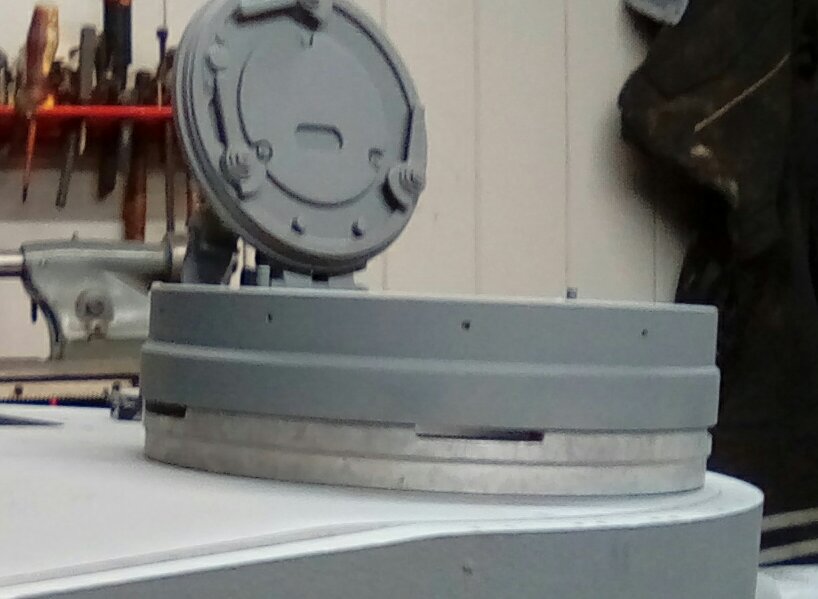

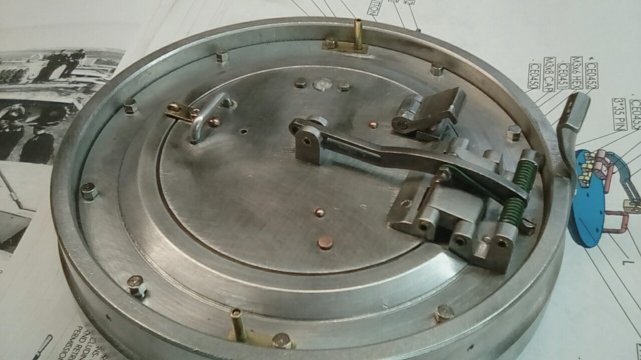

Just about done but for the tiny holes on the vertical face equally spaced all the way round, don't know what they are for?
Now the outside fittings correspond to the internal fittings, which is handy.
The monster fitted and ready.
Christoffer Ahlfors
Posts: 702
Location: Stockholm, Sweden
Has liked: 745 times
Been liked: 359 times
Re: Early or mid ? Tiger 1 build by Phil Woollard
Post by Christoffer Ahlfors »
"Just about done but for the tiny holes on the vertical face equally spaced all the way round, don't know what they are for?"
They are drainage holes. Without them, the cupola would hold quite a bit of water, covering the hatch, providing a very unpleasant surprise when opening...

I must not forget the little commanders aiming point, that's the small piece of rod welded across the forward viewing slit.

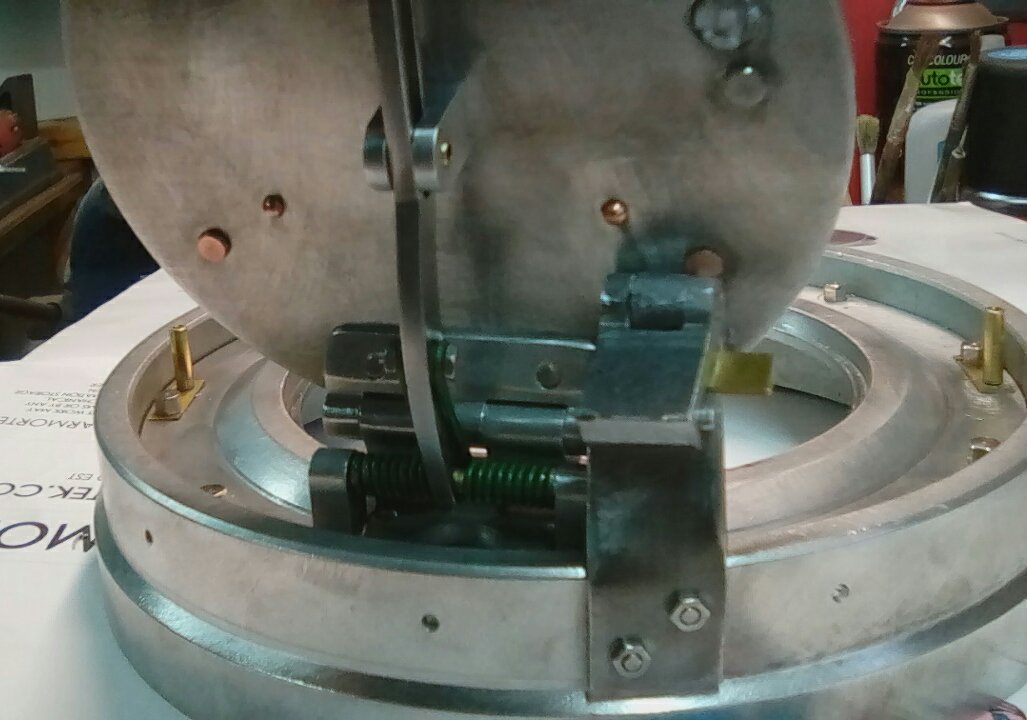

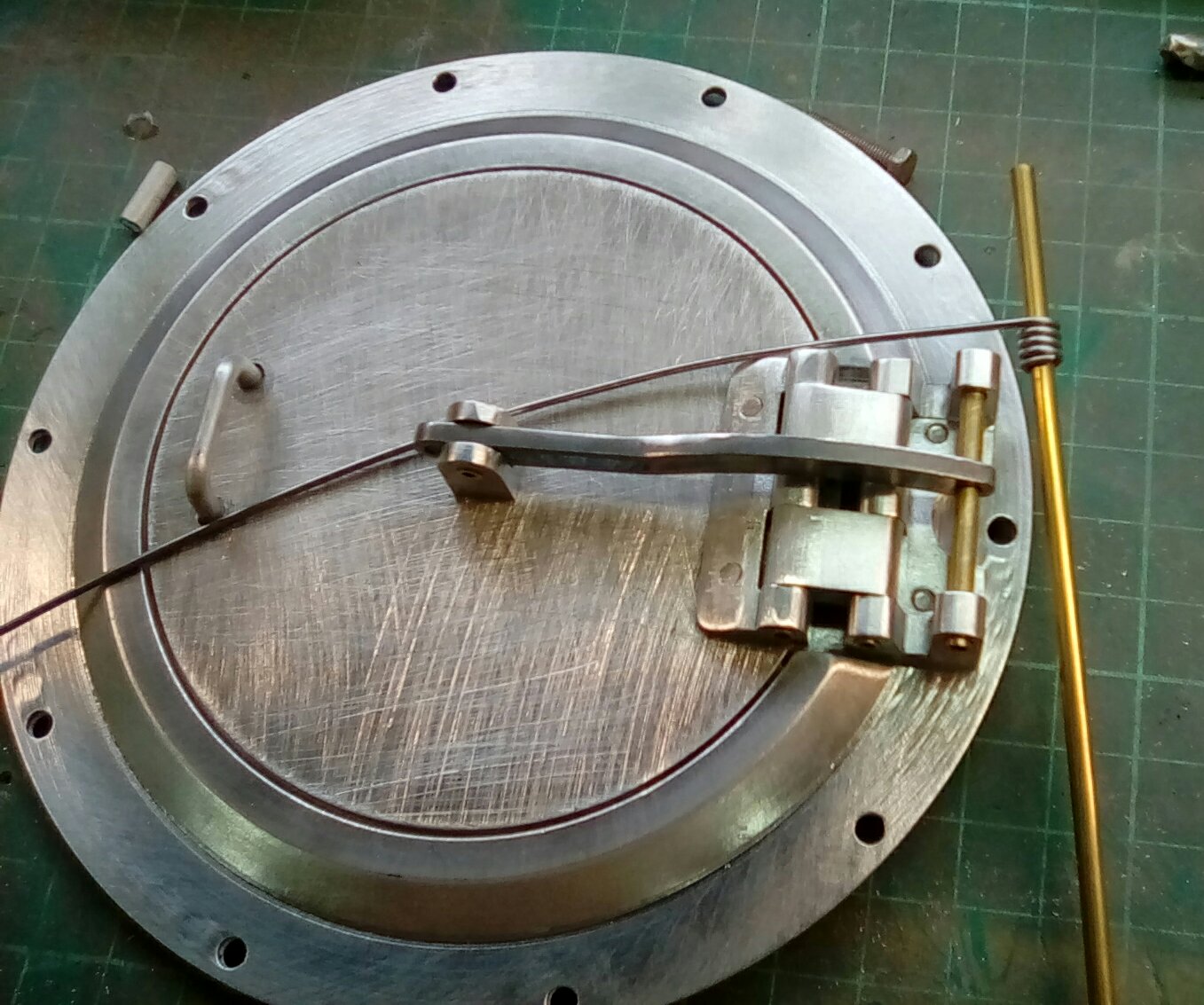

Decided to make some working assister springs.

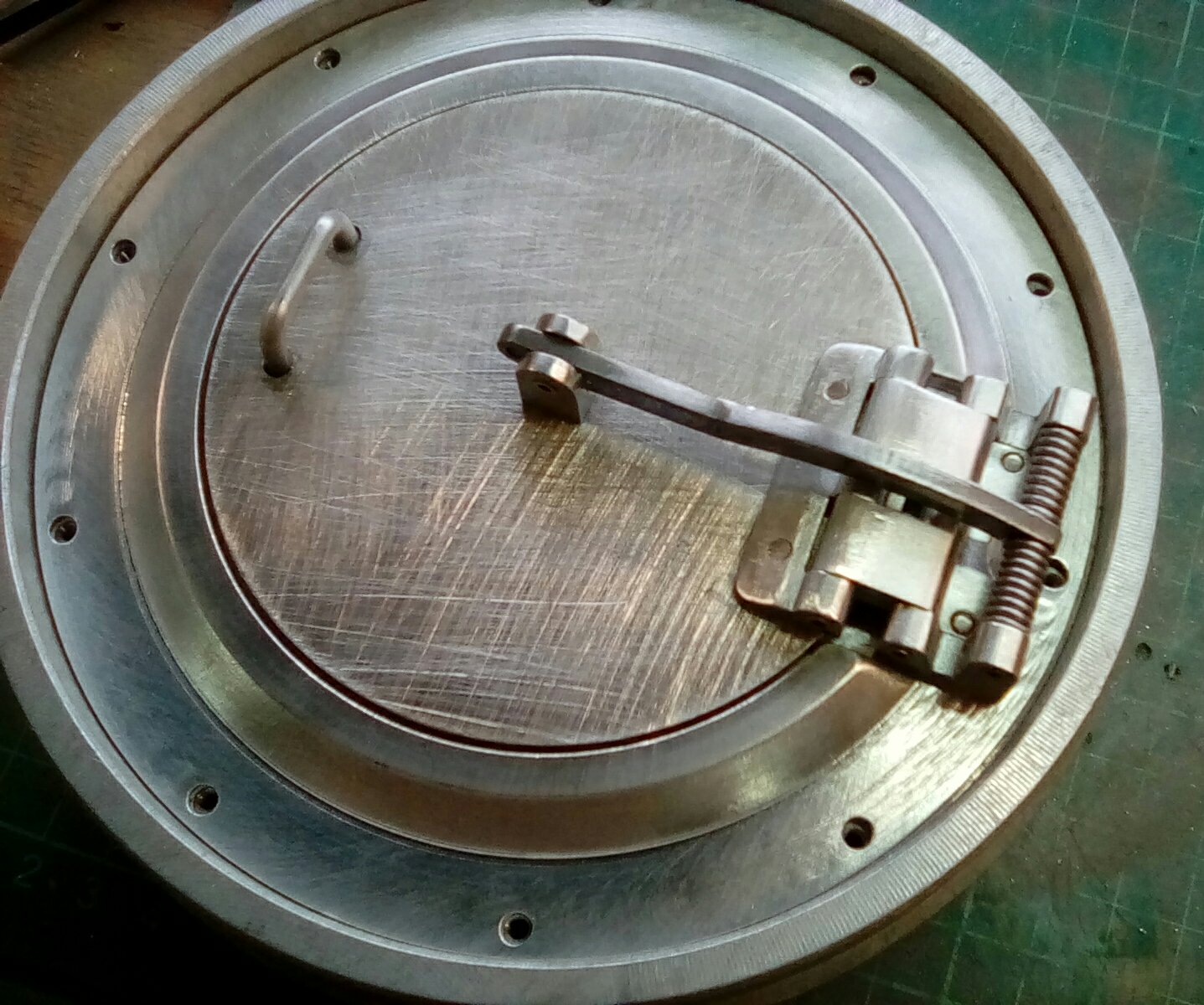

There's a tremendous amount of work involved to fully detail the cupola! Thank you Vince for your input.
The hatch hold back latch is fully functional.

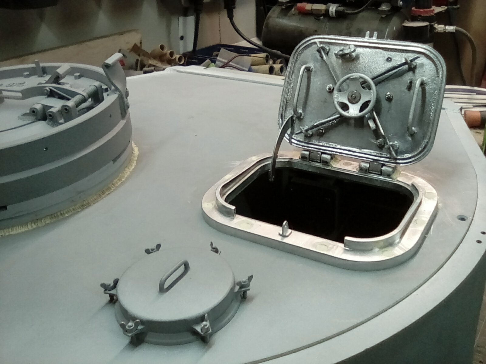

The loaders hatch. 8)
I have a few loaders hatches in stock to chose from.
The bible.
The bible.

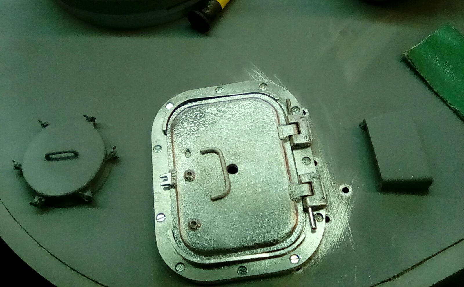

Don't want these hinge pin mounts.
Making it fit.
Making it fit.
I have to move The handle to the center for 1943, and lose the opening key hole in the middle.
Internal detail went well.

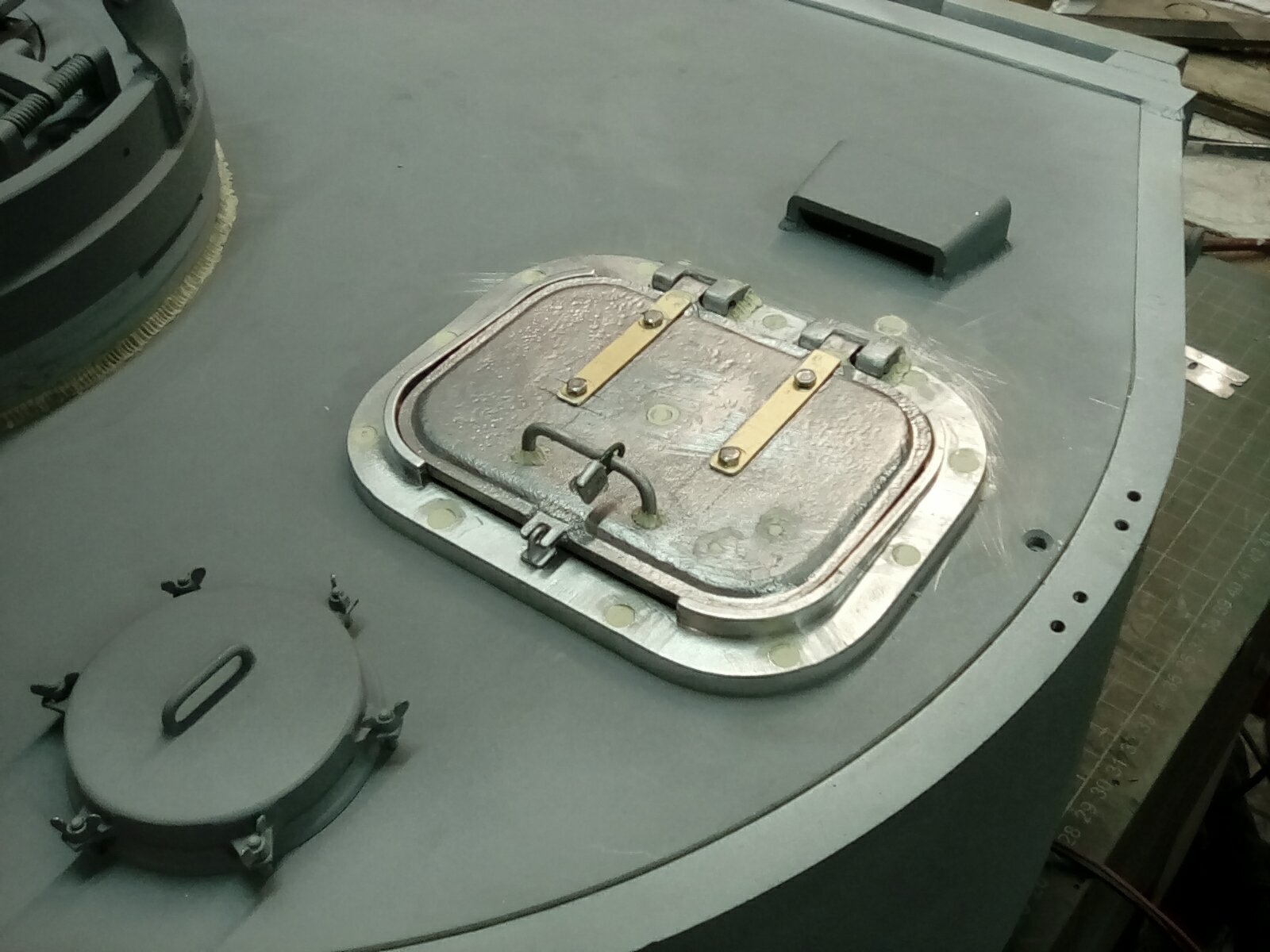

The hinge strap detail added in brass.

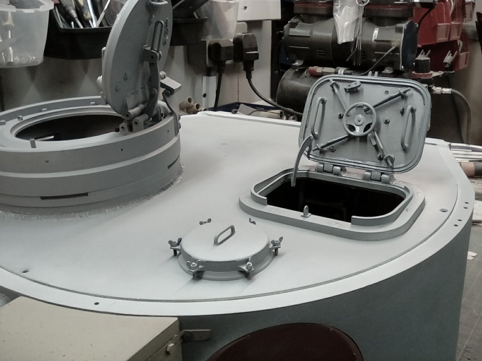

All done, welds added and primed.
Maybe just little bit more welding needed.
