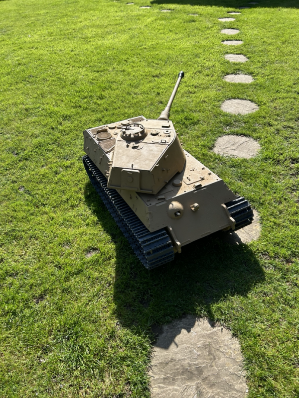

Nearly 5 years after its manufacture and 15 months into its build KT29 has finally moved by its own steam!
Whilst clearly some work still to be done I am delighted to finally see it move.
However its maiden voyage lasted less than 5 metres before the left hand track jumped off the sprocket
It was not entirely surprising as the tracks appear to be so slack and I have been unable to tighten them up any further.
I have checked that the idler wheel, road wheels and sprockets line up, I cannot lengthen the torsion bolts any further as they are at the end of their travel (the longer bolts are fitted) and I cannot take out a track set. I’ve looked at fitting still longer bolts but any further travel would force the tracks up into hull surface.
The wheels are presently set at 30 degrees - could/should I increase this to say 35 degrees?
When set on the ground the top tracks just sit on the wheels.
Can anyone point me in the right direction as I don’t think the search function is yet working on the new server.
I’d also like to find a picture showing just how much I need to file off the sprocket teeth - I think mine are ok but I’d just like to double check if anyone can help.

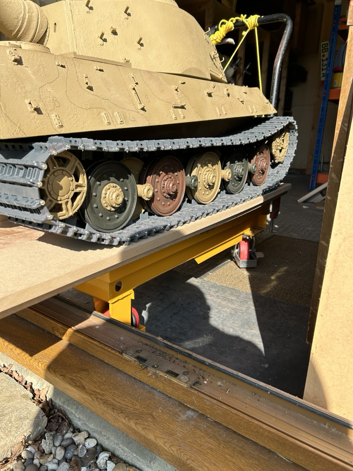

I own a nicely running 2009 KT ( Turret Number 008) and have also been helping another chap in Swindon with his which exhibited the same issue with getting the correct track tension. We eventually went down the route of obtaining a pair of Liam Mahoneys revised idler cranks to increase the range of track tension. Paul Sparks (UK) may have a set left if you want to go down that route. If however you want to strip the tank down then the issue we had was that the track bottomed out on the underside of the sponsons which prevented me from getting the full tension I needed. So the first thing I would do is strip the tank down to just the lower hull, removing turret, upper hull plate and sponsons. This will reduce the weight and also give you the bonus of being able to get the maximum adjustment on the idler cranks.
Run the tank like this and see if it will work without throwing a track. If it works "run" the track and running gear in using this configuration. The track will "stretch" so it may be necessary to remove a link at some point. If this doesn't work then you will have to adjust the torsion bars by increasing the angle as you mention. If you need moral support then bring it along to the Open Day and we will try and help out.

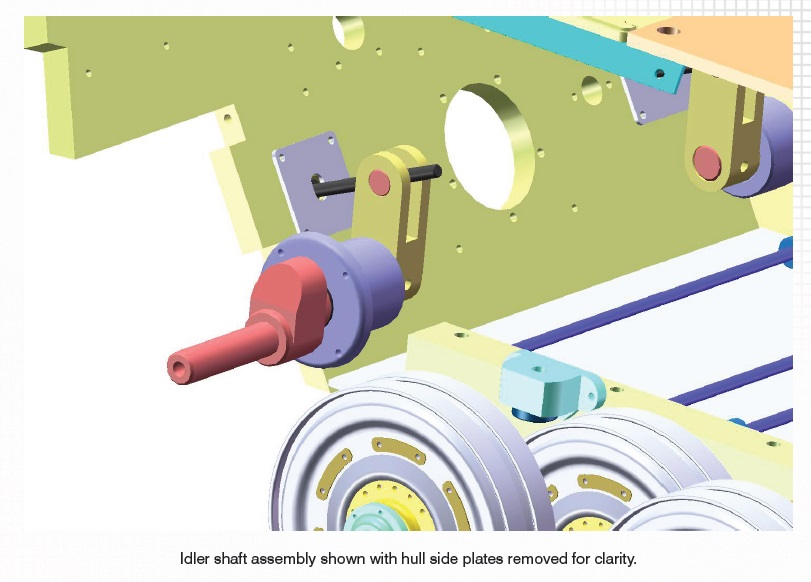

Michael, the idler adjusters can help this problem. We needed some on the JT. I have my old set available if you need some.

I am using the longer bolts supplied with the options pack but if I fully extend them the tracks hit the underneath of the sponsons.
If I loosen the bolts a little then the track jumps off the sprockets. I cannot take out a track set as the track will not then join up.

Liams and other idler adjusters have a longer throw so the idler wheel moves further allowing for a slacker or tighter track. We needed to slacken the tracks and loose a link, now its perfect and I have adjustment in both directions.

Apologies for asking this, but is the idler arm installed with the idler below the centre line of the mounting bush, as per the attached drawing ?
Like that, the idler sweep is from 4:30 to 7:30 on a clock face. I ask because I don't think I've ever seen a KT with the tracks so close the panniers.

Always below as far as I'm aware. I've never seen pictures of real Tiger i or ii or Panther with the axel arms above the centre line.
