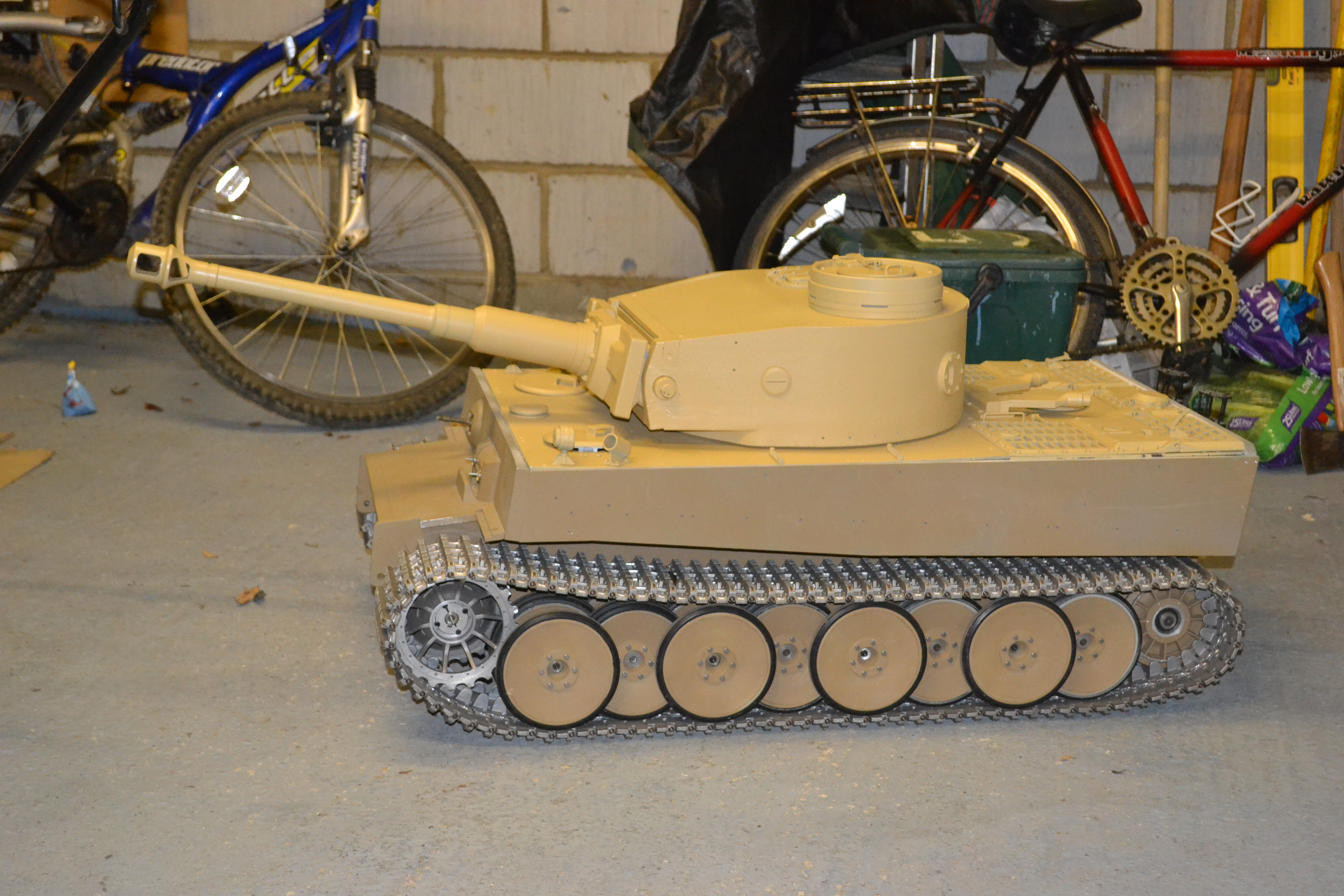

Re: Tiger 1 (Early Variant) 2004 #98 build
The turret and deck arrived in Oxfordshire on Saturday. Messed up my electronics layout and track tension but Dad has done a great job.
Lots of work to do.
Lots of work to do.

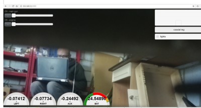

Finally got the video camera pointing out of the drivers window (port?).
Could the Tiger 1 drivers actually see anything useful? I managed to angle it down a bit but not much better.
NB Amp gauges not calibrated yet.

You get a few quick peeks in this video:
Yours looks about right. Love the HUD you have there.

Looks good to me. Who is that handsome chap hiding behind the laptop
Thanks Adrian,
The video does make it pretty clear that visibility is very limited. Sounds like my "customer" is OK with it though.
Sam

Like the Video cameras, I remember trying to drive my Tiger just using the camera feed to my phone from the drivers vision slot, no chance. you can have quite a lot of fun with those Cmos Cameras!

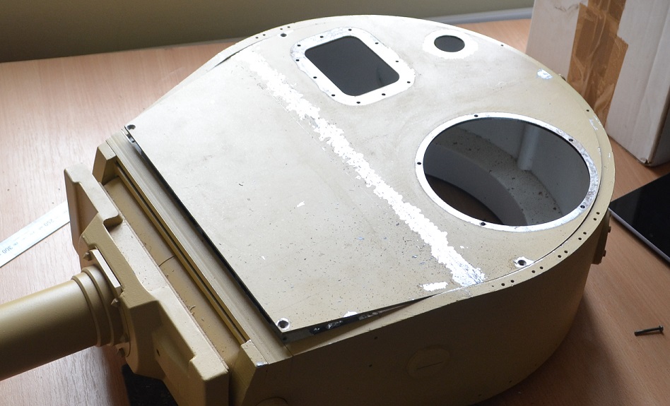

Some visible "progress" after long slog with electronics and software.
I've not done modelling using a lump hammer before
Not helped Dad's paintwork, working up the courage to do the new bend and grind off the sides to match.
Sam
Sam
Turns out my Dad was right and very difficult to bend without the right tools. So doing what Steve Stuart suggested a couple of years ago and making from aluminium.
