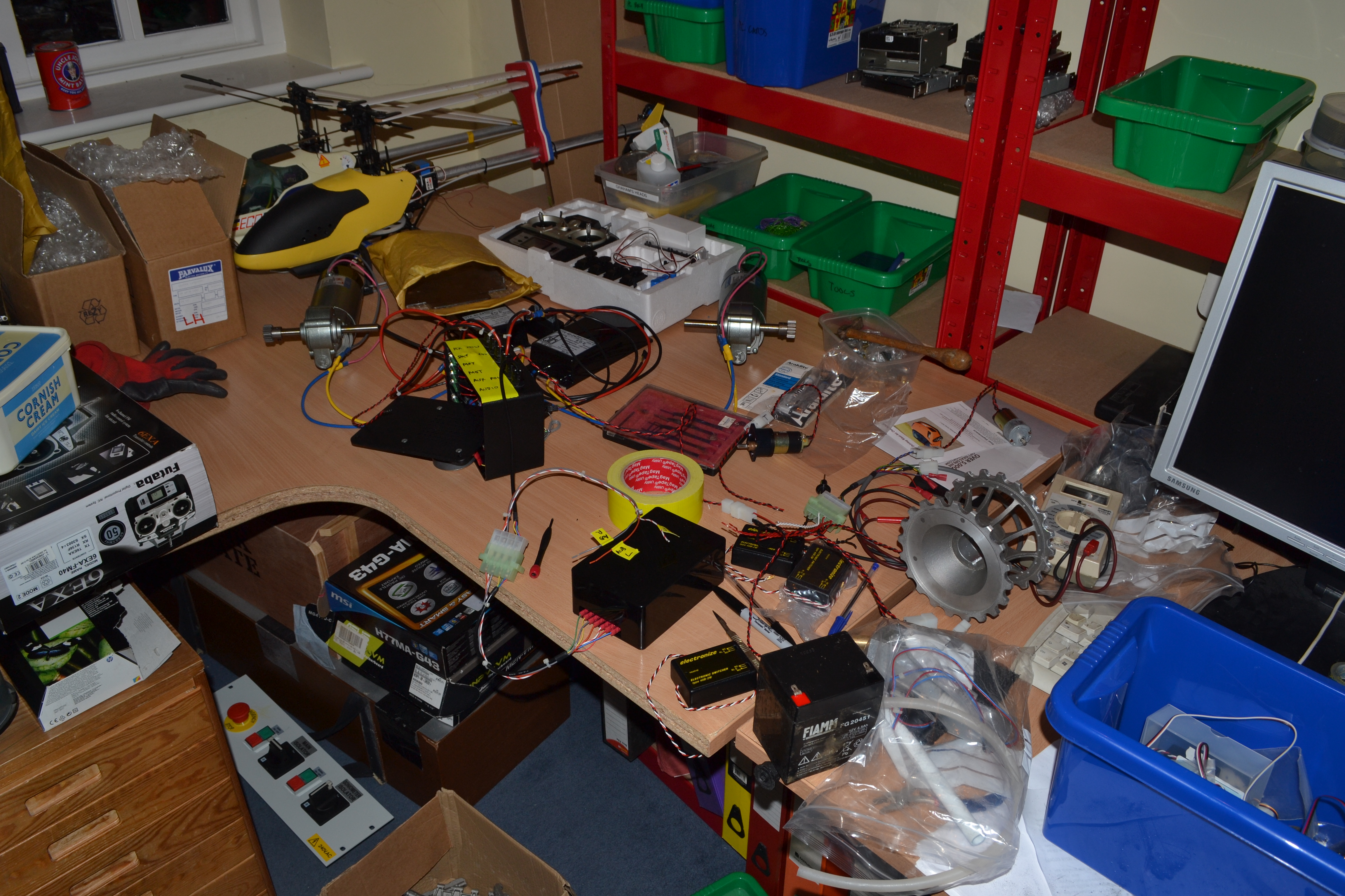

My Dad is building the bulk of the tank in the UK NW, I'm doing the elecs/tracks in SE and we promised the original buyer to share our build progress (or otherwise).
I've laid out the electronics to try and understand what connects to what.
With the help of lots of labels I think it is sinking in. Batteries ordered.
I think I will add a switch to disable the smoke and firing unit. I can't quite picture how you reach switches when the tank is assembled though.
Still got 140 tracks to file down. Not sure the Dremel will survive to the end.

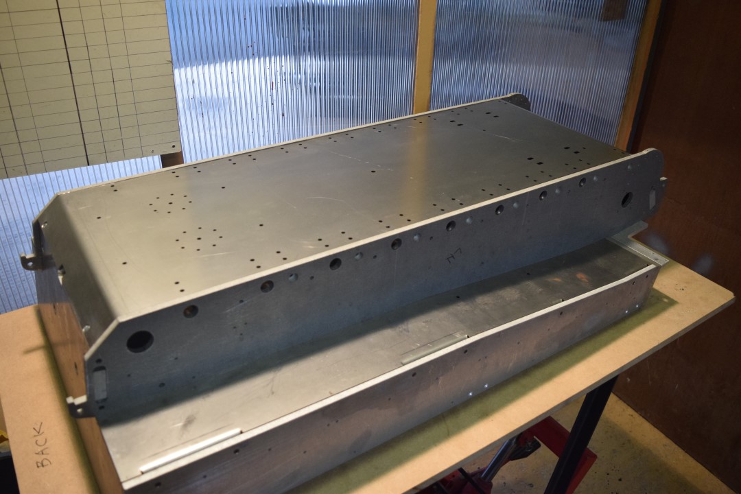

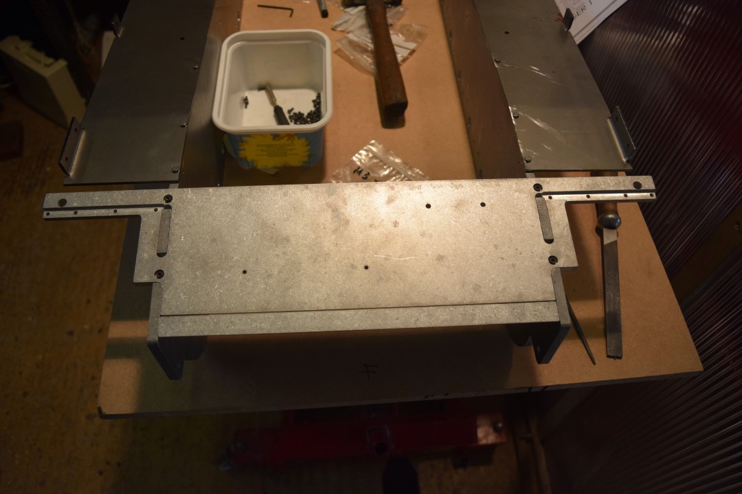

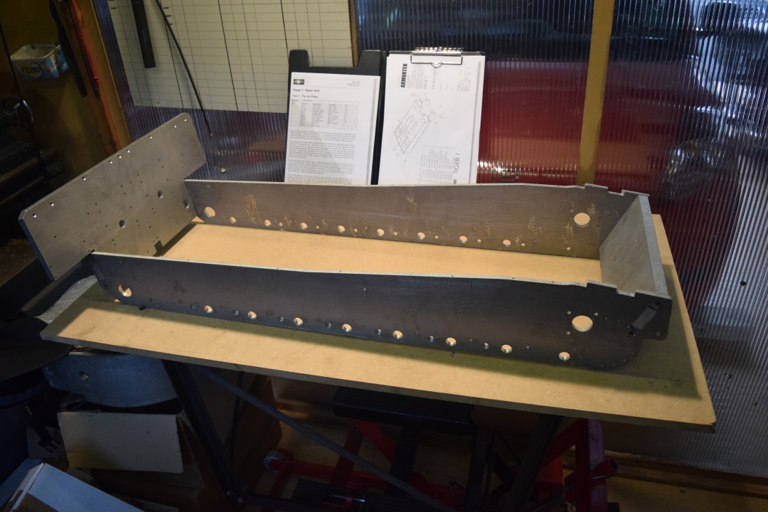

Stage 1 - Basic Hull build. There were a few hole alignment issues but with a little adjustment it all went together well. Thanks to East Coast Armory for advice especially re the use of M4 csk skt to replace M4 hex to bolt the bottom plate to the upper hull. A couple of photos showing cutting of countersunk holes.
