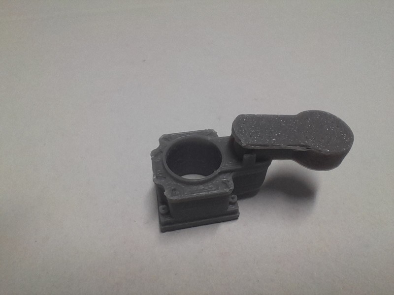

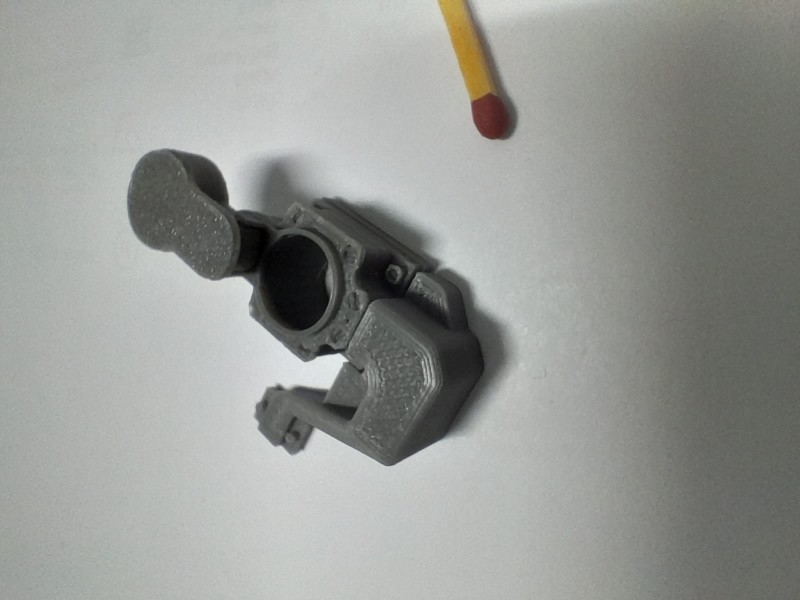

Some more progress:
Printed with a FDM printer to check parts. Obviously the finer details are lost.

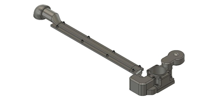

Today's progress. Finished the cable conduit.
One final part to be added. That elbow at the end of the conduit. I have a feeling that this might create problems. We'll see next time.

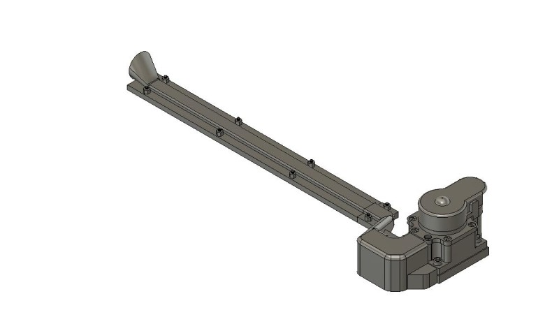

Final part done.
I think I am calling it done. At the moment it is made up of various parts which can be printed individually and glued together. I can join them together and make it just one part but being long and slender I suspect it would be easier to get broken. Not sure what to do.
