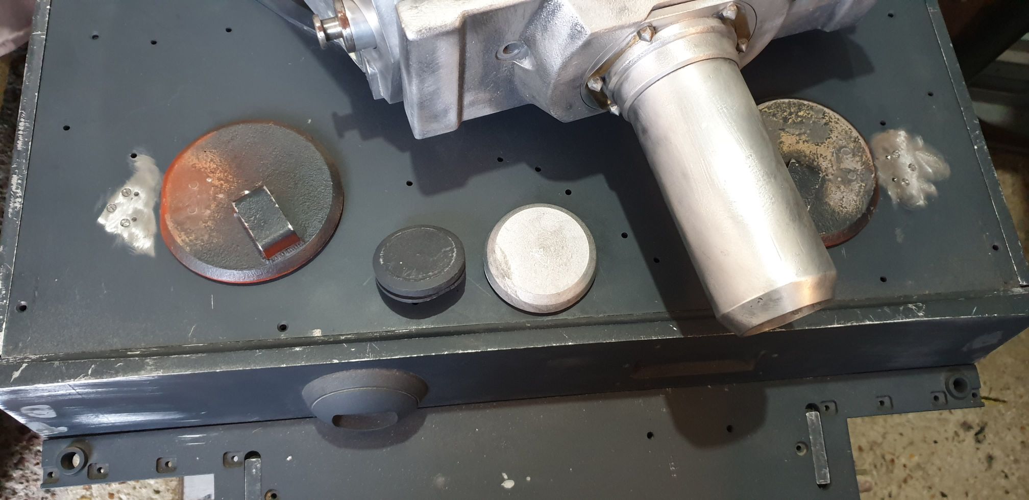

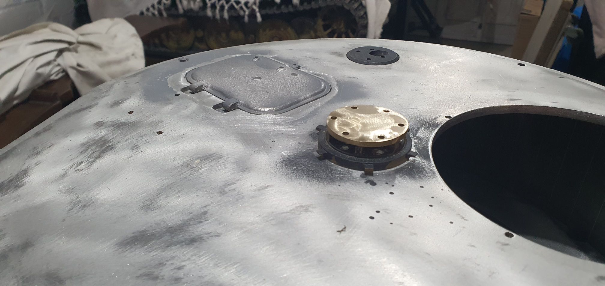

And the second hatch fitted, original holes tapped to m4 and plugged with a counter sunk fastener ...only a small amount of filling to complete.

Hi All
Mike Stannard air vent fitted today - on the left the original.

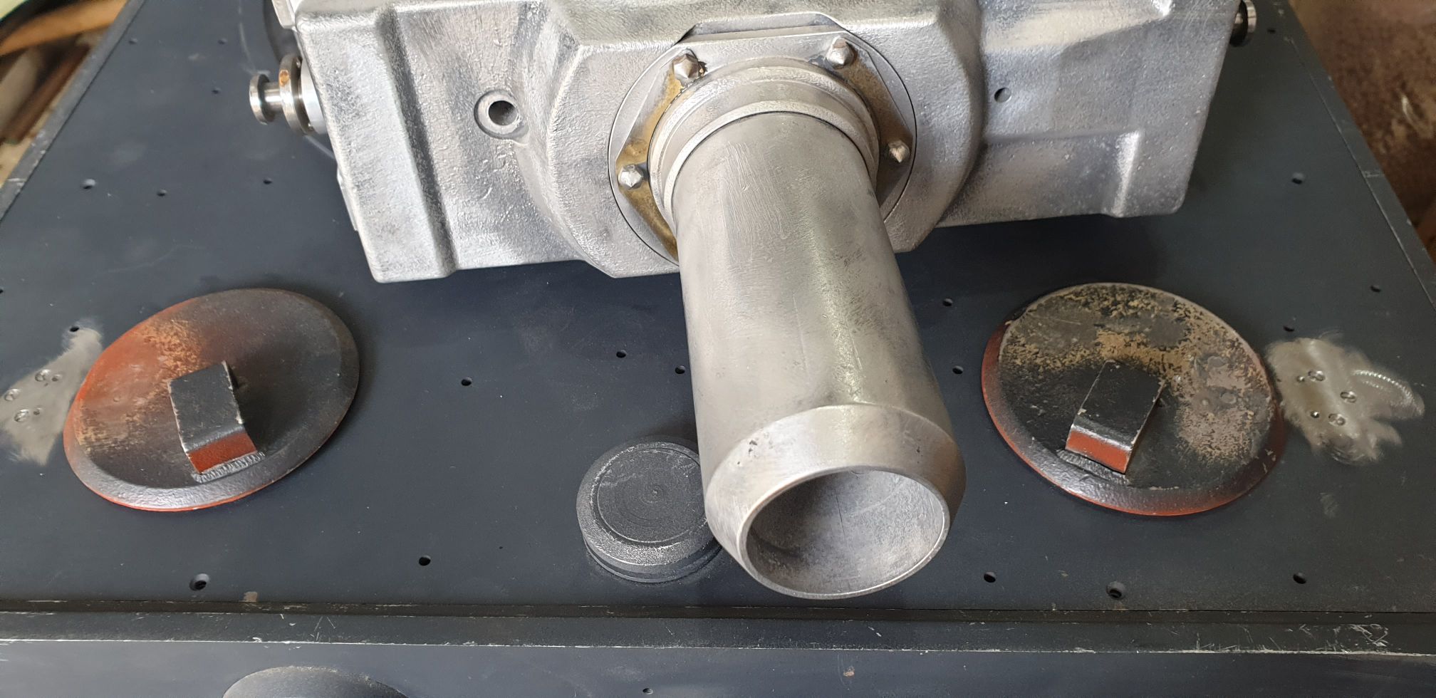

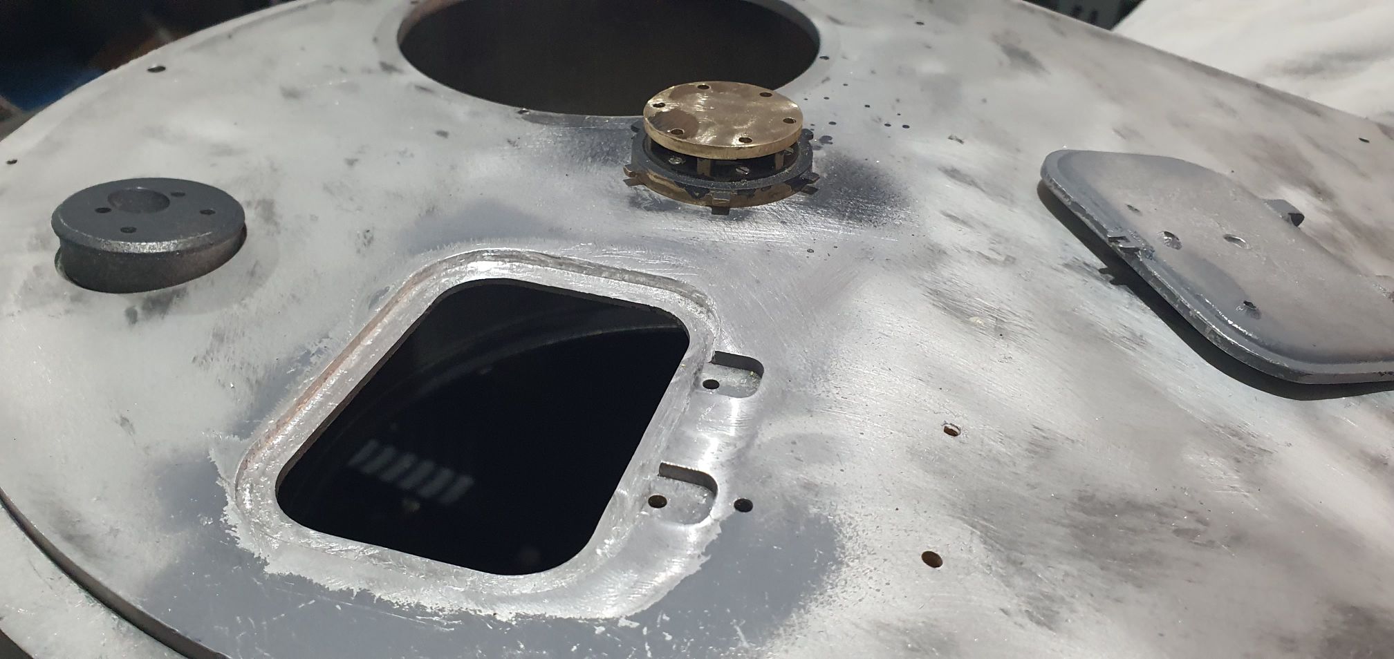

Hatch opening on the 2007 Late tiger was to small to receive a Armorpax hatch, I increased the size with my dremel

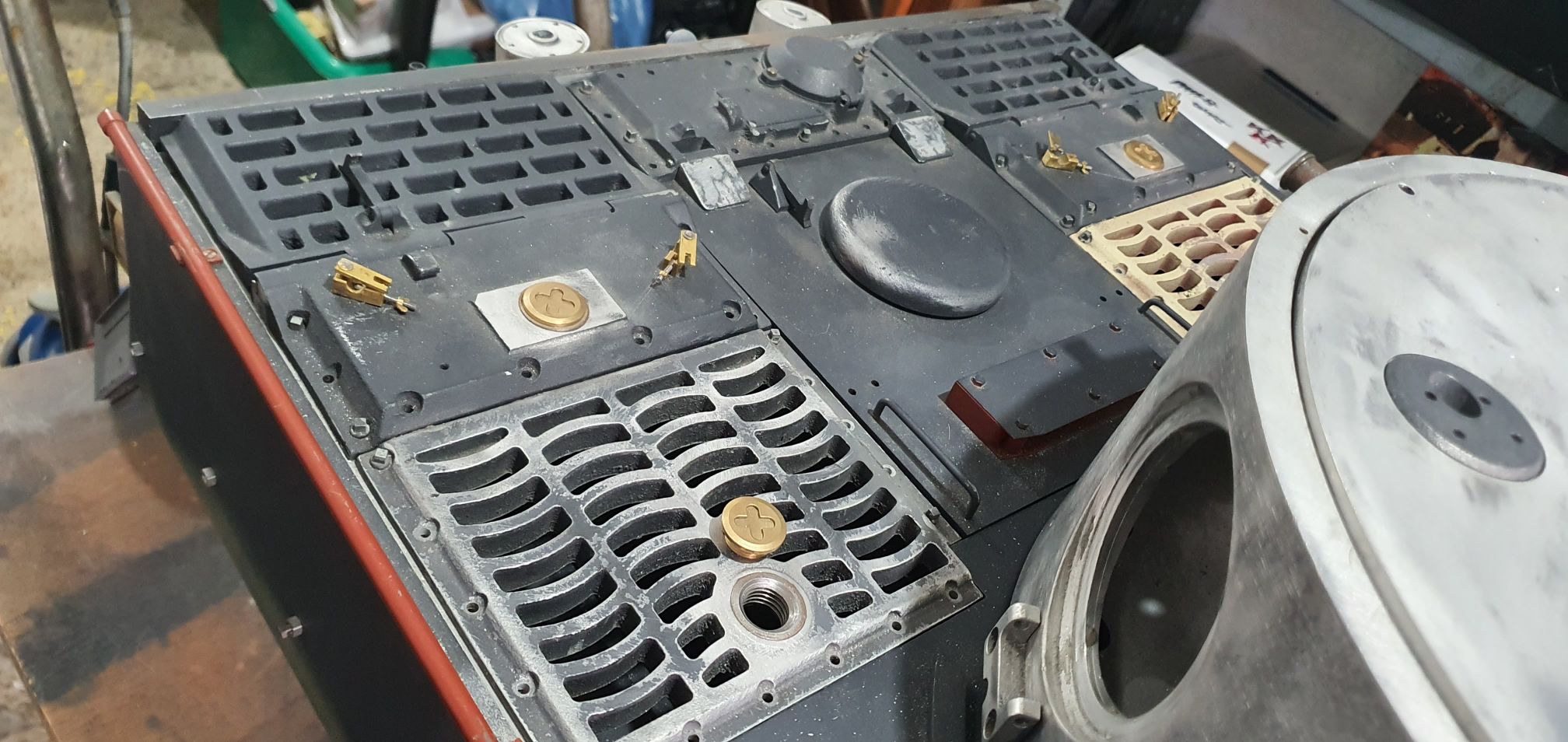

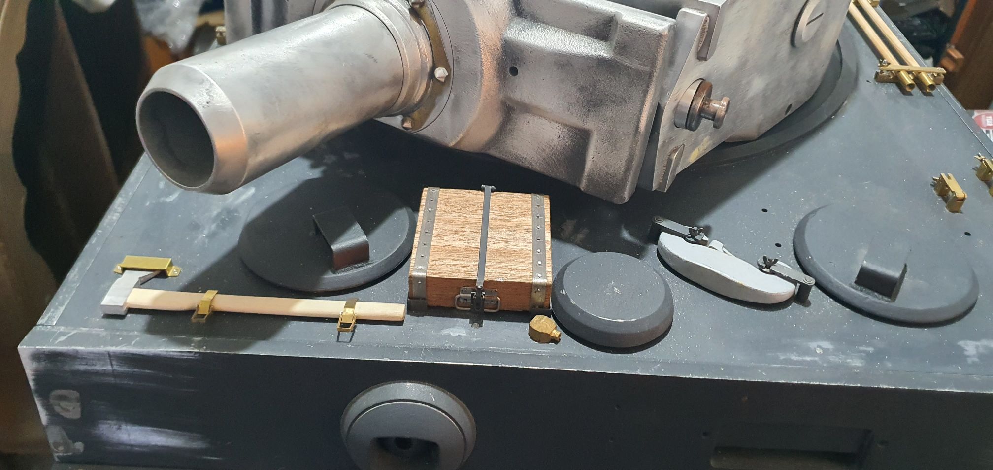

Mark Lawson vent fitted, I reduced the thickness a little
Mike Stannard axe fitted along with some Steve Winstone parts , jacking block, C shackle brackets and light conduit.

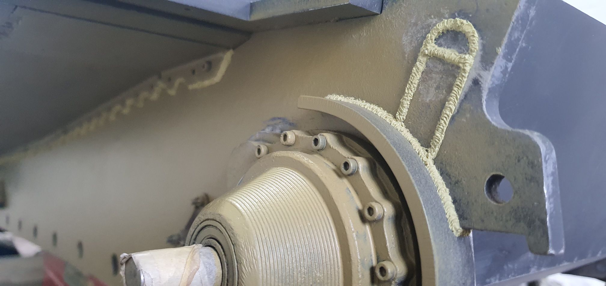

Some welds added, waiting to receive the top half of the fillet from John Fitzsimons
Steve Winstone gun cleaning rods and tow cable brackets fitted

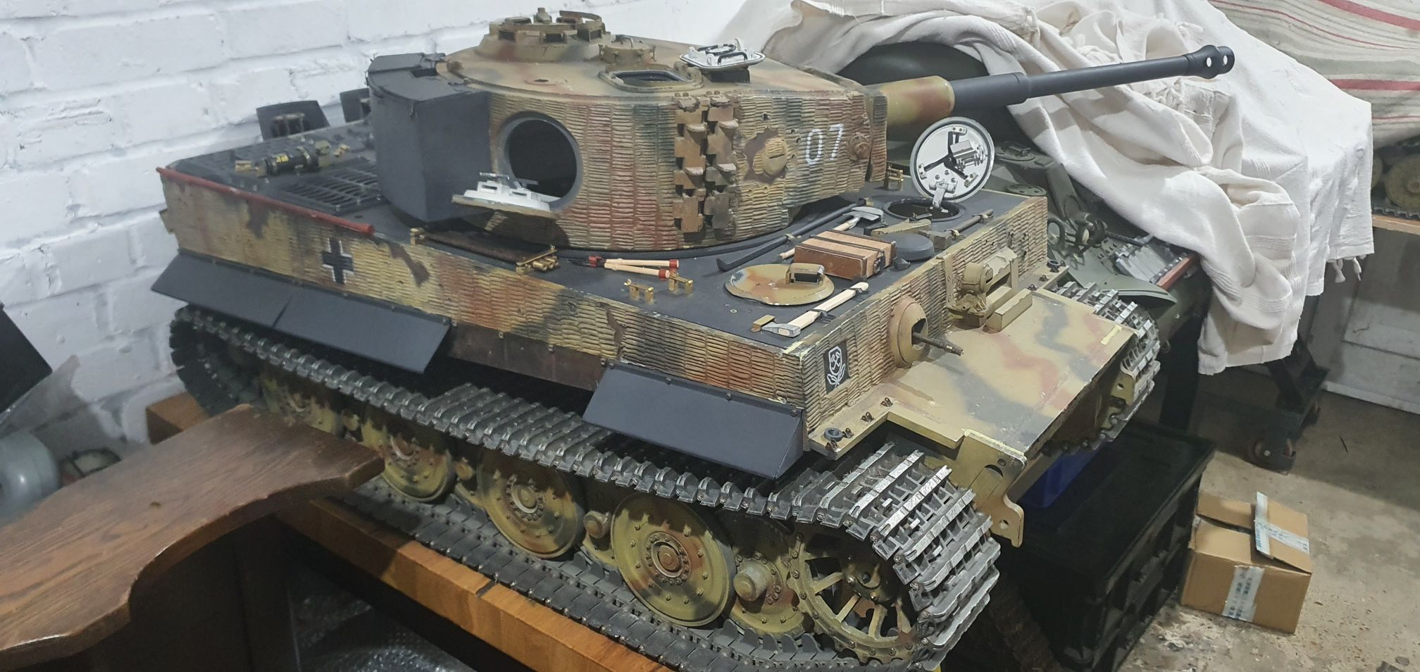

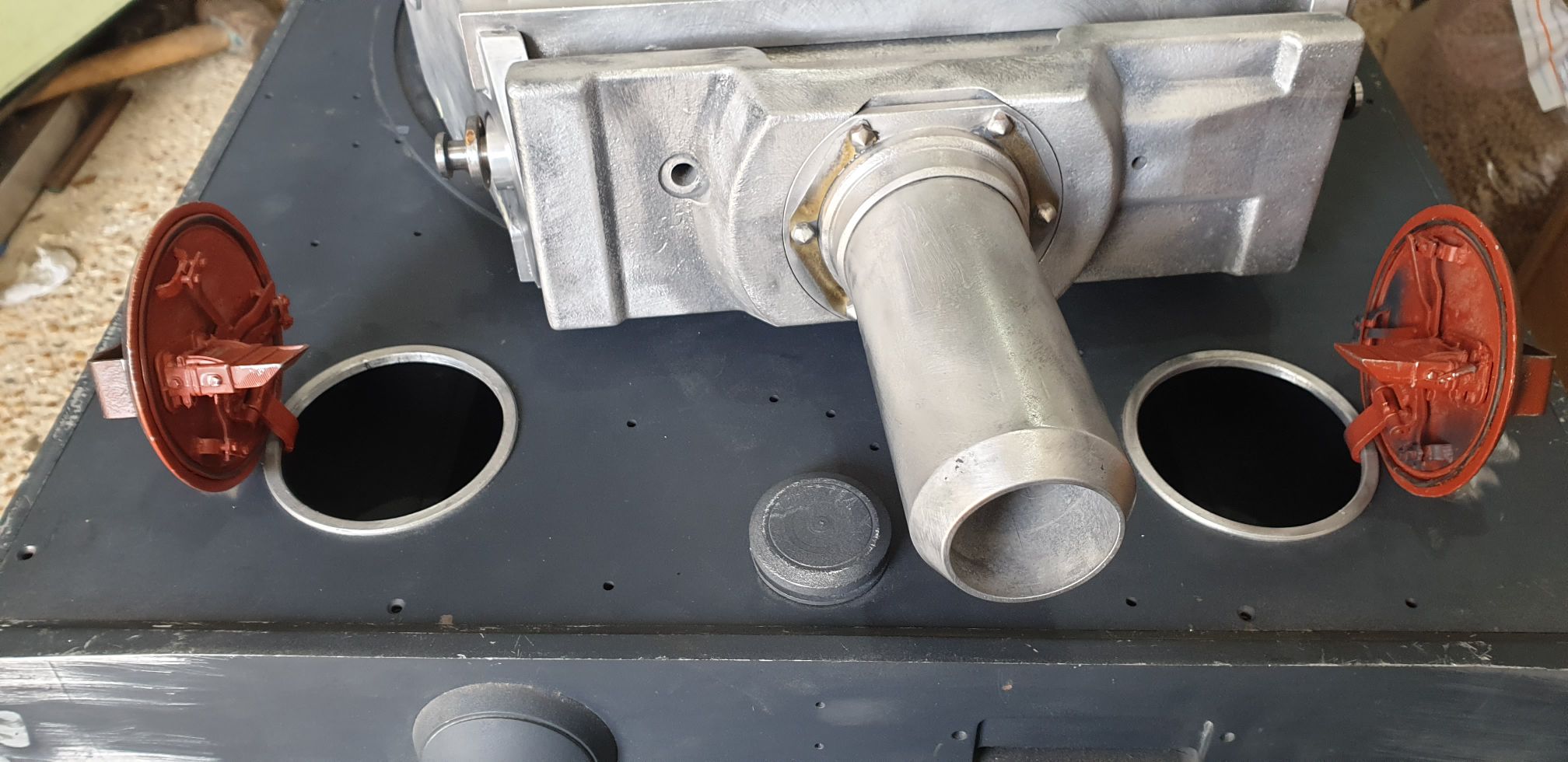

Another late tiger restoration that I've been working on, lots of things fixed and parts added.

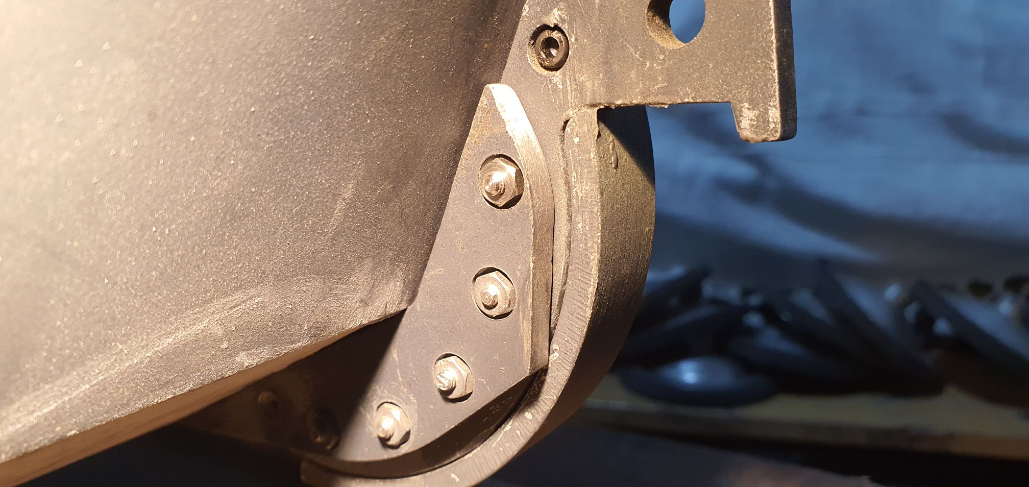

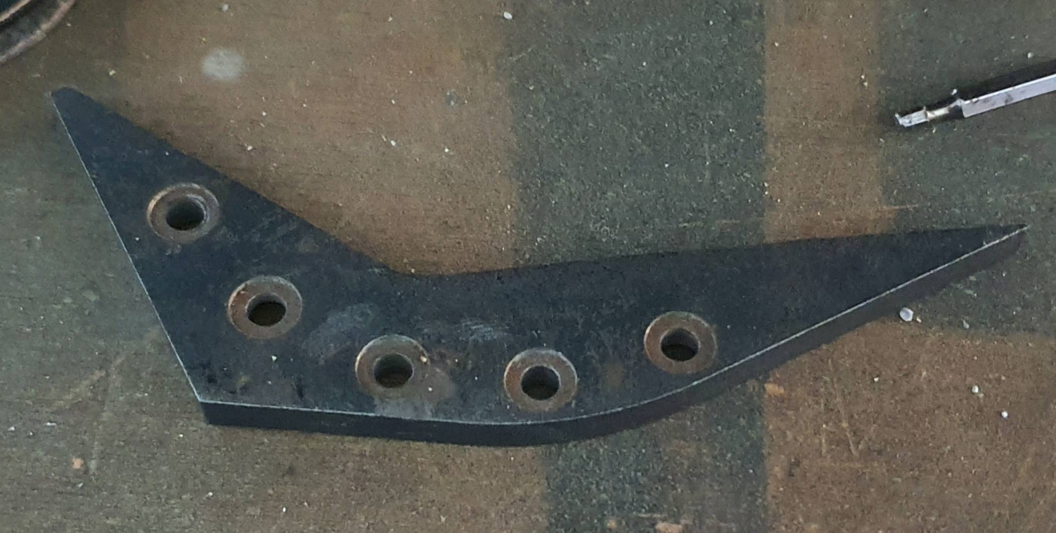

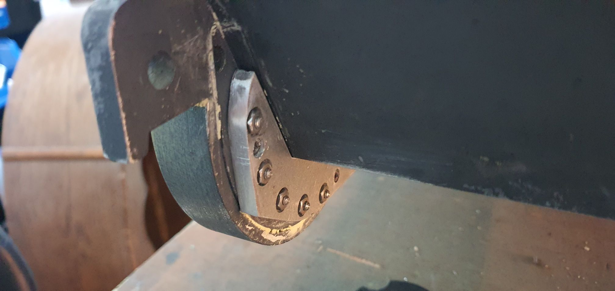

Front fillets counterbored and reshaped to look more like the original part, 4ba nuts used, and additional holes drilled to secure, these will be filled.
Original part-  counterbored to large
Modified -  position and size is better, I can now add a weld line in the correct position
