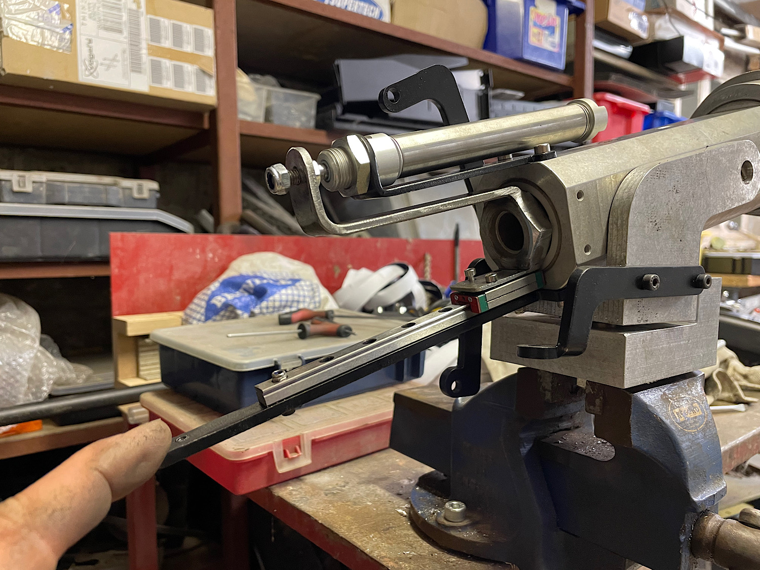

It uses simple pneumatics to retract the gun barrel and then release it slowly, The gun had been modified to have 85mm of recoil I use 80mm of this and then install a bump stop internally to save the bang at full extension. The JT can be modified up to 140mm of travel but this is too much for my battery location, so I am happy with 80mm and it works well without major modifications to the gun assembly.

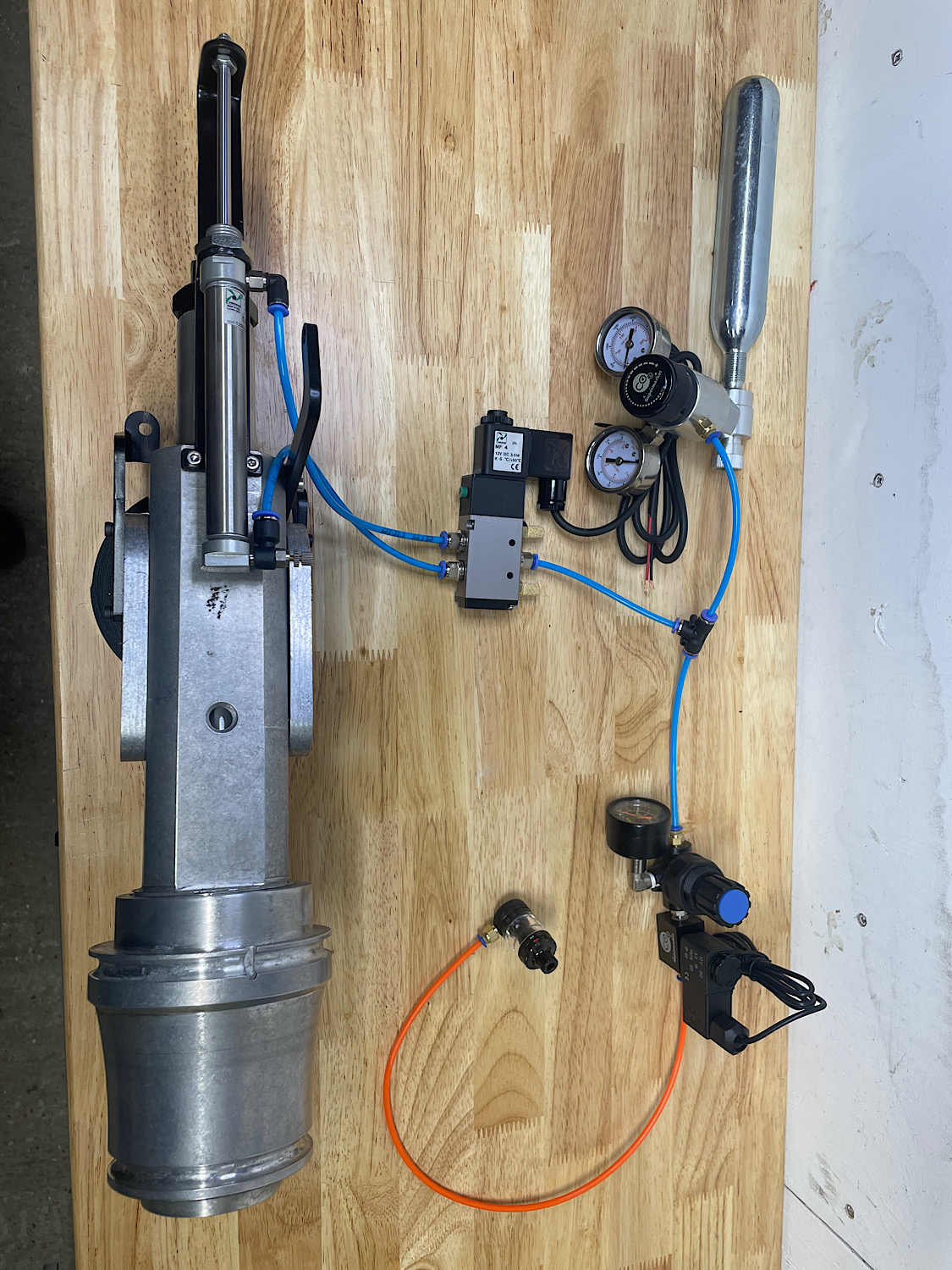

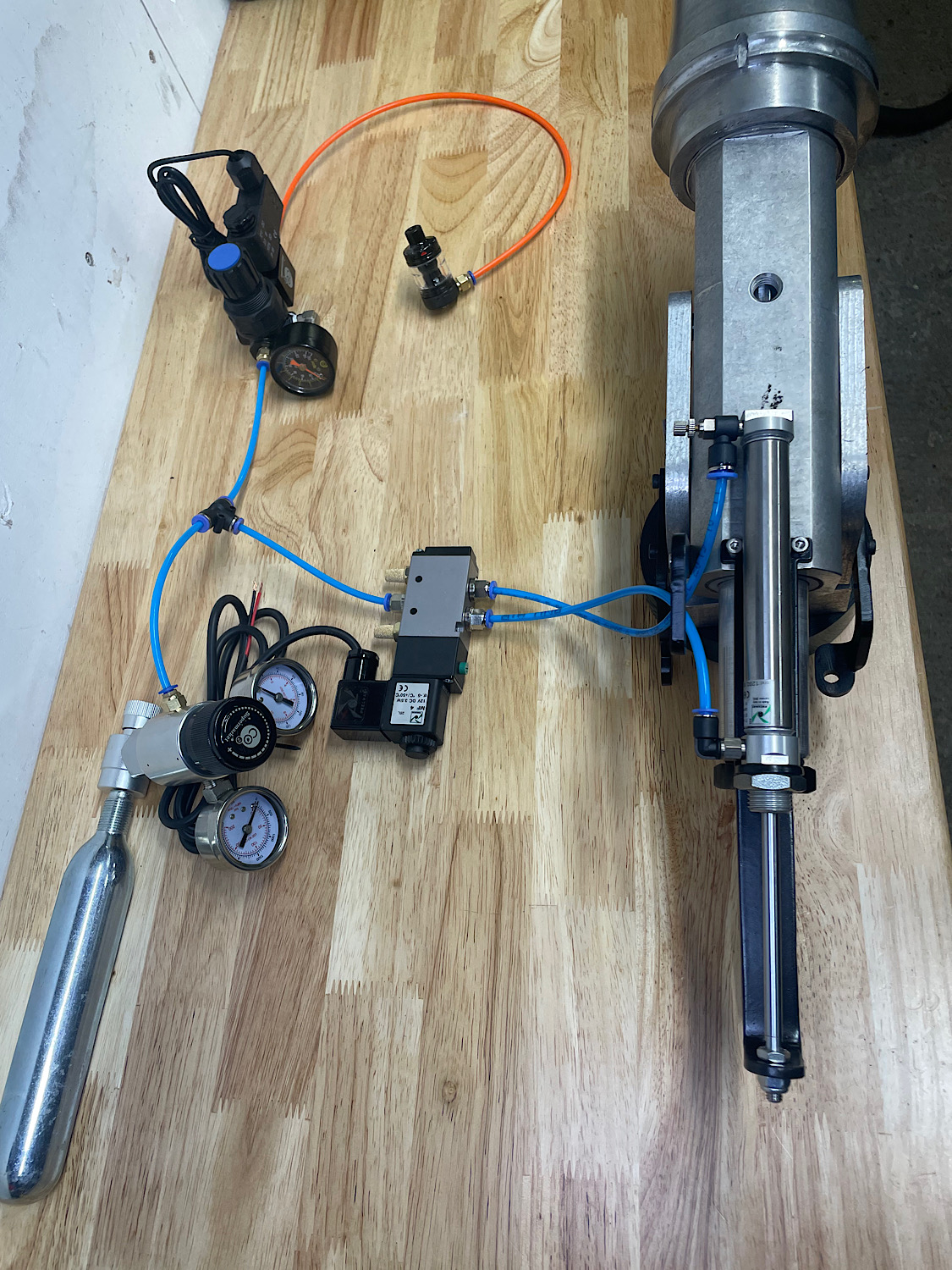

So a CO2 canister is connected to a CO2 regulator and set to approx 45psi (Blue hose) this pressure is then sent in 2 directions 1st is the 5 way pneumatic solenoid valve and the other is into a second regulator which lowers the pressure further to around 15psi for the Gun smoke Vape. (Orange hose)
On energising the 5 way pneumatic solenoid valve (12v trigger) the co2 pressurises the cylinder on the gun and the barrel retracts, When the solenoid is not energised (power removed) the gun barrel returns to its out position but is slowed by the adjustable valve on the return side of the cylinder.

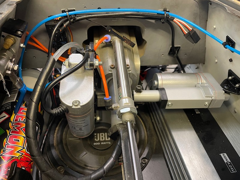

On top of all this I changed the elevation and slew to linear actuators for precise reliable movement the elevation is using a 50mm and the slew a 30mm pictures in my thread for those interested.
