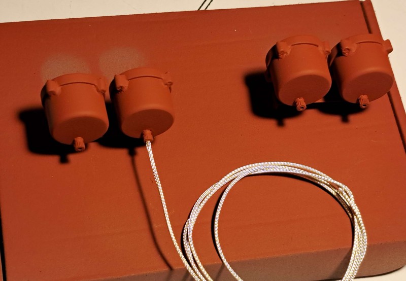

David, A bit late in the day but there is de-soldering wick which sometimes comes hollow and looks like braided sleeving in copper. Beware the stuff I brought was just flat braided and not hollow. I got this stupid feeling while trying to open it up after 5 minutes. :?
I've used screen sleeving stripped from old computer accessories wiring found in my spares drawer, but often found at boot sales. Pulls down to about 2.5 mm OD.
Unused Scart leads have been stripped to supply thin colour coded wiring to put through said braided sleeve to supply the Chieftain lamps front and rear, 3mm OD copper tubing soldered together making up tee's and carefully bent tubing for elbow's, then forming thin alloy sheet into hexagonal nuts shape on the hollow braided ends sealed with J/B weld to form the hollow nut. (A bit like me)
it's a bit crude, but six wires at one point needed to go through the braiding cable on the front lighting setup I'm doing.
All load resistors for the LED's are connected individually remotely, don't be tempted to join all lamps with one resistor.
I usually run warm white LED's with a higher rated load resistor than normal on low voltage (6v) they'll last "long time" with a more realistic warm white element type glow.
I'm putting red LED's in the front infra red lamp housing's, because not everyone will be wearing their infrared googles ....it's Theatrical. :lol:

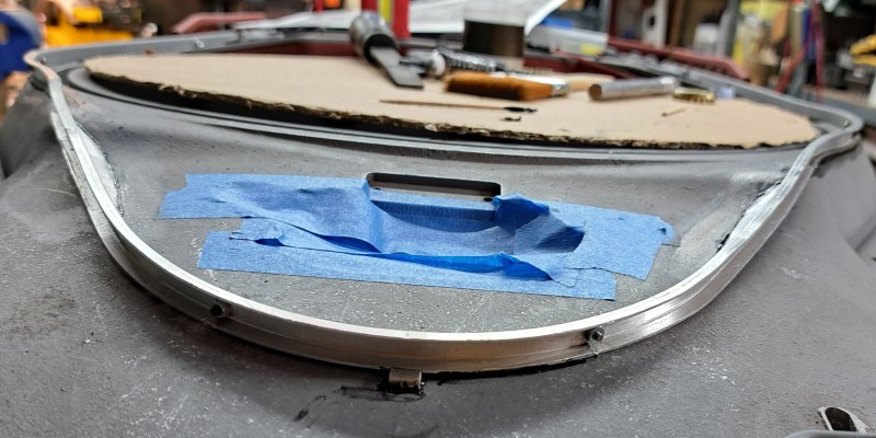

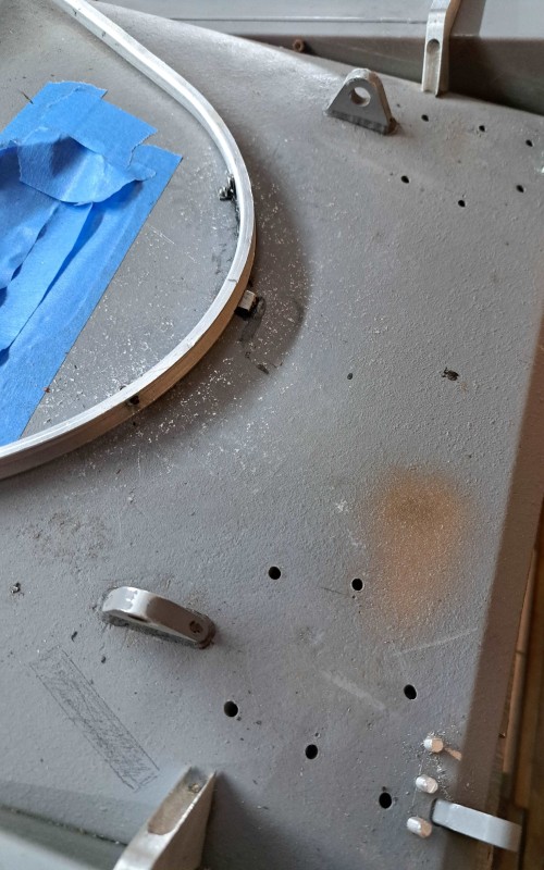

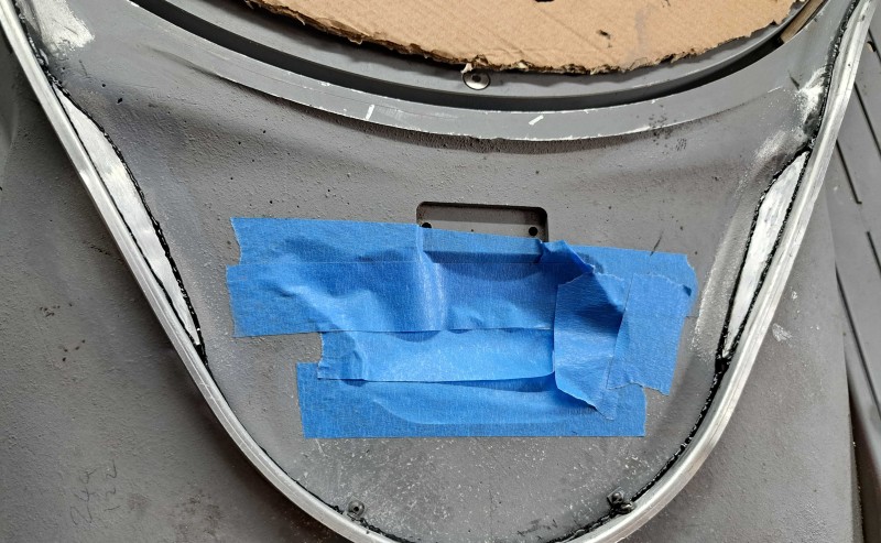

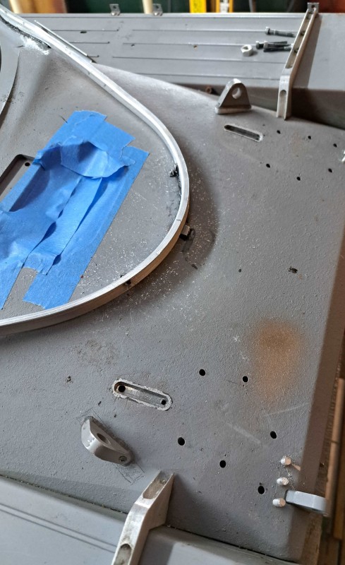

As part of the front end modifications, a job I thought would be a bit of a chore. That is to remove, make and refit these lifting(?) eyes. In the end it wasn't that bad a tall.
Fitted as per instructions.
Where they should be, but not these bits.
Good job I didn't use JB weld or the like, could have been difficult to remove :oops:

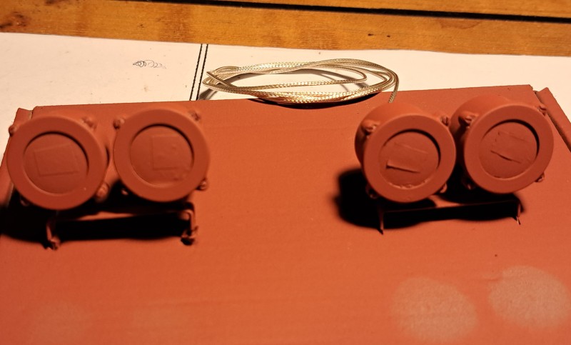

I was happy with the headlights, so far, a bit more work before fitting required, but not a lot.
With faux braided cable.

Hi Charles,
The front details are coming on nicely, the lift eyes look much better relocated .
Charles, John and Richard, many thanks for the tips on braided cables - anything is a big improvement on my original 'boot lace' idea.
John, - I'm interested and slightly concerned about your comment on LEDs 'I usually run warm white LED's with a higher rated load resistor than normal on low voltage (6v) they'll last "long time" with a more realistic warm white element type glow.' Being an electronics duffer I have used pre wired 12v resistor and LED's from the 'bay of ees' which are now sealed for good in the headlight units - should I be worried about them not lasting very long. What are you calling a higher rated resistor ? should I be adding a second resistor to each circuit and running at a lower voltage ?

Re the headlights, you could put some sticky silver foil over the wires on the inside to cover the wires? Also as another suggestion, I would slide some 1mm heat shrink sleaving up the brass tube such that it hangs out the bottom. This will help in protecting the fragile wires from vibration and binding on the edge of the brass tube.

Thank you, Richard, I never even thought to cover the wires :roll: :oops: . I should have painted them at the very least.They are firmly fixed in place now and the wiring clued to the light frame and will go into the hull through the mounting holes, not yet drilled.
I have changed the resistors too(LED's as bought were 12V), the lights will be controlled via an R/C switch (as supplied with the S1), which is 5V(ish), I believe. We have tested the Chieftain lights using the S1, it worked :-D
