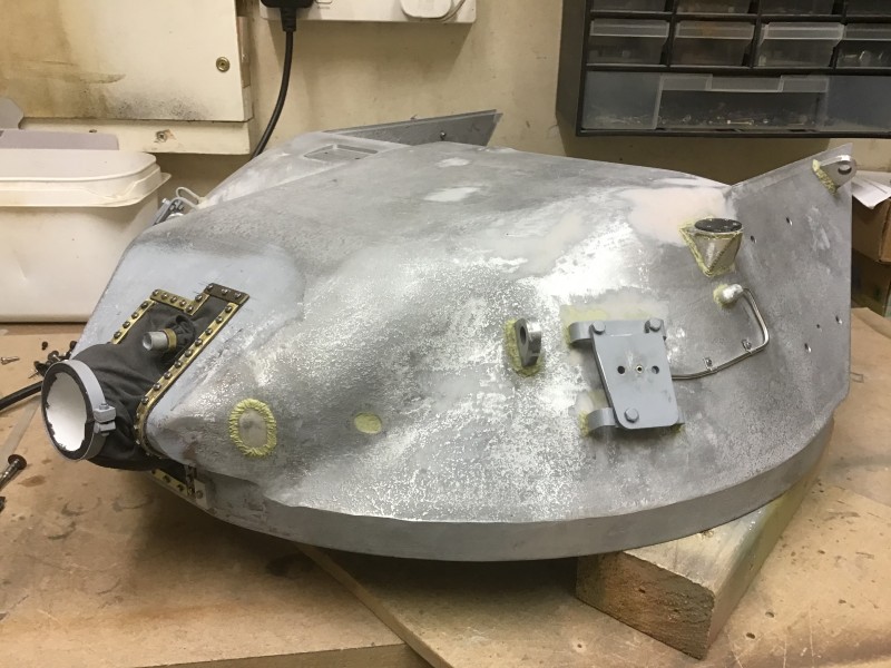

I have added the gun mantlet dust cover and mg port. Weld detail has been added for the ranging gun blank and a dummy gun trunnion blank. I have also modified the smoke discharger mounts
On the right side I filled the gun trunnion mount hole and repositioned it further aft. Wiring harnesses were also added to the smoke discharges.
The commanders stowage bin was also upgrade and the TUAAM was lengthened

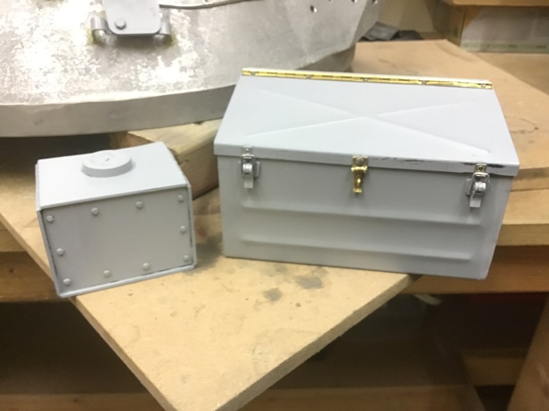

Mounting blocks added for the commanders bin, the lower dummy mounts have also been added. The upper dummy mounts will be added after the bin is finally fitted.
