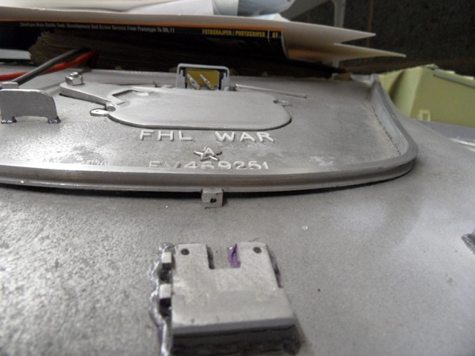

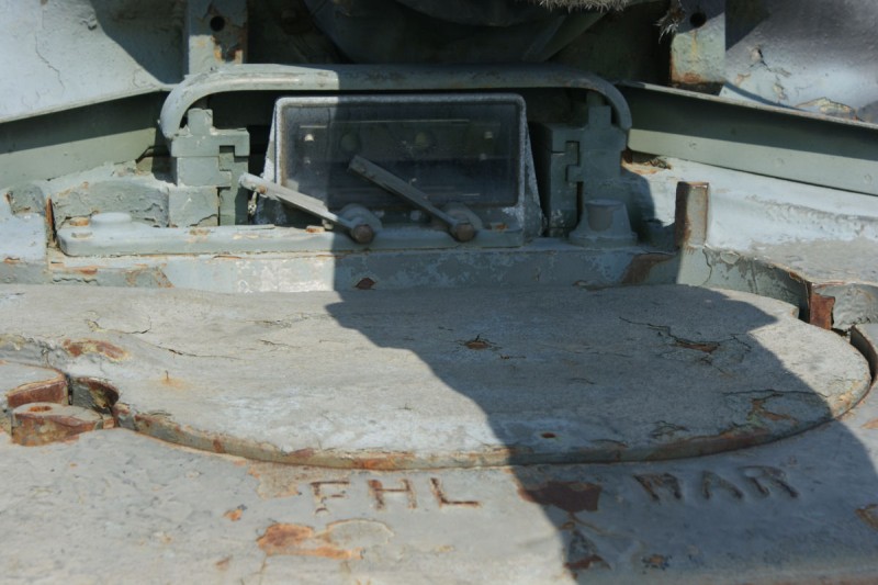

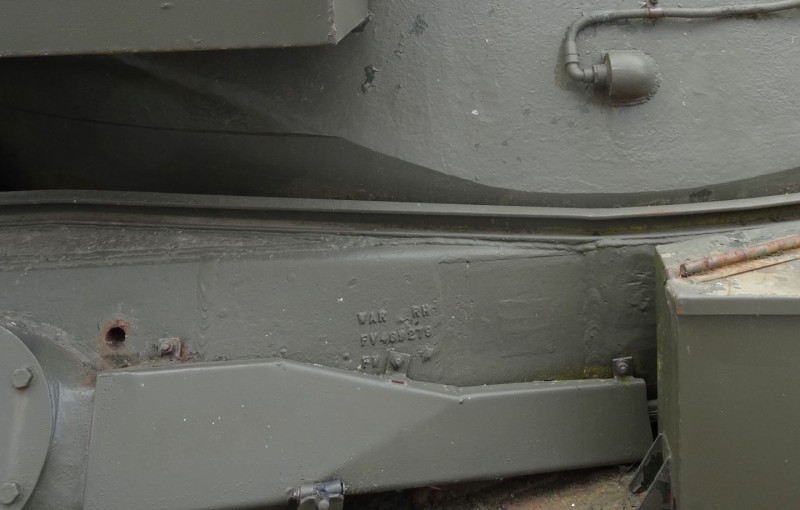

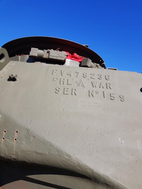

From the photos their mark seems to be 'FHL' and maybe just 'FH' and possibly the 'A' star symbol as well - do you know ?
