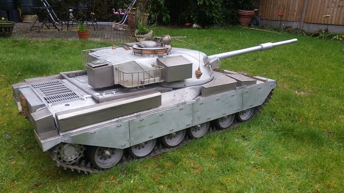

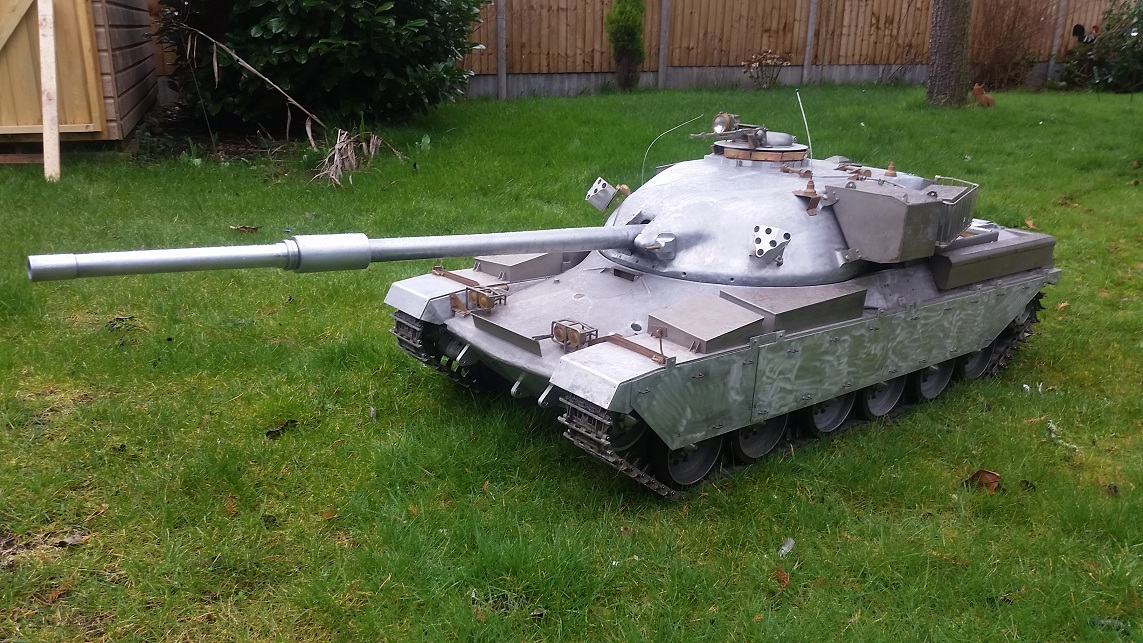

Hello and welcome to my Chieftain build.
The current plan is to make an early MK3, though I’m still missing dimensions for some key details, so things may change.
The reasoning for the choice is I like the cleaner lines of the earlier versions, less cluttered by the add-ons and upgrades that kept Chieftain on the front line for over 20 years. But most of all, the look of the early beehive air filter on the turret takes me straight back to my childhood in the late 70s when I made the 1:25 Tamiya Chieftain. Featuring individually linked tracks with rubber inserts, twin motor drive and two speed remote control (on wires, not radio) it fast became my favourite tank kit and so the Armortek Chieftain has a lot to live up to.
On a recent trip home I was amazed to find the Chieftain hidden away in the attic, looking surprisingly intact after 35 years buried under loft insulation.

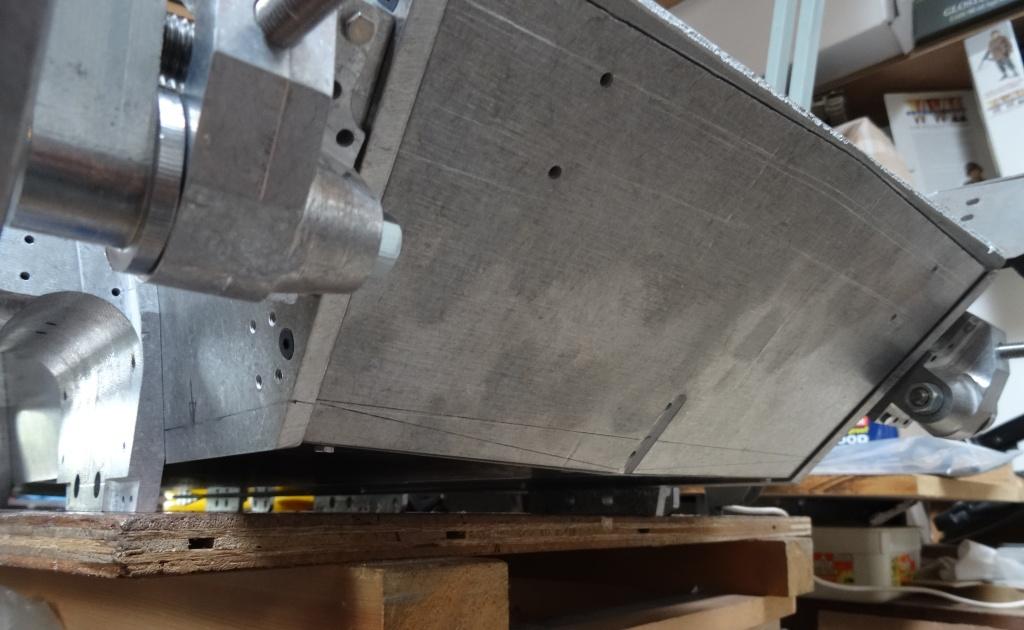

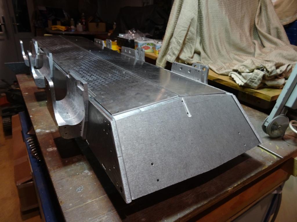

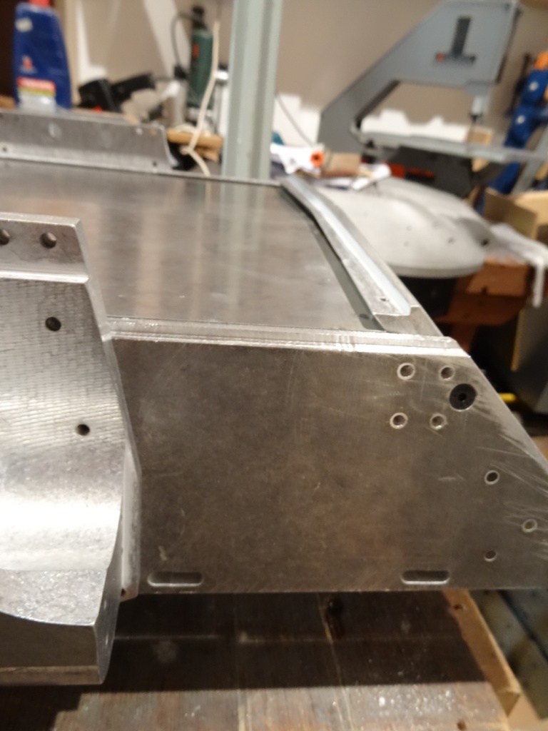

First task is add some extra daylight to the underside of the hull by increasing the ‘V’ angle of the hull belly plates from about 3 degrees to 5 degrees, as measured from the horizontal.

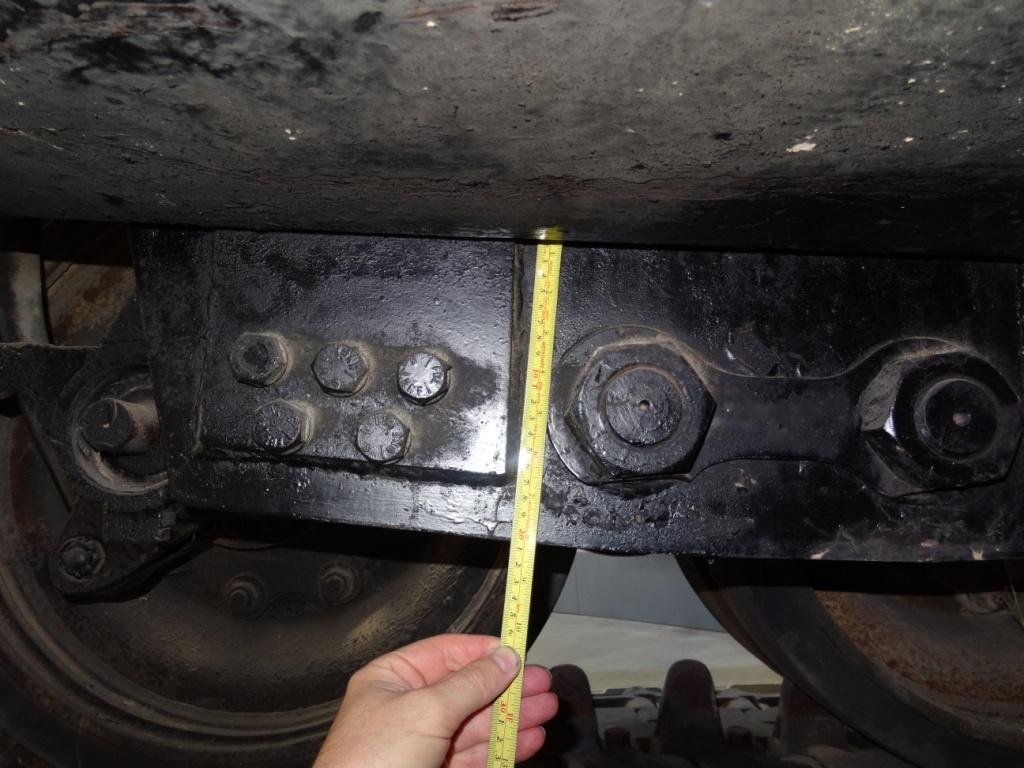

Measurements from the real thing were used to locate the correct position for the bottom of the hull sides relative to the centre of the swing arm pivots. A small step was also added to the side plates to replicate the exposed edges of the belly plates. Projecting inward at 5 degrees brings the underside of the belly plates nicely back to the centreline of the kit hull.
Rather than try and bend the correct V in the belly plate, I decided to cut it into two down the middle. This seemed a good idea at the time, but I now need to find a way of stitching it back together.

I like your thinking David with the belly plate. I think I considered a deeper V bend, but what you gain on the middle you loose on the edge.
It would concern me to loose the strength unless your going to reweld it back together. Welding up the rear end was enough trauma for me.
I managed to extend the front armor V by about 6mm. Thinning down to the outside edges.

There is nothing gained in the middle as the centre line of the V ended up at the same point as the kit, so the ground clearance along the middle is unchanged. Unfortunately, it's all loss, as I cut off about 13mm from the bottom of each side plate.... and yes, I did check first to see if the large diameter motors still fitted without the need to add 'power bulges' in the hull floor.
Joining the the two belly plates back together is a challenge. I don't have access to welding and initially I thought I may be able to solder them, but now realise that would require a massive amount of heat to bring everything up to temperature evenly without distorting things. Also, there's a fine line between melting the solder and melting the aluminium, so plenty to go wrong. Instead, I will stich it together with some thin steel plates and plenty of M3 countersunk fixings.

I didn't really understand amount of material you had removed on the lower side armor, I was looking at it on my phone during a work break.
Looking closely on the PC I see the changes,

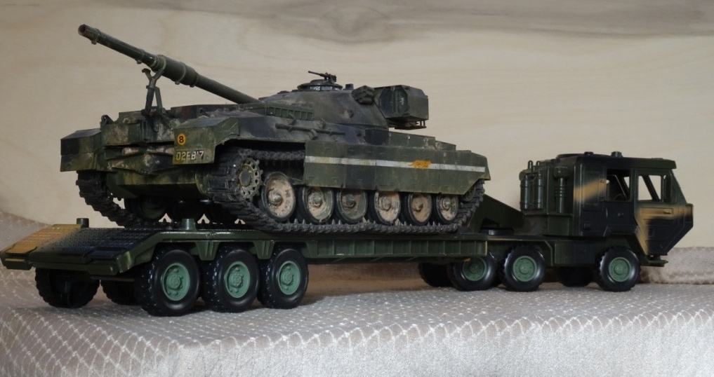

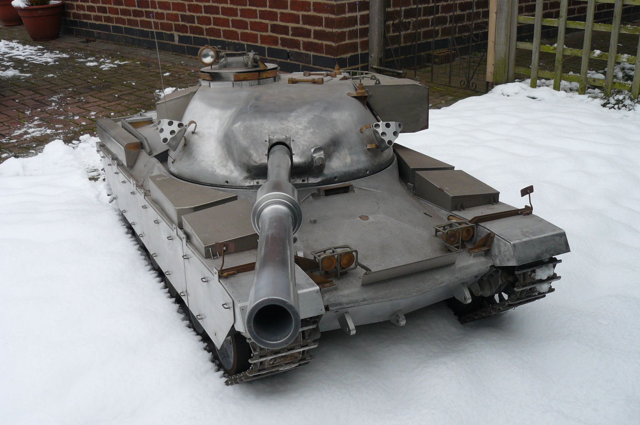

My old 1/5 scale mk3s Chieftain I sold to purchase the Armortek Chieftain.
I couldn't paint it or detail it though fear of loosing its originality, too big to keep with another on the way.

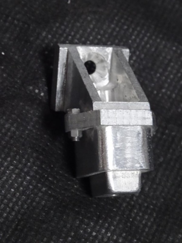

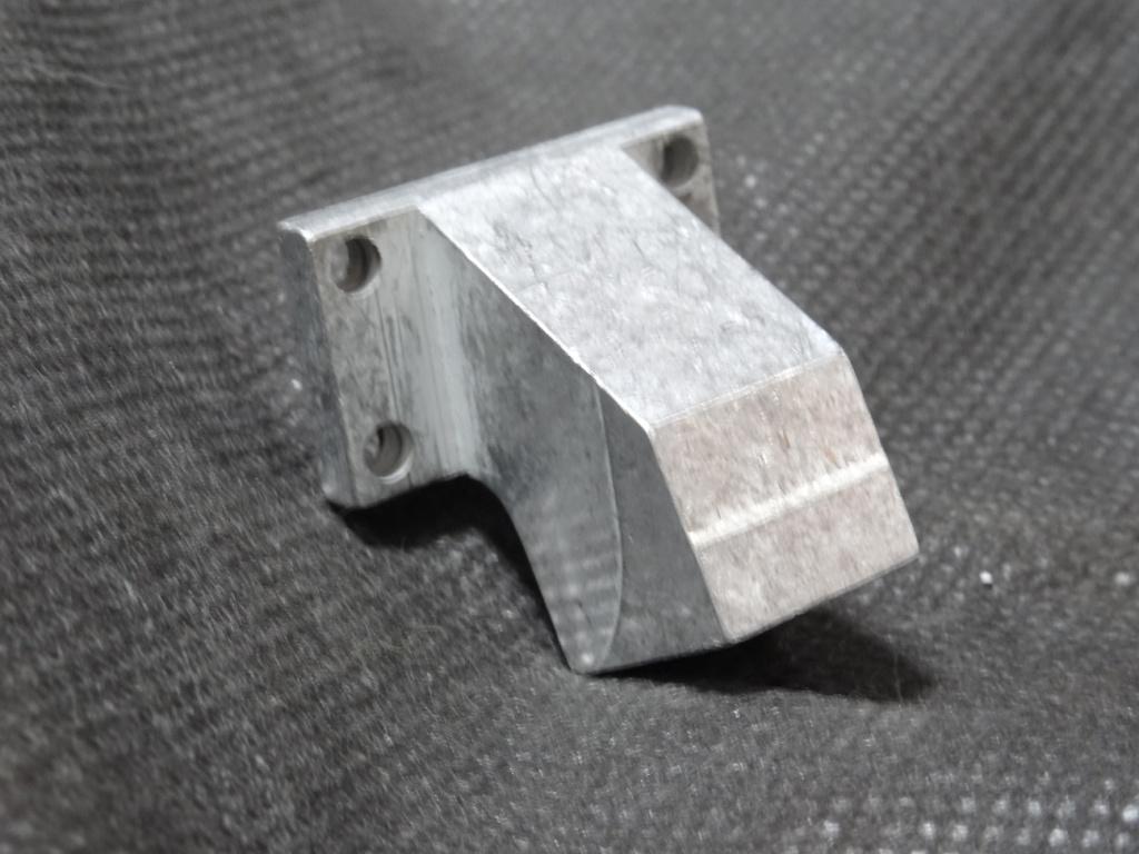

Next up on the build are the suspension units. The first item to improve being the bump stops, as their location helps dictate the finished shape of the main suspension housing.
The solid kit piece was hollowed out as much as possible to give it more of a fabricated look and the bottom half cut away and replaced with a new mounting flange and bump stop housing. The two mounting ears were also cut away and the four m3 fixings replaced with a single countersunk M4. The bump stops will be pinned to the suspension units to stop them from being knocked round on the single fixing and unscrewing whilst in use.
I was thinking about hollowing out the housings and adding real rubber inserts for the stops immediately adjacent to the sprockets and idlers, as these seem to get the most and heaviest contact during use (can anyone confirm ?).

My suspension bogies have been stored away for many months. But I seem to remember theres a few limitations of travel without a lot machining. For this reason I dont think the original model bump stops get a lot of action. With the extensions you're fittimg the wheel arms are more likely to hit the bump stops.
Lovely detail, looking forward to seeing the plans your making for this model.

Before adding the swing arms etc, I've found the the basic suspension housings make very useful 'legs' for the otherwise awkward V shaped hull to sit on - so recommend getting yours out of storage.
I proportioned the size of the bump stops from the real thing and you are correct, they are a little longer than the kit. I found the tyres could rub against the bazooka plate support before reaching full upward travel, so hopefully the longer stops will help solve that problem and also reduce the amount of metal to be removed internally to address the spring clearance issue.
