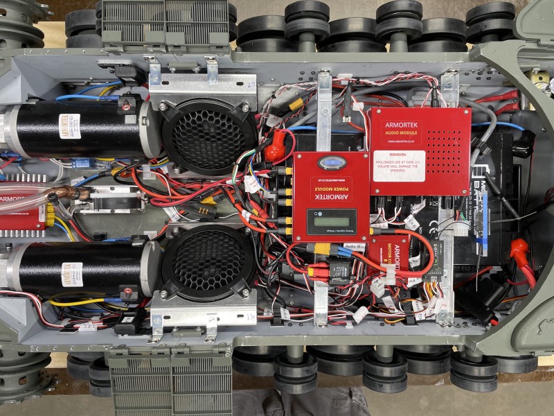

Nice layout for the electrics well done, will have a go at replicating it for mine, always seem to struggle to get the wiring tidy and l hate messy wiring.
Thanks Steve,
However there is a "small" change that needed to be made since Armortek supplied us with a new power distribution module, and asked that we don't use the old one that is shown in my original pictures. You will also be using the new larger module, not the smaller one I originally had shown. But it will not fit exactly in the same position as the old one. It will clear the turret rotation gears if kept within the inner circle of the gear ring. But it is much higher than the old one, and as a consequence, the linear motor mounting screws for the gun, will hit the 15 amp fuse that sits on top of the power module.
My layout being very tightly configured and all my wiring looms set in place, really had few options to make it fit unless I wanted to rearrange everything! I did not. So I moved the 15 amp fuse to the side of the new power module. It was very easy really. I took the top cover off, and I just cut a rectangle slot on the side, and remounted the fuse holder. Everything fits perfectly now with no clearance issues. I realize that I now voided the warranty on the new power module, but there is really nothing inside to go wrong. It is all hard wired connectors. So I can live with that. See the pictures below. The overall picture does not yet show the new fuse position. The other picture through the turret does.
-Ray

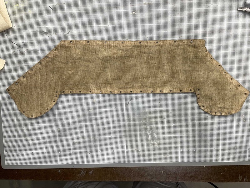

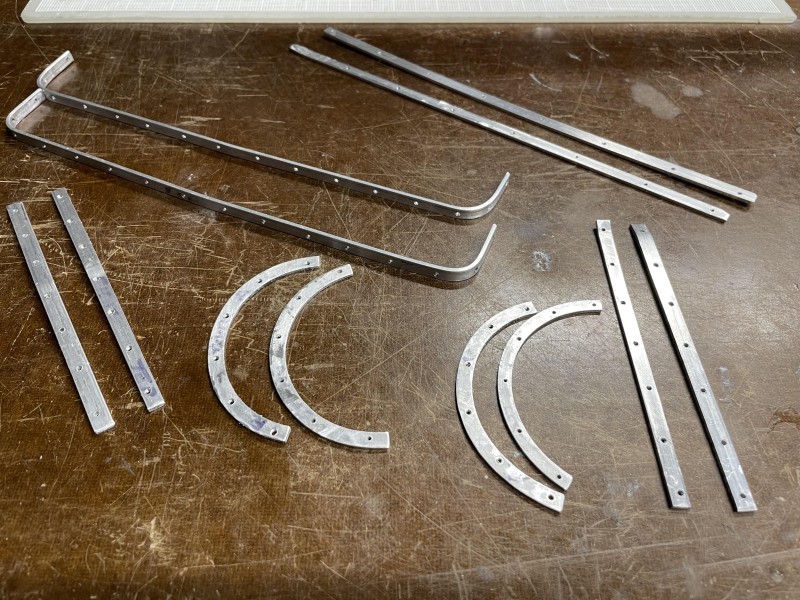

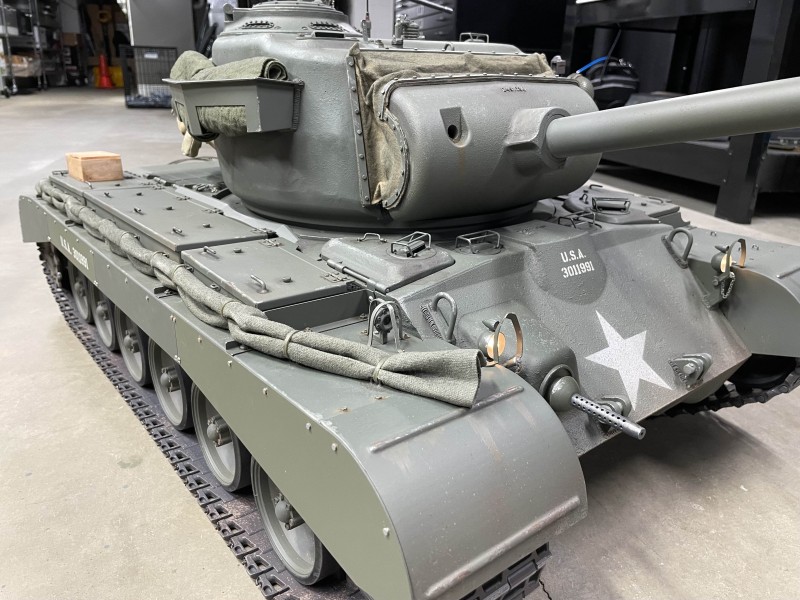

As my tank is nearly complete except for some weathering, here is my interpretation of the canvas covering the mantlet.
The framework is made of aluminum and is both on the top side of the canvas and the underside like the real tank. I used the same number of bolts (I think) and all holes are threaded using 2-56 hex head screws. It took me 6 tries to get the template right for the canvas.
-Ray

Your canvas looks excellent! Nice work!

Good mod Ray, thanks for the heads up. Your detail work is amazing.

Thank you Bob. I spent a couple of weeks on it and was really glad when I was done. Just wanted to move on to something else.

Steve McEvoy wrote:
Tue Sep 05, 2023 8:56 pm
Thank you Steve. If I had the new power module from the onset, I am sure I would have put it elsewhere. Not many places it will fit other than between the speakers. Part of the problem I had with the height not clearing the linear motor mounting bolts, is that I made a plexiglass tray that sits on top of the batteries as I did not want to mount components directly to the batteries. So the tray can be unbolted from the hull and removed as an assembly. That used up about 5/16" in height, so it is possible it will fit without my fuse modification if mounted directly on the batteries.

I like the electronics layout so far. Very neat and organized. My only question is what are the specs and manufacturer of the battery ?
Raj
Raj,
The batteries are 12V 22Ahr. Got them from Amazon.
12V 22AH SLA Battery for Wheelchair Medical Mobility - 2 Pack
-Ray

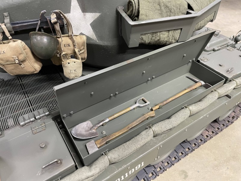

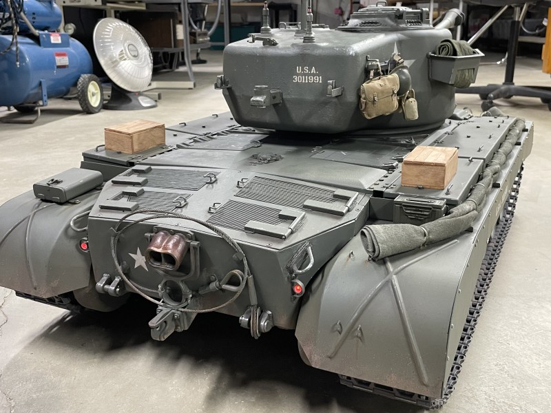

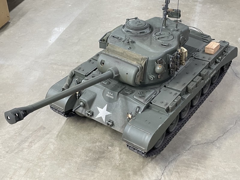

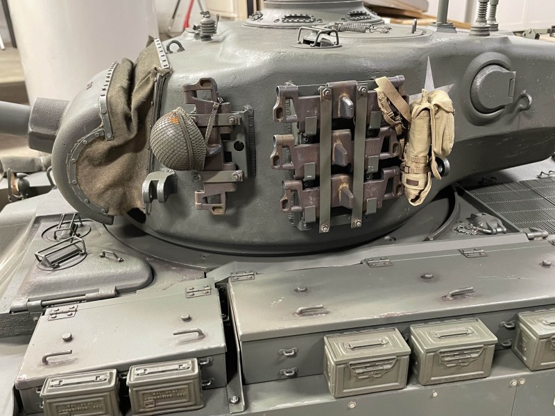

So my build in essentially done, with the exception of a couple more custom stencils to be applied, which I have not received yet. Also need some markings on the K-Ration crates, also will be stenciled. The helmets and bags are from the big auction site we all know.
The weathering is done to a moderate degree. I did not want it to look like it just came out of a battle, but rather a survivor with a bit of wear and grime. I know not everything may be exactly accurate as to how the paint may weather, but it is just my interpretation. And I didn't want it to look brand new. It was hard for me to start weathering after all the work I spent freshly painting it.
The machine gun, tools and ammo boxes are from Armorpax and they are a very nice quality. Highly recommend them. The machine gun lock on the rear of the turret and the track wrench on the side are from East Coast Armory.
All other mods were scratch built. If you have the Pershing you will know what they are, and my previous posts shows some of them. I hope more people will post pictures of their machines when done. So far I have only seen Tom Miller's tank completed. I will be taking it outside this weekend on its maiden run.
Thanks for all the help on the questions I have posed on the forum. All were very helpful in my first tank build.
-Ray

Love the internal layout , the mantlet canvas cover and painting Ray.
Just found that no co-axial machine gun (at least the barrel) included in the kit. :)
