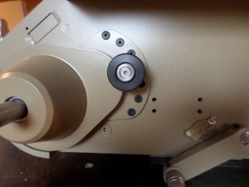

Today some misc. work was done.
I replaced the m3 countersunk screws that hold the final drive parts to to hull with m4 CSK's.
For me, the m3 do appear a little bit to flimsy for my liking. As I had bought a whole box any way
(I used these on the underside baseplate too), they came in handy.
Replacing was simple, I just did run the M4 tap thought the exisiting holes, no sweat at all.
Extra benefit, they only stick out 1mm at the inside.
Next job was to assemble the sprocket wheels, just a matter of cleaning all the holes to remove
the dried up cooling fluid and apply a tiny amount of loctite before inserting the heads.
After that the primer was applied, followed by a coat of Dunkel Gelb.

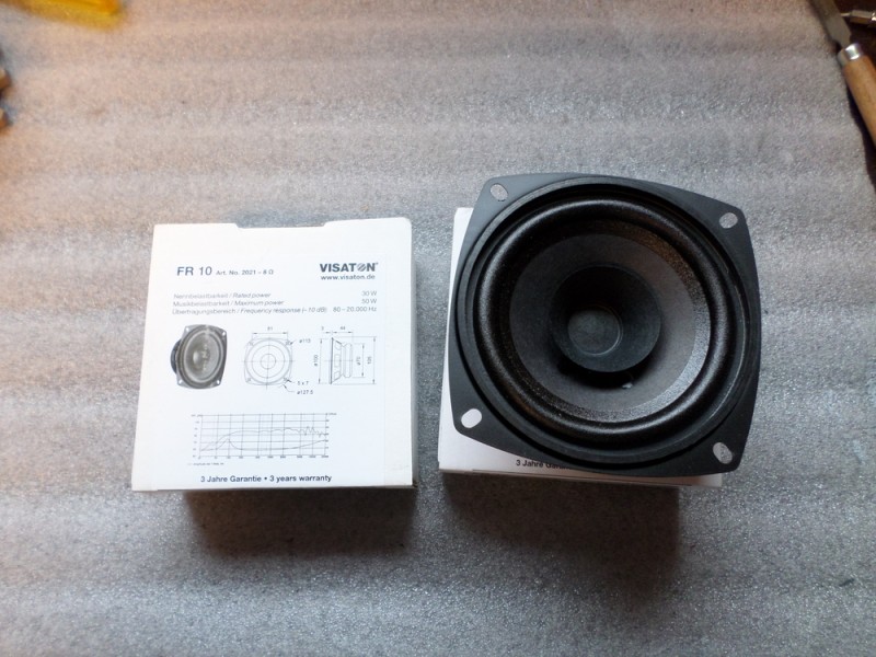

Off to the electronics parts shop to get 2 small wide range speakers, their diameter is nearly the same
as the inner diameter of the round air intakes. Each speaker will be boxed and attached to a base,
this base is then fastened using longer m3 hex head screws which go through the existing holes of the air intakes.

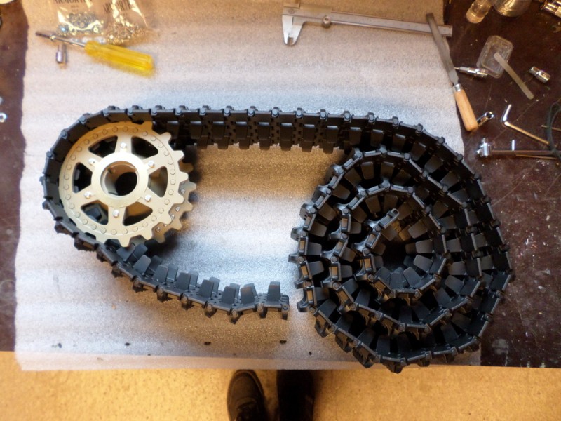

Track, and 'look, no Loctite!"
Post by Ed Groenenberg »
Today being the Dutch national Madness day (aka Kings day), I had a day off.
Having assembled the 1st set of wheels, I taught it would be nice to see how it looks with a track fitted.
The manual explains to use Loctite to place the hubcaps on the wheels at the very end of the assembly process.
I beg to differ, why not use another solution, which allows easy removal of the hubs when needed?

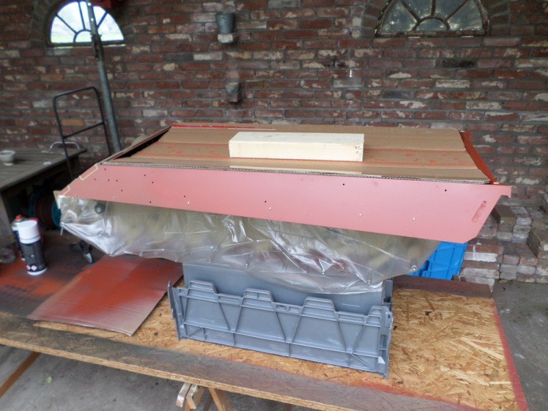

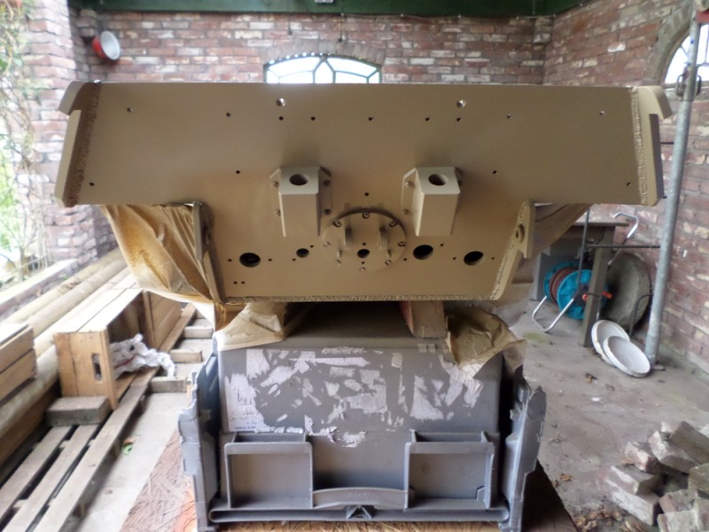

More painting
Some more painting was done on the main body.
Prepping was done to protect the already pained bottom part.
A few coats and the main body is now doen.
