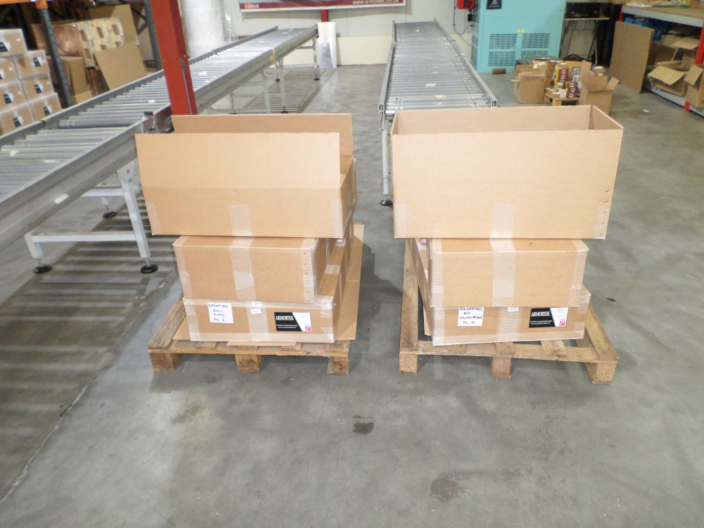

After a few months of waiting, I was finally able to collect my latest kit, the Panther G #4.
Together with one of our local RC tank club members Riny, (he got number #6, we picked them up at the Armortek factory last Friday.
Kian gave us the factory tour, and after that we checked out kits.

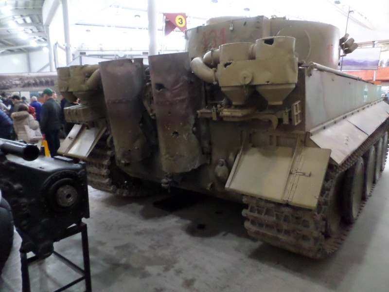

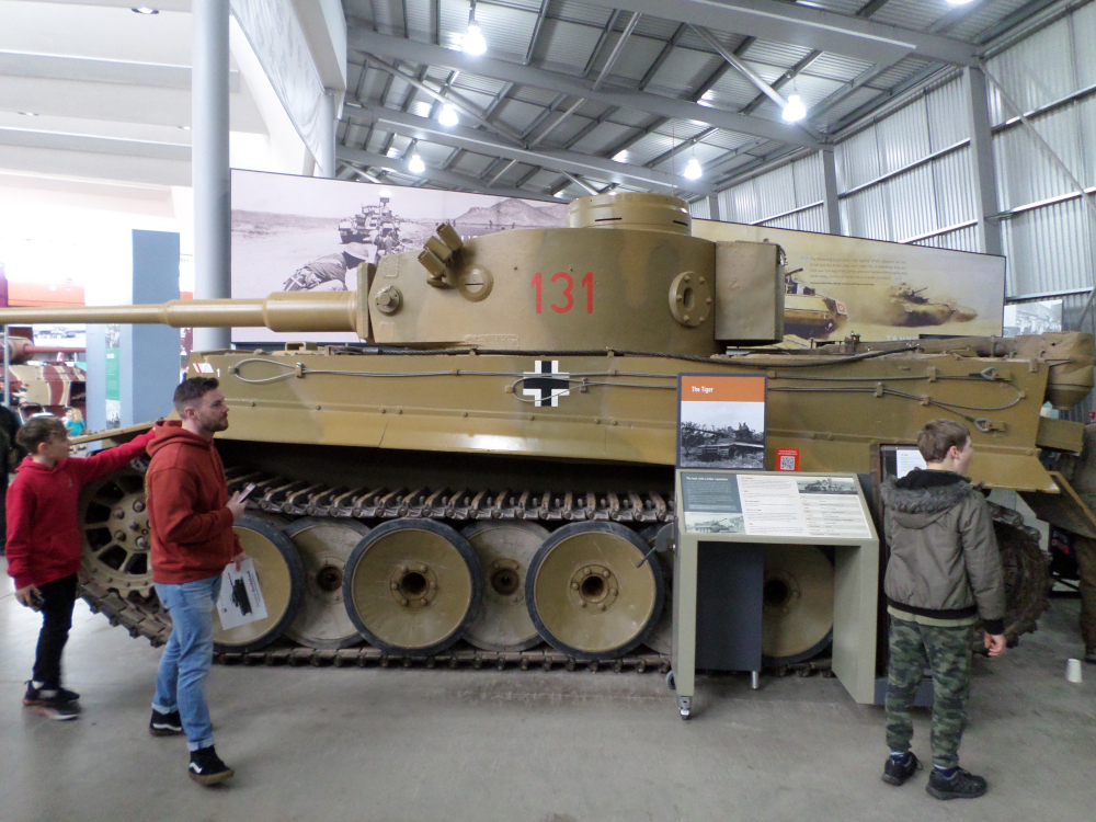

The next day a visit to Bovington was made, were we did meet a few other model owners, did a bit a shopping at the event
bought various items for the Panther (my wallet felt the pain), and I had finally a look to the real Tiger 1 - 131.
On Sunday we drove back and after a bit of delay we made it home.

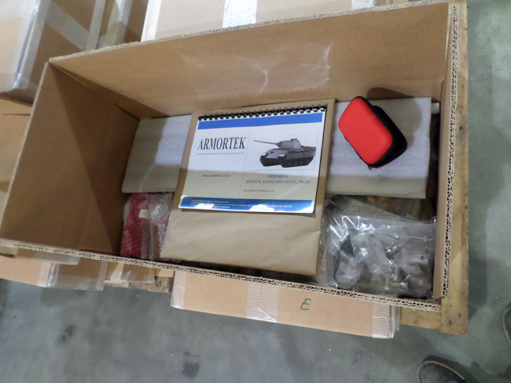

Today, time was spent to check the packing slips of each box, all was ok.
Also the parts were redistributed, one box with all the road wheel & transmission parts,
one with the turret parts and one with the rest, except the long parts.

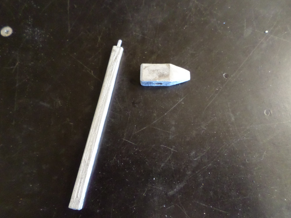

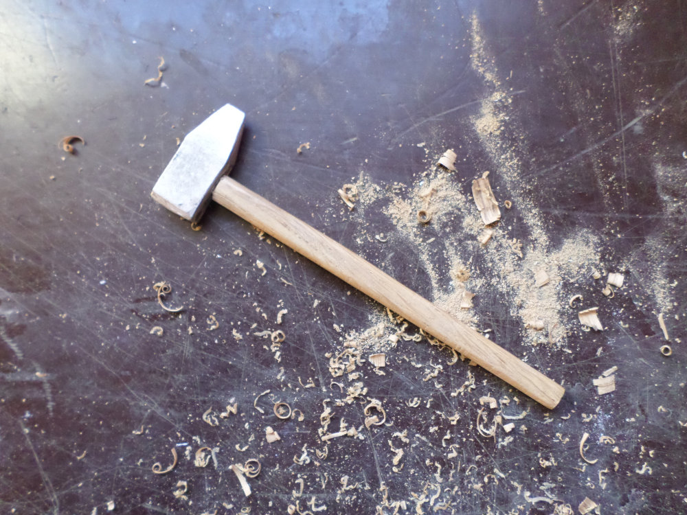

Well, you make a wooden stick for the sledgehammer.....
The original aluminum stick for the sledgehammer has a round end part, which looks that it could break of easily when one is not too careful.
So I decided to make a wooden one. I had a strip of French Oak left over, and made the stick.
The hammer part was drilled out, and using a watchmaker's file I squared the hole. The metal part needs finishing in black, the stick I probably will coat with furniture oil to give it an 'aged' look.

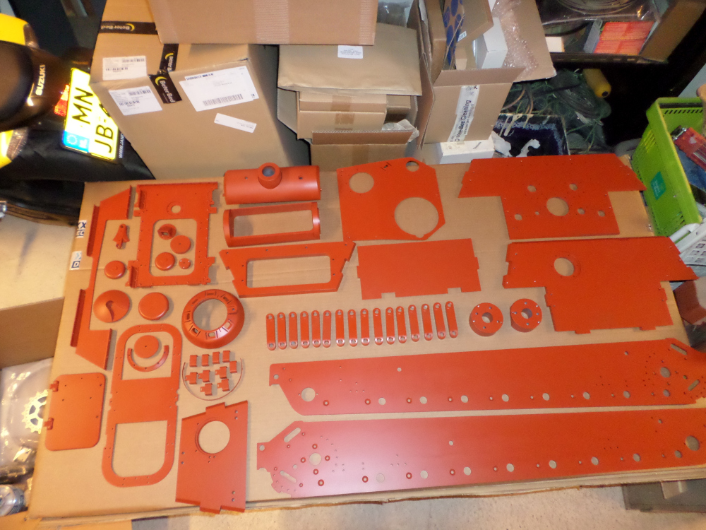

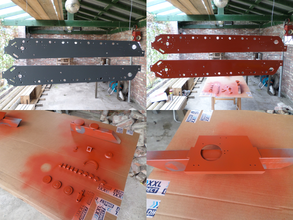

Today was a good day, it was priming time. The floor is riddled with empty spay cans.....(well, only 5 up till now).
Every aluminum part was cleaned with scorching pads, and then cleaned with Acetone.

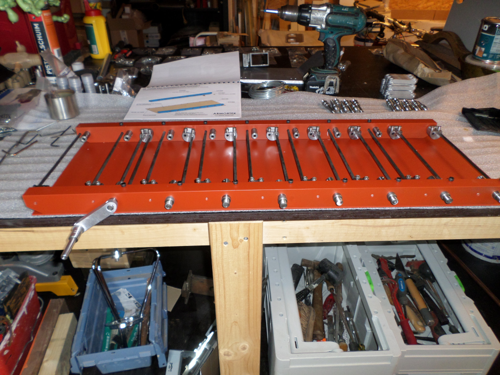

A good coat of etich primer was applied, followed by a good coat of red oxyde primer. This job took most of they day, running between the Garage and the 'paint booth'.

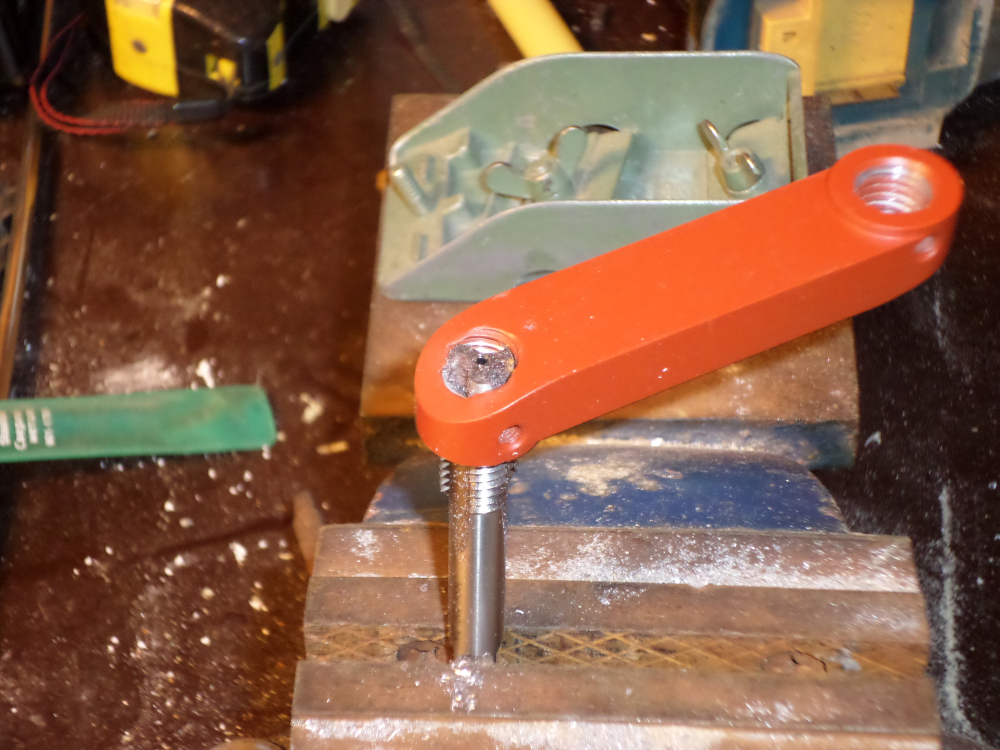

In between I did assemble the base with the bars and installed the 2st torsion bars with pivot blocks. I started using the button head bolts as specified with the manual, but basically every 2nd one got unusuable,
as the bit did eat away the sides. (Yes is was a quality bit, not a cheap 1ct one).
Out with the button head ones, in went the (temporary) cap head ones.
They get replaced with countersunk ones in due course.
And the pic below is an overview of all the parts primed today.

Today's little job.
Well, take Armortek's advise in mind when cleaning aluminum, especially when it is a espresso machine!
Today only a little bit of work was done, only priming a few small parts and using a 12mm tap to run through the swing arms.
Yesterday I tried to build the road wheel swing arms, but this did not go very smoothly. After only a turn or 2 the axle would
not go further, unless some force was applied. I think Brain Ostlind already made a comment about this problem.
So I got a 12mm tap at the local hardware store and used it to run trough the existing threads. Some went pretty easy,
some needed a bit of handling, but threaded holes now accept the axles and torsion bar ends without much friction.
Last edited by Ed Groenenberg on Mon Apr 10, 2023 7:57 am, edited 1 time in total.
