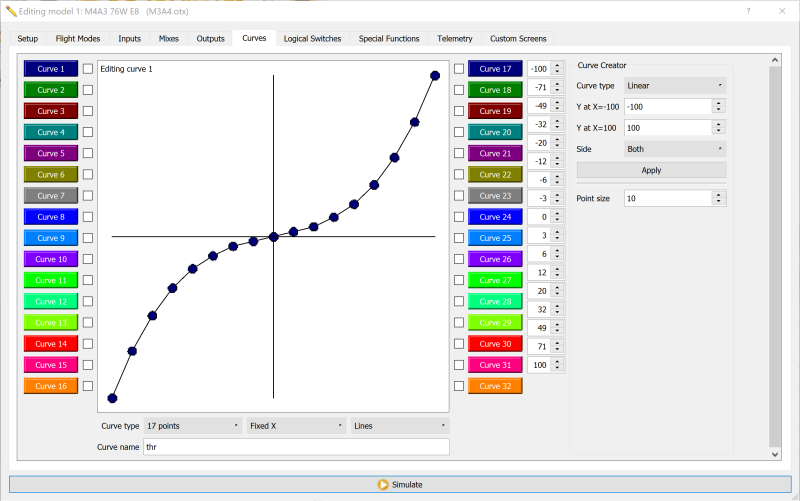

Paul Sparkes wrote: ↑Tue Mar 07, 2023 8:16 am
Looking at your opentgx config I see you are using logical switches. I'm pretty sure this is to reverse the turn direction when traveling backwards so it turns correctly. I however even copying your config can't simulate the turn correction. The logical switches turn on in simulator but the mixes seem to be the same as before. Can you explain how and why you are doing the above. I normally just do the standard track mix and it works (same as Stephen whites explanation).
