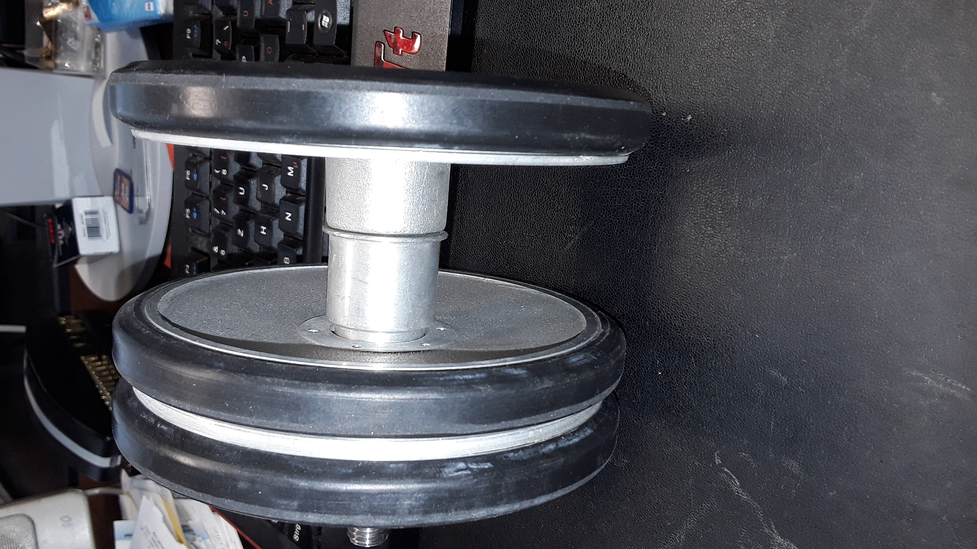

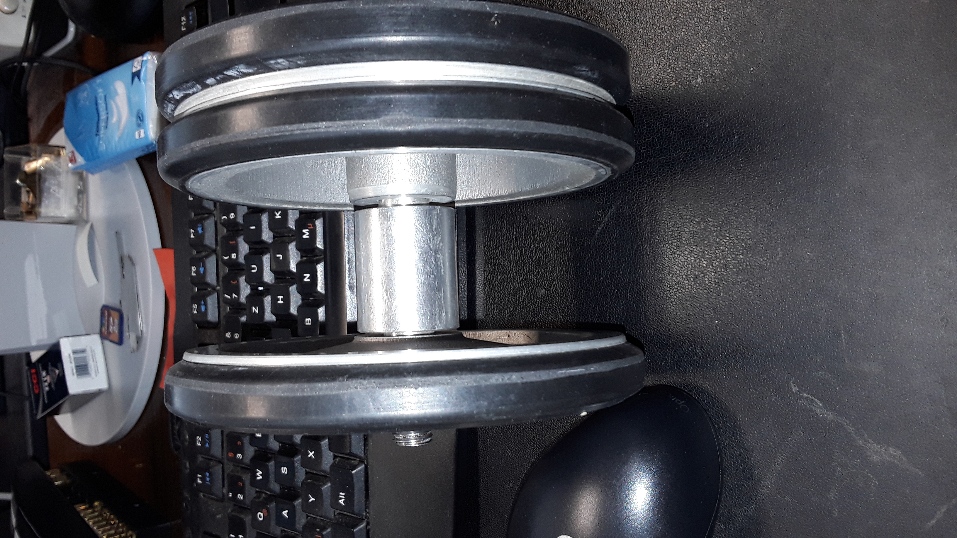

At the moment I havent fixed anything, it is just all provisoric fixed, so I now started with the wheels.
I find out that there is a lot of space in it. I wonder why. It is much more than I expected tolerance. I will post a photo soon

On the pictures you can identify, the space within the wheels. It is realy a lot....
