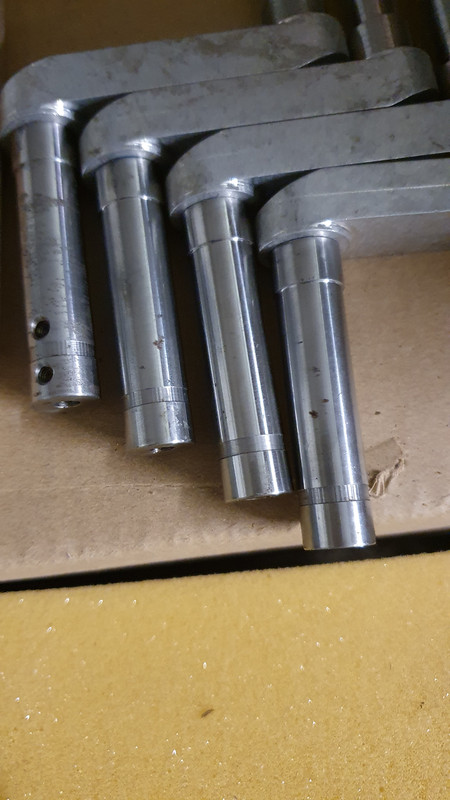

I have problems with the suspension and bearing blocks, also with the construction of the wheels and the suspension arms.
The suspension blocks have different mark and are available in different quantities. Some are brass, some are aluminium. I do not know which one comes to left or right, seen from behind of the Tiger.
The suspension arms have also different marks or rings, one ring or two. All I can identify at the moment is, that two 5mm torsion bars go to the front and 2 to the rear. The rest is 4 mm.

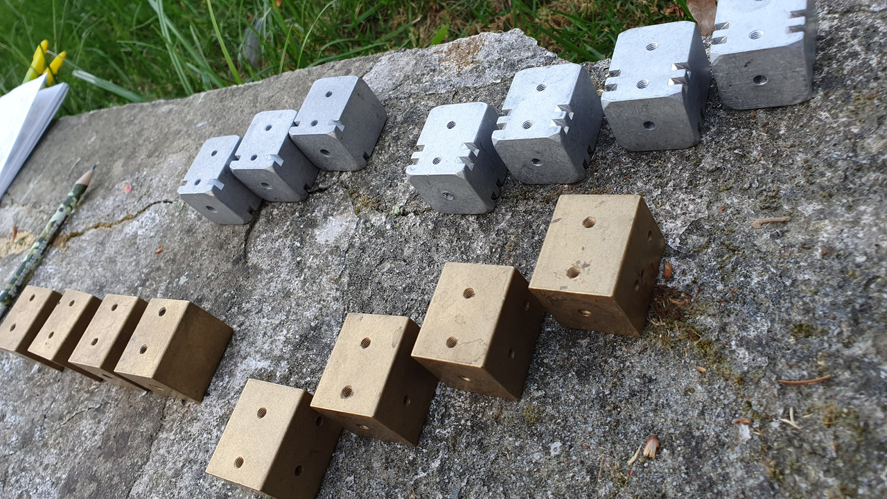

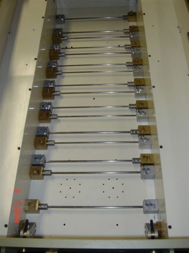

Suspension blocks in alloy and brass, notice some of the alloy blocks have a single cut and others double cut;

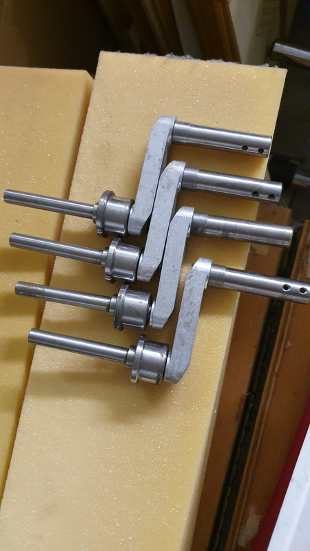

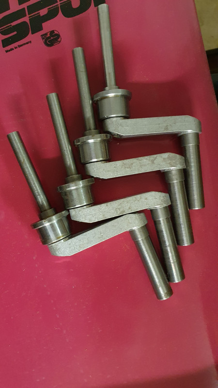

Different swing arms, notice a slight cut in the first picture;

Single slot aluminium blocks go at the front and the rear, double slots in the middle:
The actual order of the bars is 5 5 5 4 5 4 4 4 4 4 4 5 4 5 5 5
The two blocks (one of each) with a chamfer go at front, where the hull floor bends.

One ring or two should indicate 4mm or 5mm. Best to try with a 5mm twist drill and see which is which.

I will try to check your picture out. In my case, as you can see on the photos Mark sended, I have only 7 blocks in aluminium. So I have to see what is possible. I will try to post a photo, when I arranged the Blocks in the hull.

The order goes 55545 because of the relative positions of the suspension arms. The wheels are staggered from one side to the other so that the torsion bars do not clash.

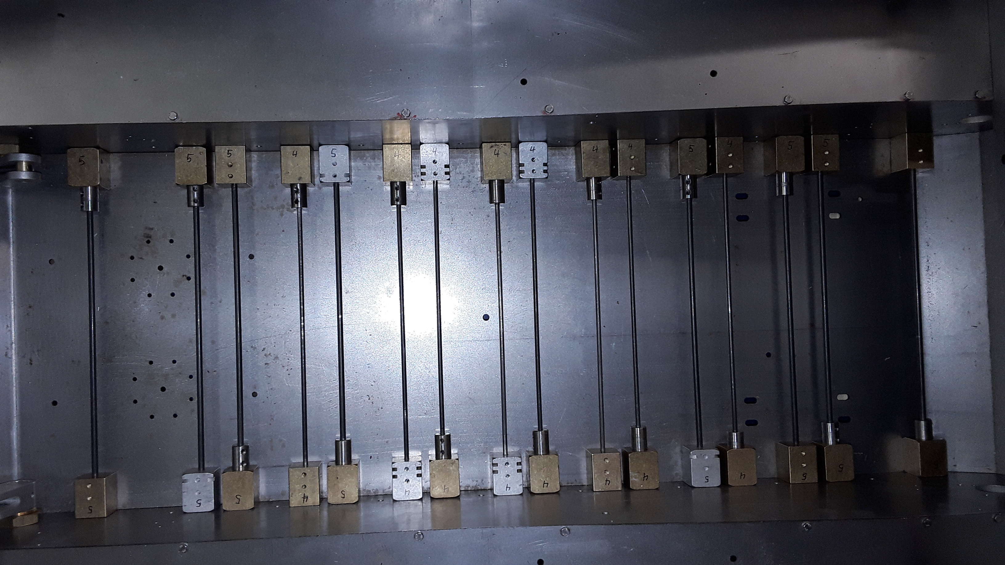

At the moment i try to make the torsion bars fit into the blocks. They all dont fit quite well. I will send a foto, when i have them all in the hull. Then next difficulty will be the wheels. Thery is much space in it, what I could see so far...

If they have them, another possibility is to ditch the blocks and the steel floor and get the current spec suspension bars and floor from Armortek.
The bars are part number CE2172, the busings are CP0223 and the floor is CE2153. They should be the correct size, though you might have to fill or open up some holes.

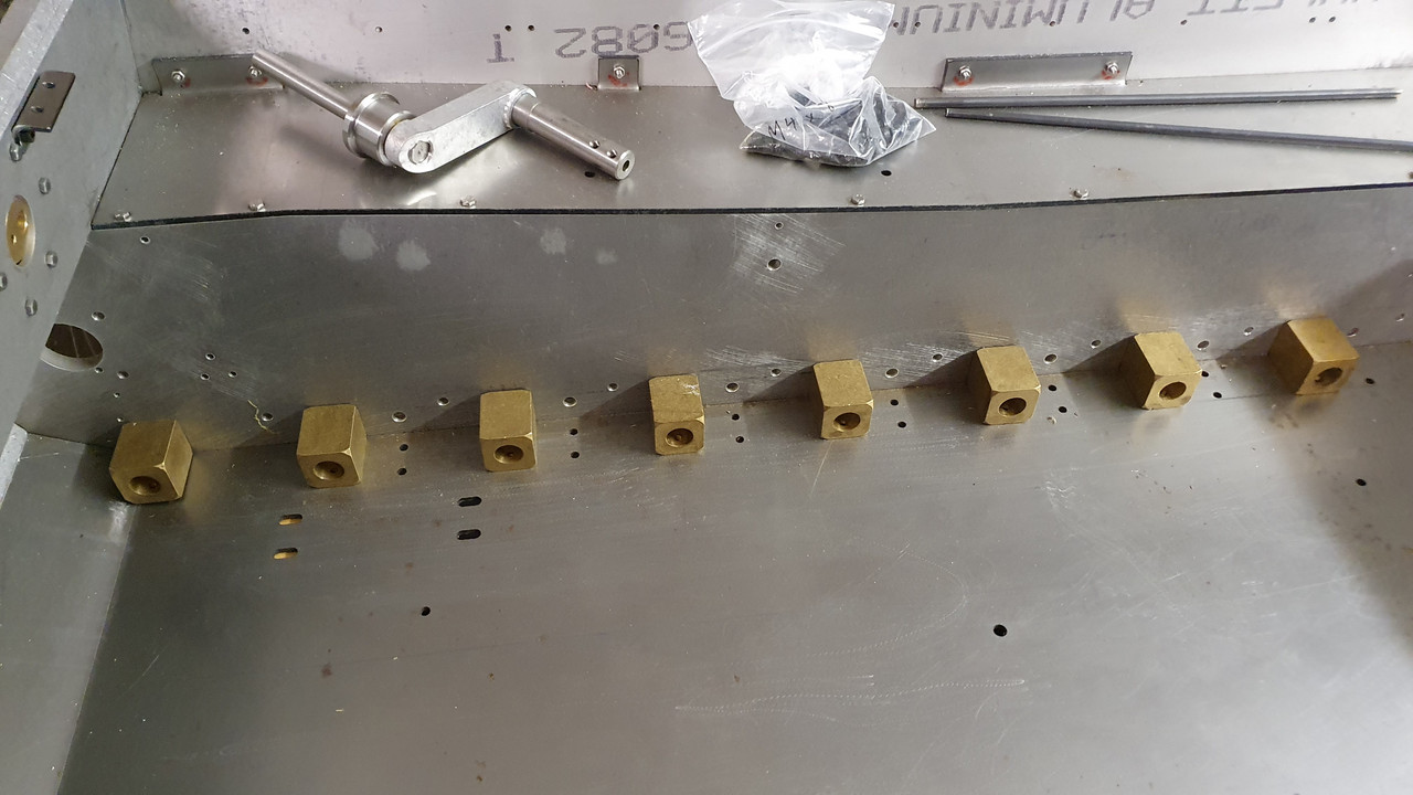

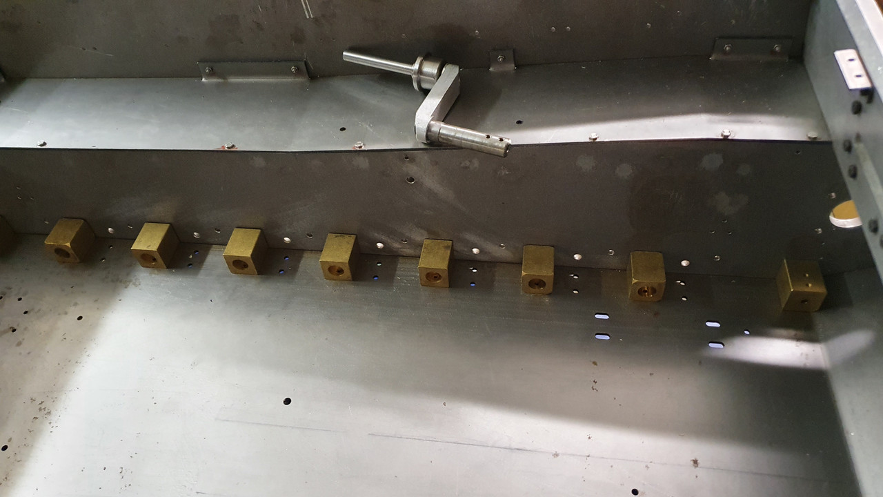

Ready with the blocks. What do you think, does it look correct?
Posts: 5130
Has liked: 1481 times
Been liked: 1687 times
Re: 2001 Tiger suspension help required.
Yes, that looks correct to me :D
