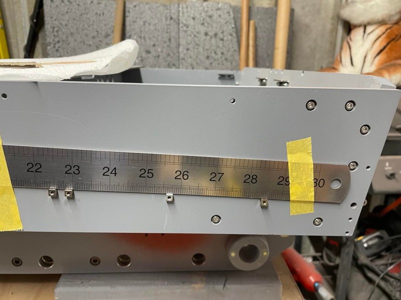

I haven't seen anyone post this,but i used a straight edge to get the mudguard studs correctly inline while loctiting them

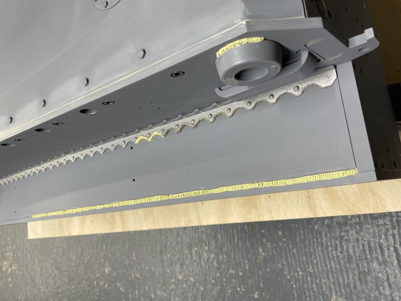

the second was a lengthy milling of the front plate,in another build (Garys i think) someone mentioned that the edges are a tad too long,i am not sure how much larger than they should be so winged it a bit removing 7mm which was roughly half i am not sure if this is correct but took a chance on it being close

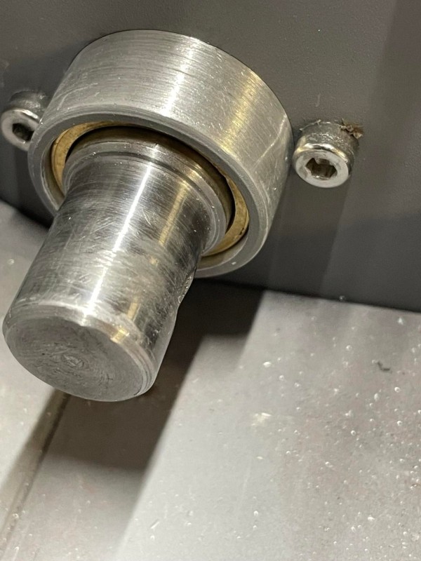

Idler Endfloat Issue
After taking a long time to get the rear idler spindle fitting snug,i ran into a problem,it turns out you have to balance the distance for the brass bush so that you take up the end float of around 1mm,if you dont it will have a knock on effect later on
let see if i can explain....
i started out inserting the bush and the spindle from the outside with a liberal coating of green loctite,bad mistake......
After heating the part up and starting all over again,it should look like this to remove the end float
This is the correct position for the bush to take up the end float the problem is how do i loctite this in place while taking up the end float?
Donald

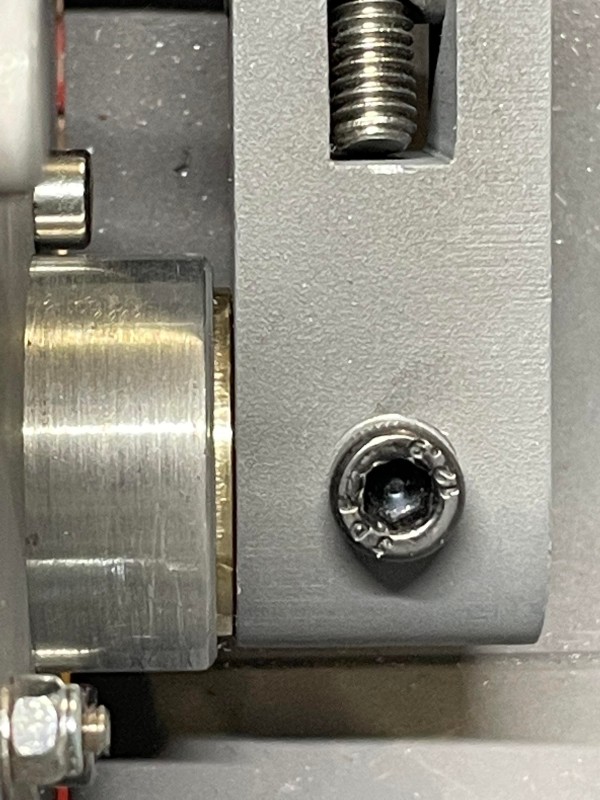

Hi Donald
I also had problems getting the Idler bush in the correct location and eventually decided to put all the wheels on and use a rod along the wheels to line up the idler wheel and ensure it was centrally aligned. There was a slight discrepancy between the idlers and I found I need the bush to protrude slightly on the idler wheel side of the hull to get the idlers aligned.
I have added a photo of mine , I cannot guarantee this is how it should be done but I have also used green loctite so fingers crossed .
Gary

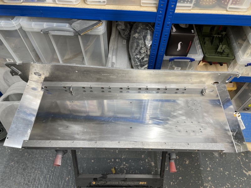

This was printed to correct the kit part,my milling skills were not up to shaping the kit part,but this 3d part in aluminium is a direct fit
