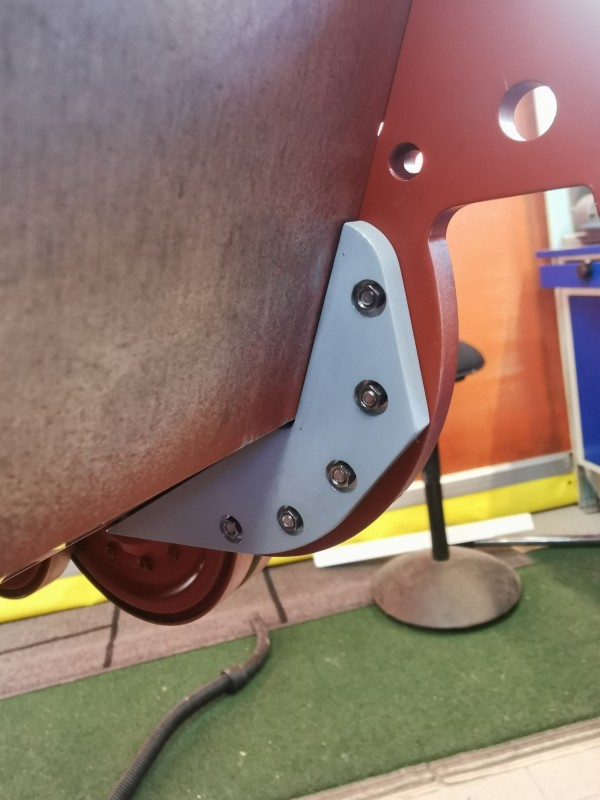

Countersunk bolts/nuts for the front reinforcement plates. Not quite decided if I'm going for bolt/nut or bolthead outwards. I know that bolt/nut are the correct way. But there was something visual appealing with the bolt heads🤔 Think I need to shot a mist of primer before I make a decision.

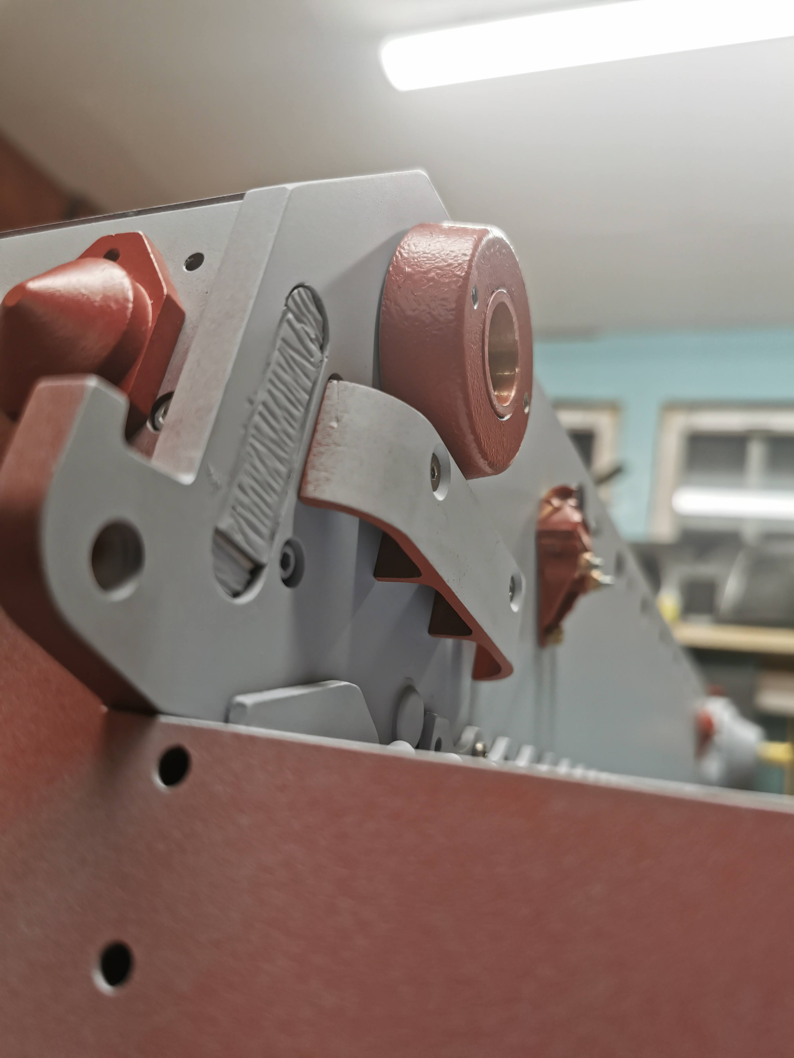

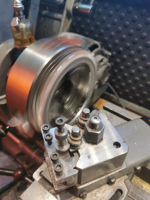

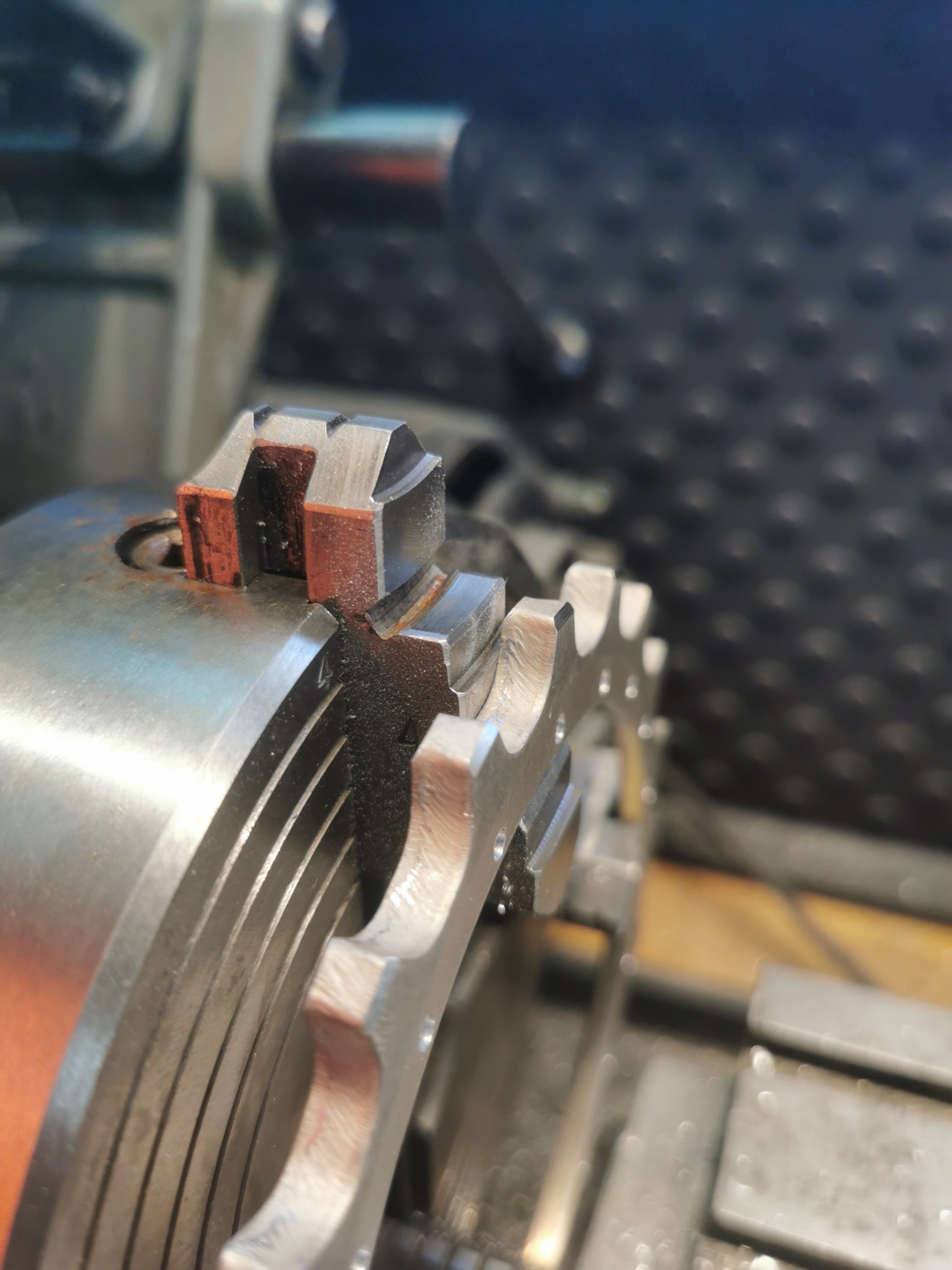

Have chamfered the sprocket rings, never found any info on whats recommended geometry, so went for 45 deg.

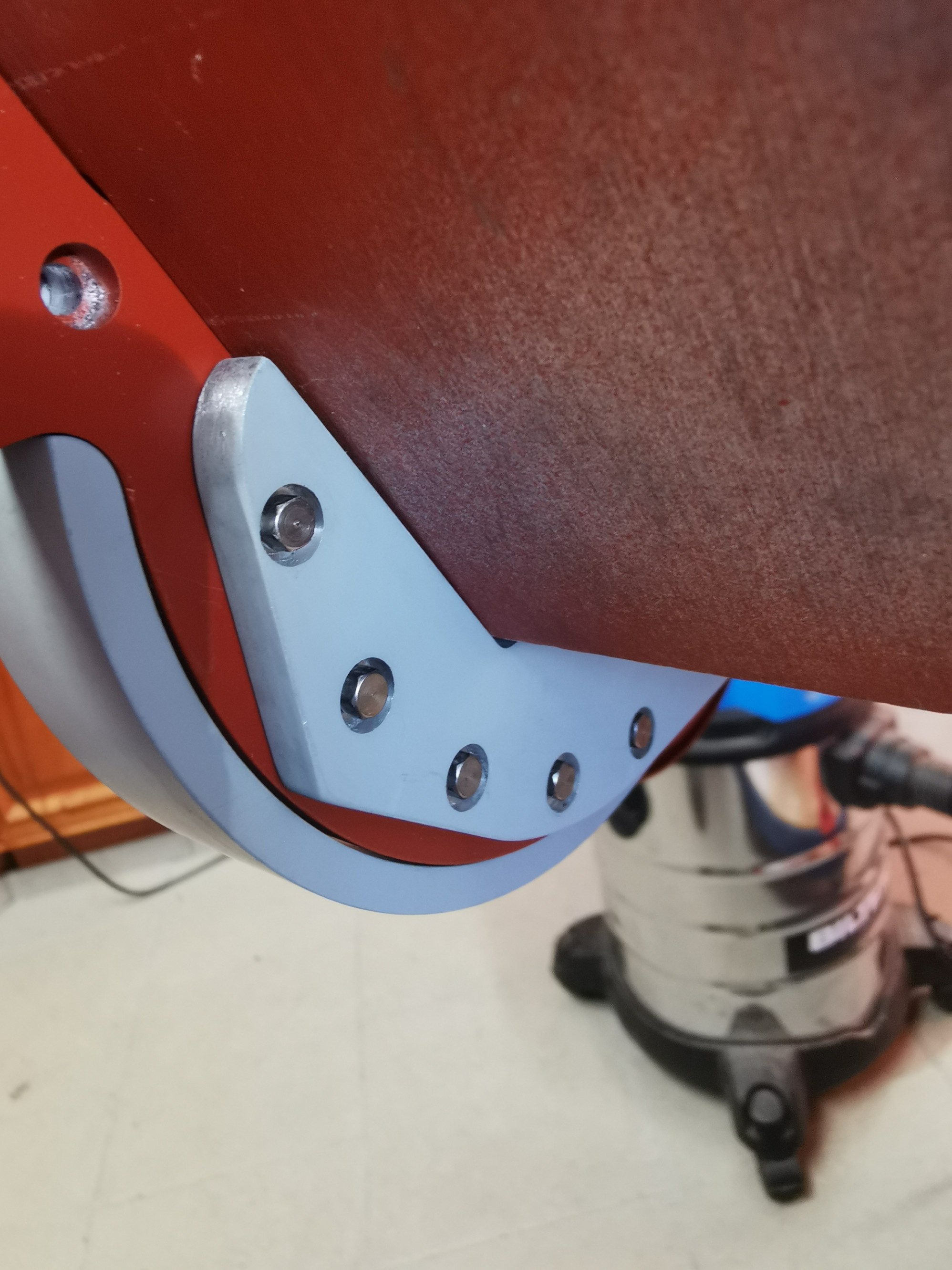

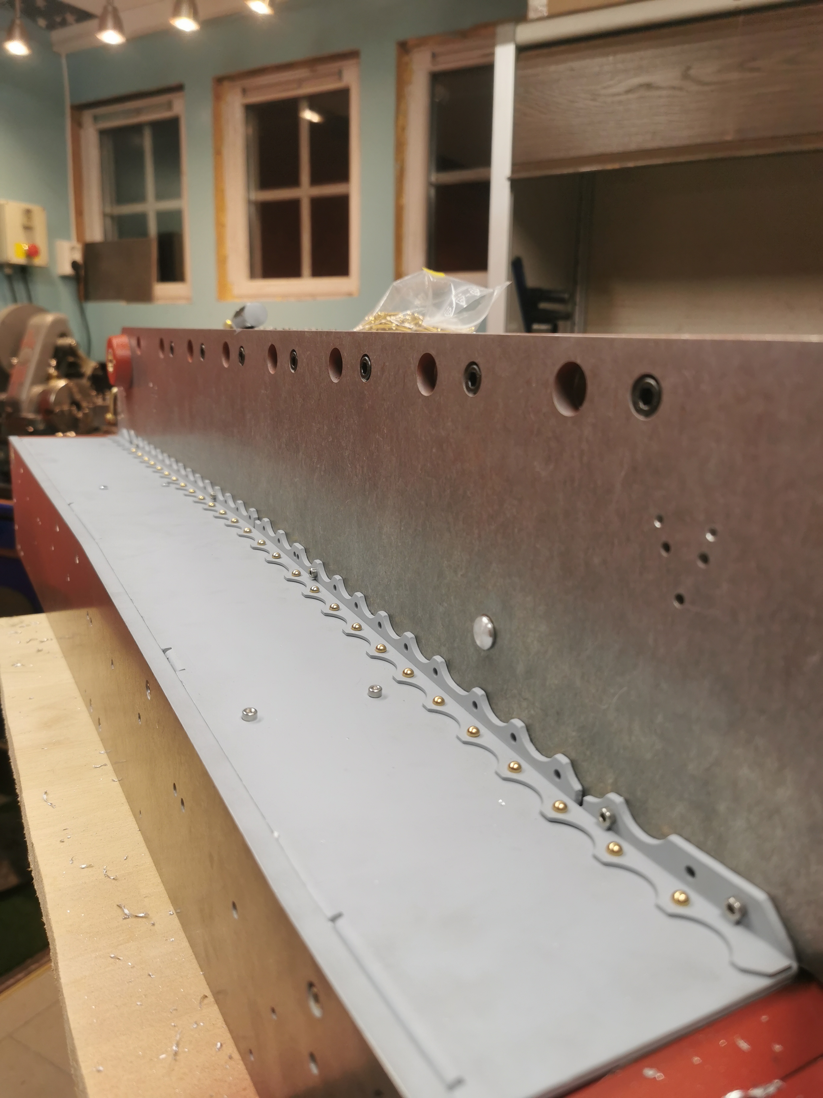

Hull progress has stalled for some time as I really would like the missing pannier gusset, but was unsure how to make them. By chance, I found out that there was a guy "almost next-door" that had a laser cutter. But needed a cad file for the parts. Asked Vince Cutajar if he might help, and minutes later cad files was in the mail😀 THANK YOU Vince👍
I really need to learn Fusion360 🤓
Back to the laser guy, and swoosh the parts was cut. Made 4 pieces, so Tor also got a pair.
Great day, got parts cut and found a new friend in the laser guy😃

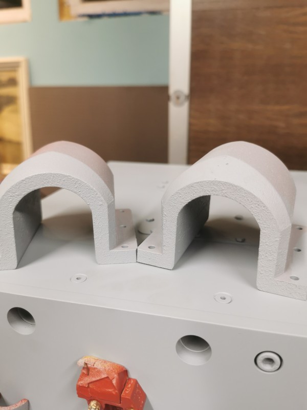

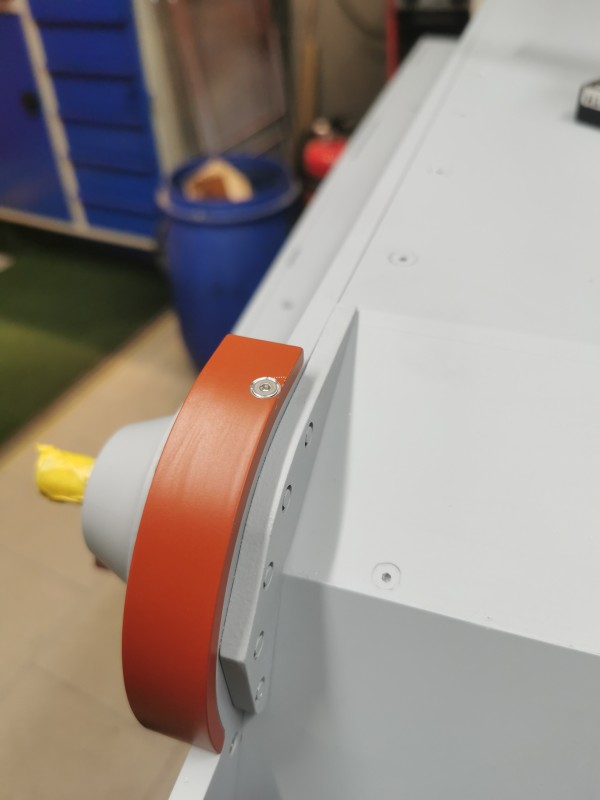

Not to much to brag about today, but have gotten myself a full etch primed hull. And started to mount som part. The half circle armour ring for the drive cases are original mounted with 2 bolts. I wasn't to happy with this as the lower portion of the ring would flex a but. Not a problem in it self, but might be bad for the Milliput weld line. So I drilled/tapped and countersunk for a M3CSK bolt, and with this addition the ring is rock solid.
Need to get me some putty to delete holes😉 before the Milliput welding starts.

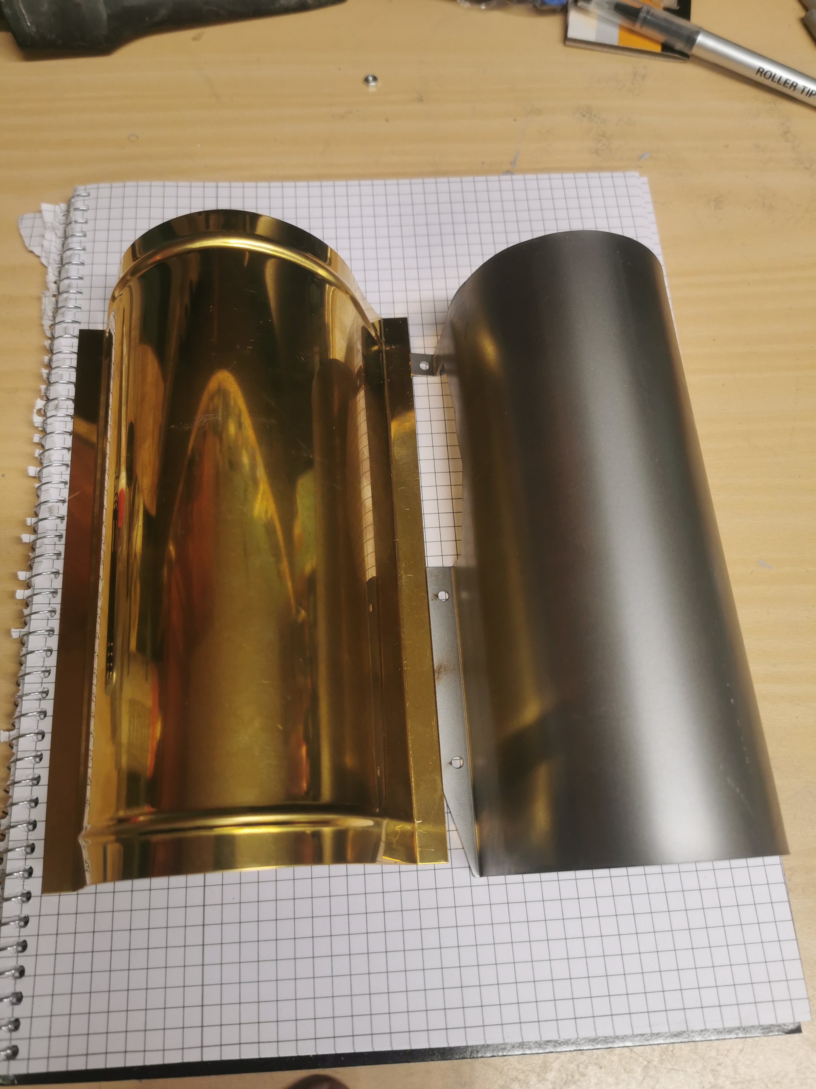

But would like to share what I got in the mail today 😁 I think these will look good on the big cat. A HUGE THANK YOU to Mr. Robert Tanzer for pressing these shields. Very nicely done, quickly delivered and at a great price. 👍

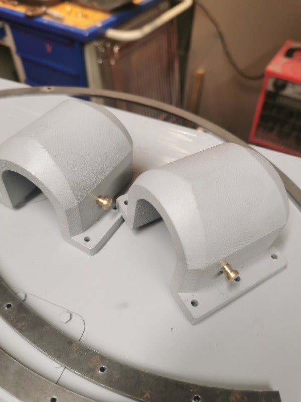

Anyway, got my lifting lugs done on the exhaust armour. A quick job on the lathe, once I determined on the dimensions. Did them in brass, as I had a M8 rod laying in a drawer.
