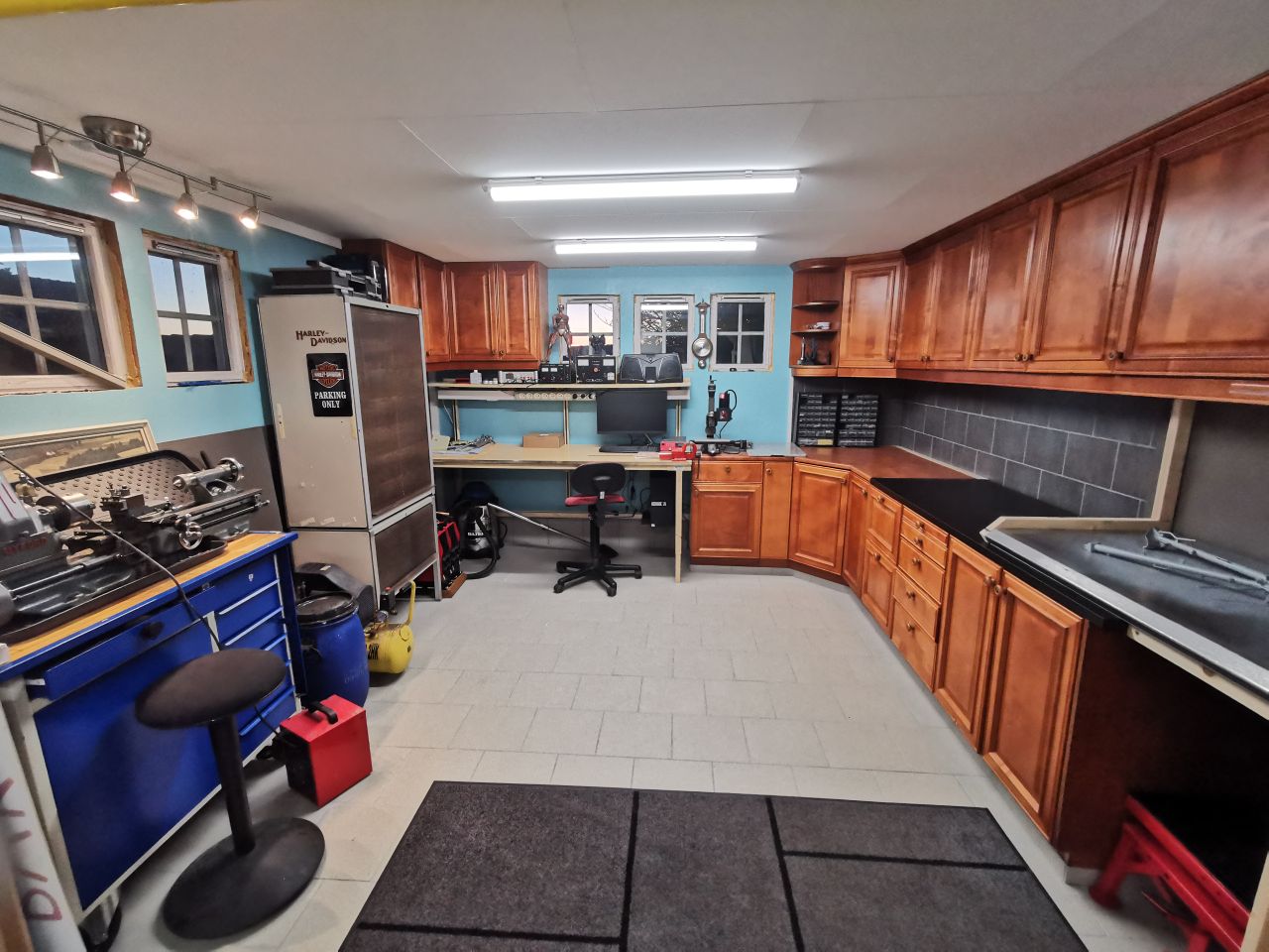

I am impressed with how neat and tidy your workspace is!! :D

The room is just finished, so believe me, it wont stay like this for long :) And behind the closed cabinet doors, there is absolute chaos :)

You have the two most important assets in your workspace: Space and light. :D

Welcome! That is one nice man cave! Enjoy the Tiger1 build.

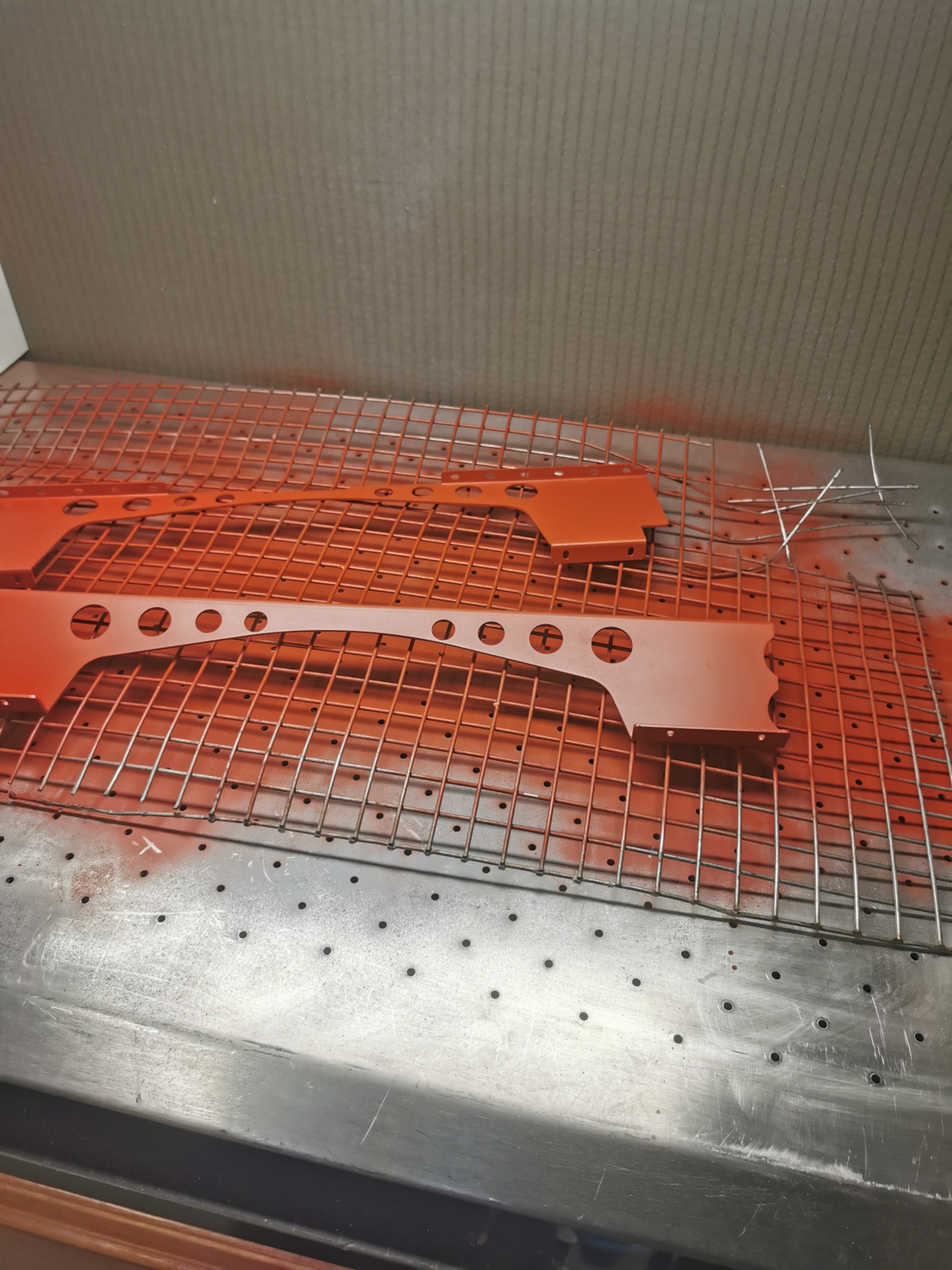

Slowly started to make som parts red, just a test to see how my homemade paint boot works out. And it works great :) I found a old kitchen interior, given for free. And it had the ventilater integrated, found out it wasn't enough so I made a downdraft ventilator made out of scrap parts. I drilled 250 M4 holes in the stainles steel plate, and has a powerfull fan below. Zero paintdust in the room during operation :D . Only downside is that the powerful fan suck air so hard, that I have made a organ with 250 pipes. It's noisy as hell :shock:

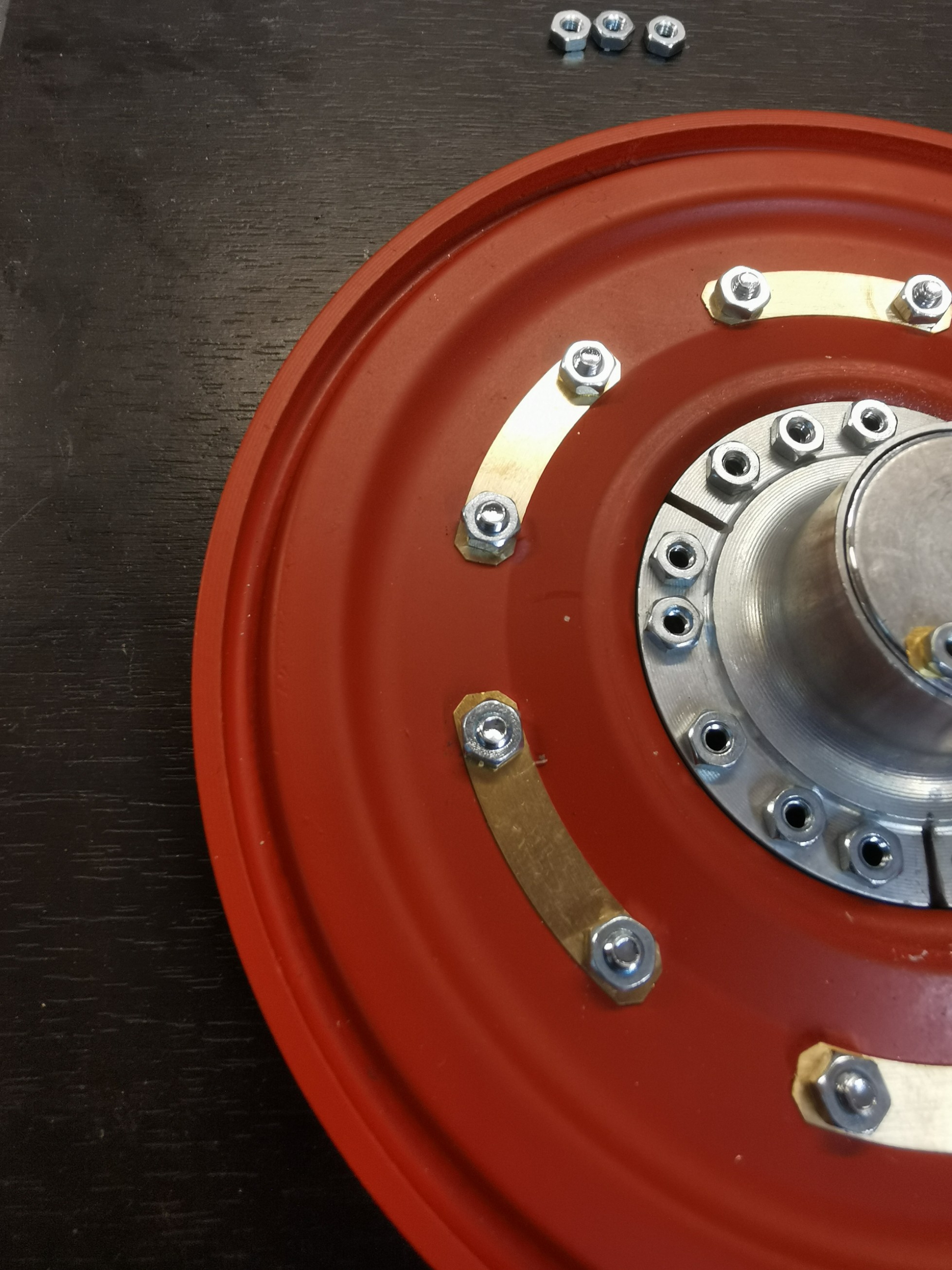

Have drilled out the outer bolt circles to take M3 bolt/nuts, would like a tad smaller bolts for the inner circle. What is recommended? Going for M2?

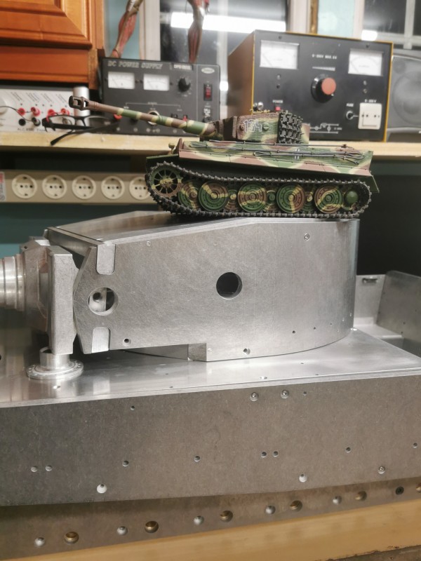

Just for fun. Size do matter :D
1:24 vs 1:6 scale.
Can i ask why you drilled these out to 3mm,when 2.5mm bolts are supplied for the job?
i think like me you are following Oddballs 2017 build on You Tube,the only reason he did that method was because the 2.5mm hex bolts were not included in the 2017 kits (Socket Cap screws supplied)
i too looked at the wheel video recently and then seen no need to replicate what he had done as it was was corrected by using the hex bolts
Donald
[/quote]
Hi Donald.

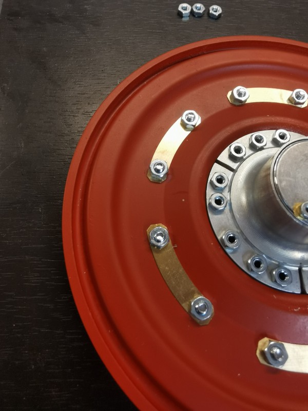

Because I want a visuel difference between the outer and inner bolt circles. The outer are substantial bigger than the inner circle on the real thing. The M3 gives me 5.5mm heads, and I think I'll get the wanted effect by going to M2 on the inner circle(4mm head) I have yet to find (locally) M2 bolts, but M2 nuts are available.
I'm going to pick up some nuts tomorrow, so we'll see if it works out. :)

Found som M2 locally, and tried out a comparison between M3 outer circles and M2.5 and M2 on the inner circle.
I think M2's are the way to go (?)
What do you think?
