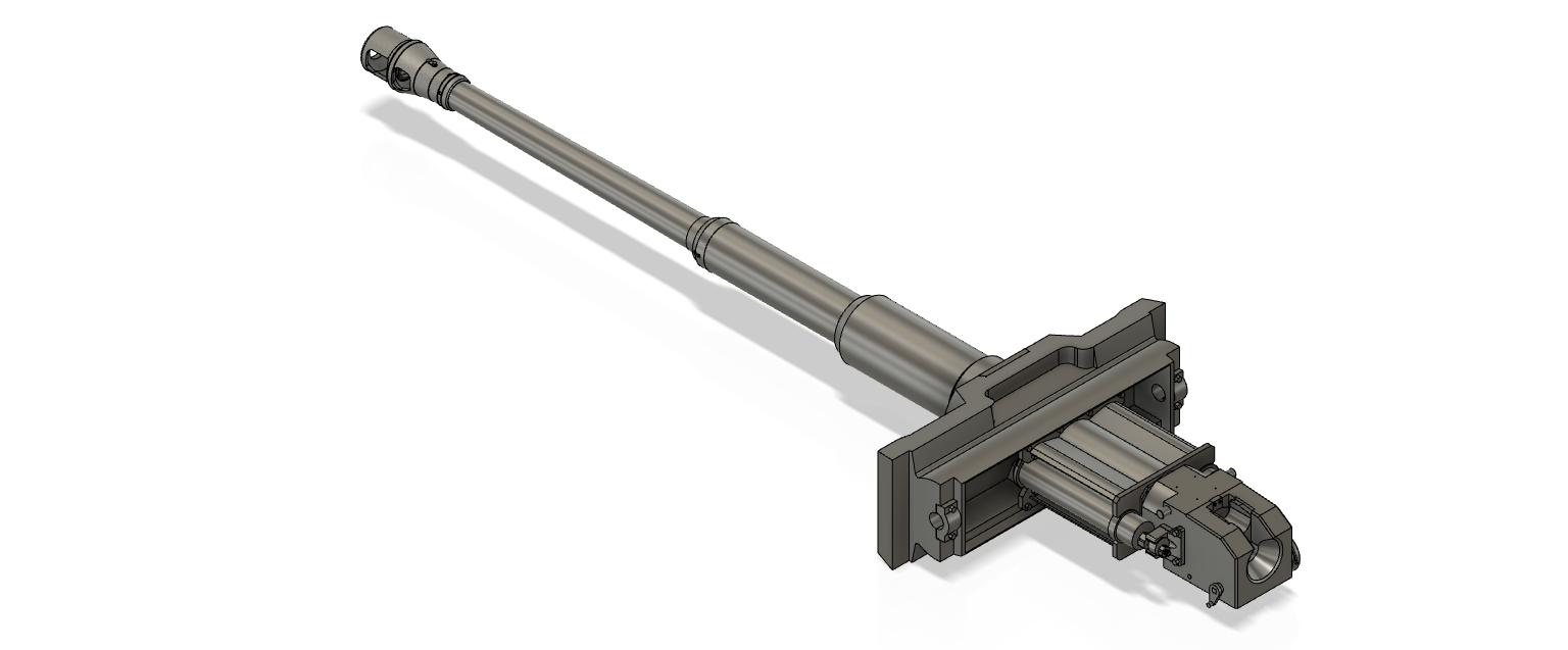

Yesterday I finished the breech and cradle. Decided to add the barrel and muzzle brake. I used my own 3D model for the muzzle brake instead of remaking it.
Now I am thinking of adding the mantlet for completeness. I guess I am digging a deeper rabbit hole!!

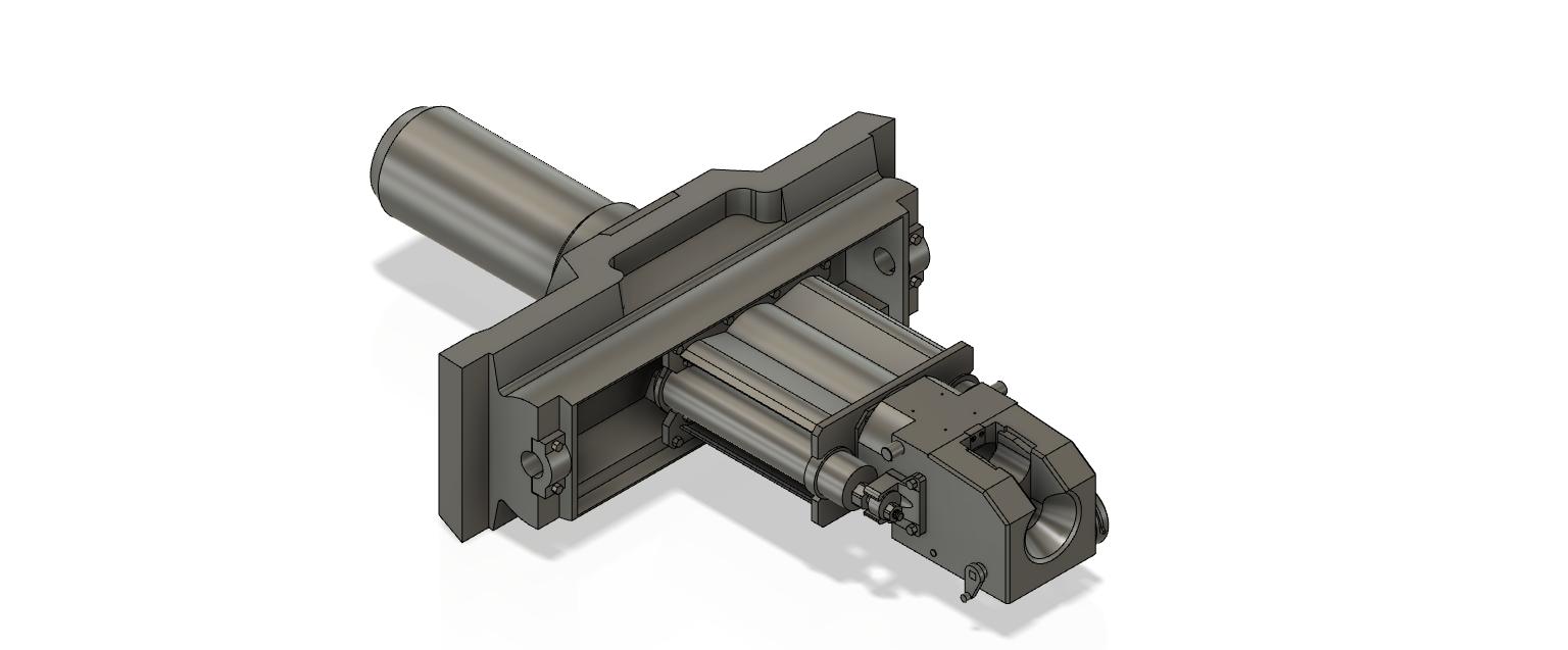

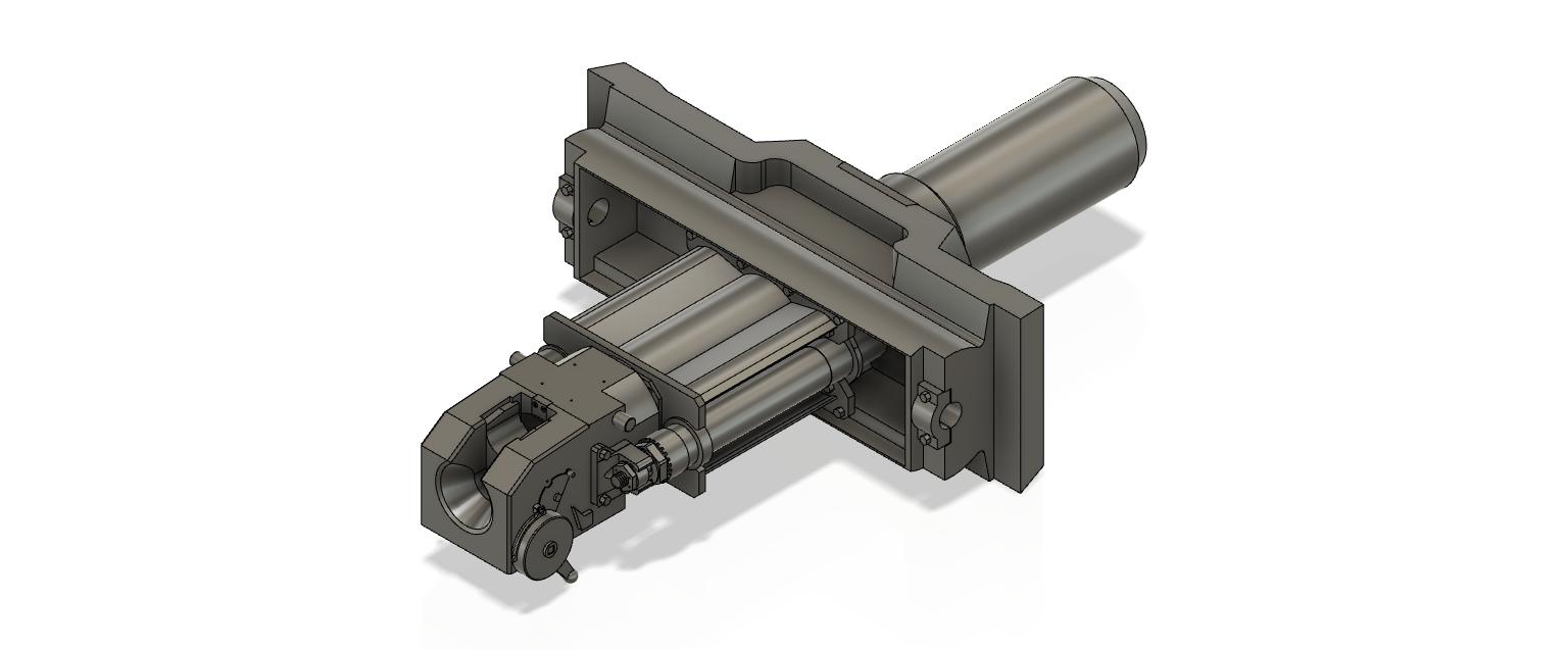

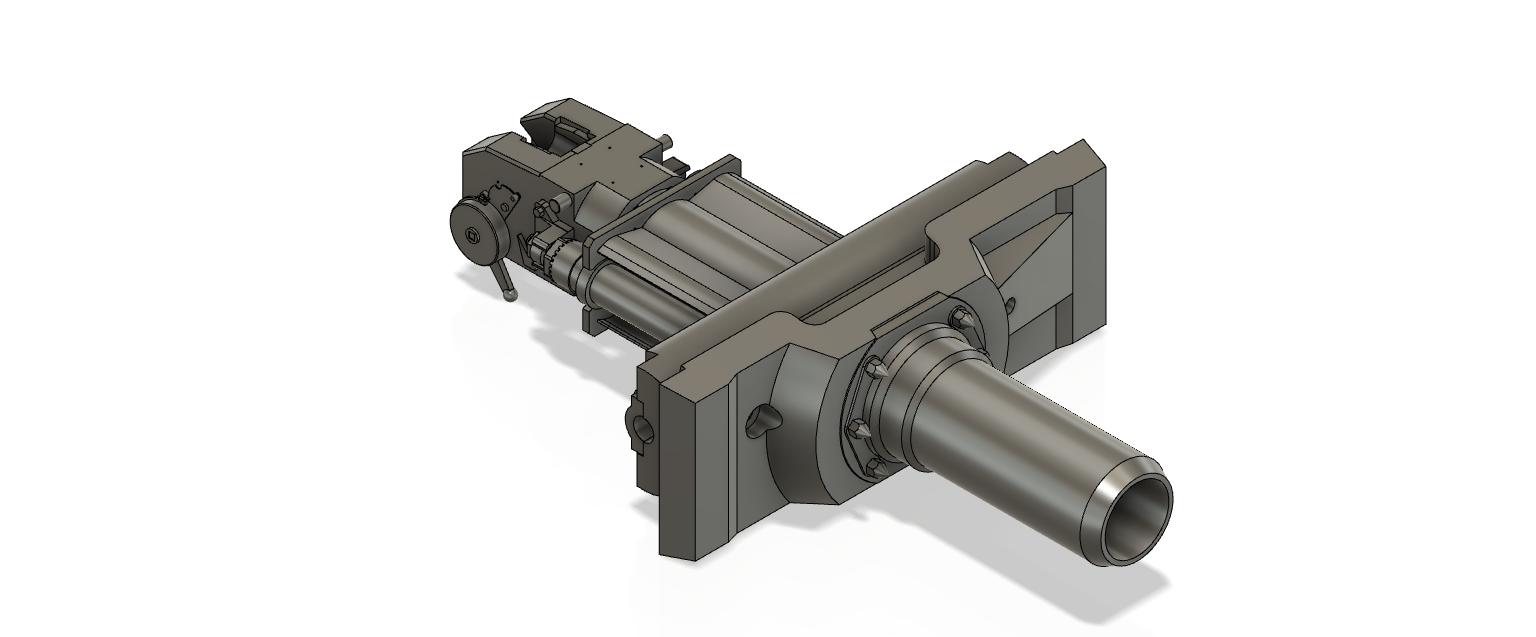

I have disabled the link to the 3D web viewer and instead I am posting a few images.

Beautiful CAD model Vince. Your skills have come a long way! That gun looks great.

Thanks Bob. I guess practice makes perfect. As I am rarely going to the workshop I tend to spend a lot of time on CAD.
